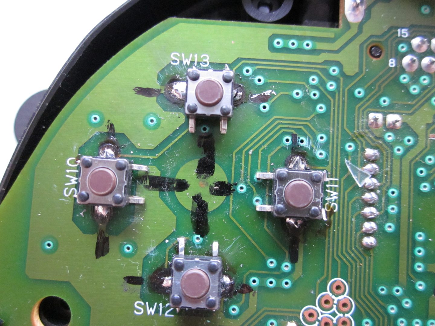

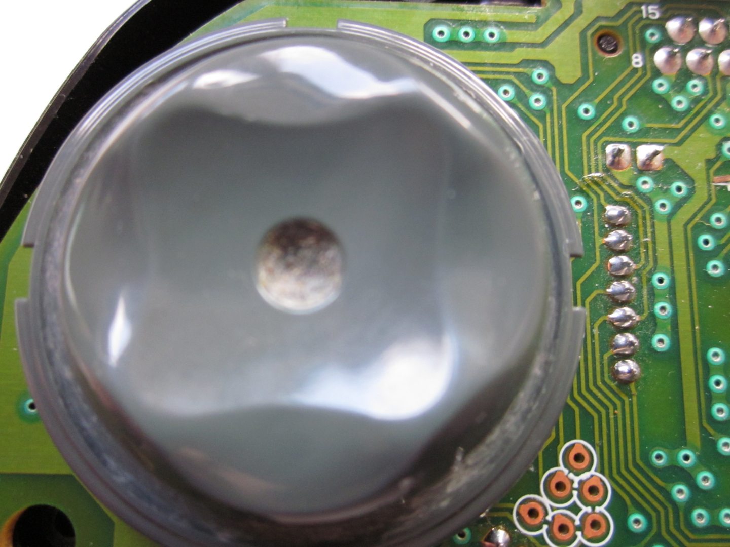

---edits re Microsoft Sidewinder gamepad d-pad switchmod:---
Just found that Sidewinder pad, and surprise: made my Mitsumi, at least the pcb is, and presumably this next trick as well. I've always found it's d-pad awkward to horribad, but that was before I met the xbox's. What they did, was get regular rubber domes, ofc smaller lower and stiffer, and put those in the diagonal corners of the pad (although the domes are bottoms up when compared to normal orientation); so what you do when using it is riding the top of the dome way before the buckling point.
Very little space to mod switches into, but probably will take a moment one of these days to do so anyway, to test if having the buckling point actively under your fingers on a d-pad will/could feel nice.
Alright, started on that sw anyway, the pad will need to be rotated for the switches to fit unless I start cutting; and after putting one switch down it seems like it might work.. Though it's a b* to make sure the switches rest at exactly the right spot and exactly horizontal (imbalance will be very noticeable in use), will update later.
After mocking about quite a bit with the switches, all 4 soldered on now (all with the idea to keep the original hard plastic pad on top of those), it seems that it might feel nice; when done properly. Thing is, getting them into exactly the right positions so the d-pad can comfortably and reliably click all of them is even more of a pain than I thought. Add to that, that to fit the switches the membrane and plastic ring (that normally keeps the membrane attached to the d-pad and keeps the d-pad from rotating on the spot(!)) are ditched, now allowing the d-pad to rotate and slide a few mm (enough to block the switches from activating as they are currently positioned), I'd not recommend anyone go down this road unless they have a sacrificial pad to learn on (as I do).

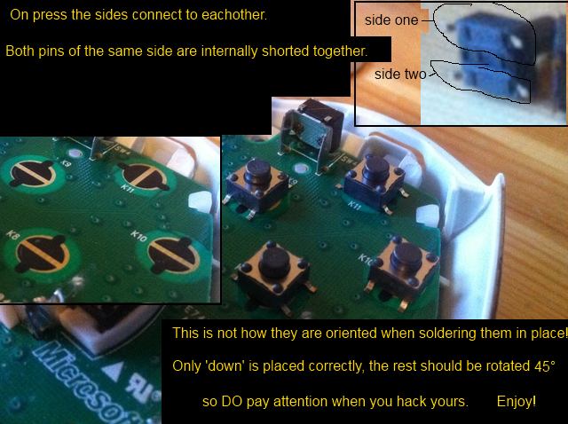

:!: I just noticed something, your pic of the switches before soldering is misleading, it doesn't show how you actually have placed the buttons; if soldered down like this, 3/4 buttons will be always triggering (unless the other pins are not touching the copper, not even through pressure) so careful readers!
switch orientation.jpg (59.64 KiB) Viewed 24892 times
So again, any orientation *can* work, provided you are aware what points to isolate and which to solder.
Otherwise, just solder all the pins in the orientation that's indicated in the text on the pic.

Off: :Quadruple Facepalm: I TOTALLY forgot to mention that. Sorry readers! Off is correct, the 2 pins that are directly across from each other will complete the circuit. See his pic! What I did was: I bent the pins beneath the switch and soldered them on that way (surprisingly easier than expected).
Plus, your project seems cool can we get some pics!! :D
**Scratch This**
[EDIT] :!: "Down" (A button) is placed incorrectly. The pins directly opposite from each other close the circuit. Only 2 out of the four pins need to be soldered for the circuit to be closed since the switch is SPST. I believe that they call that "One-way" in Britain. As I said above, I bent the two that I used underneath the switch, tinned them, tinned the copper (after scraping off the pads) and then soldered button to pad.
**This here is good**
[EDIT 2] What Off said below is correct I seem to have confused myself somehow :?: Thanks off!
:o :o :o :o :o
:!: Stop confusing the (potential) readers man*, my pic is correct in pointing out that the 'A' button is the only one oriented correctly...
I just rechecked with the single button I haven't soldered in that the pins that are on the same side, facing the same way, having the same orientation if you will, are the ones that will connect to eachother when the button is pressed; the ones opposite eachother, the ones that, when folded under the button will touch one another, are already internally connected through a short. :!:
Now where's that quintuple facepalm. :roll:

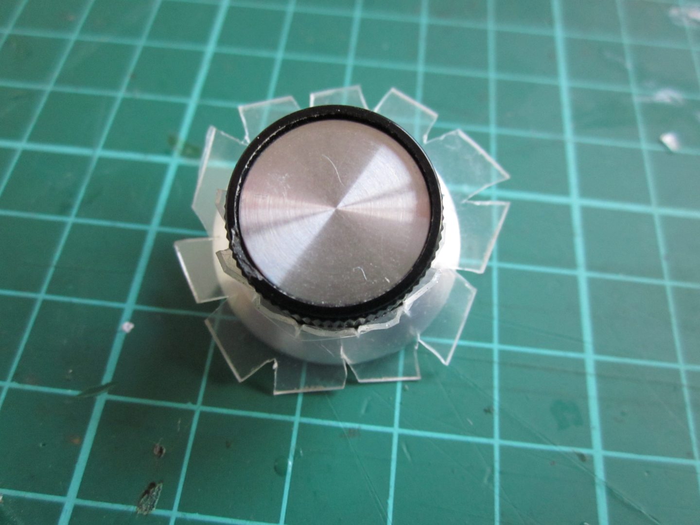

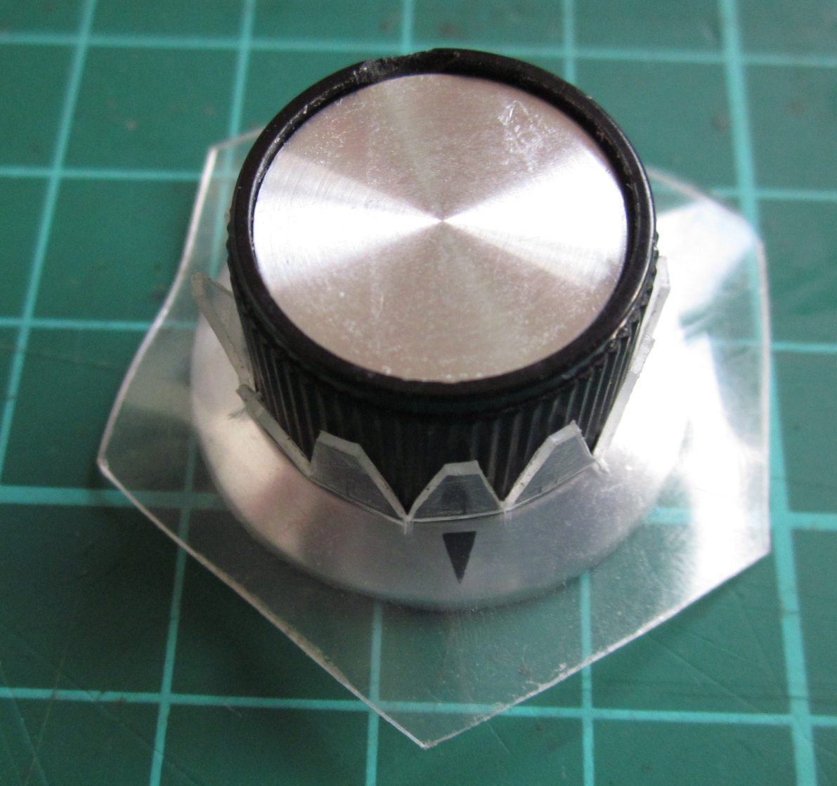

AAAAAAANyway, what I came back to this thread for, was to crap it full of pics :lol: on your request! :evilgeek:
Pics, smilies, and horribly made up text*. :mrgreen:
*I'm confusing them enough as it is.

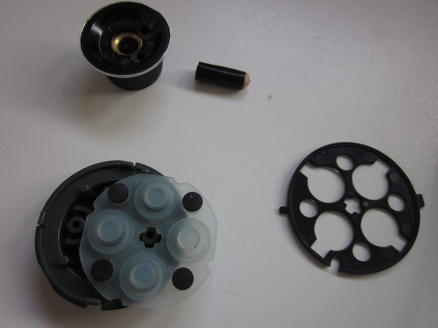

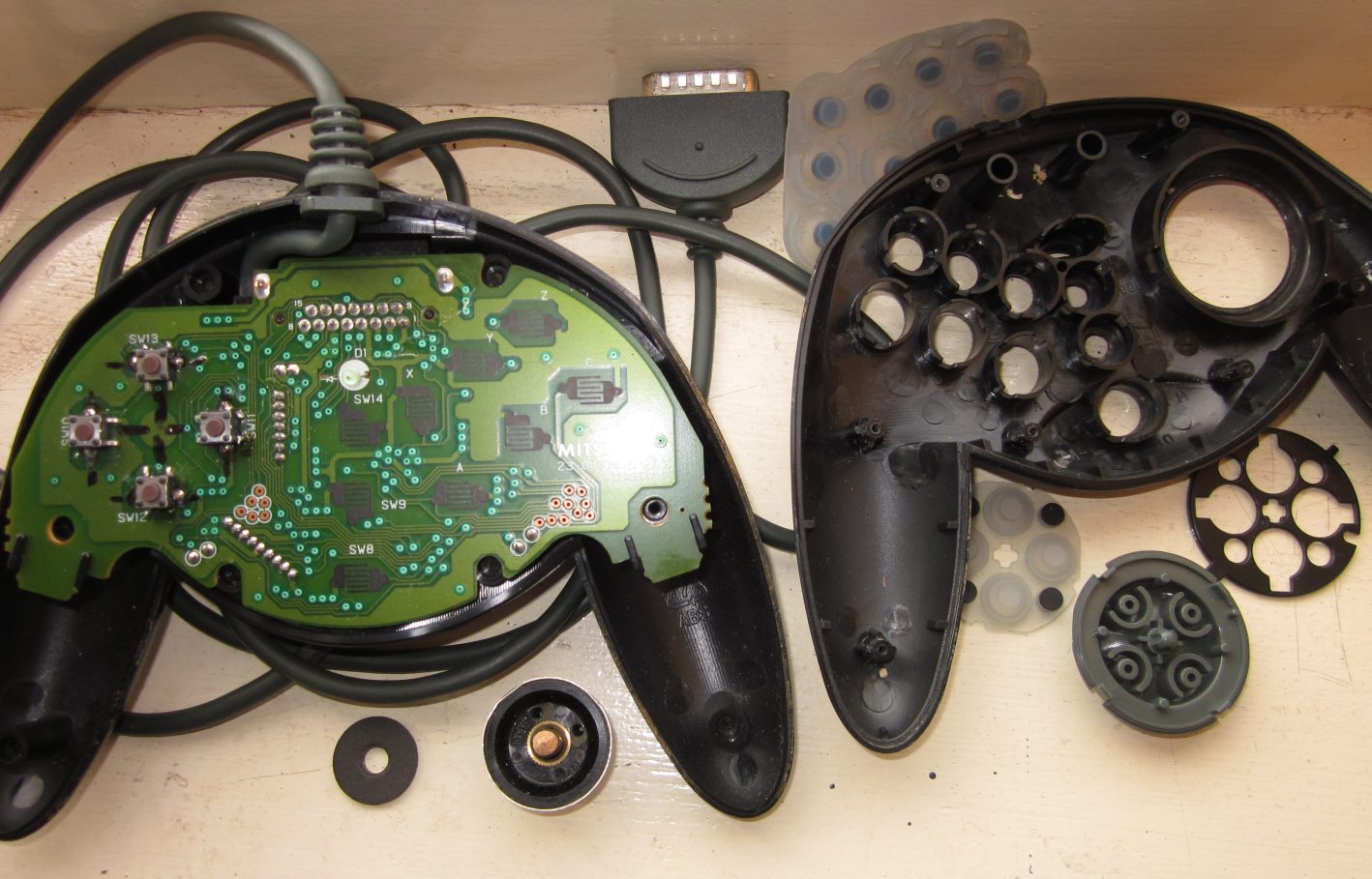

So I potentially sacrificed that old controller of mine. A Sidewinder.
A what? A 1996 Microsoft Sidewinder*. Have actually got another kicking about somehwere.
*funny how the one on wikipedia is knackered, the cord-strain-relief has split
Both should still function but haven't been tested in at least two years, before that I actually had one in use to control my pc with, music, videos, browsing, file organisation, gaming; and all at the same time ofcourse. Different story.

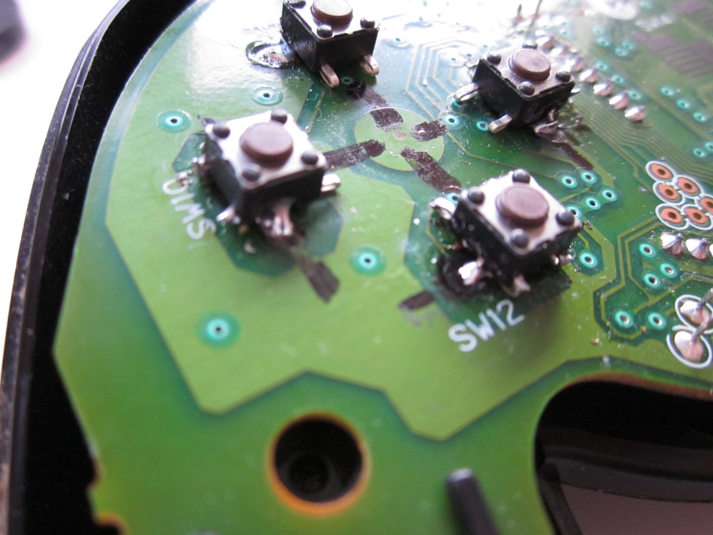

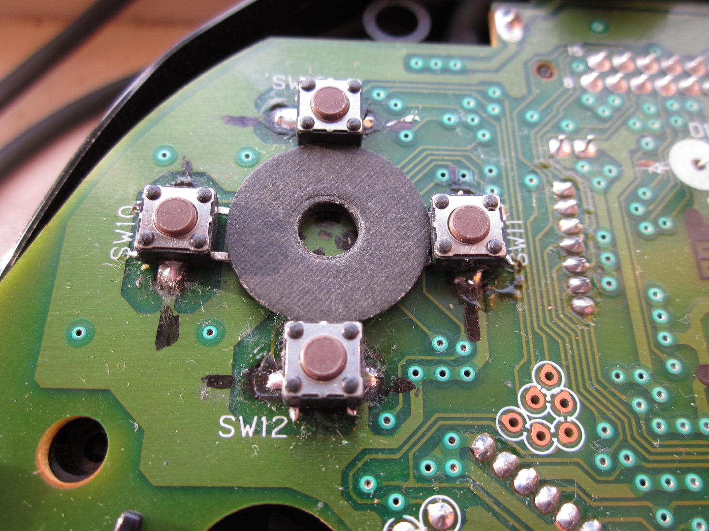

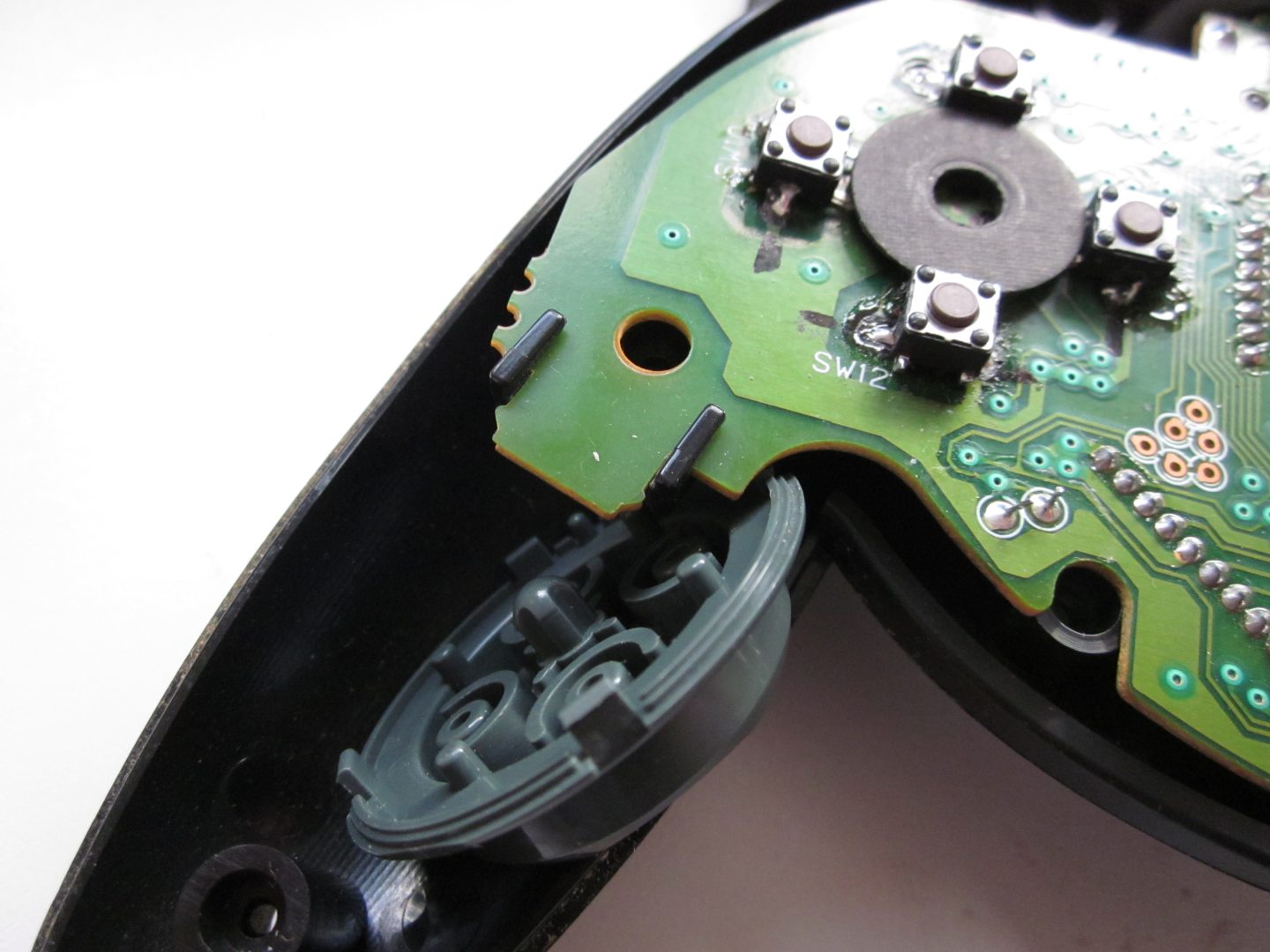

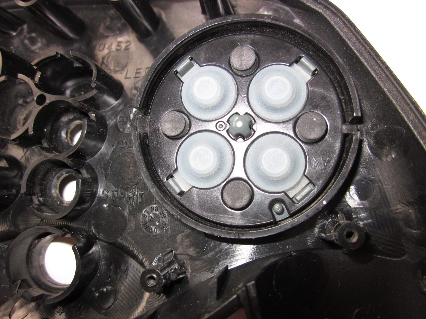

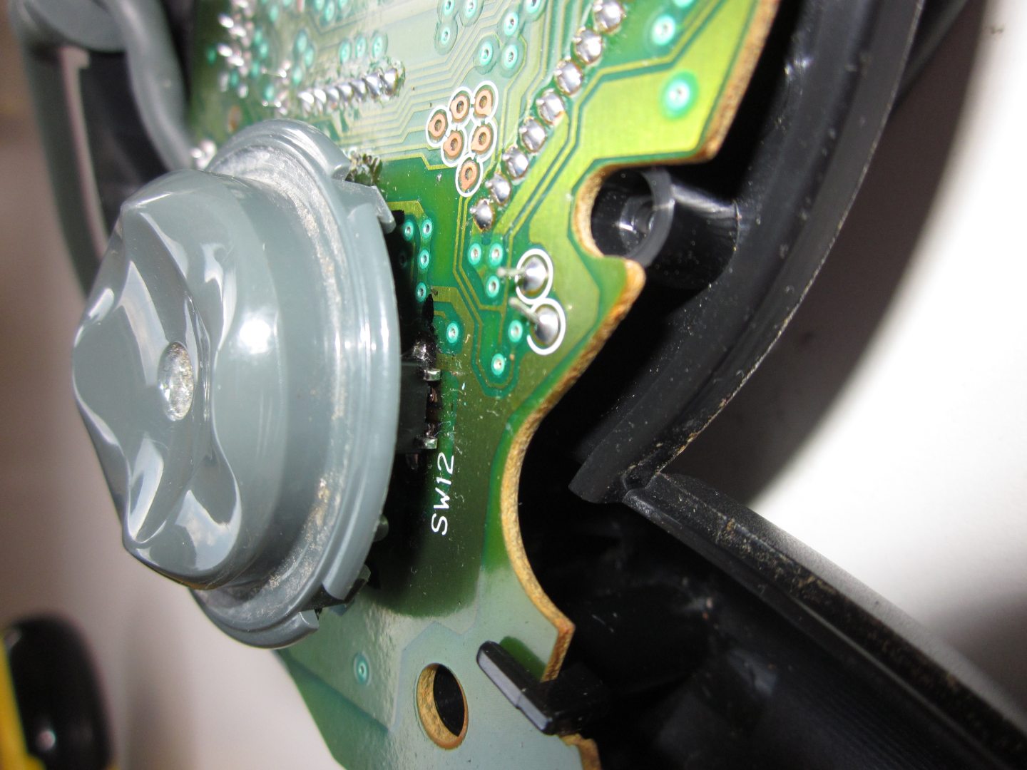

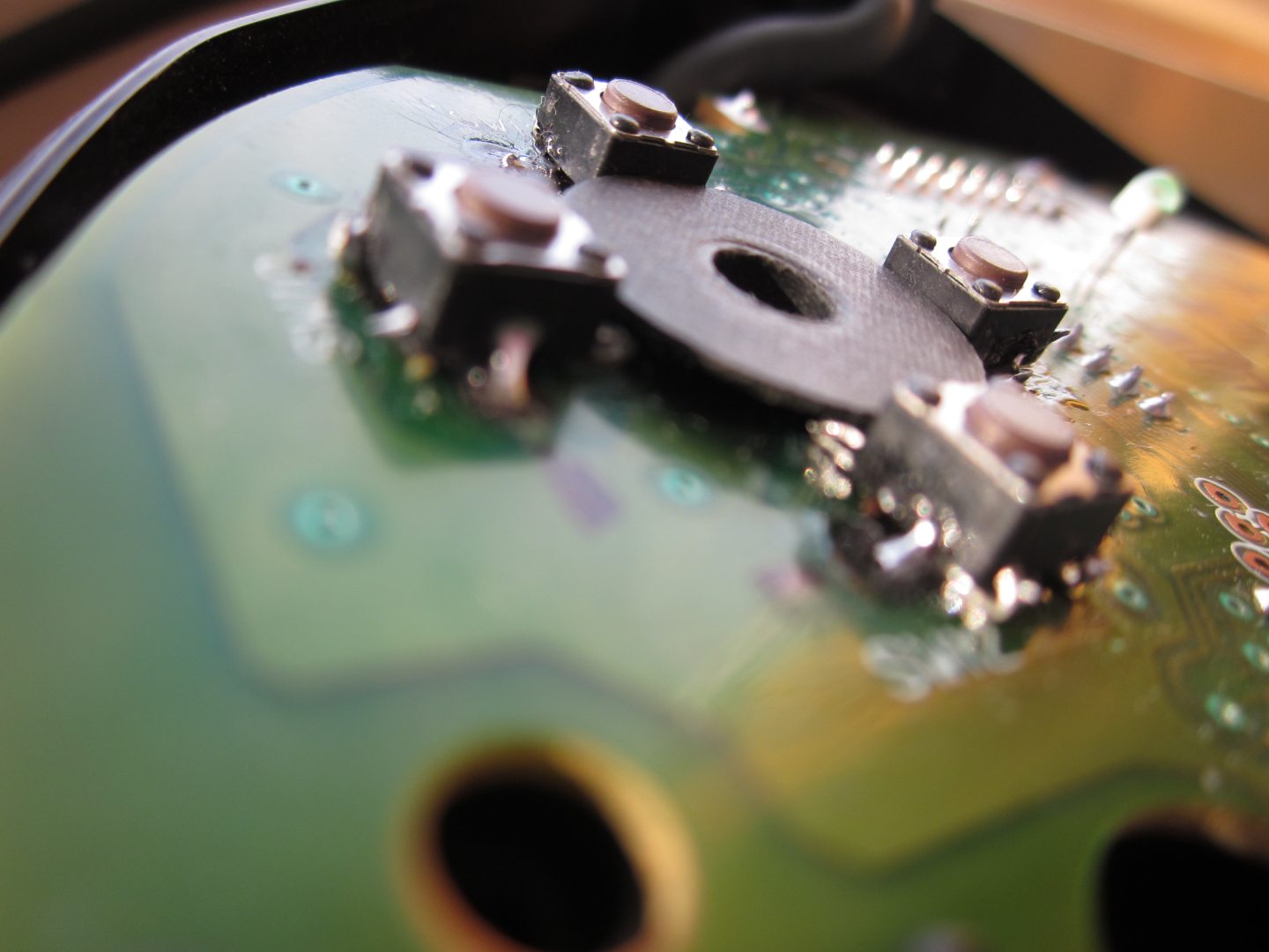

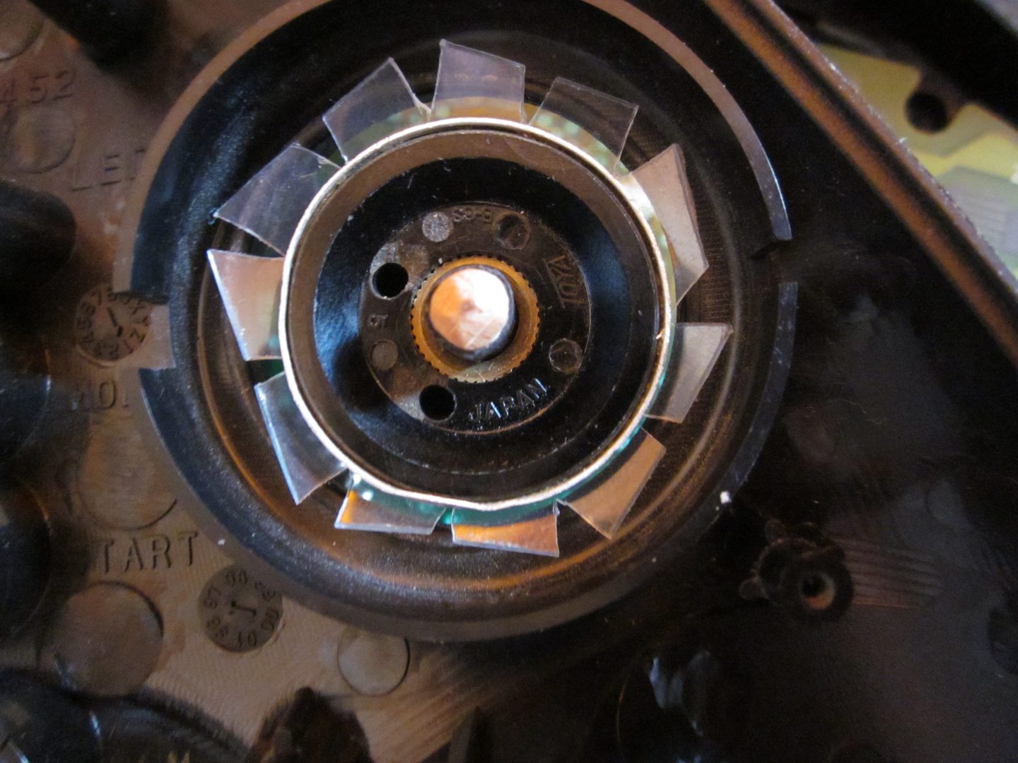

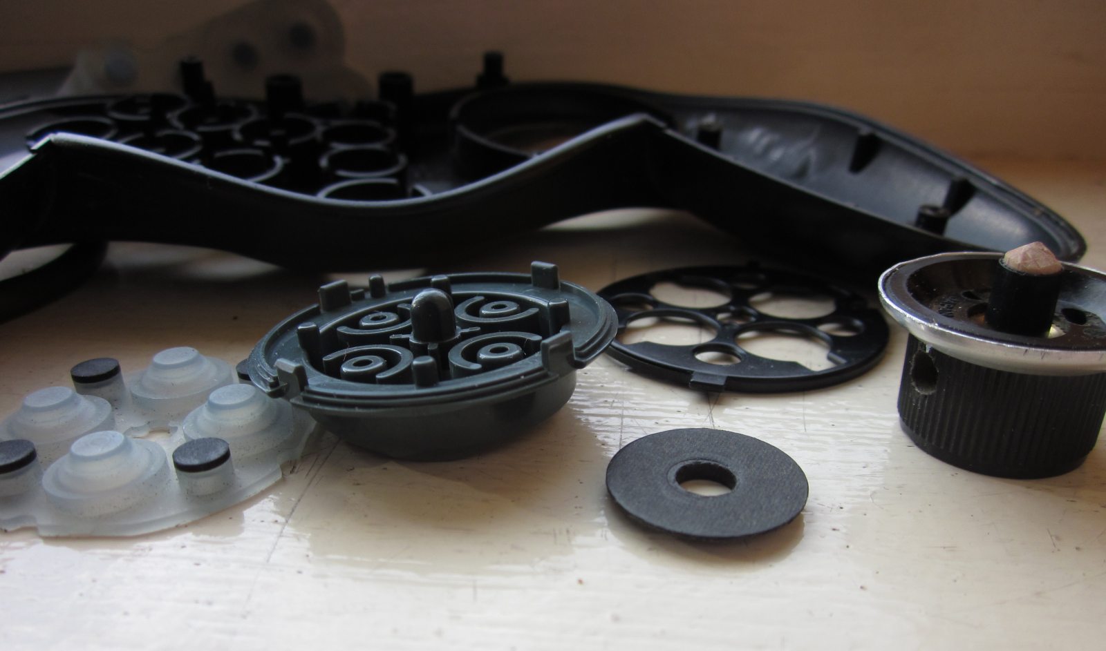

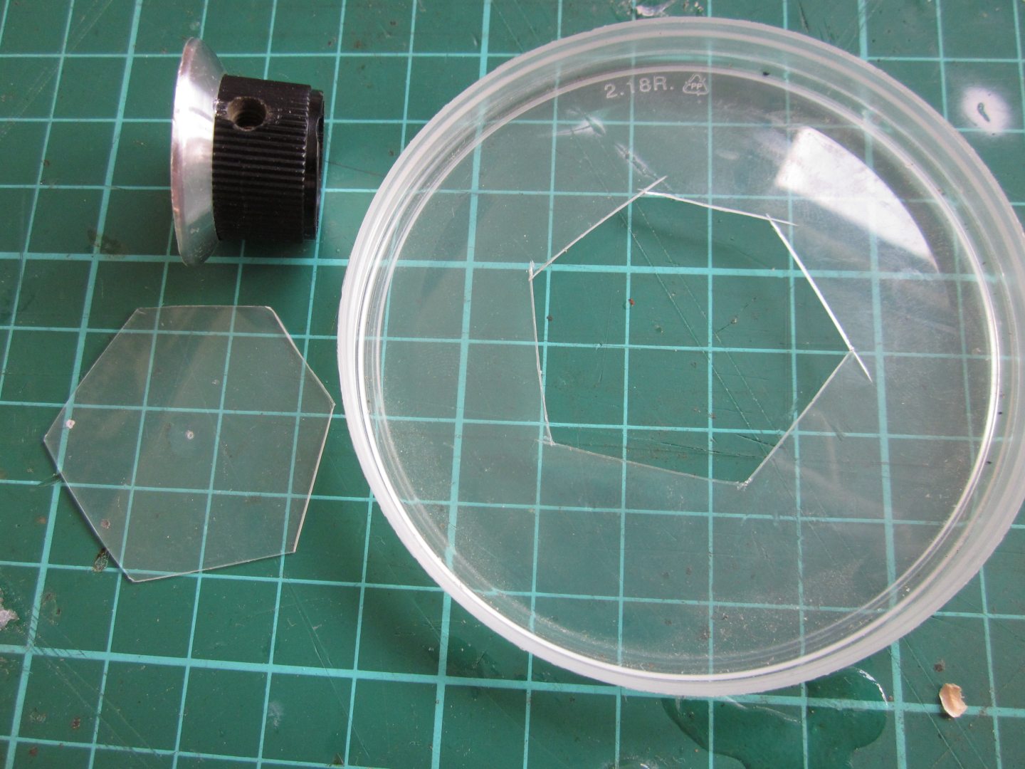

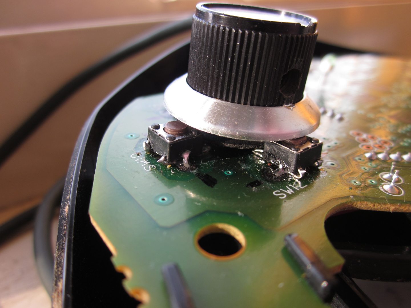

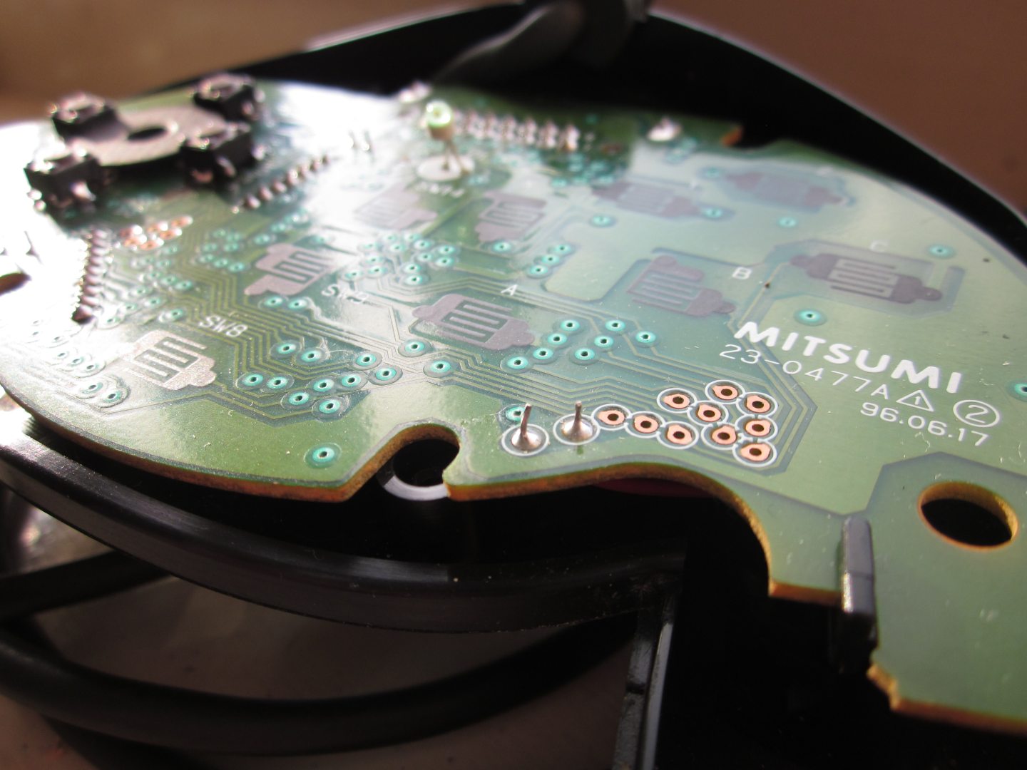

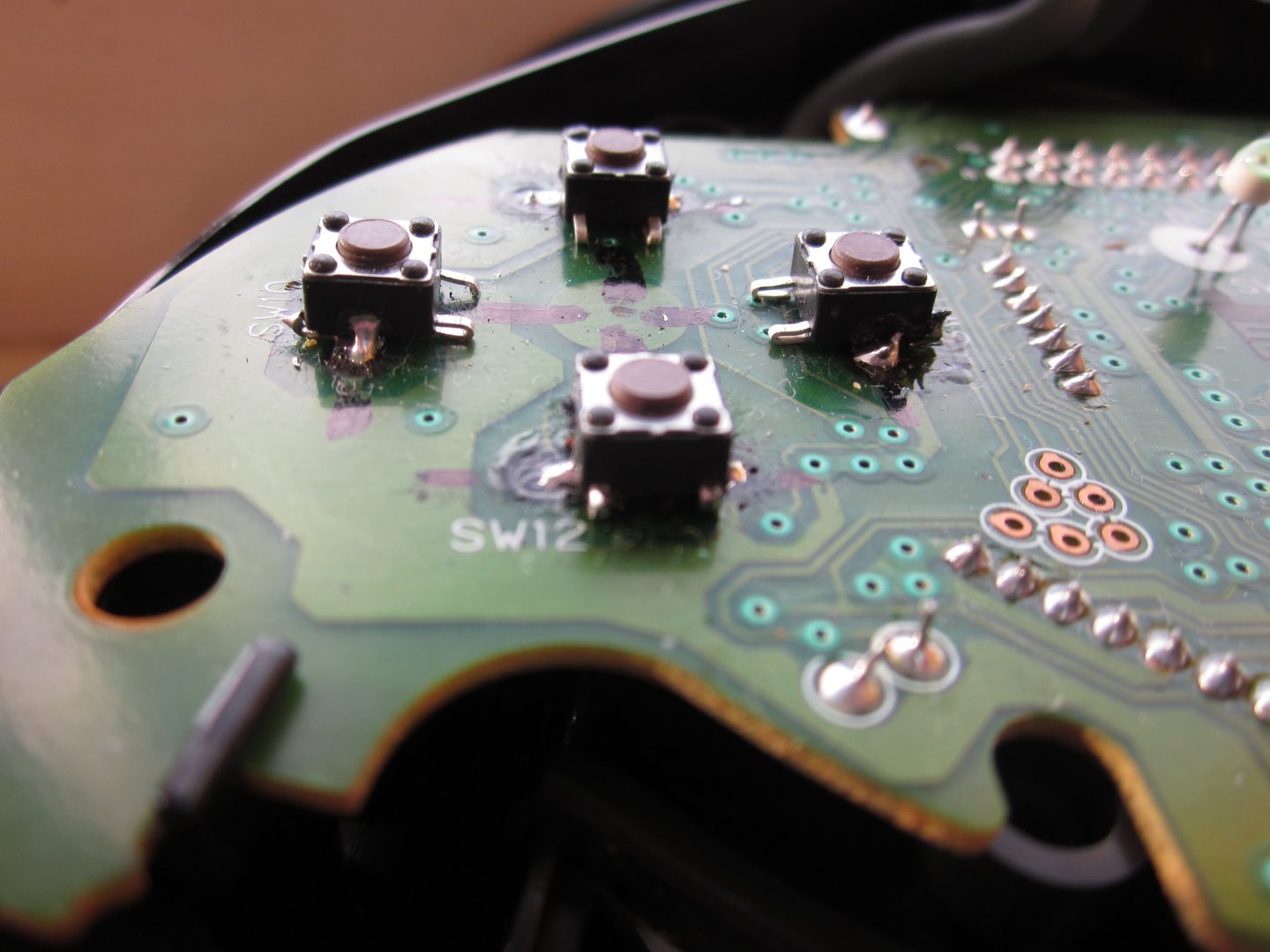

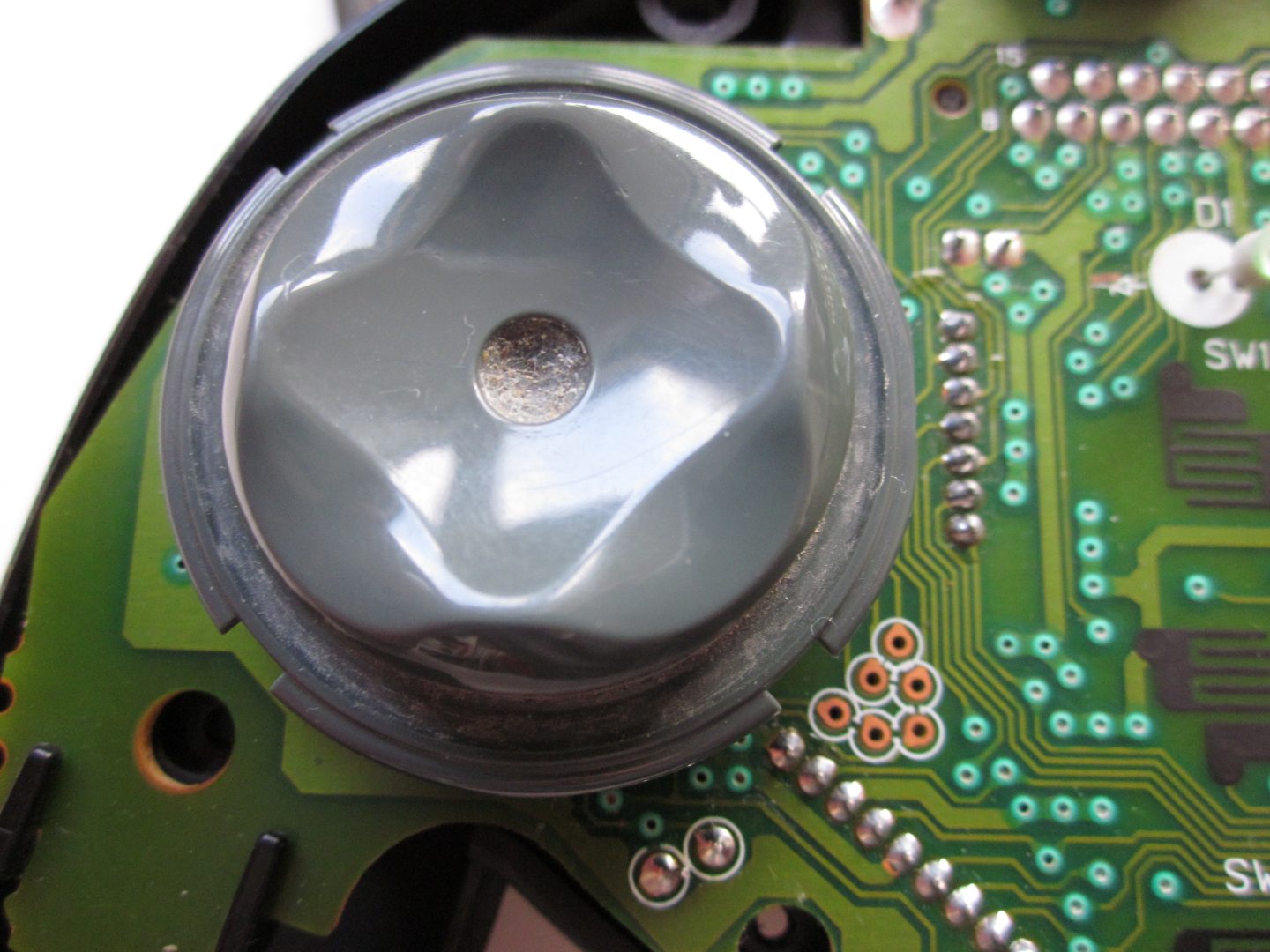

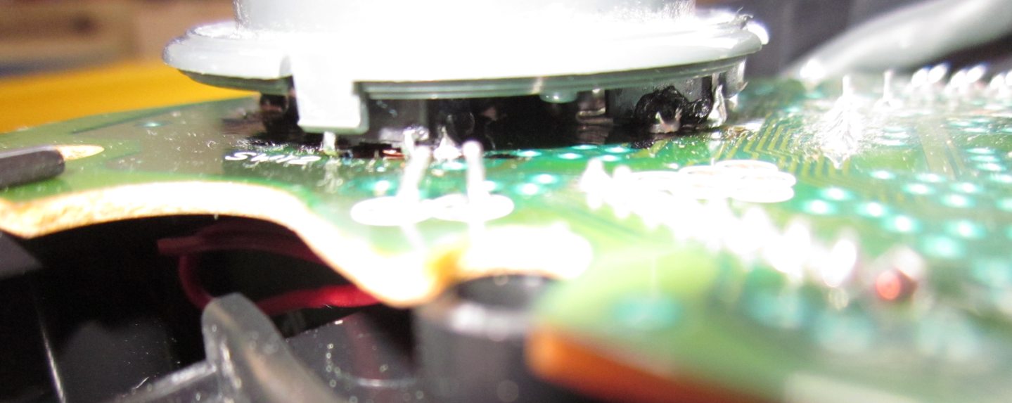

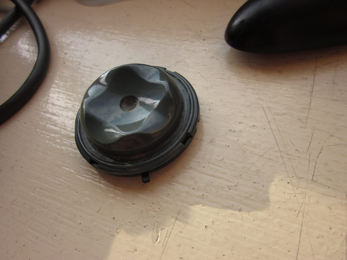

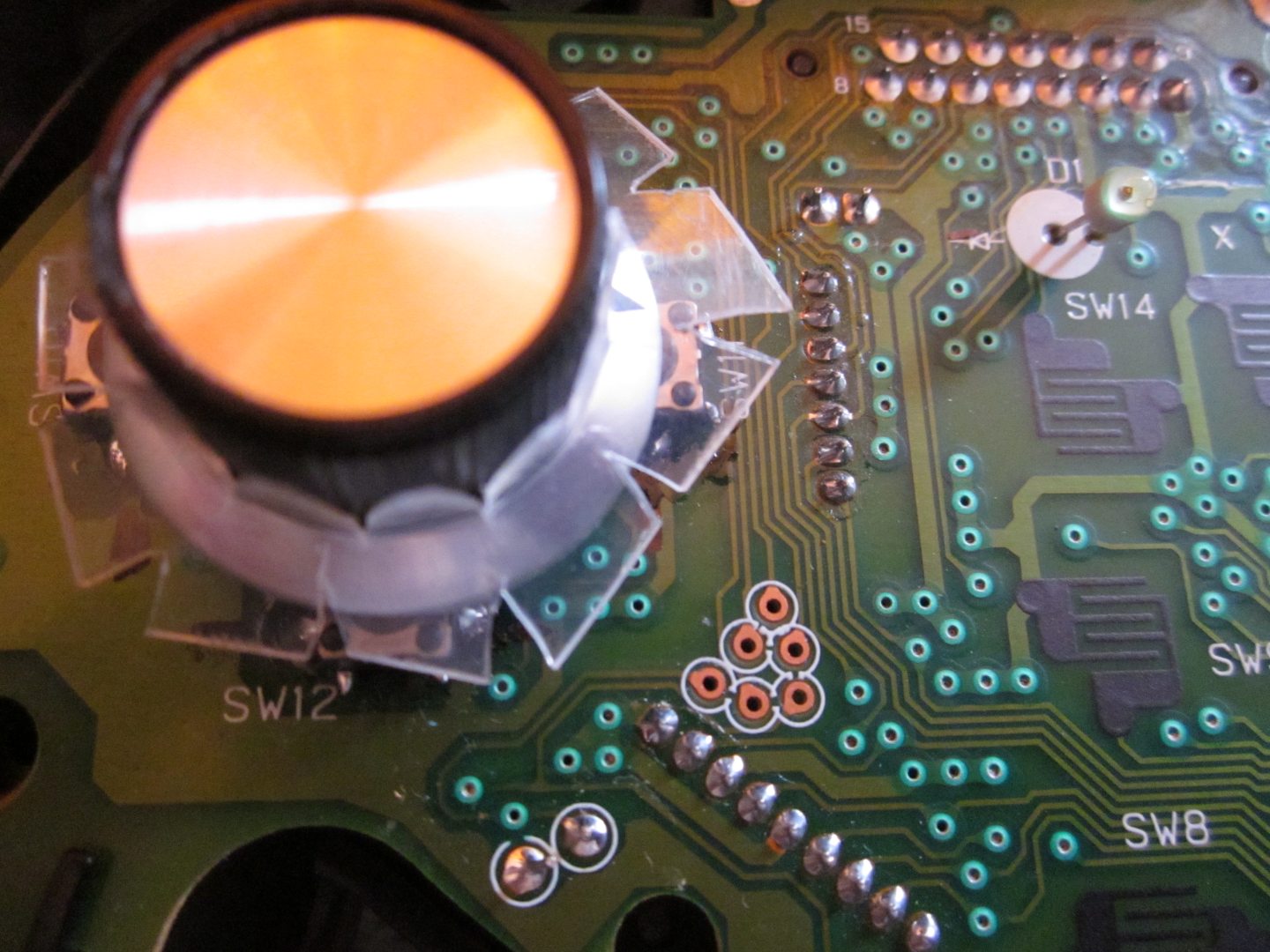

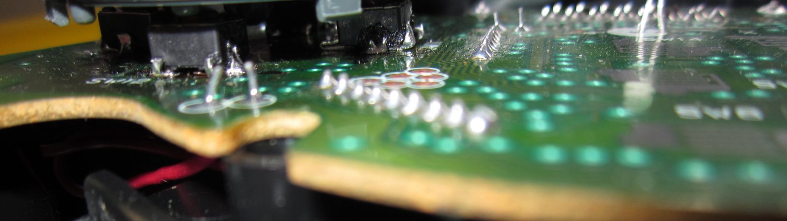

So, I went in on that old boy and soldered four of those same simple MOM/SPST-switches to the four pads that normally make up the D-pad. Ghetto style.

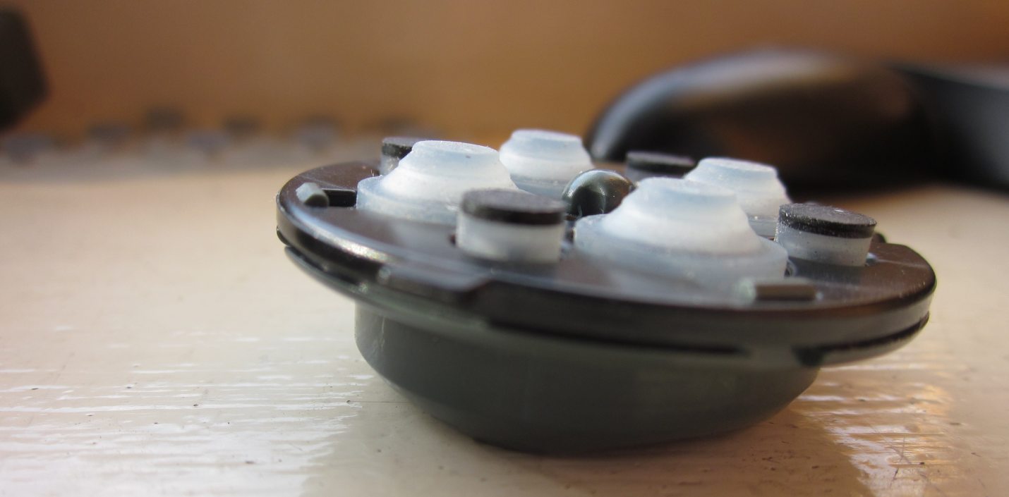

Funky details:
  • _That D-pad uses rubber domes, up side down, attached to the pad not the pcb, to, provide counterforce; nothing to do with actuation, it's just for centering the pad and providing mushyness.
  • _It's made by Mitsubishi. Would not be surprised to find out all those old half-way decent Microsoft peripherals were not even theirs to begin with.
  • _The buttons all have tabs to ensure there is only one way they can fit in only one hole; they must've really thought about how to ensure that even cheap labour kids could put one together flawlessly.
There's more to say, as always, but there's already too much text I take it.
If there's any burning questions, ask; someday you might see a response.
And no, I haven't tested the controller, so it might still be fubar; I went in to judge the feel, and that does seem very decent, although, it can't really be fair judgement on that part. You'll see why.
To actually game with it will take a while, for I'll have to dig up a soundcard from somewhere around here, should still have one with a gameport, and then get that shi to work with Win7 (ppjoy or something) since they ditched support/drivers for gameports afaik. *edit: fyi: no go on win7x64. win7x32 there is an option for.

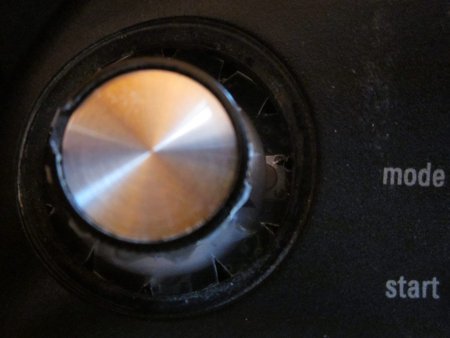

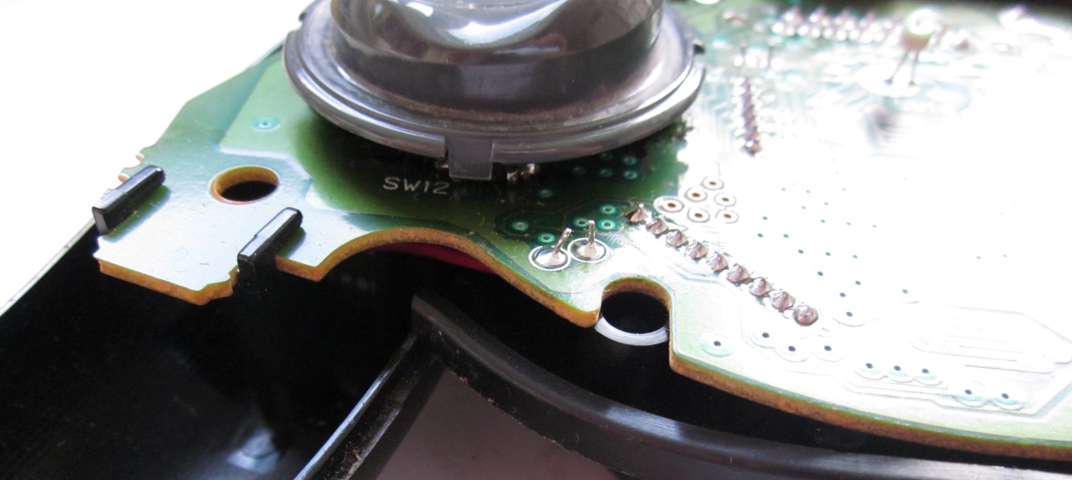

[PICS][FINALLY]
off

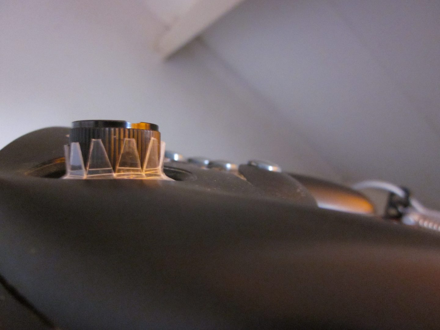

25 Apr 2012, 18:59
[pics][moar]
off

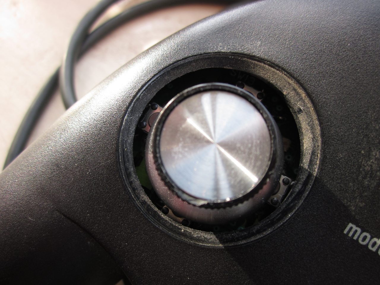

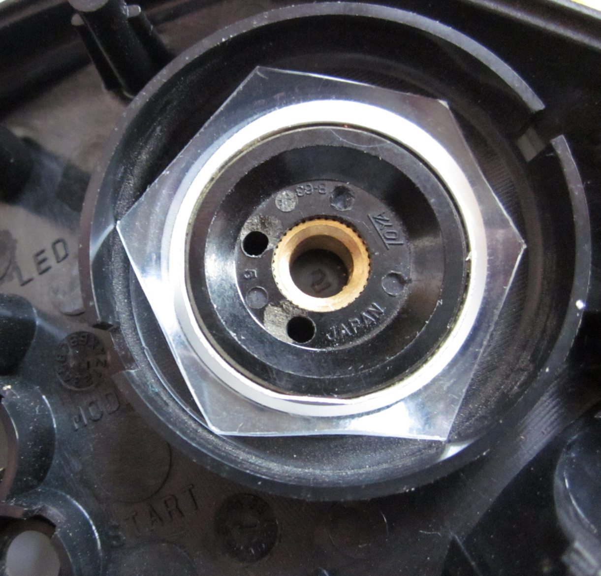

25 Apr 2012, 19:06
[and that's it]

Well it is bloody tall, hence the sideshot to show that off. ;)
But for the little while I've tested it feel-wise, it definitely works clickily, and does not feel awkward!
I really should've extended that wall of text to include wtf I did to end up with what it became, and how I did so, but thought it was enough threadcrap for one session. Basically, original pad wouldn't fit without cutting it up.
But 'pretty' was not what I expected to hear, at all; thanks.

Quite okay that you posted it here! I like the look of the (oven?) knob. New buttons or not, I still terrible at Halo HAHA. Yeah I should have recorded the "clicky" noise of the buttons
