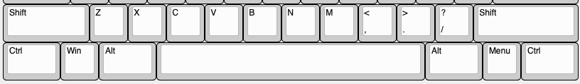

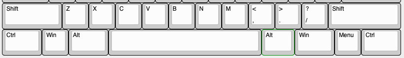

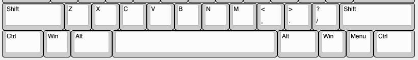

They had every opportunity to fix the bottom row and managed to fail spectacularly. 5.75u space and 1.25u useless key? Come on now. Just ship a 7u space bar option.
What they did: 1.5-1-1.5-5.75-1.25-1.5-1-1.5
What I would have done: 1.5-1-1.5-6-1.5-1-1-1.5
What they still can do: 1.5-1-1.5-7-1.5-1-1.5
01 Jun 2020, 17:25

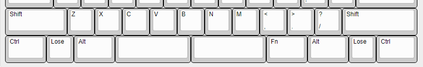

That said, if the space bar is gonna be split, then this should objectively, unquestionably (YMMV) be what must be done:
1.5/1/1.5 / 2.75/2.75 / 1.5 / 1.5/1/1.15
And if they come to me and say "But we don't produce the WheelWriter's Code key anymore!", I'll say, "Well, start producing it again!"
