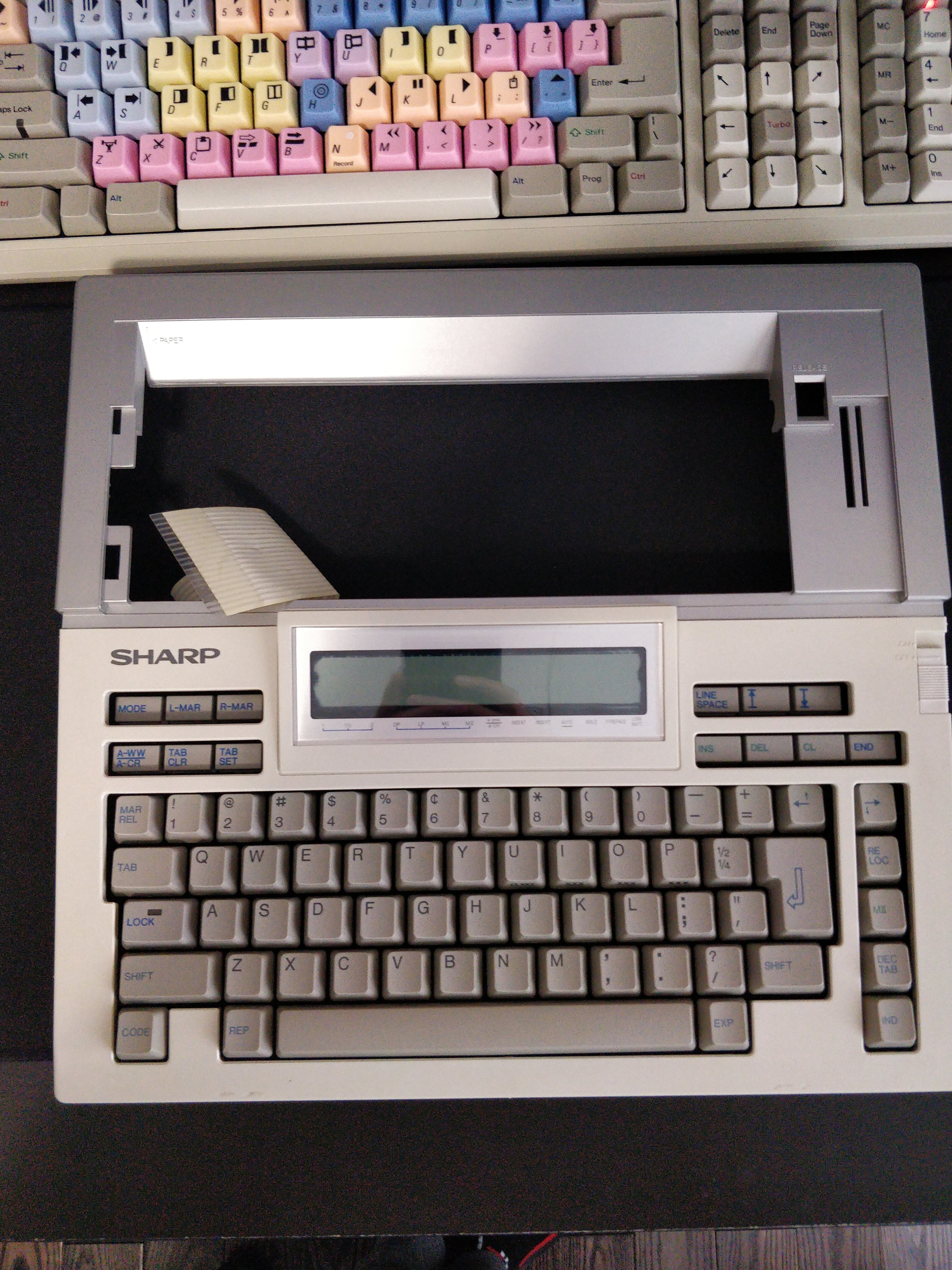

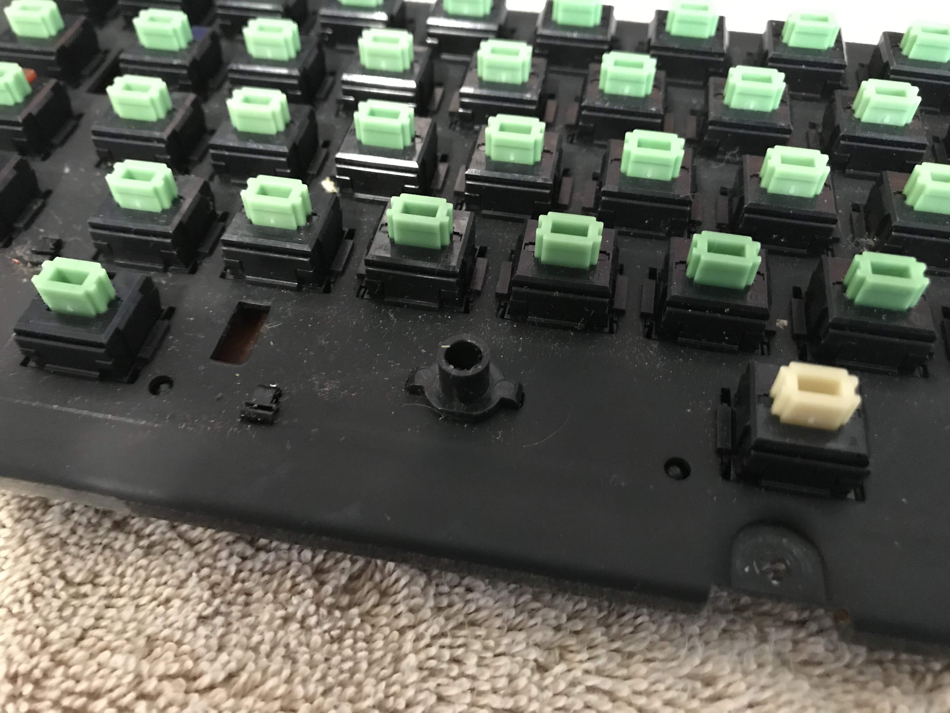

I bought a Sharp PA1000H on ebay and it turned out to be a great buy. It has green Alps as I expected, but these things are fucking mint. I will go as far as to say that they are as NOS as you can get without being NOS. They fell unused.
Plate before just a super light dusting (yes, this is exactly how I found them; they're that clean):
After light dusting:

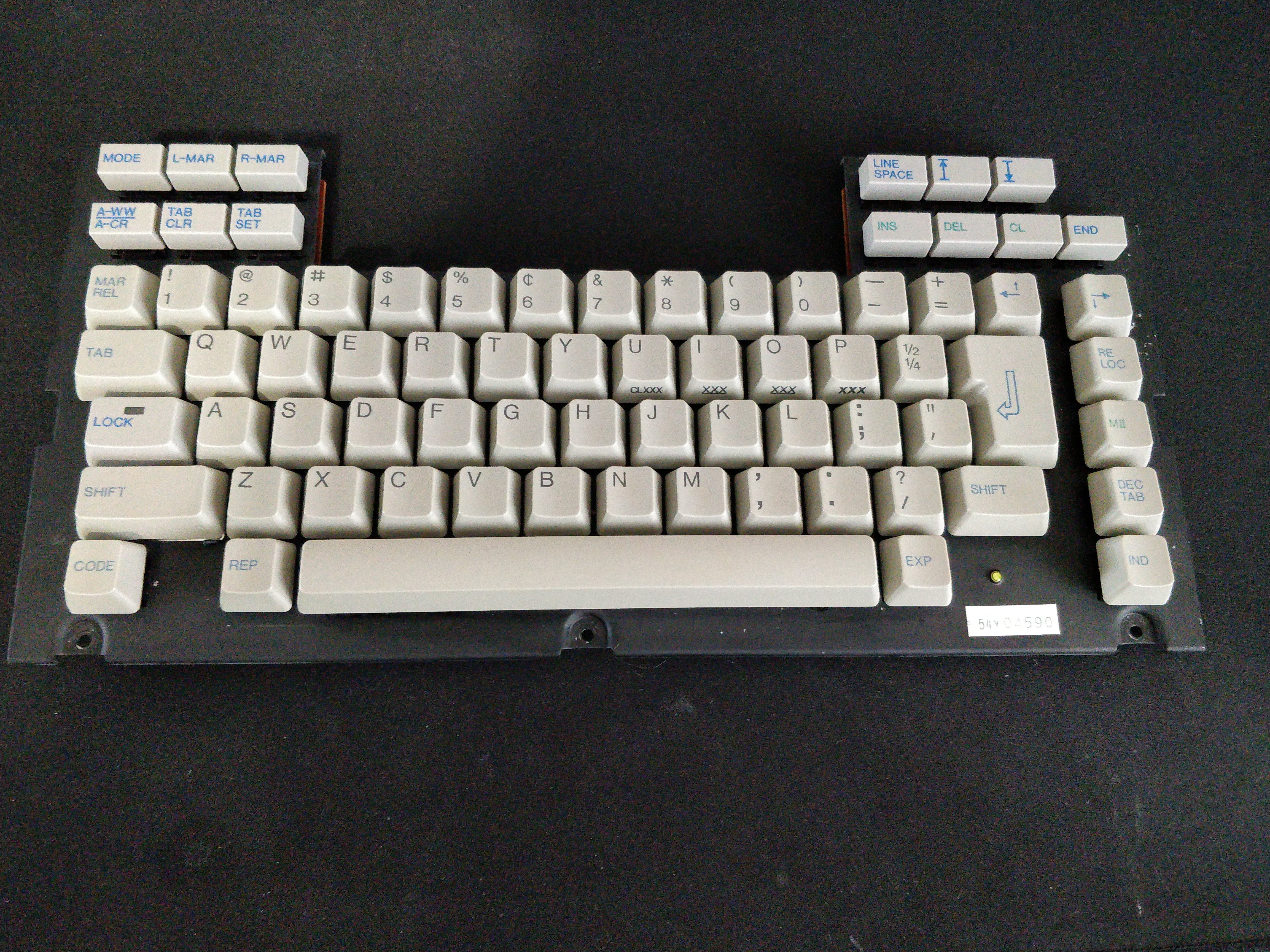

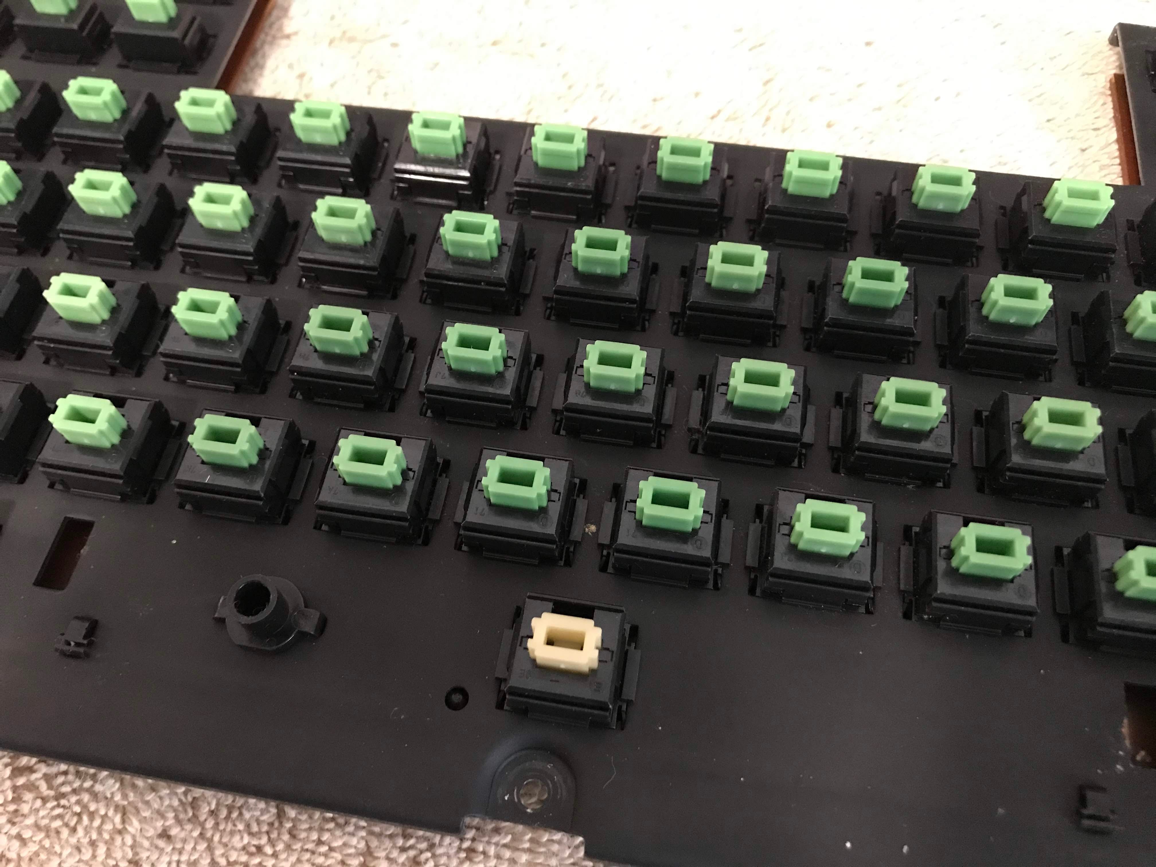

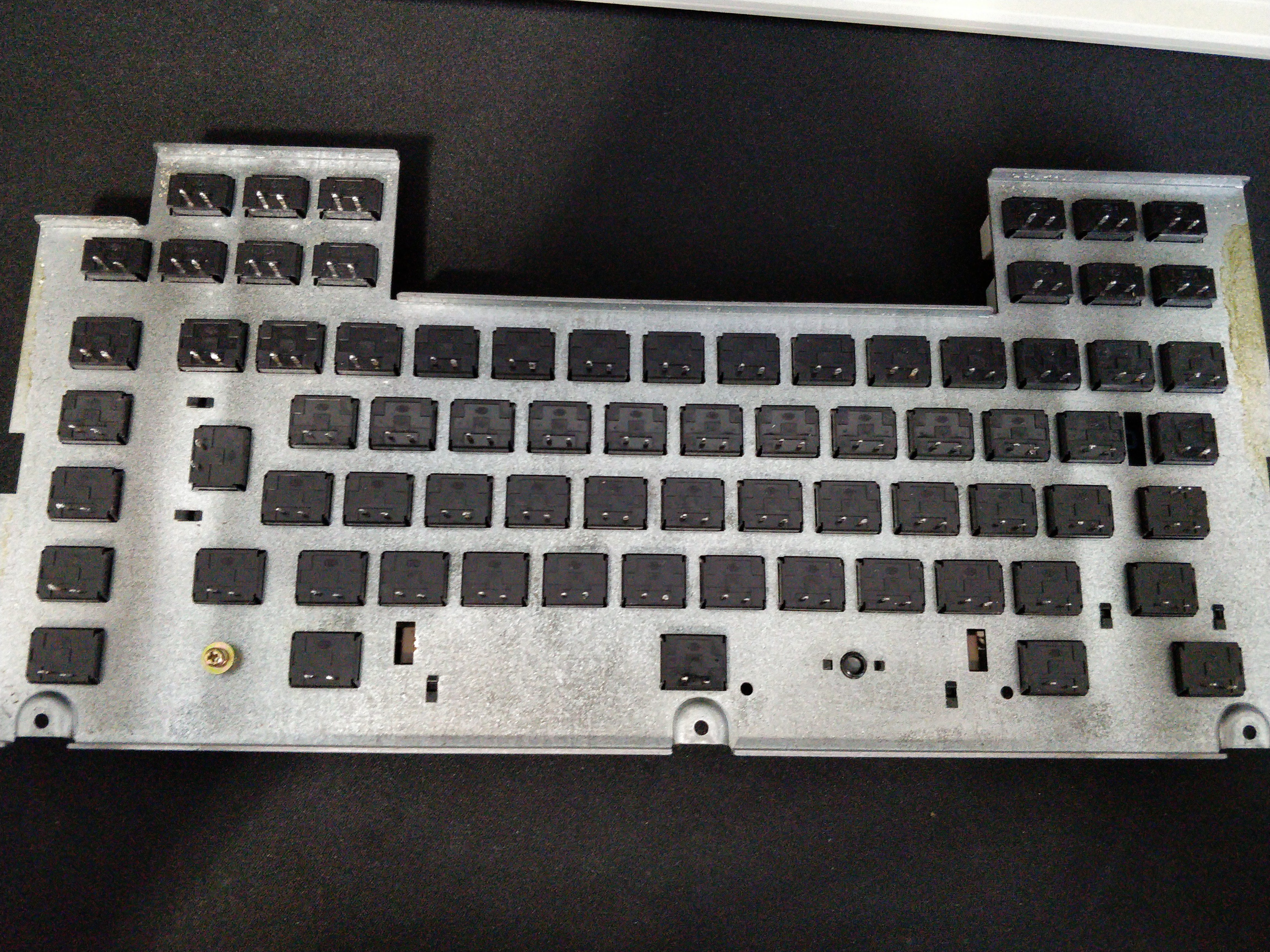

Keyboard module:
Gorgeous Alps doubleshots with really nice colours:

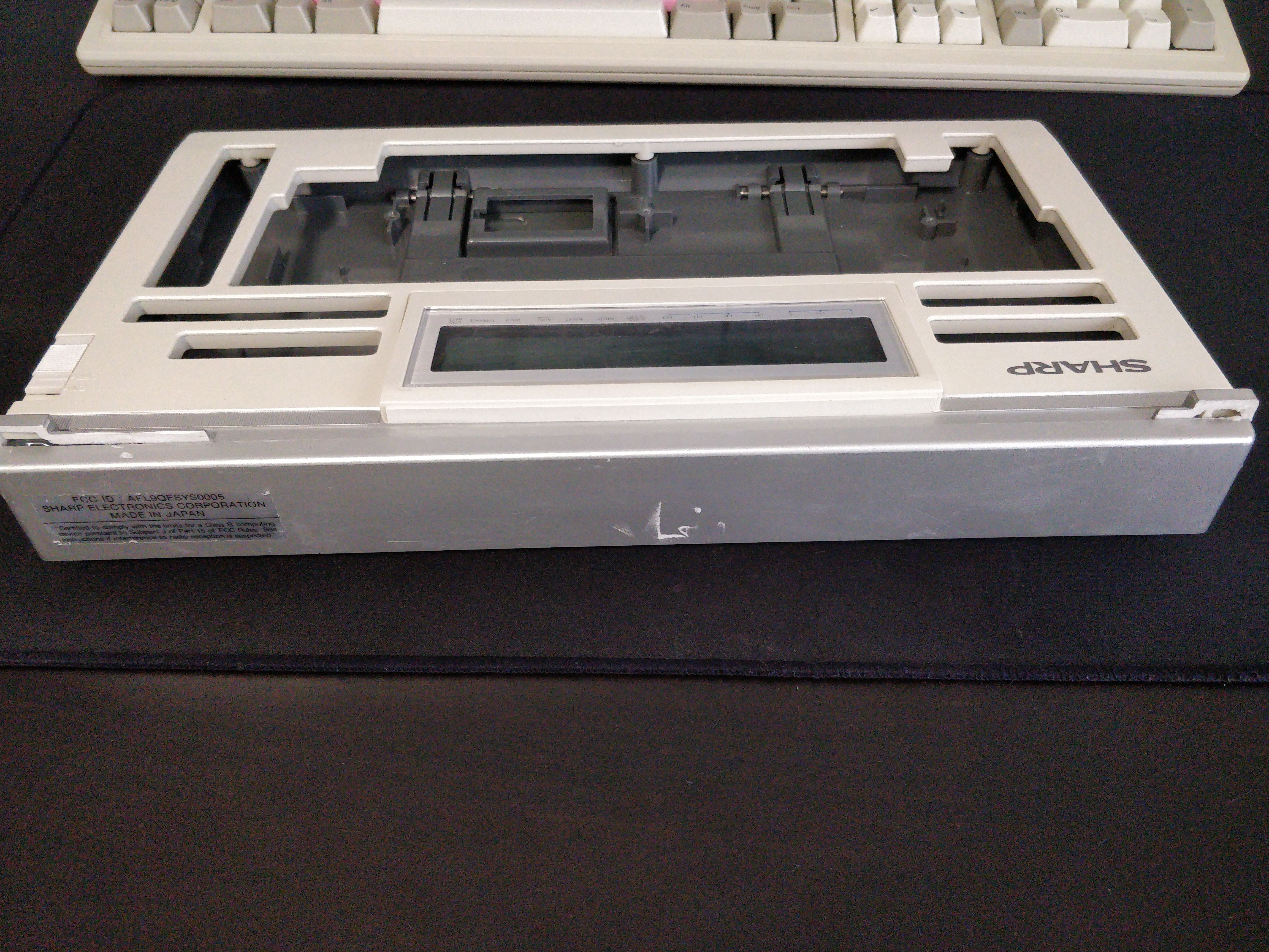

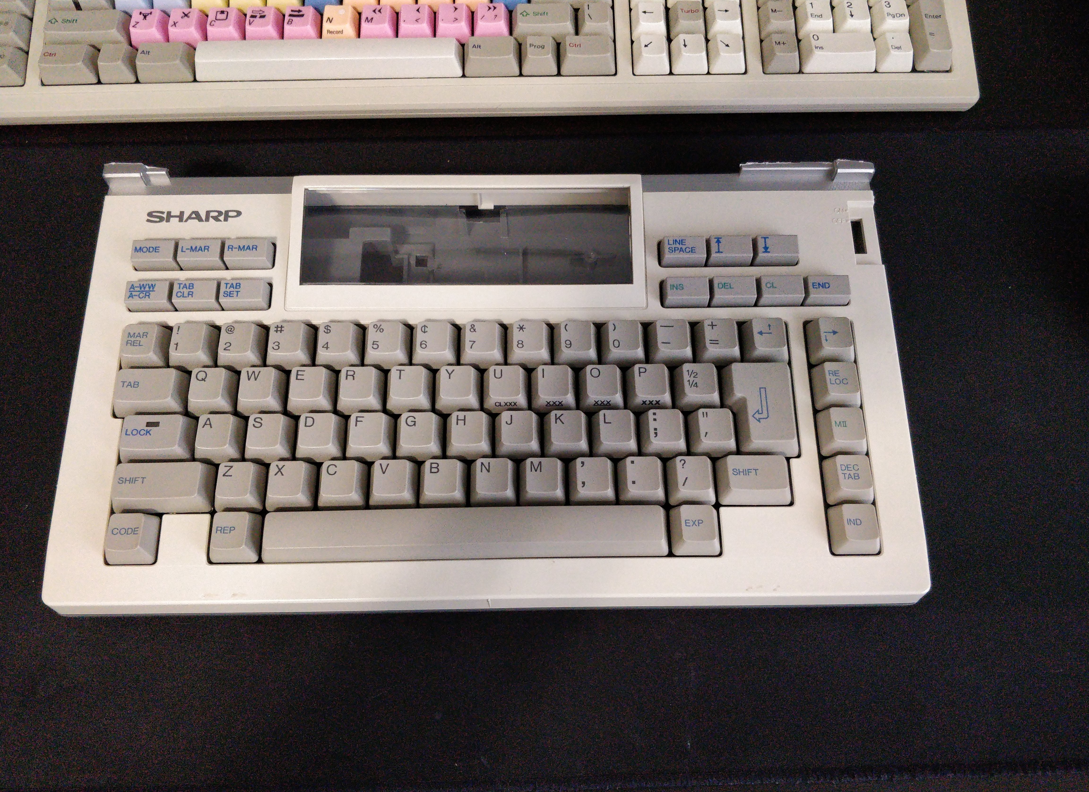

I decided to cut the printer part of the case off as I have no use for it and it made the whole unit unecessarily long.
Before:
After:
Sanded and cut blanking plate from the rest of the plastic. Doesn't look the best from the back or bottom but looks fine from the front and works well.

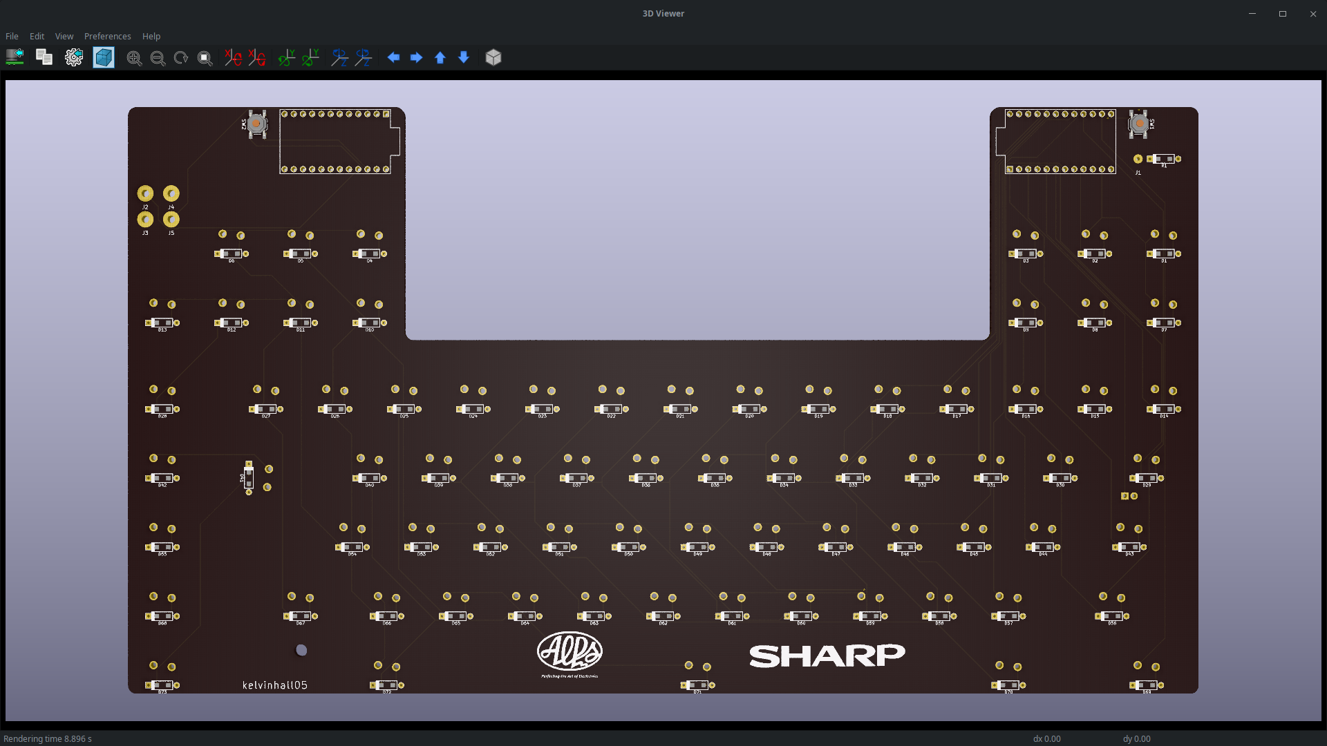

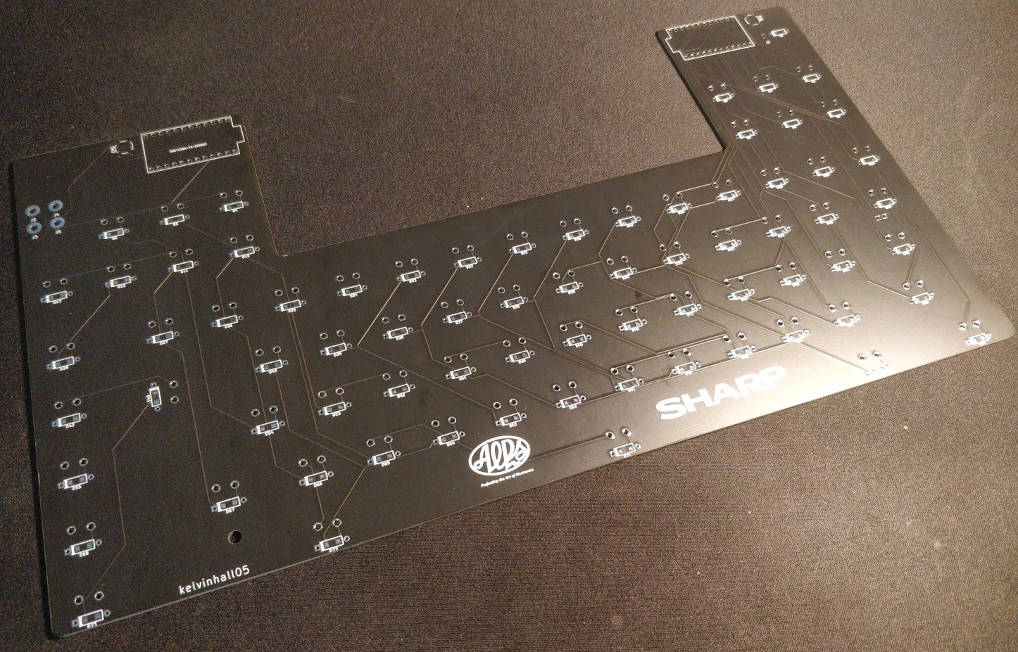

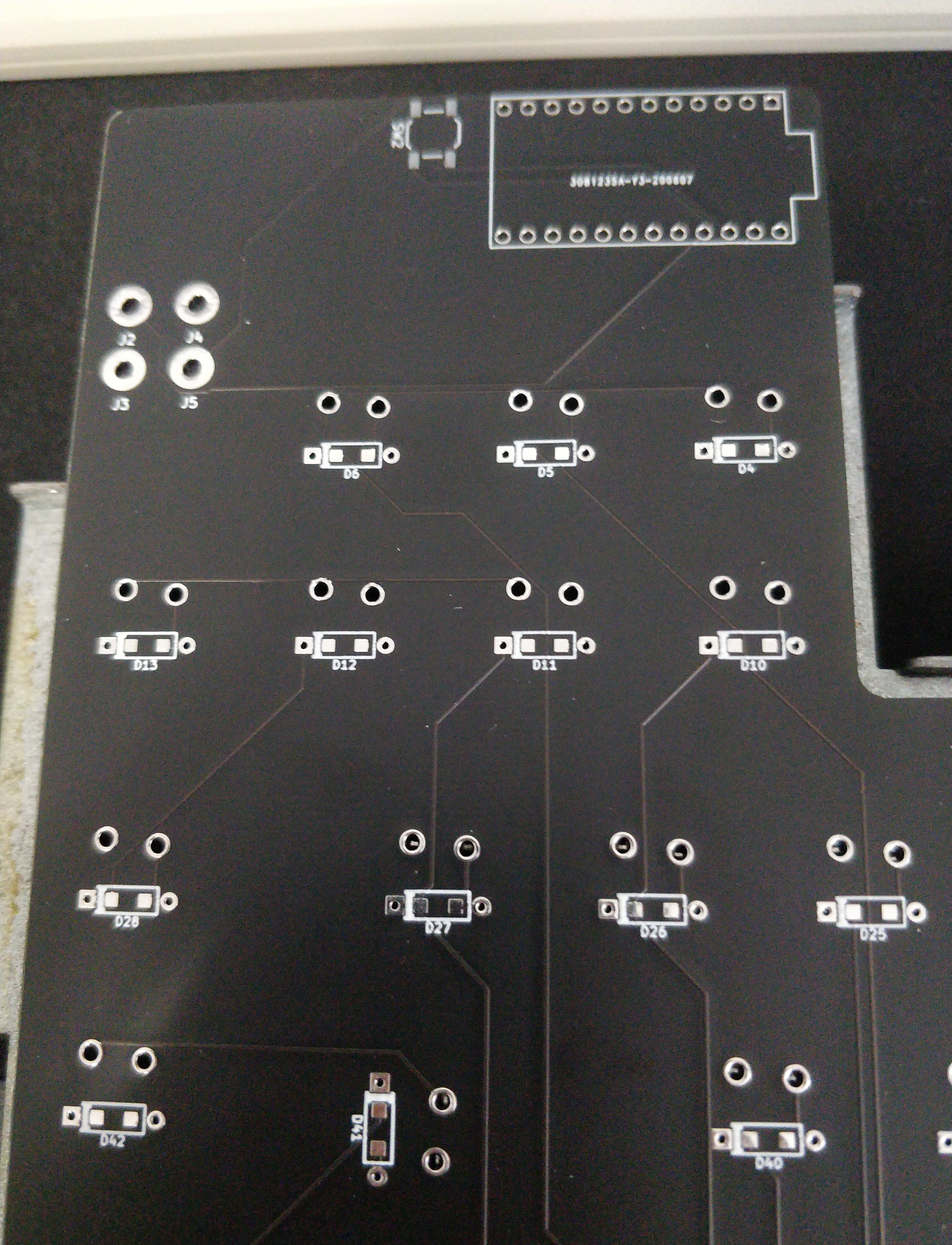

I made a PCB for it as it's the easiest way to get everything I want wired up, it'll be nice and neat to wire everything up. Still in production but here is a render:
Screen Capture_kicad_20200606100019.png (704.13 KiB) Viewed 11218 times

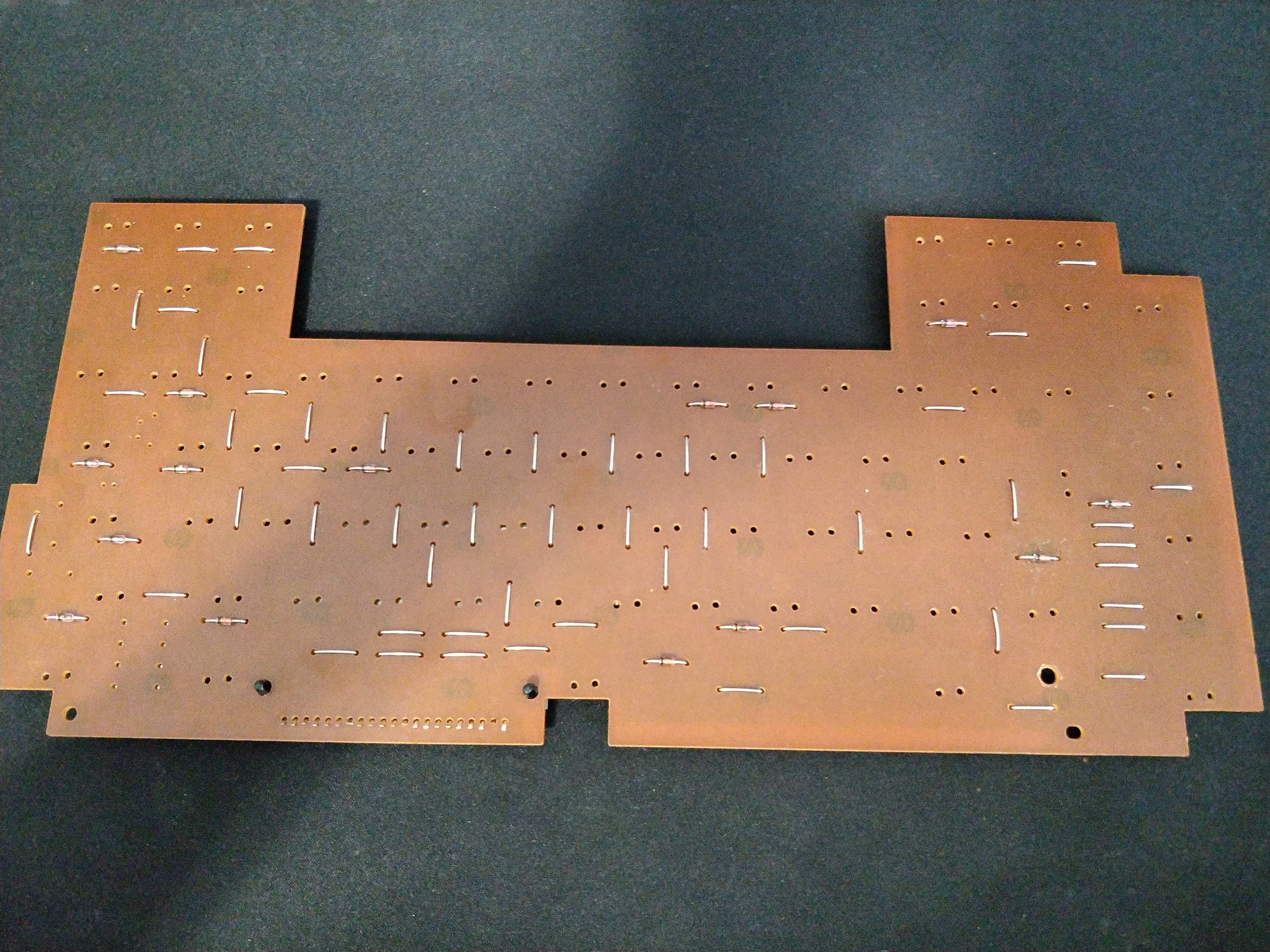

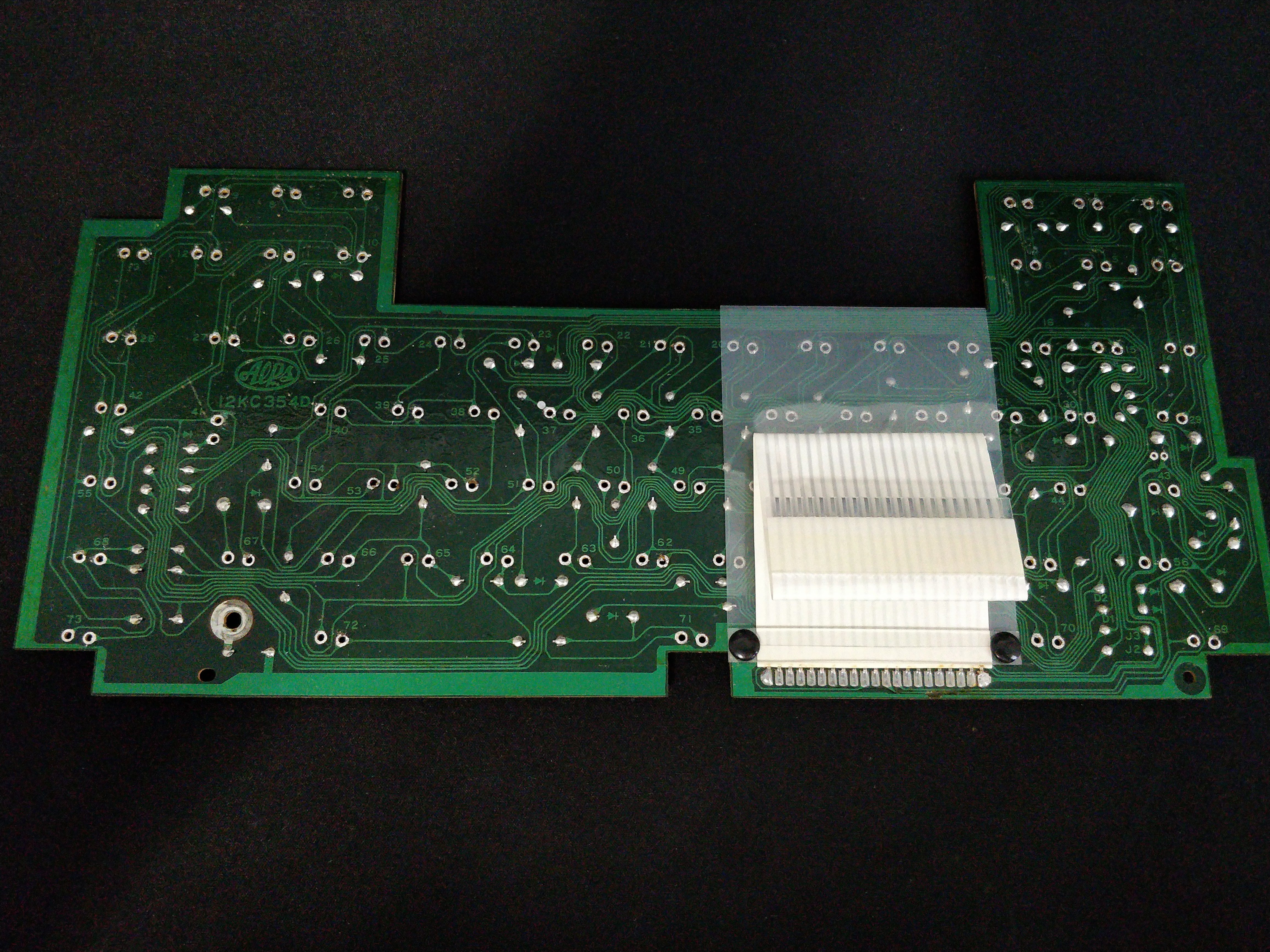

Old PCB desoldered:

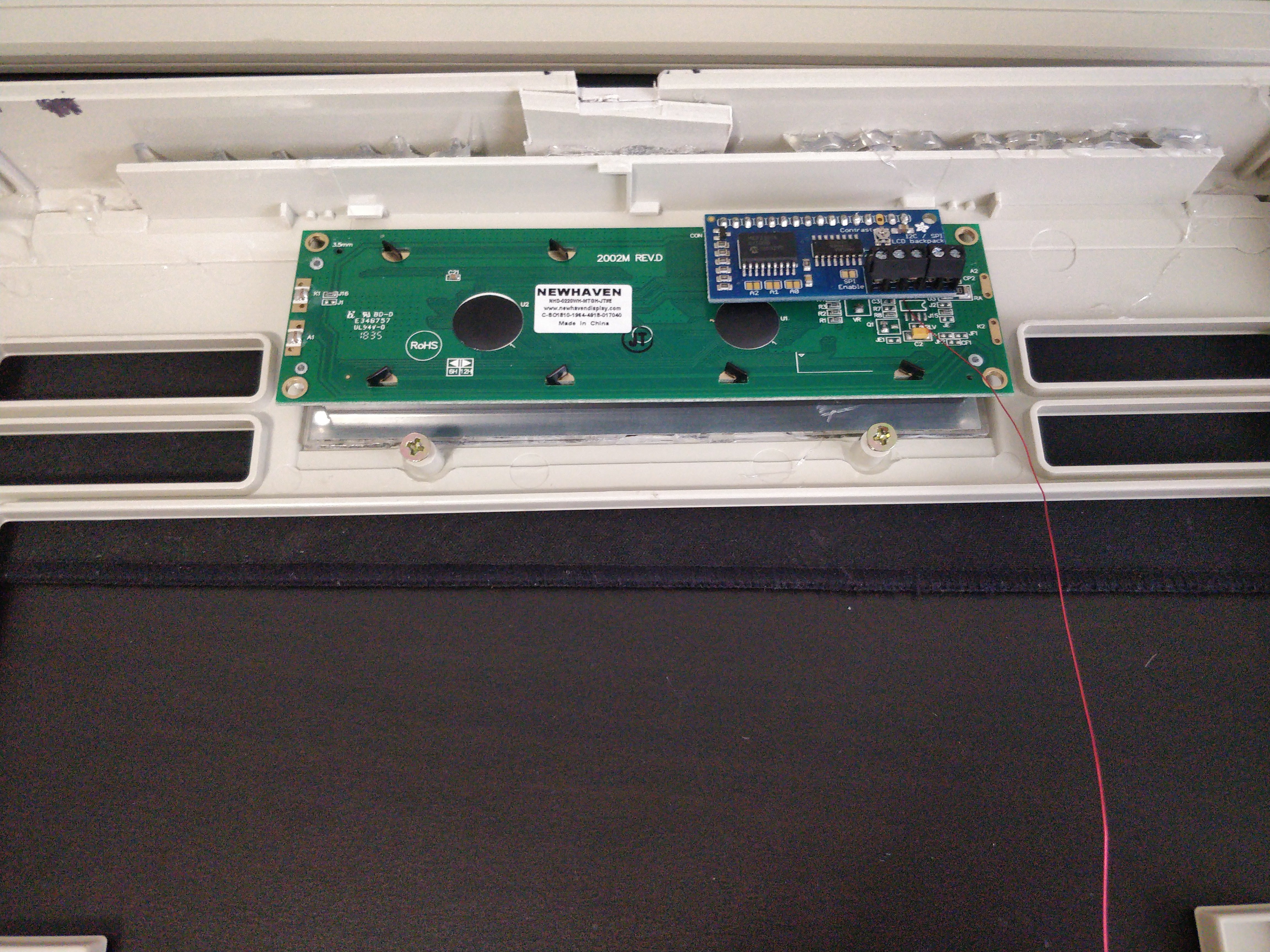

Digikey order arrived just now. Everything looks good. LCD viewing area is almost perfect, only about a mm too small on the sides. It's fine, I won't notice it.
This one is a lot thicker than the old one. Will have to make some kind of bracket to hold it, maybe use part of the old LCD's PCB.

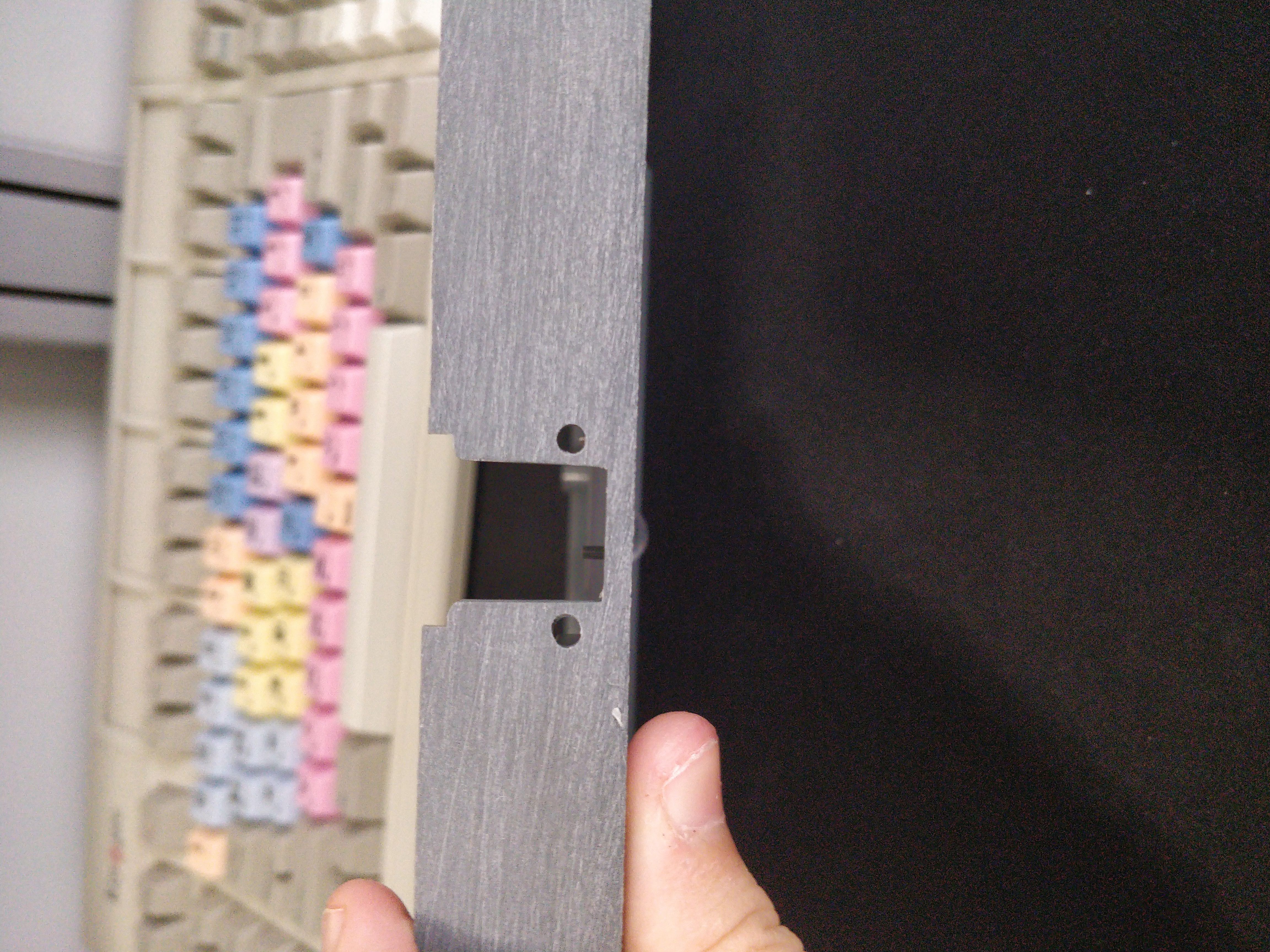

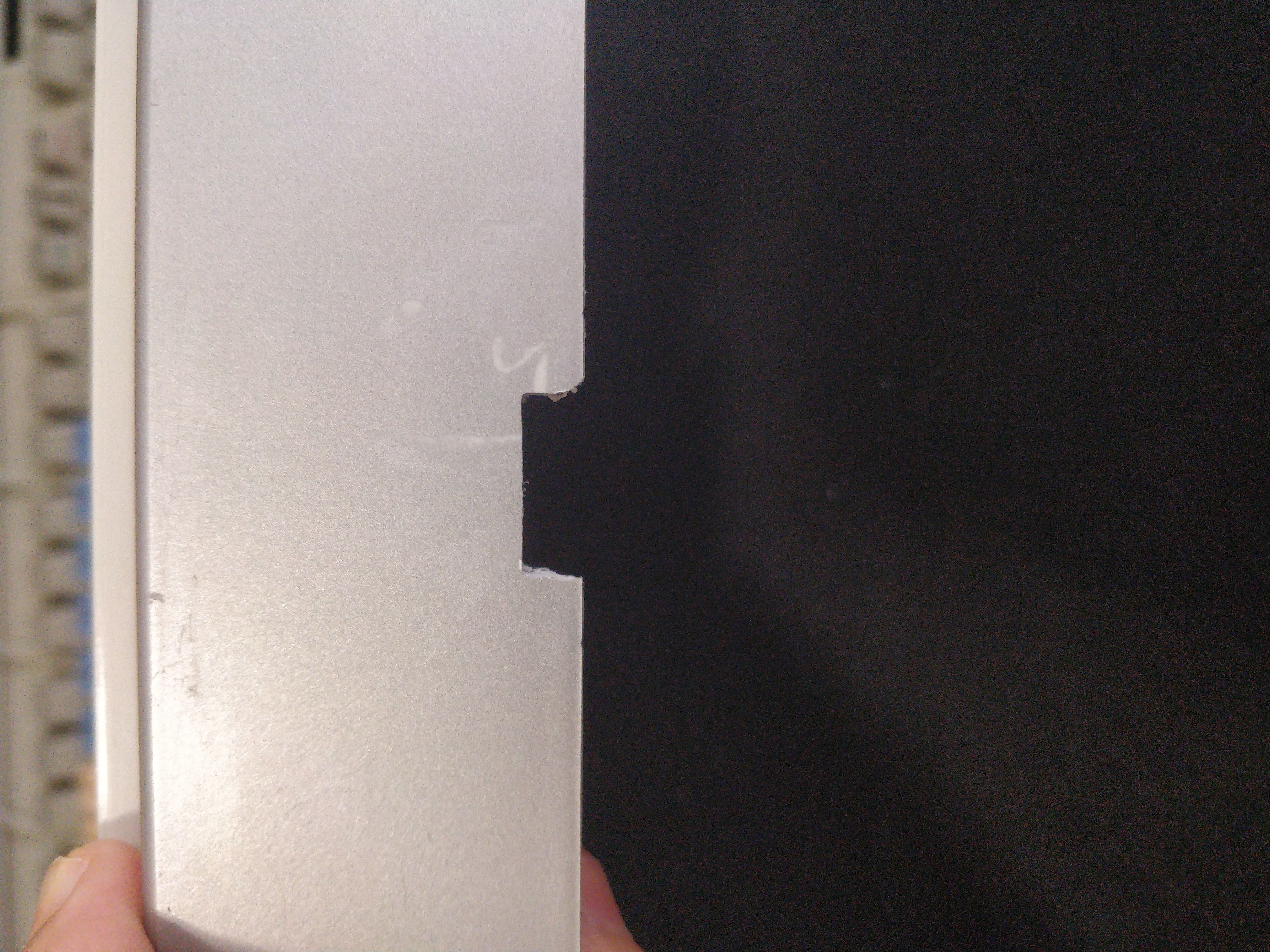

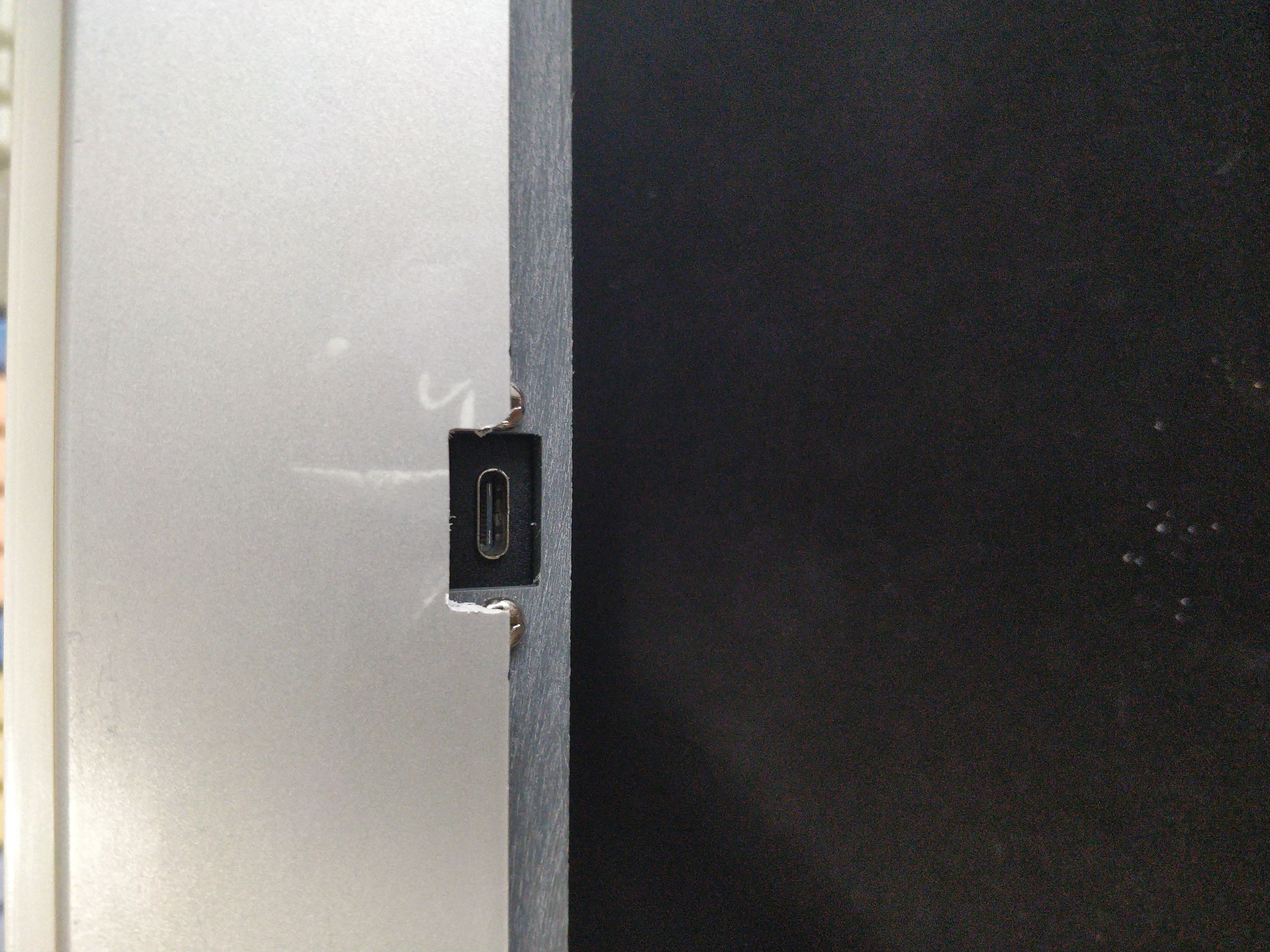

USB port holes/cutout drilled and port mounted:

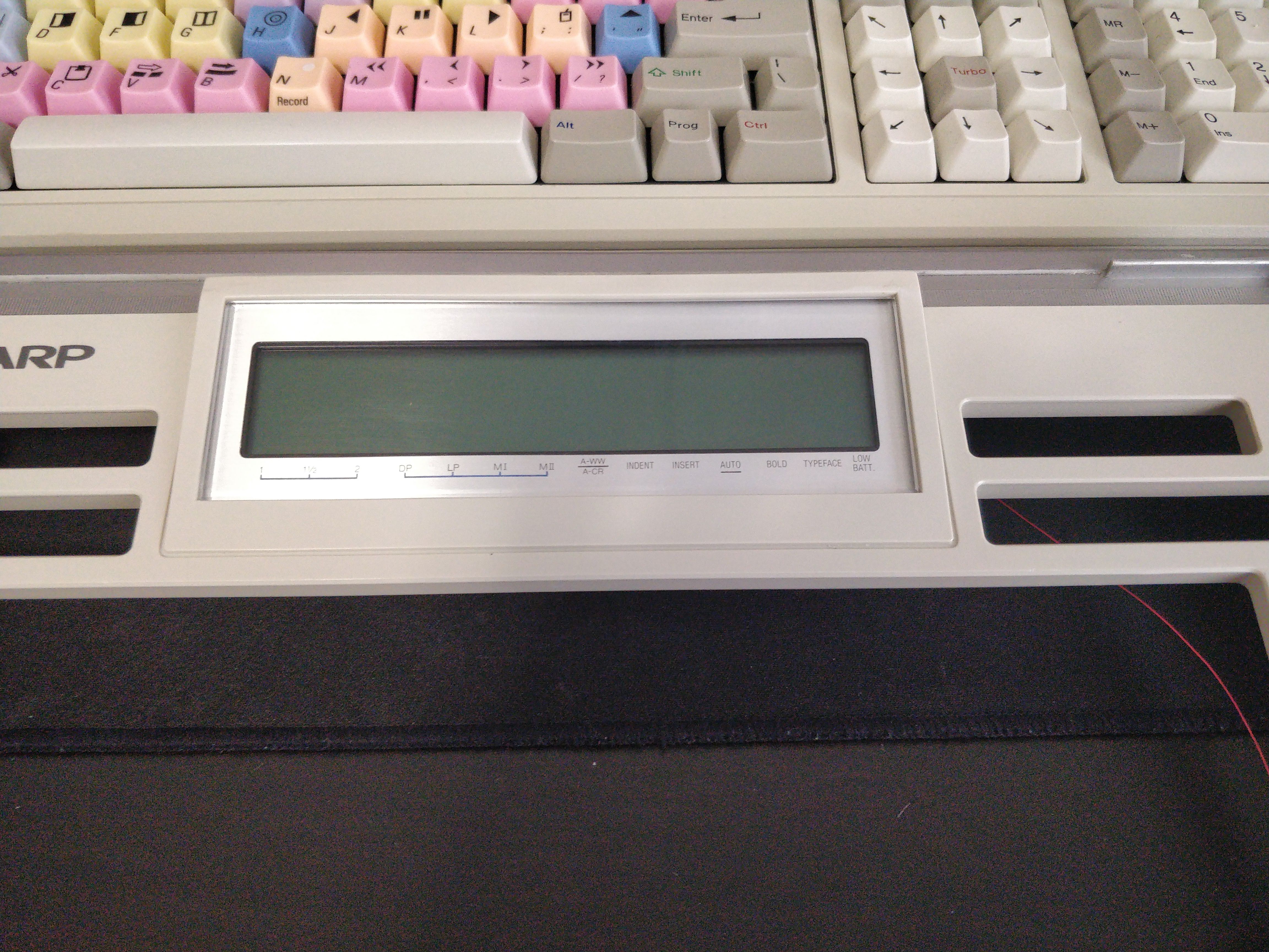

New LCD temporarily attached with tape so it stays lined up while I figure out a permanent way to hold it on (the tape could totally be permanent, might just stick with that).

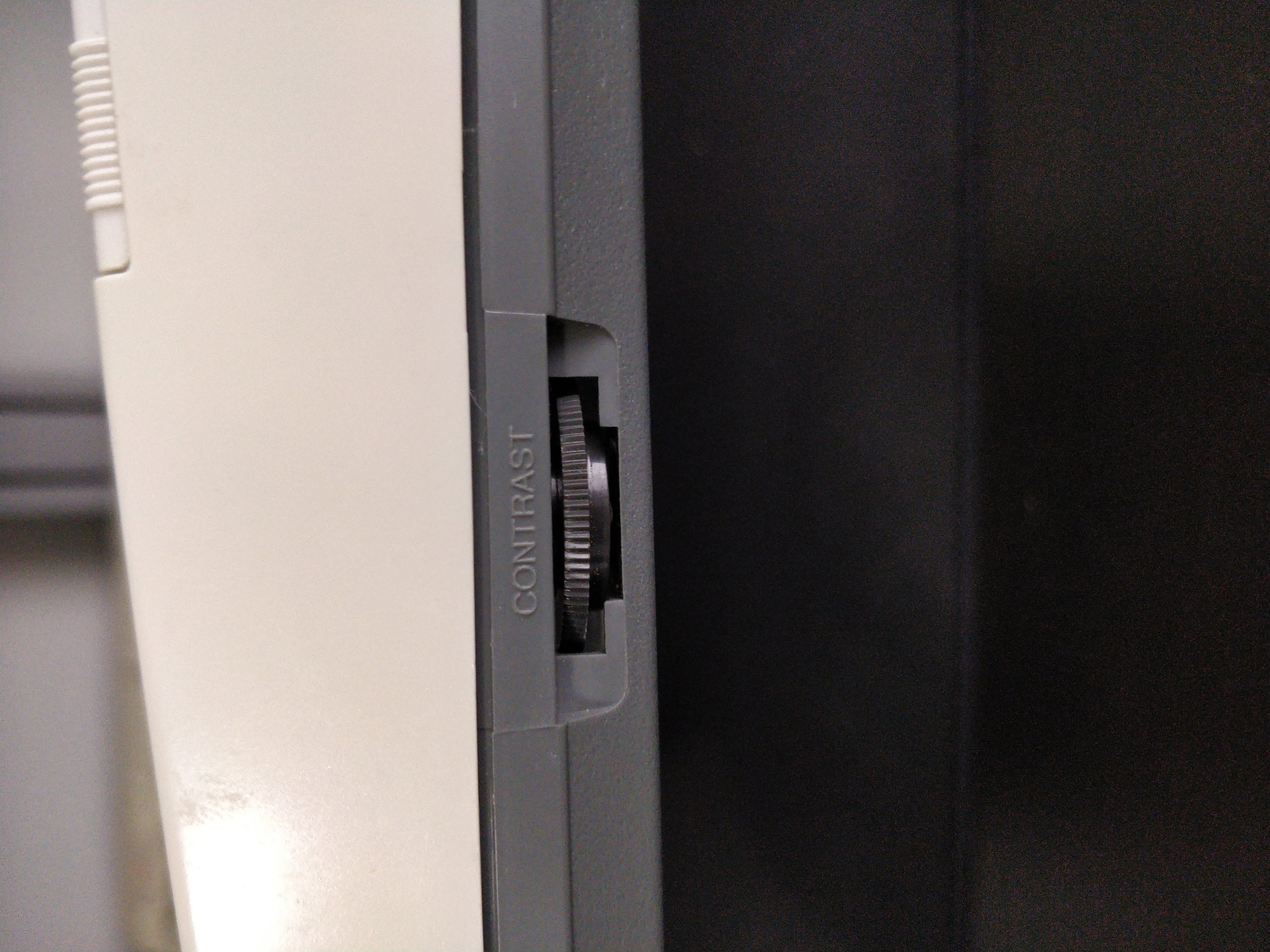

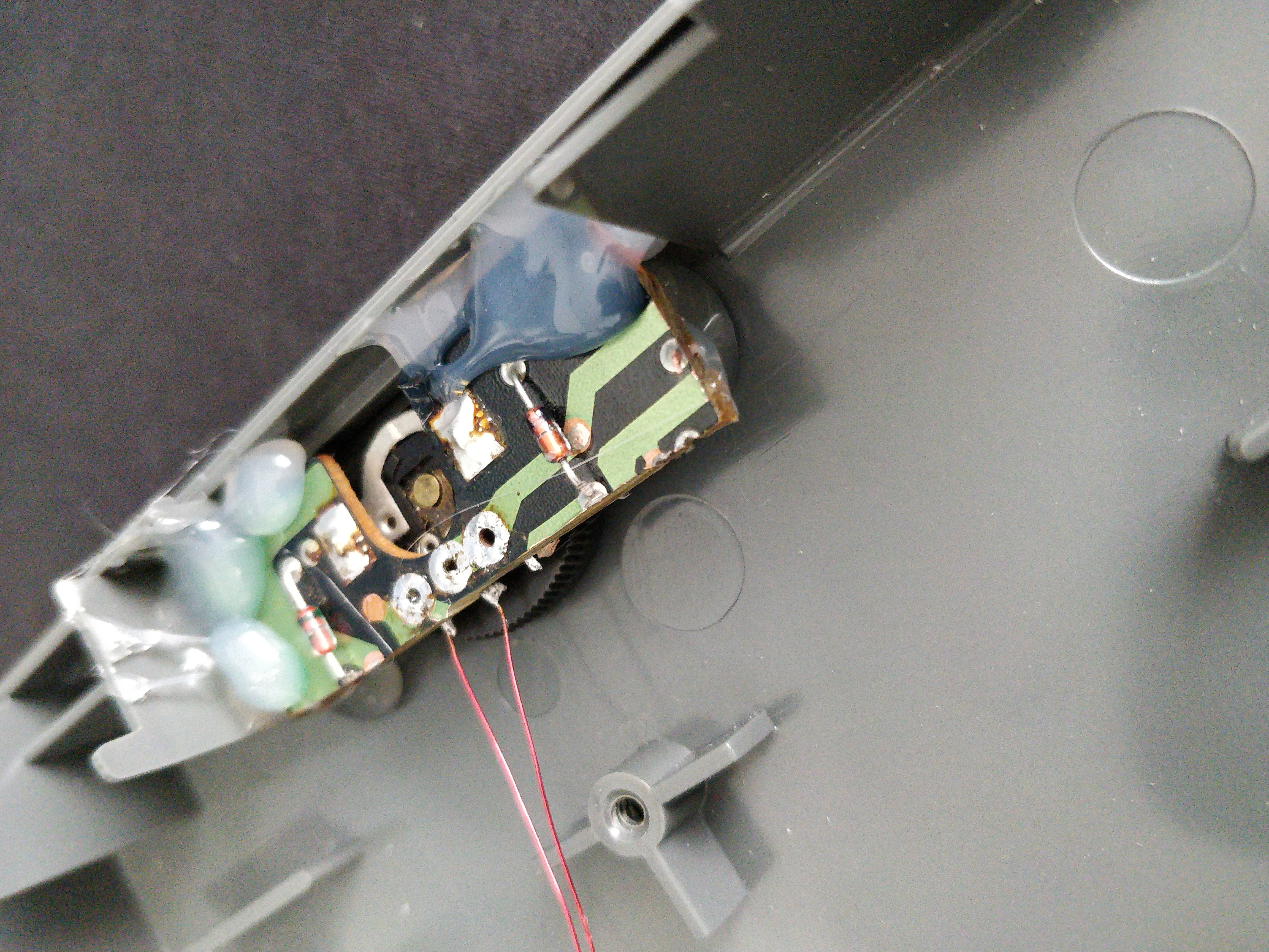

Original contrast potentiometer installed. Had to cut part of the PCB to get it to fit properly.

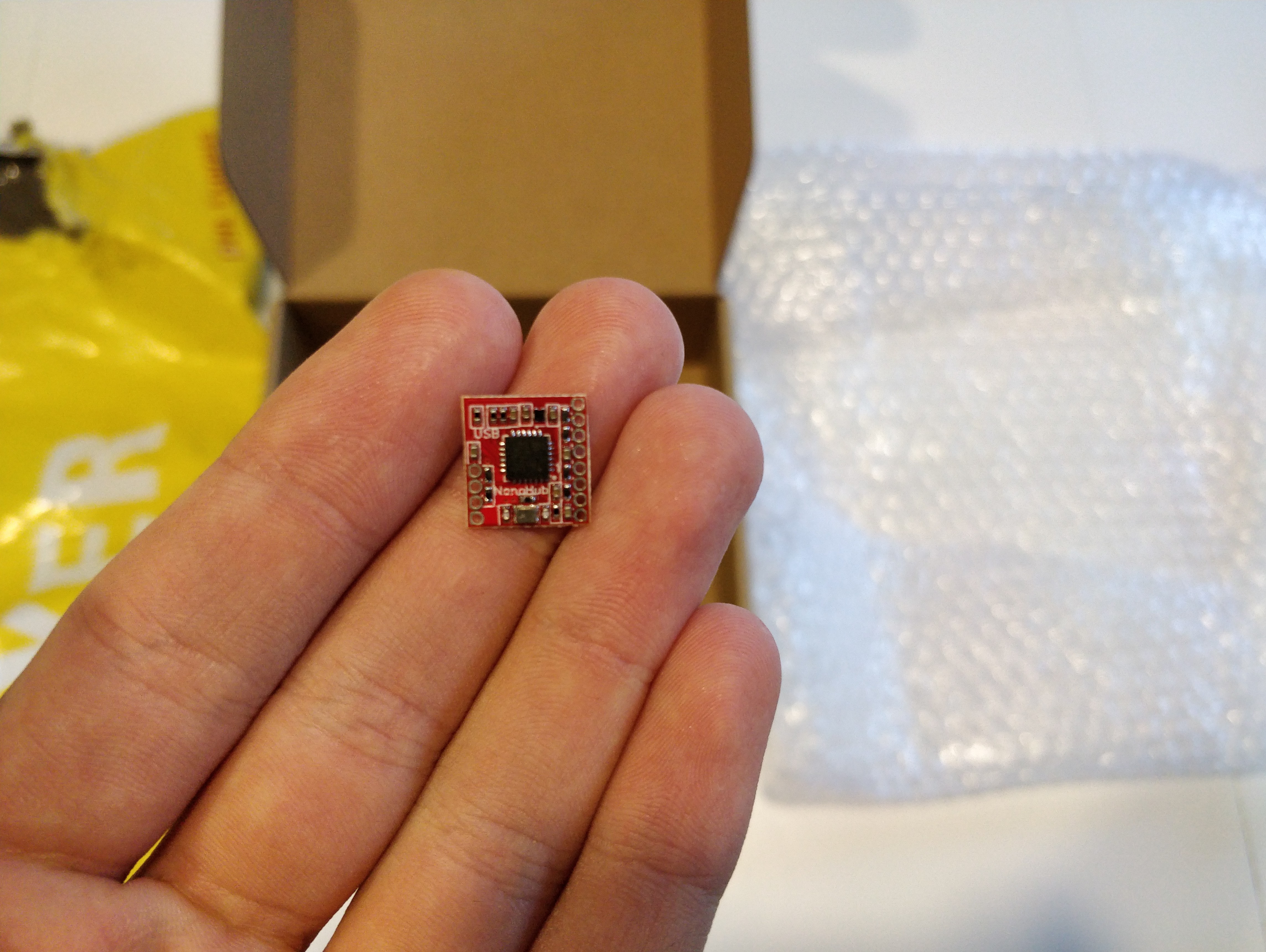

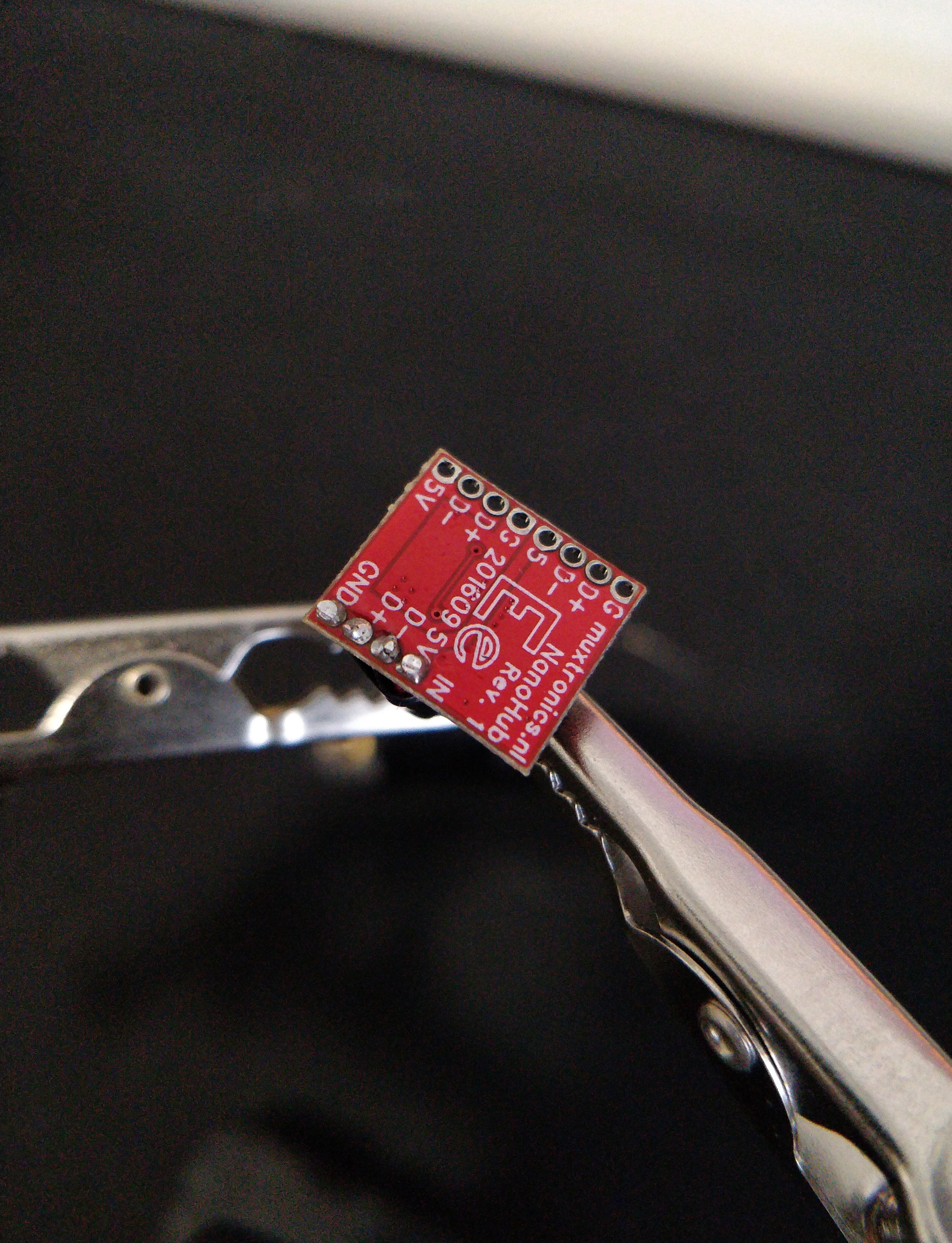

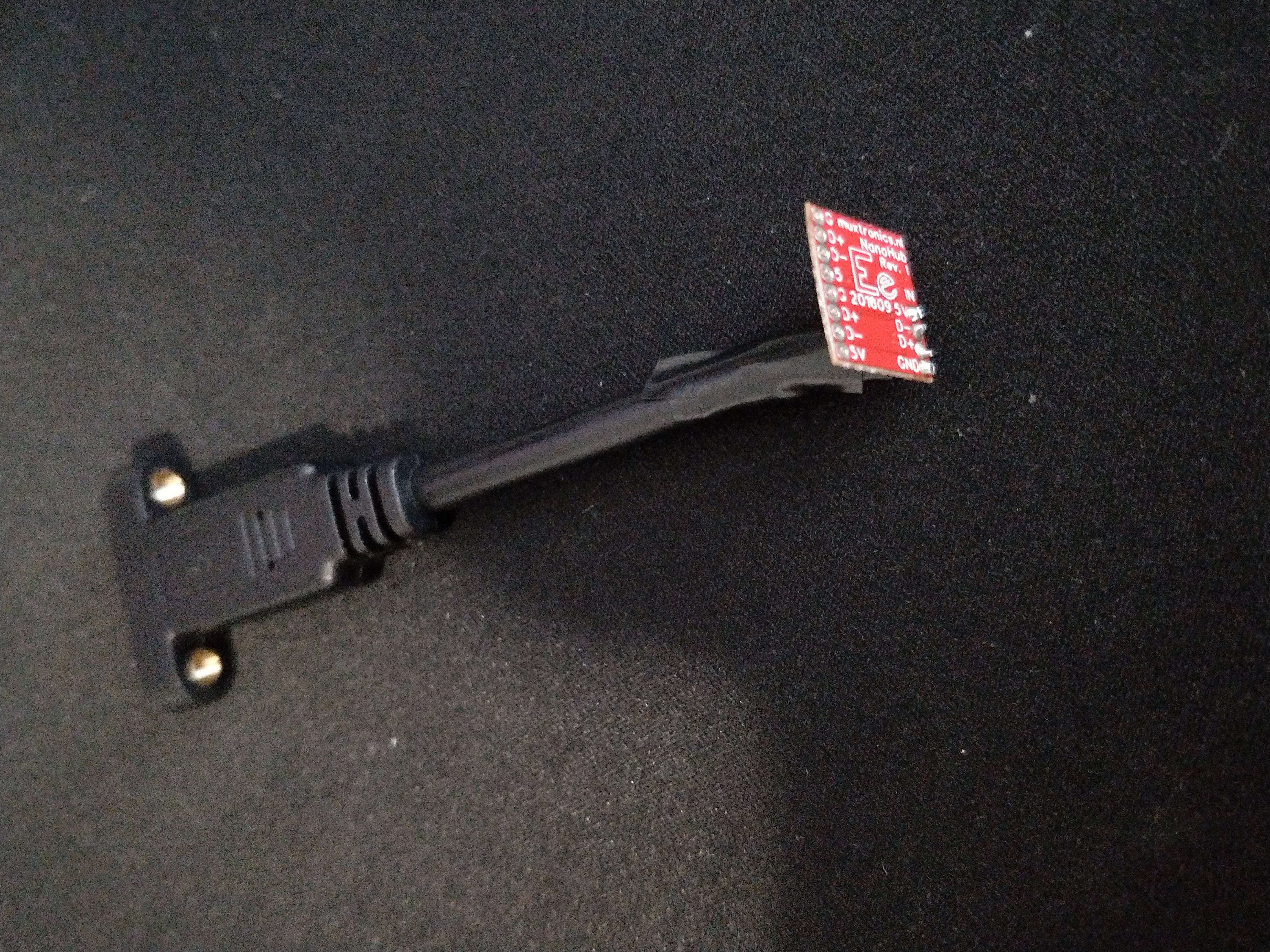

USB hub arrived. Way overpaid for shipping, but at least it came fast from China. This thing is way smaller than I expected. Gonna be fun soldering to it without helping hands.
kelvinhall05
12 Jun 2020, 01:39
Ok found some helping hands, lol. Soldered fine, wasn't too hard thanks to them.

PCBs are hopefully gonna ship today. Checked a few hours ago and they were at the "final inspection" stage. Guess we'll see my next mistake when they arrive hahaha.

PCBs are out for delivery, can't wait to inevitably find another mistake!

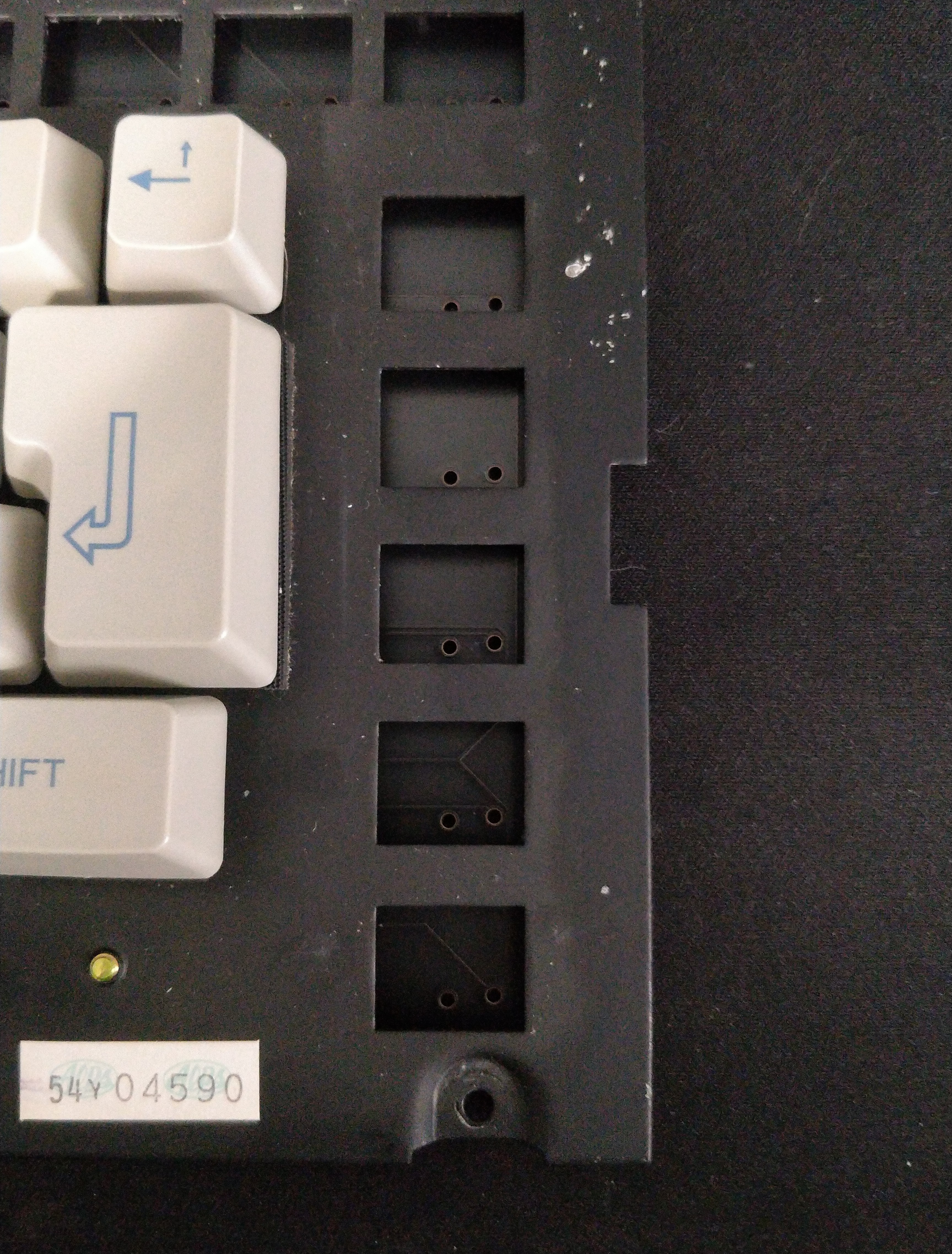

kelvinhall05

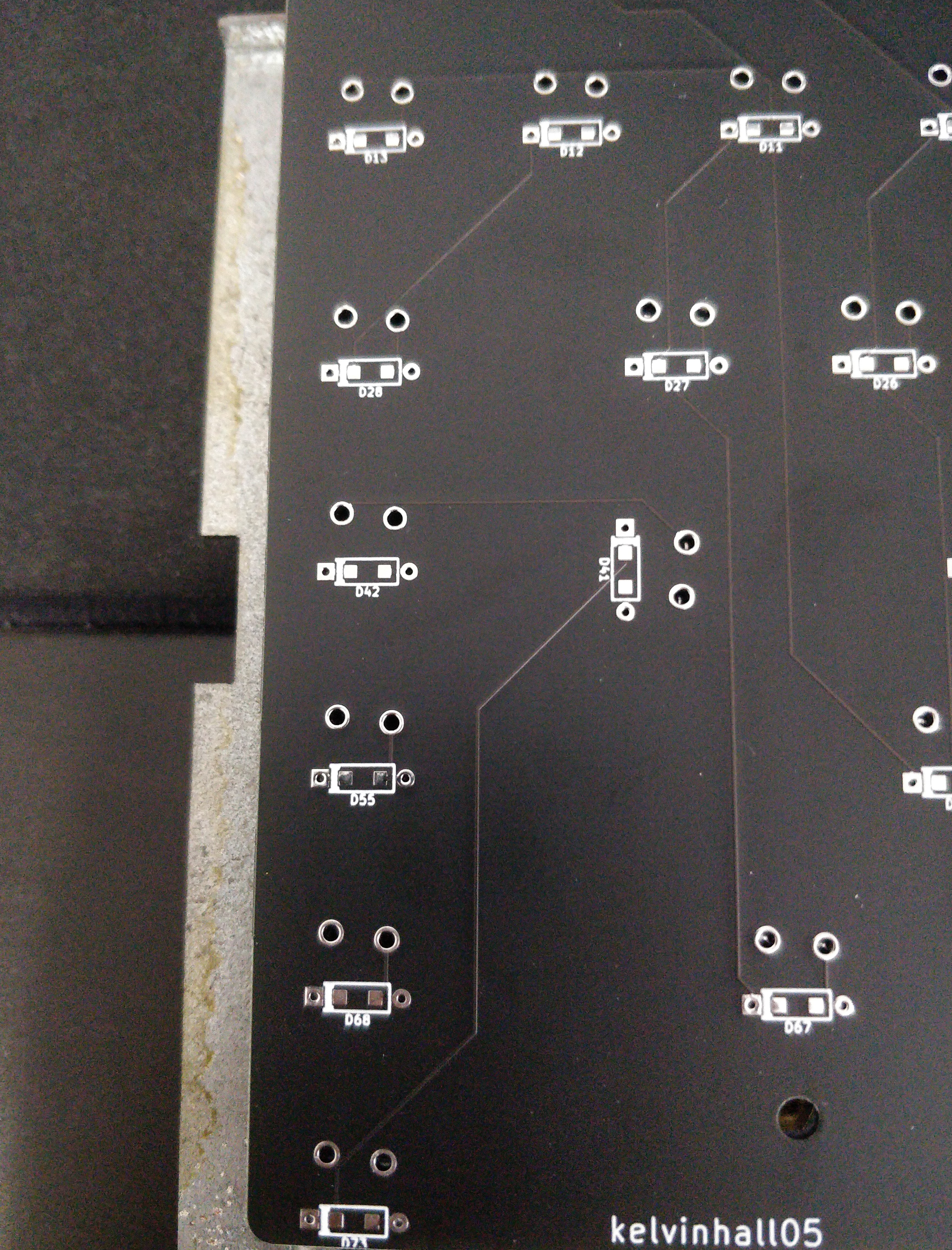

25 Jun 2020, 01:07

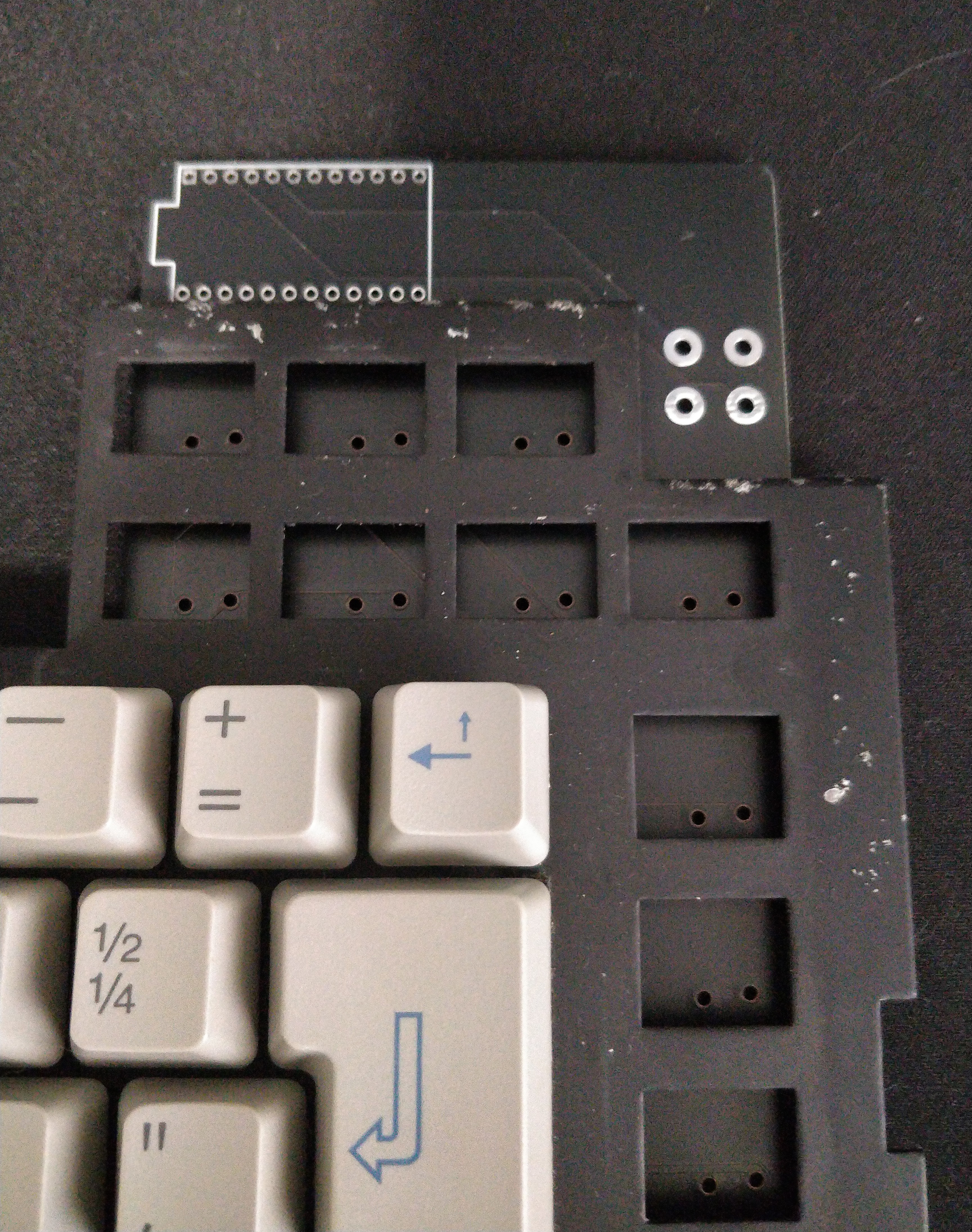

What did I say?
Guess project is on hold until I get enough money to get new PCBs. If someone wants to buy this disaster, lmk
Jesseg
25 Jun 2020, 01:16
Man that must be annoying.. how did you do that?
kelvinhall05
25 Jun 2020, 01:54
Jesseg wrote: 25 Jun 2020, 01:16 Man that must be annoying.. how did you do that?
Well first, I'm fucking stupid.
Second, I probably moved this row over an extra 0.25 or 0.125u, and since I based the top keys on this side on that far-left row...yeah.
Welp.
ddrfraser1
25 Jun 2020, 03:27
Dude! Dremmel! That’s what I did when I got a non stepped caps plate but the pcb was stepped. Is it just that row?
kelvinhall05
25 Jun 2020, 04:04
ddrfraser1 wrote: 25 Jun 2020, 03:27 Dude! Dremmel! That’s what I did when I got a non stepped caps plate but the pcb was stepped. Is it just that row?
Yeah, it's just those. I'd rather not hack up the plate, partly cause I'd have to mess with the case.

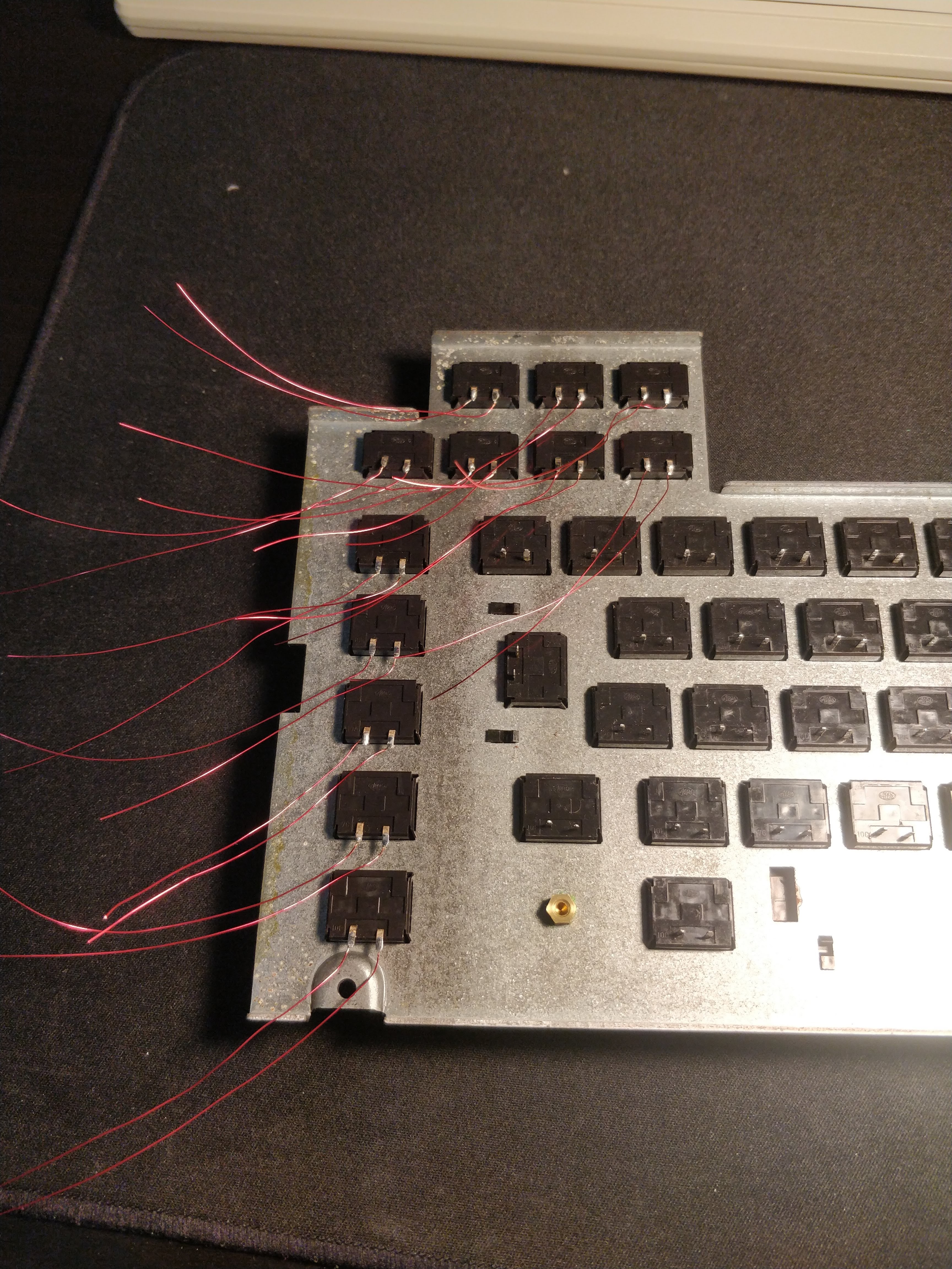

I thought of a (hopefully) good solution. Attach magnet wire to all the leads of the misaligned switches, bend them flat, and solder the magnet wire into the holes instead of the switches.
I will solder stuff to the PCB tomorrow and hope that this works. Will also put electrical tape over the PCB where the pins are bent flat, just in case.
kelvinhall05
25 Jun 2020, 04:08
At least the PCB *looks* pretty nice

Jesseg wrote: 25 Jun 2020, 05:07 Good Idea, and that looks great!
I am not happy with it, gonna bug me. But if it works it works.
kelvinhall05
25 Jun 2020, 18:43
Guys I'm a FUCKING GENIUS
Magnet wire worked :lol: :lol: :lol: :lol: :lol:
I had to heat the joint for like 15 seconds to get the insulation to melt (yes, that is how you're supposed to remove insulation on magnet wire) and now it works wonderfully! God damn...first I go full retard mode, then I fix it lmao.

So this just keeps getting better. Seems my character LCD might be dead. Either that, or the LCD backpack is dead, or something else idfk. I can't even get the LCD's backlight to turn on which is a really bad sign. I mean, the backpack is getting 5v, so I assume the display will...I'll have to undo my amazing hot glue job to investigate more.

I managed to get the backlight working and the characters working but not at the same time, although I have a feeling that is due to the example code I was using (which is a pita to flash from Arduino IDE btw).

Having trouble with the clear plastic that goes over the display. There is something on it, looks like glue or something, and alcohol won't take it off. Worried acetone will destroy the plastic.
Also the usb hub doesn't work, awesome. Not sure if I misunderstood what it's for/how to use it, but it ain't passing data through. Awesome, more money gonna need to be dumped into this project...

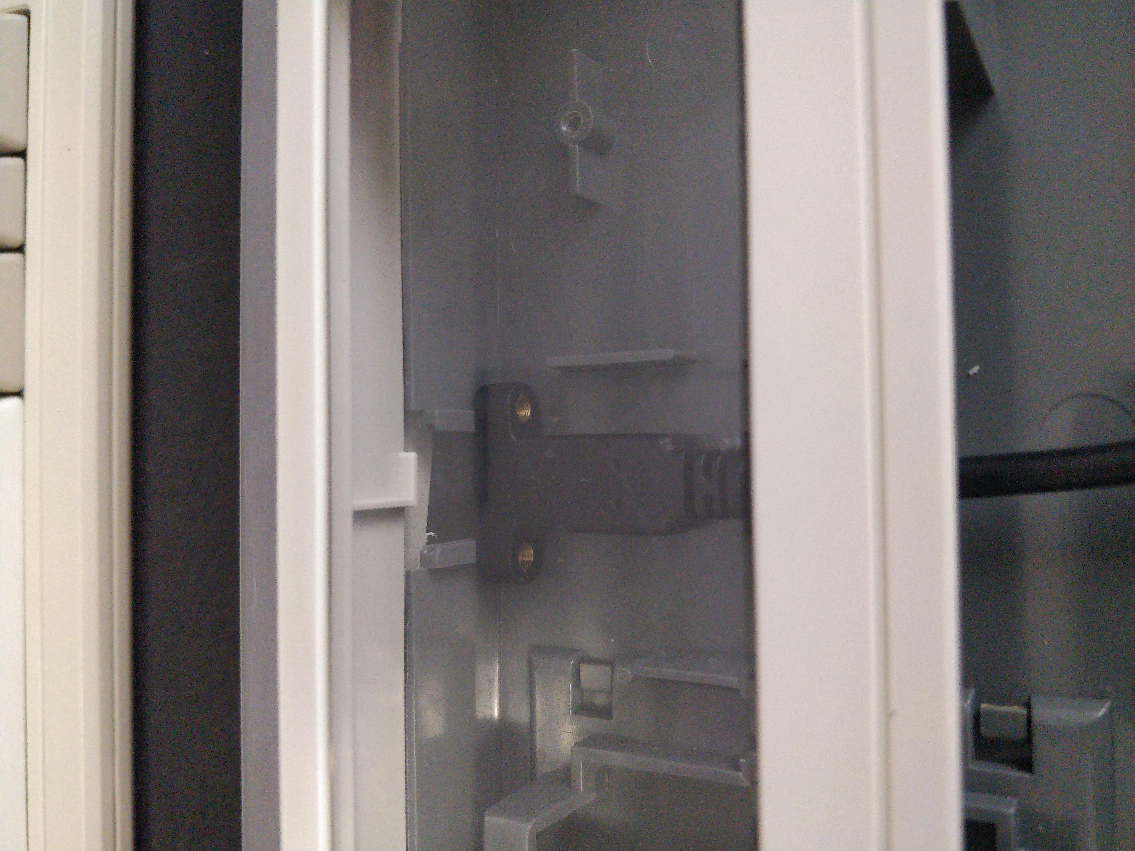

Also, I tore down a shitty little 4-port USB 2 hub and glued that inside. Works great. Really pissed that the Nanohub didn't work cause it was almost 30 USD after shipping, but oh well.

I am not going to try to fix the old plastic that covered the LCD. It's too far gone. I'll just replace it, but I have to find some cheap 3mm acrylic first. I have mounted the LCD since it can just barely fit without having to rest in the plastic bit, if that makes any sense.
