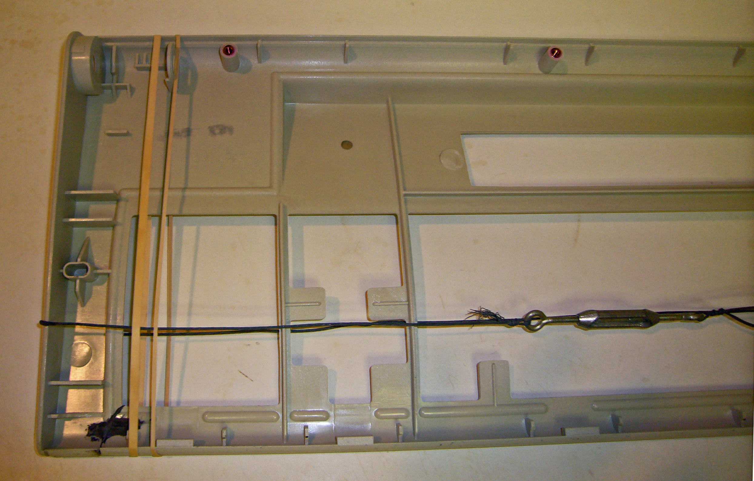

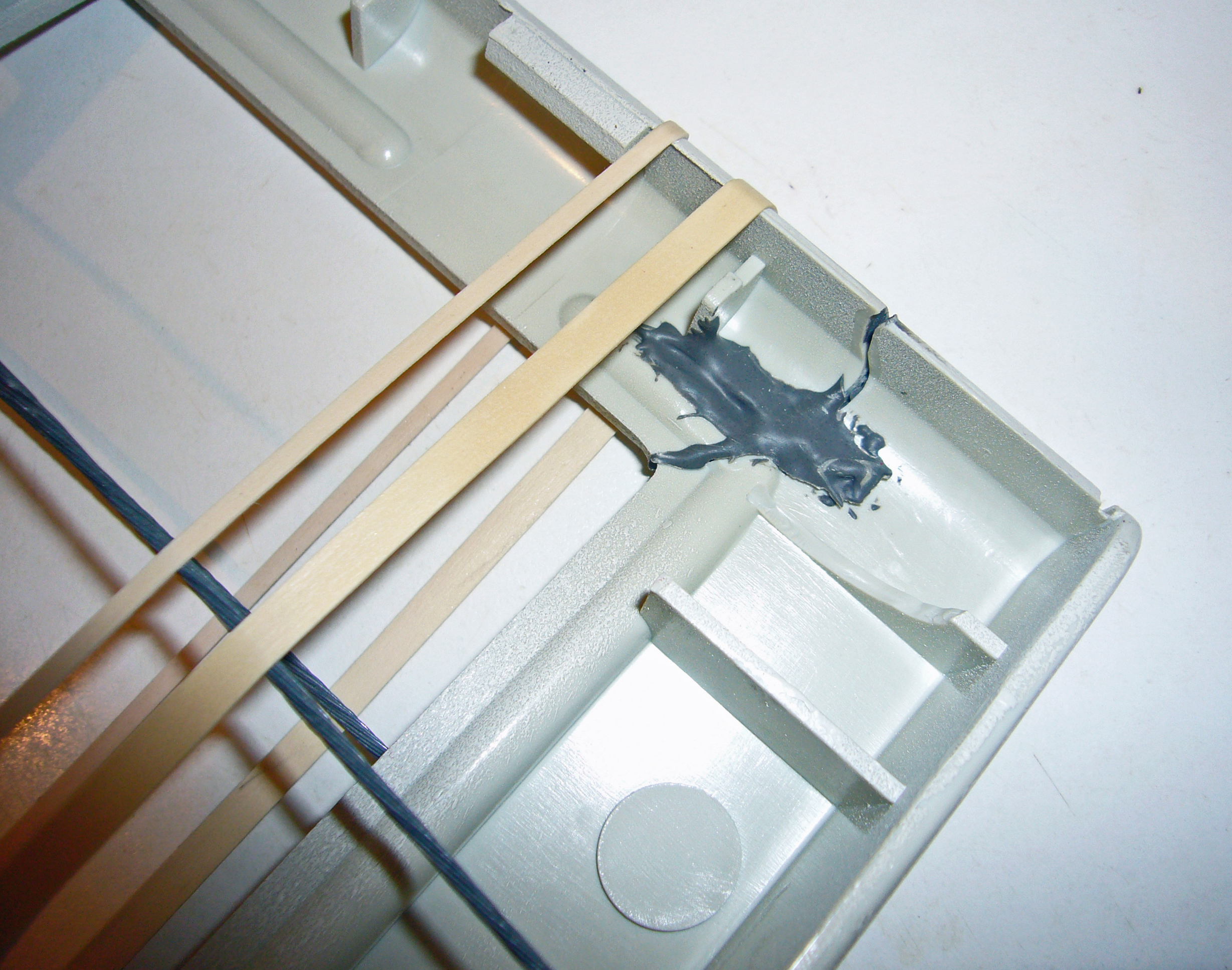

I have used JB Weld (original formula is best) on Model F cases but not Model Ms.
I reinforced the back side with a length of wire embedded in a gob of it, just to be sure.
- F-122-case-repair-002.JPG (3.3 MiB) Viewed 2089 times
- F-122-case-repair-001.JPG (3.02 MiB) Viewed 2089 times

Thanks very much!
