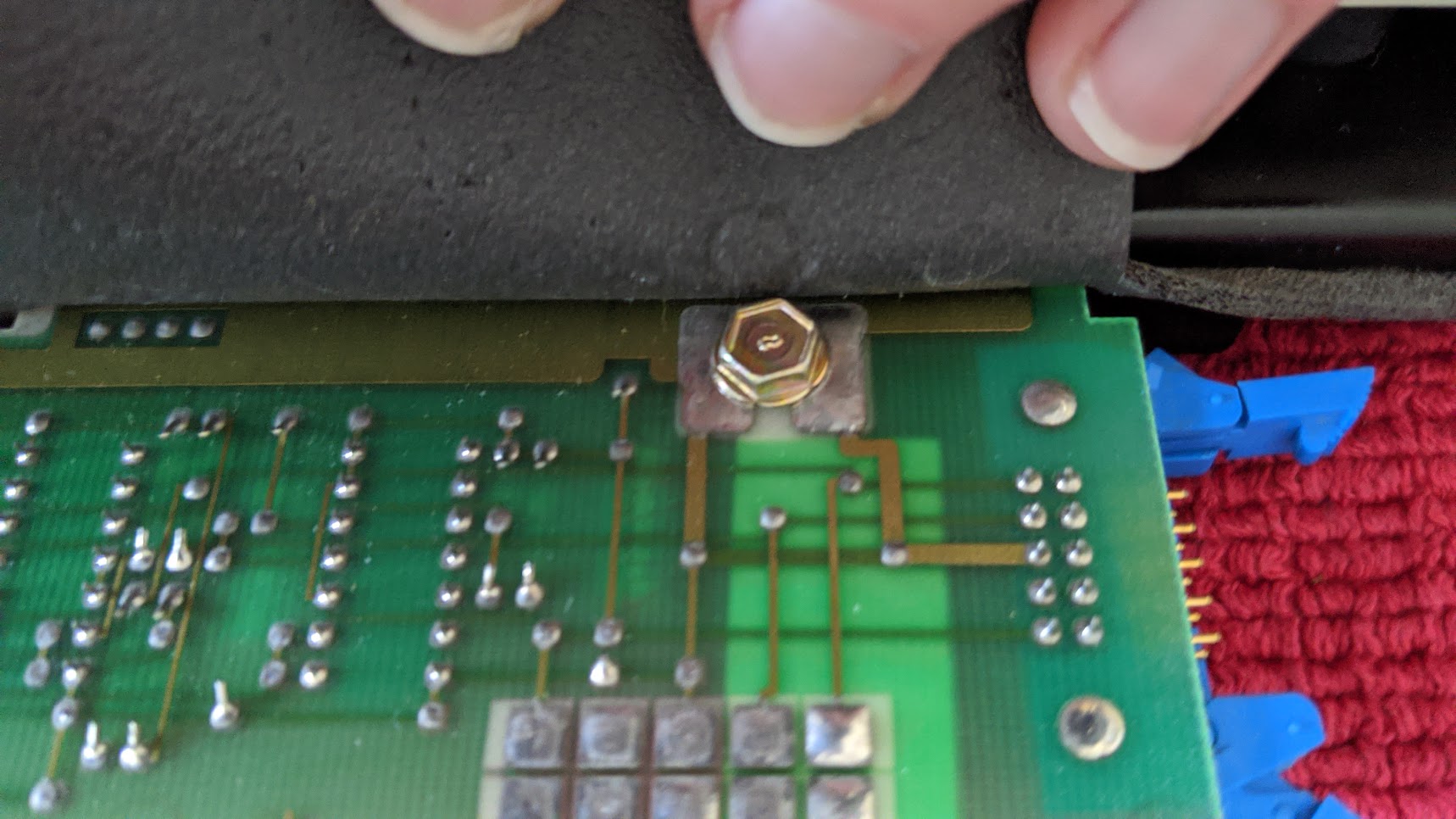

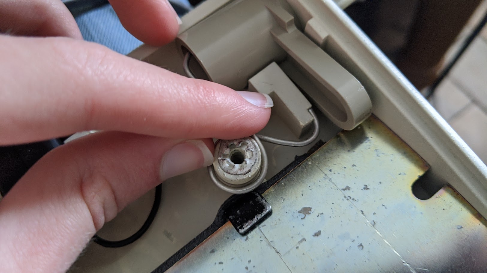

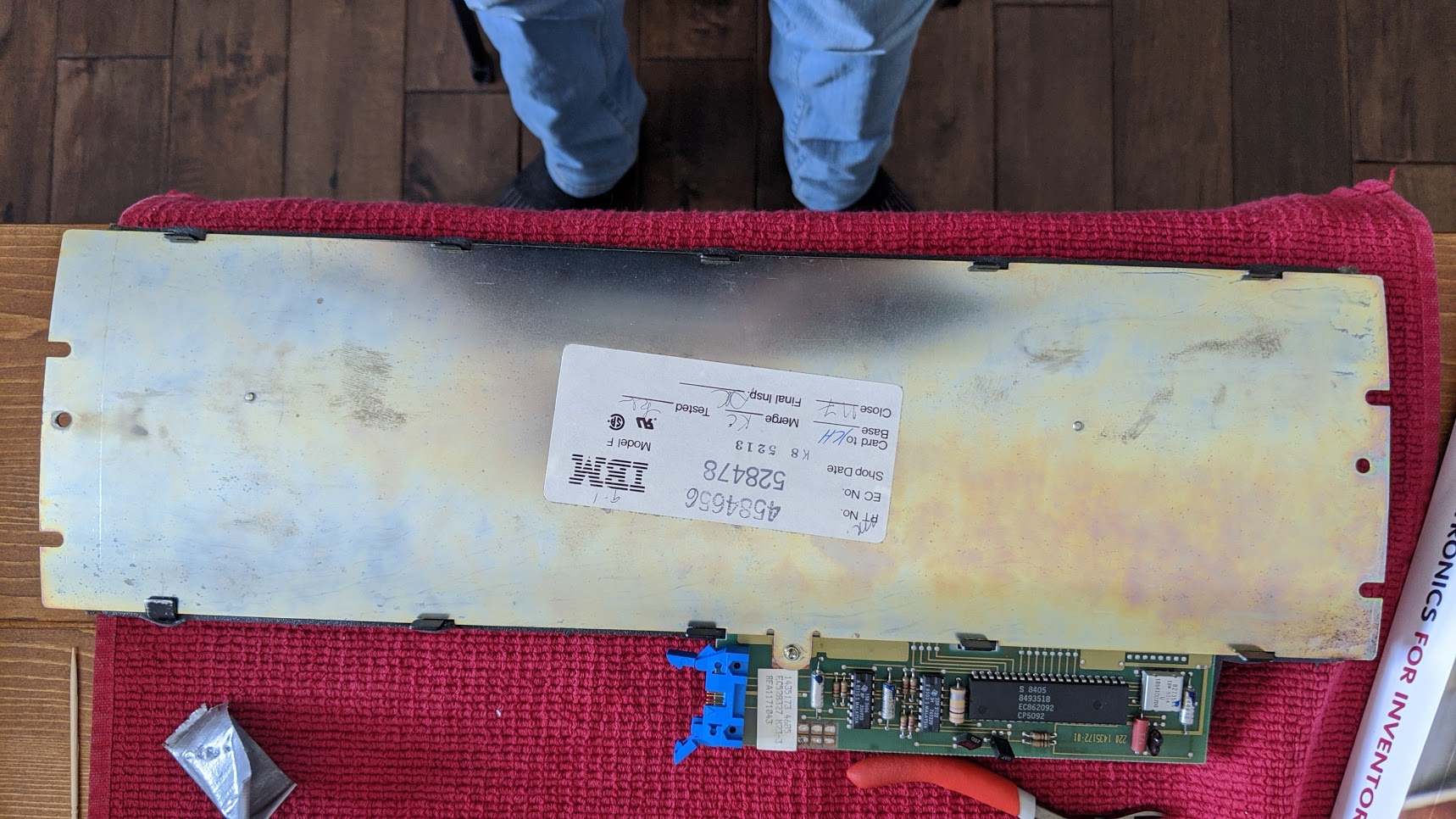

2.) The ground that y'all recommended will not work/isn't right, the cable sadly doesn't reach:
You can see that black lead running off from the cable (separate from the 7x2 connector) is connected to that PCB spot, but when you take the cable and put it in it's intended spot:
The ground connector fits perfectly with the case screw location. Just an FYI, the case back is metal, and so is the screw, so that should ground...?
I am still learning electronics and such, so correct me if I am wrong, but that is a functioning ground, and I believe it is the correct spot, as the DIN cable does say "IBM" so I know it is not after market.
The metal backing (painted):

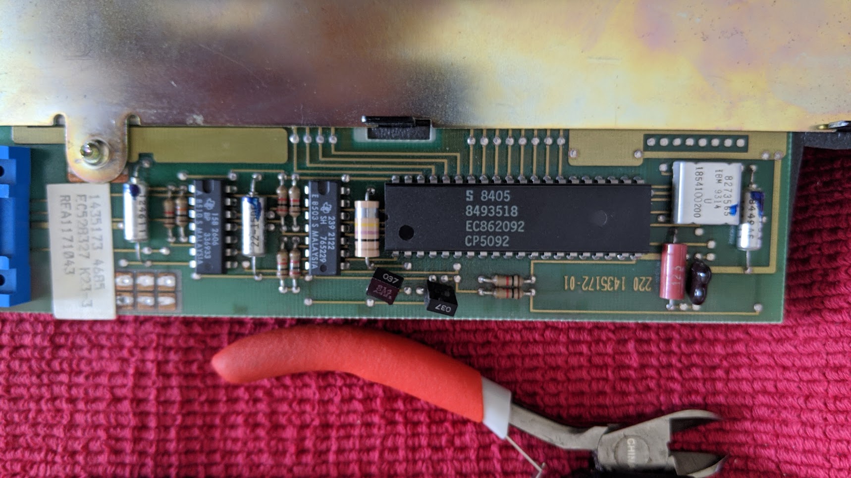

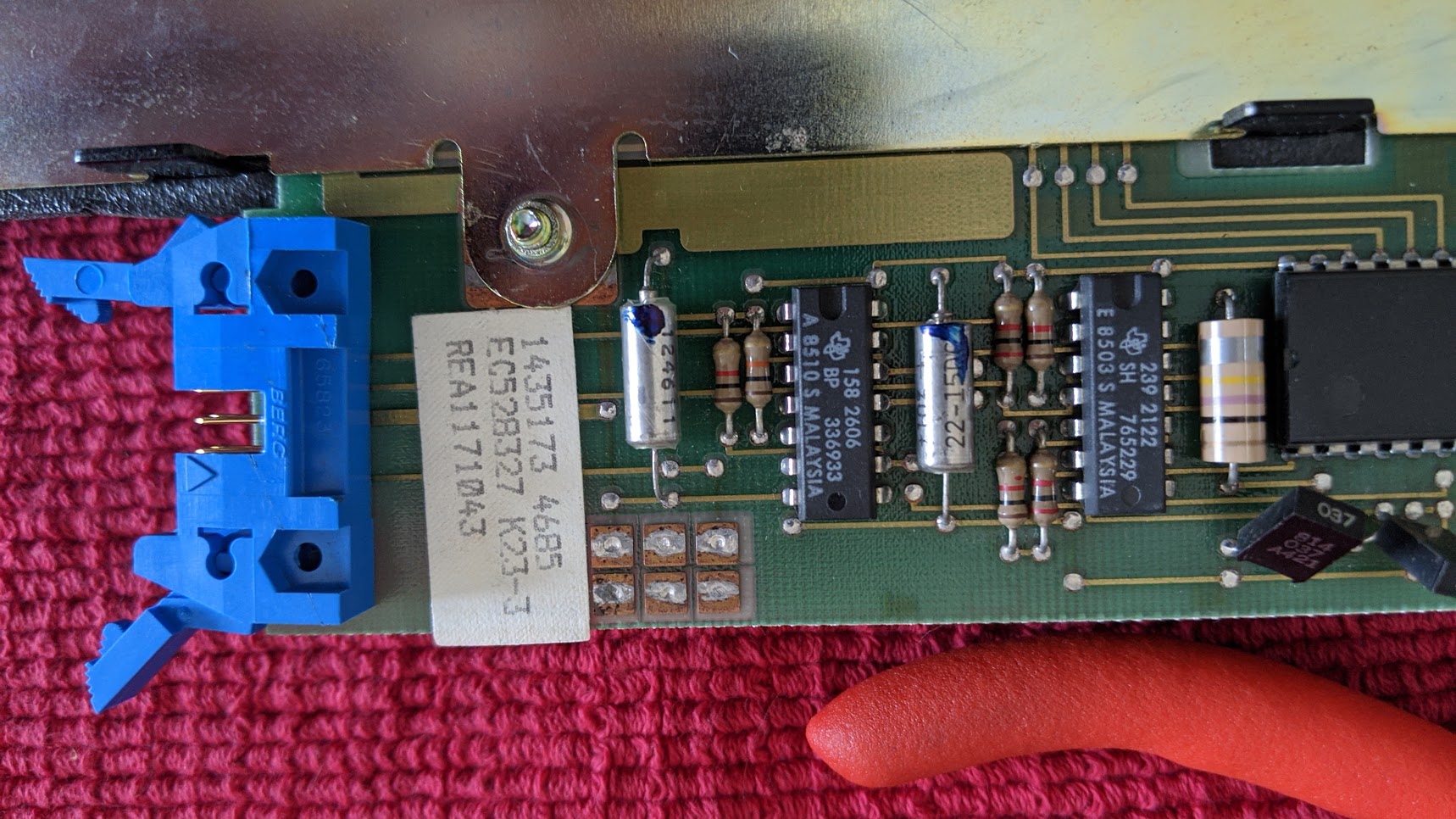

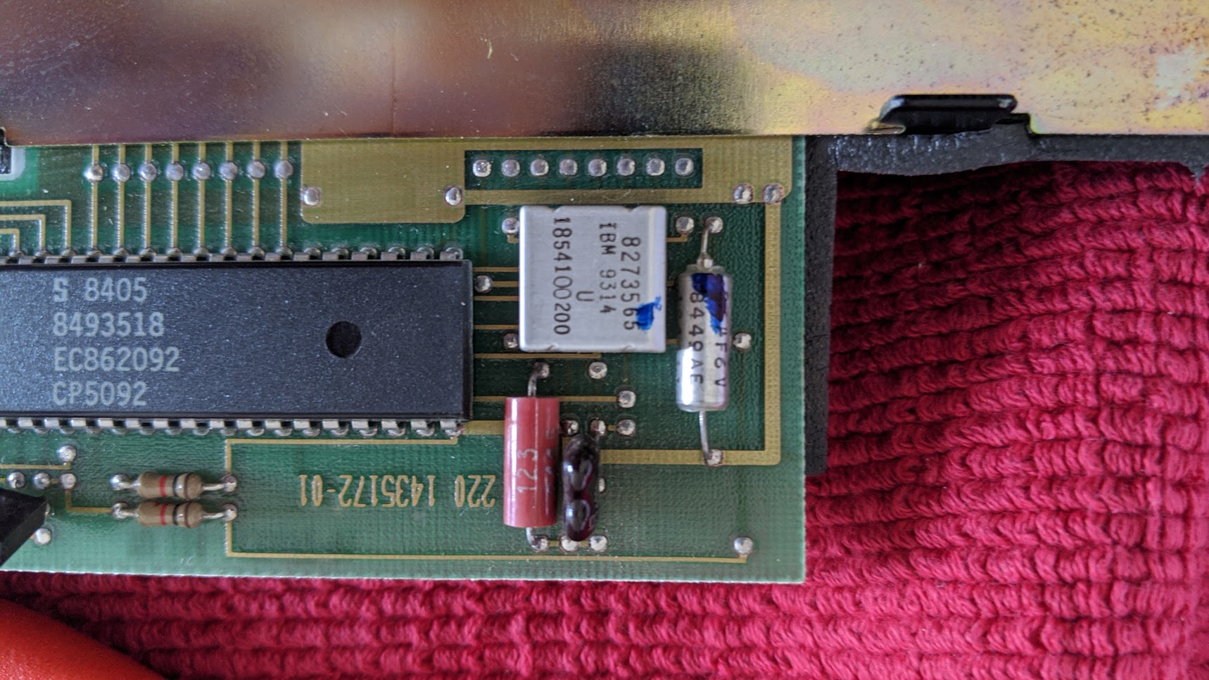

The cable is not the issue, it has continuity through the cables. Along with this, that connector thing isn't for the ground at all, but for PE, the ground is supplied through the cables <3. I was confused at first though, as I couldn't locate the proper cable format, this was when I realized that the cable connector diagram I sent earlier was wrong. This is the actual output (don't mind the bad handwriting:)
This was confirmed by this. The resistors are as follows, and in ohms, all of which were true:
There are other components obviously, but I am not sure how to test for them, all of the contacts are in good shape, no corrosion at all. Next, I check continuity throughout the board, looking for sections that may have broken/aren't connecting, and couldn't find anything. Each point means it has continuity with the cable and its respective connection:
Reference:
Ground:
VCC:
Clock:
Data:
From here, I was able to tell that these pads could be soldered directly to and correlate to the cable, which I believe is by design:
I honestly don't think there is an issue with the board that I could test offhand, all of the connections are good. Any idea how I can test the other components to see if they work? I think the issue is with the converter, to be honest, but I have no way of checking this.
