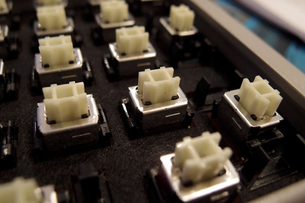

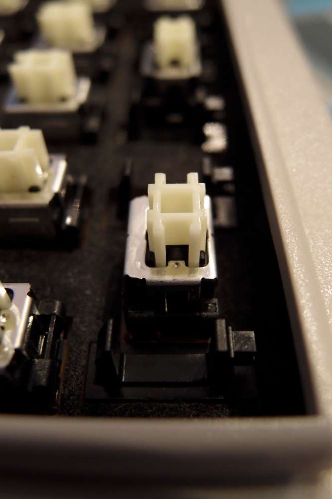

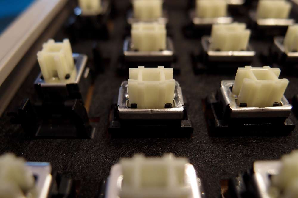

Hi, today I got a Numpad from Olivetti and found that it uses a mechanical switch, that I never saw before...
Could you help me find out more about it?
Here are the photos: (look big but are small in filesize =)

They look like a toasters. How does the keyboard and key caps look?
rodtang
11 Apr 2012, 19:04
Looks like some strange ALPS clone.
mintberryminuscrunch
11 Apr 2012, 19:04
mitsumi?
PS. it helps to post keyboard model, manufacturer, pics,...
Last edited by mintberryminuscrunch on 11 Apr 2012, 19:09, edited 1 time in total.
ripster
11 Apr 2012, 19:06
Yep

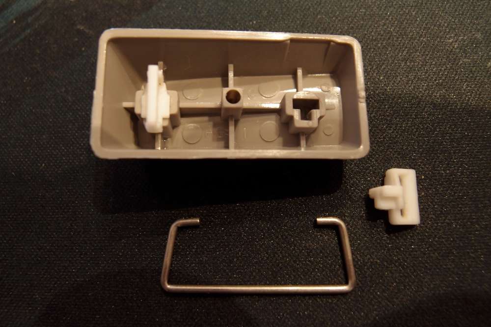

7bit wrote:They look like a toasters. How does the keyboard and key caps look?
One cap is on the photo.
It is an olivetti numpad and on the PCB and inside the case there is a mitsumi label.

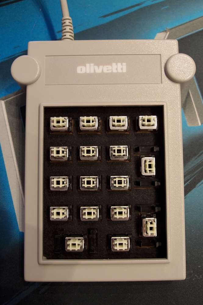

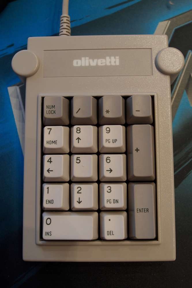

I will post a full picture when the caps are clean in about 30min.

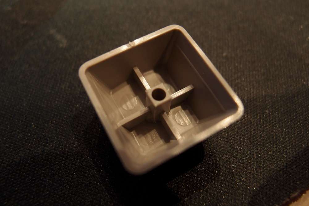

Photos added (with small filesize)
11 Apr 2012, 20:26
Tarkoon wrote:Photos added (with small filesize)
Much, much better!!!
Nice numpad!

The color of the photos is a little bit off - the stems are more yellow than white.
ripster
11 Apr 2012, 23:31
Do the switches have "ミツミ" (Mitsumi) stamped on the metal part?
Ascaii
The Beard
12 Apr 2012, 08:58
it seems the thread on geekhack with my replies was deleted...
These are indeed mitsumi switches, I am guessing they are tactile, but non clicky. I have encountered that shade of mitsumi in a quantel video console. I have also had salmon-red mitsumi(tactile, non clicky) and teal mitsumi switches (tactile, clicky). All boards are with Haata in the States...I think he has disassembled them so he can give more info on them.
Tarkoon
12 Apr 2012, 09:31
It is indeed tactile without click.
I will look again for the "ミツミ" on the switches when I come home from work, but when I inspected the switches the first time, I didn't see any manufacturer signs on the switches... Ok, in this language it looks like some scratches! ^^

What is really interesting about this numpad:
There is NO controller in it and it has a nine pin plug...
off
12 Apr 2012, 12:02
which means there's gotta be some controller chip on there- 9pins for +-17 buttons; good luck without some controller or multiplexer at least.
woody
Count Troller
12 Apr 2012, 12:38
off wrote:which means there's gotta be some controller chip on there
Or just a regular 5x4 or 6x3 matrix.
Tarkoon
12 Apr 2012, 12:46
5x4 would match.
