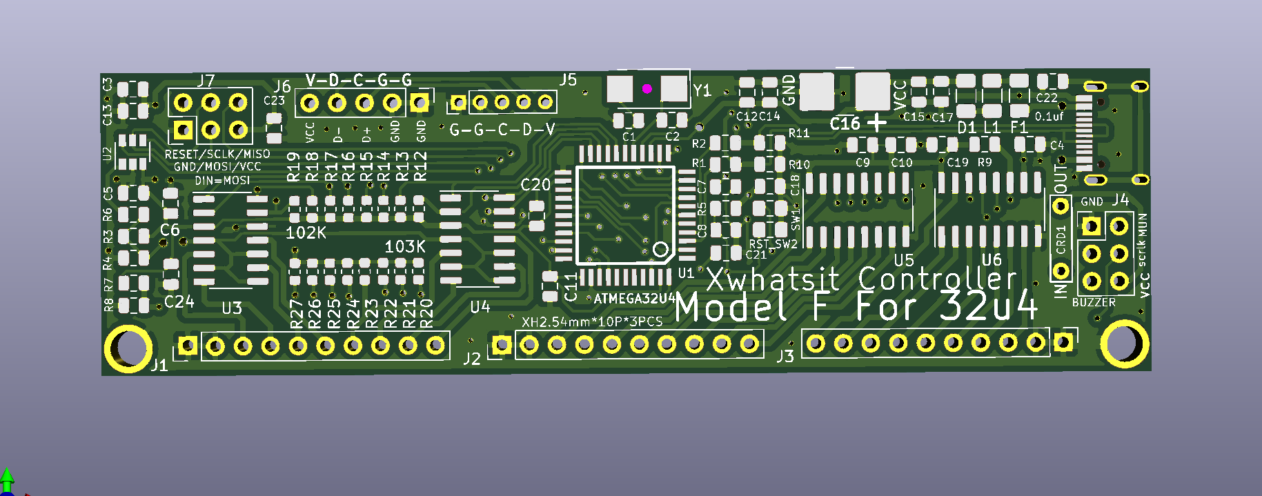

I am a novice using KICAD to draw the QFN atmega32u2 controller, and later want to use atmega32u4 to run xwhatisit, the firmware failed, 32U4 has no PC5/PC4 pin, I replaced the PF6/PF7 pin, loaded on 32U4, but these 2 The ROW pin is not triggered. Two files kbd_defs.h/sr.h have been changed, mkefile must be changed. I need help with more ZIP file code.
- 32u4.png (153.84 KiB) Viewed 1249 times
