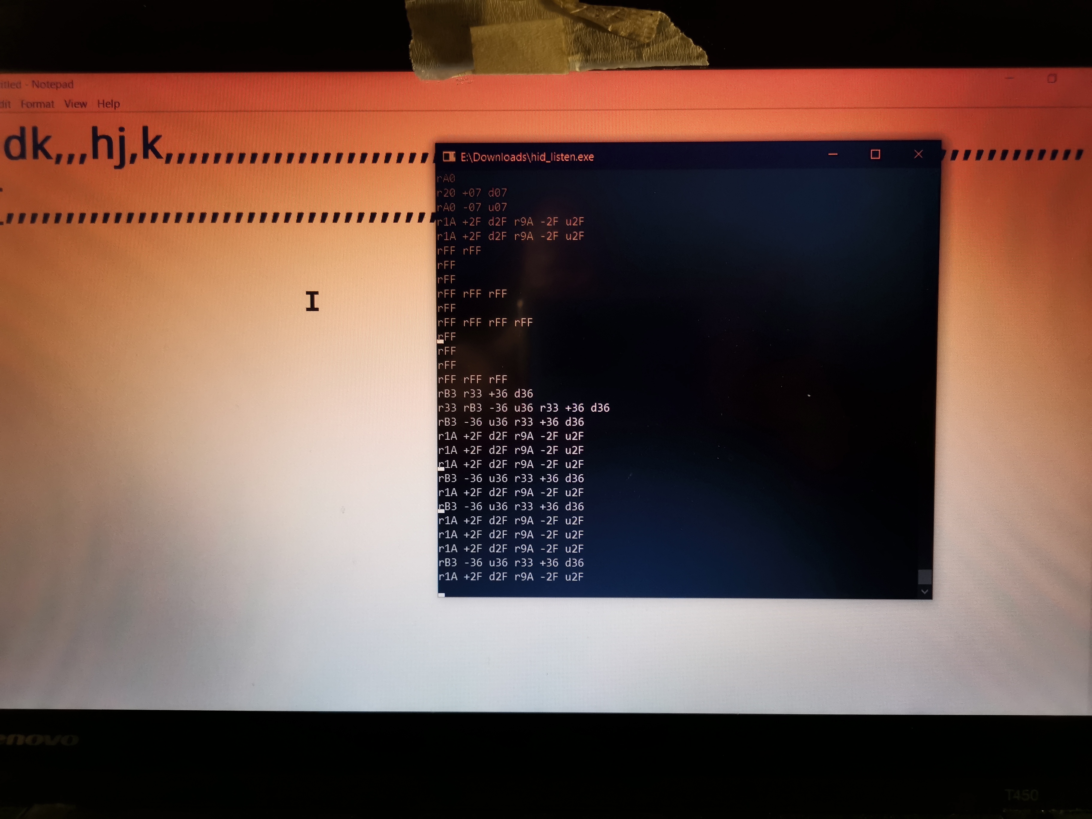

Hi peeps, sorry to post another IBM F XT problem post, but after scouring the forums on both GT and here, as well as reading though the Soarer's converter documents, I can't seem to fix my problem.
The absolute vomit of keys.

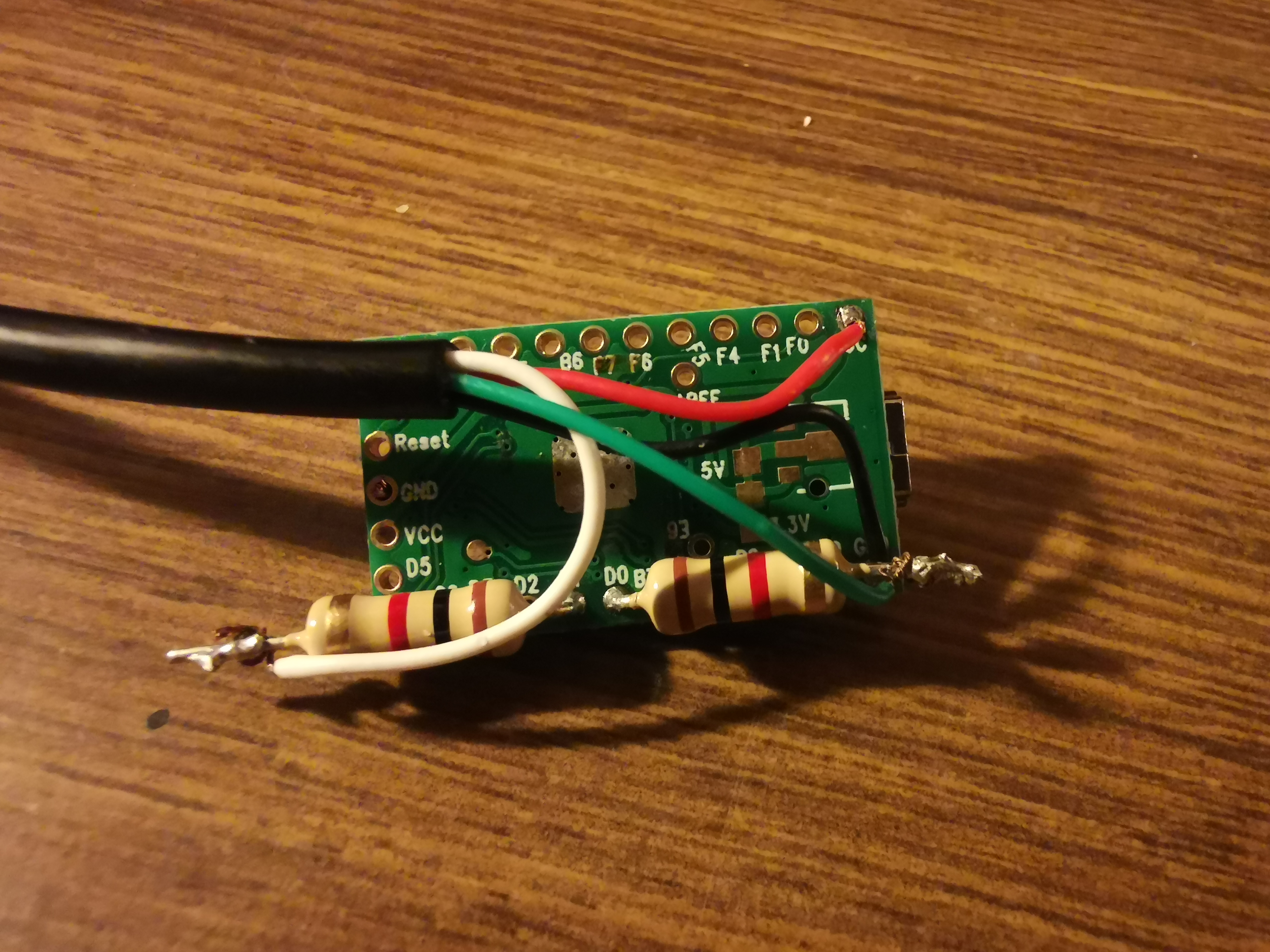

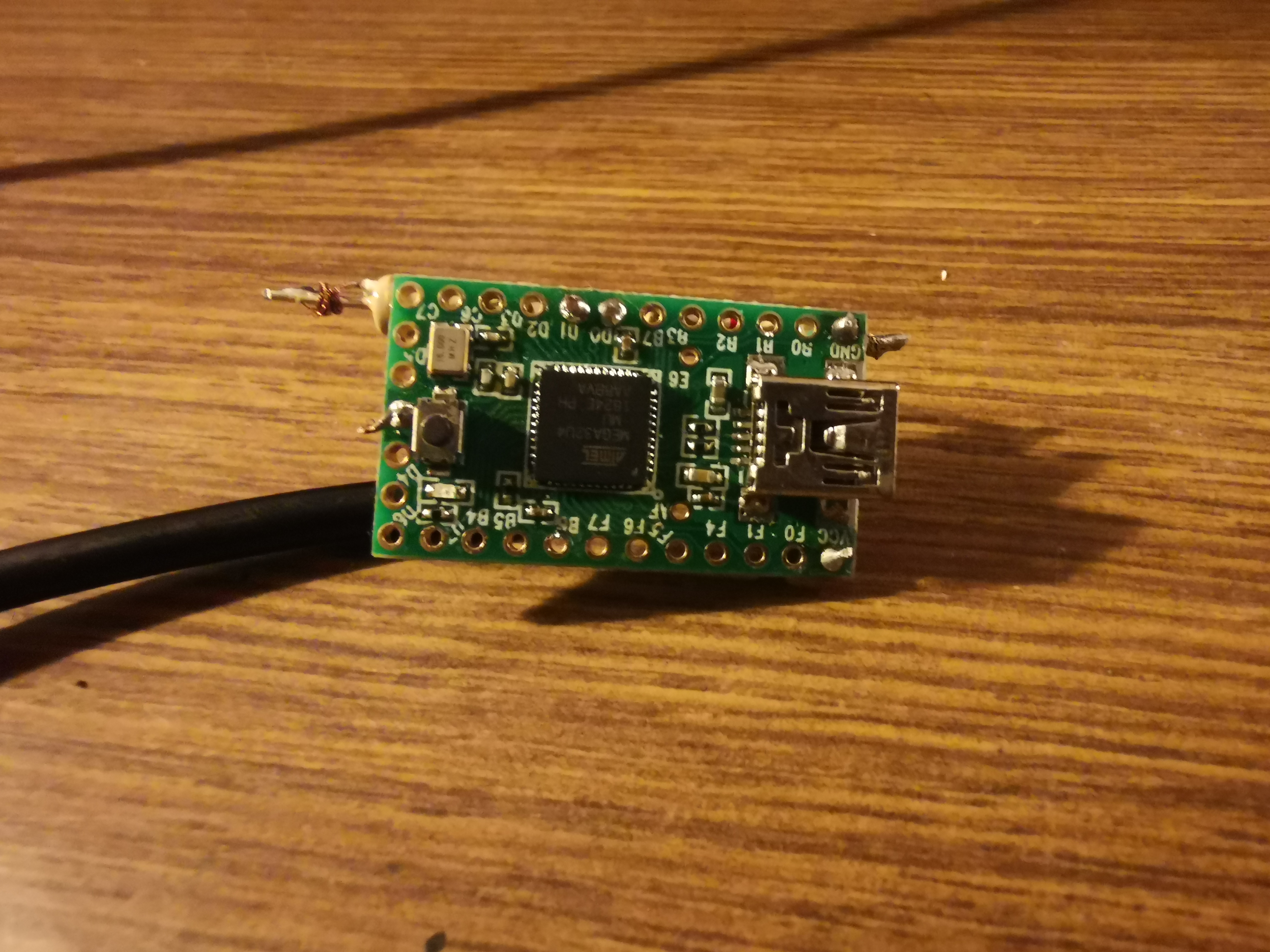

Currently, I have built a teensy 2.0 Soarer's converter, first without the pull-up resistors, and now with resistors, and both still have the same problem, though the latter did work for an hour, before deciding to spew scan codes. I have tightened everything that should connect to ground, but that seems to have been futile. The nut inside the keeb has also been tightened as much as I can, and has been re-tinned. The keyboard seems to work on very rare and fleeting occasions for about 4 key presses before deciding to go off on its own.
Here's my converter:
Please disregard the GND at the bottom, I couldn't remove the small piece of wire from my previous attempt.

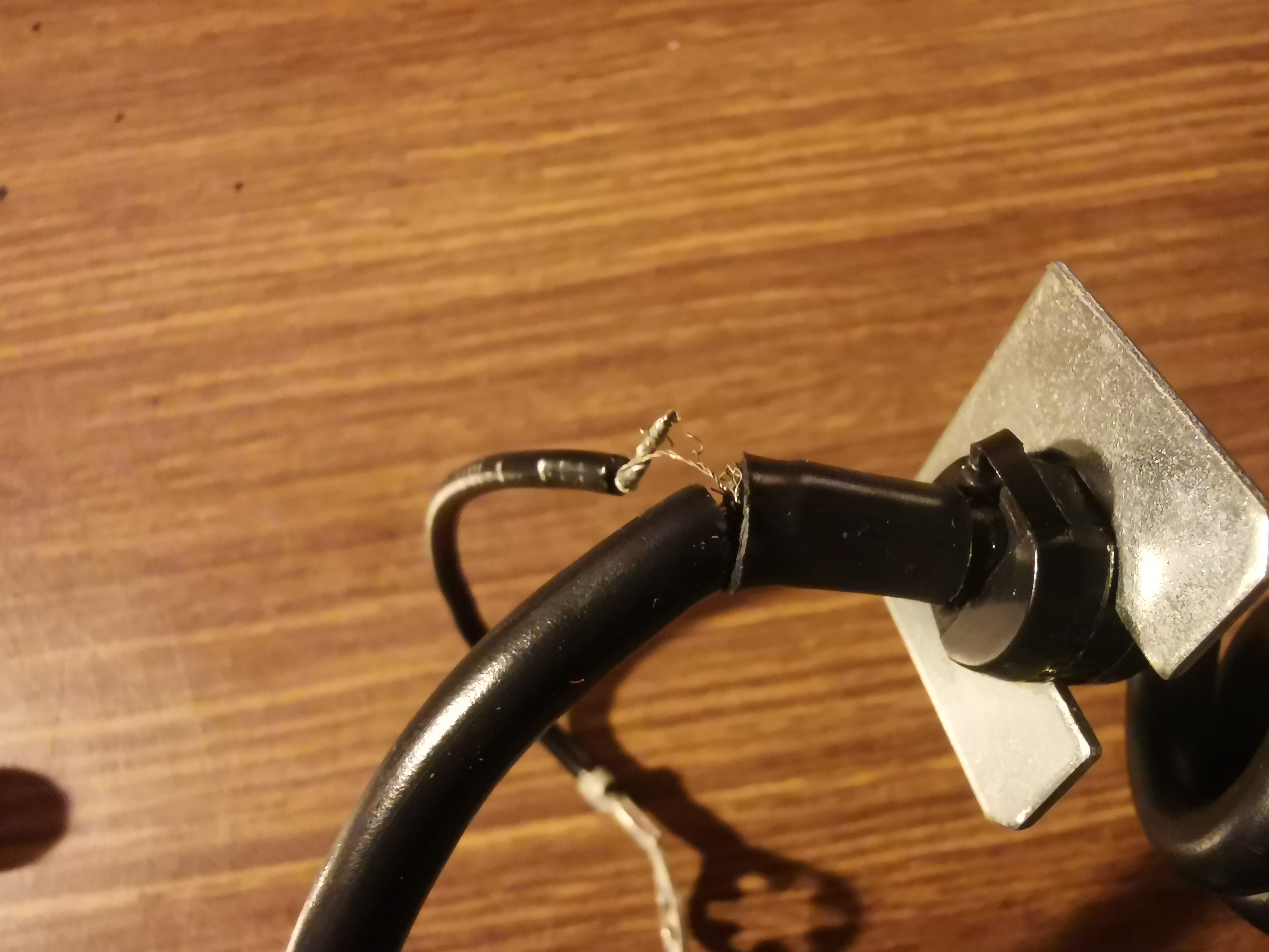

I'm worried about the original cable, as the ground connector seems to be very thin and frayed, though I have no idea on how to fix this without damaging too much. I have not tried an in-case converter, so that might fix it, but I like the external look of the cable.
This is most likely the cause of the problems.

Update: funny this, upon closing the keyboard, the ground connector snapped off- so now I also need help with repairing the cable, if anyone can help.

Spewing of text can happen for the following reasons
1. The chassis is not grounded properly.
2. The converter you built has a short.
3. The original controller on the keyboard is faulty.
To check the chassis grounding, use a loose piece of cable, connect one end to the shiny back plate (you can use tape to stick it on to the back) and connect the other end to GND on the teensy.
If that doesn't work, double check the teensy you've built. Check all connections and joints and make sure there's so solder bridge.
If it still doesn't work, use the internal converter method.
I'd start with this first before trying to diagnose point 3.

Thanks for the help, though no luck.
It seems to be spewing less, though. It's currently outside of it's chassis. There are no shorts on the teensy, from what I can tell.
Edit: I tried grounding it again, and it seemed to make no difference, as it just started spewing fast again.

And oh boy, the cable. Its not going to be fun, as upon further inspection, the wire seems to have snapped somewhere inside the cable as well, as there is no connection between the ground on the keyboard to the once attached nut-connector. I'm currently considering just doing an in-case conversion and purchasing a long and thick USB cable to coil myself. It sucks that the cable I have seems to be an earlier one, which means it's prone to fail sometime.

Oh, and I fixed the cable temporarily by tying the remaining strands of wire to another wire, which is working for the time being. I checked it's connection through the cable. Whilst I was checking though the keyboard, is the nut-connector supposed to be connected to ground, or is is just for the metal shielding on the din connector? As I have noticed that there is no connection between ground and the nut-connector.
JBert
31 Jul 2020, 10:36
If you're talking about that little metal plate clamping onto the cable: I'm pretty sure it's not connected to anything and is just meant to keep the cable inside. Only the little frayed wire with the loop on the end is connected to the cable's shield.
Another question though: how are those resistors wired? They seem to sit between the d0 pin and the cable, which would not be correct.

Athen wrote: 27 Jul 2020, 13:37 Currently, I have built a teensy 2.0 Soarer's converter...
How much building to you have to do? Are the surface mount components already soldered?
Athen wrote: 27 Jul 2020, 13:37...first without the pull-up resistors, and now with resistors...
Further to JBert's post, surely pull-up resistors are connected between a data pin and the supply voltage (VCC)?

Athen wrote: 27 Jul 2020, 13:37 Update: funny this, upon closing the keyboard, the ground connector snapped off- so now I also need help with repairing the cable, if anyone can help.
Looking at your picture, I wonder if this has been inexpertly repaired before. On yours the coiling of the cable seems to begin right at that metal plate. On mine there is about 100mm (about 4") of straight cable between the grommet on the keyboard and where the coiling starts. I also wonder if this ground connection is actually to a screen on that cable. As I don't have the problem with the fallen-ff ground wire I don't propose to strip mine back to find out but I think you will probably have to do that in one direction or the other and then, having re-attached the ground wire, put heatshrink over it to keep it neat and secure.

I just looked at the pics again. Your pull up resisotrs are wrongly set. I'd just remove them completely ...and try again ...

So going back a little, and ignoring the issue of the pull-up resistors, I had a thought - protective earth vs. signal ground.
Looking inside the keyboard enclosure, where the cable enters there is a separate wire that goes to a toothed eye, the same one that is in the 4th of Athen's original pictures and subsequently fell off. When this is properly attached it goes around one of the two screws that fix the metal plate on the bottom of the keyboard. The metal plate also has a ring around where that screw goes that is not painted (or has had the paint removed) so that toothed eye can make contact with that plate. At the other end of the keyboard cable this wire is connected to the metal shell of the 5 pin DIN plug. On the pinout for this plug on the PC & XT the shell is "proective earth (PE)".
So there is no connection inside the keyboard between this and the signal ground which is pin 4 on the 5 pin DIN plug. When connected to an original PC, presumably this protective earth is actually connected to earth. In the orihalcon converter this protective earth seems not to be connected to anything and there is no mention in the original Soarer's instructions about connecting it - that only mentions the signal ground.
So the obvious question is whether this is an issue. Certainly there is no point in worrying about that connection at the keyboard end if it is not connected to anything at the converter end. Or would it be wise for the converter end to tie this to signal ground to avoid the possibility of this plate acting as an antenna?

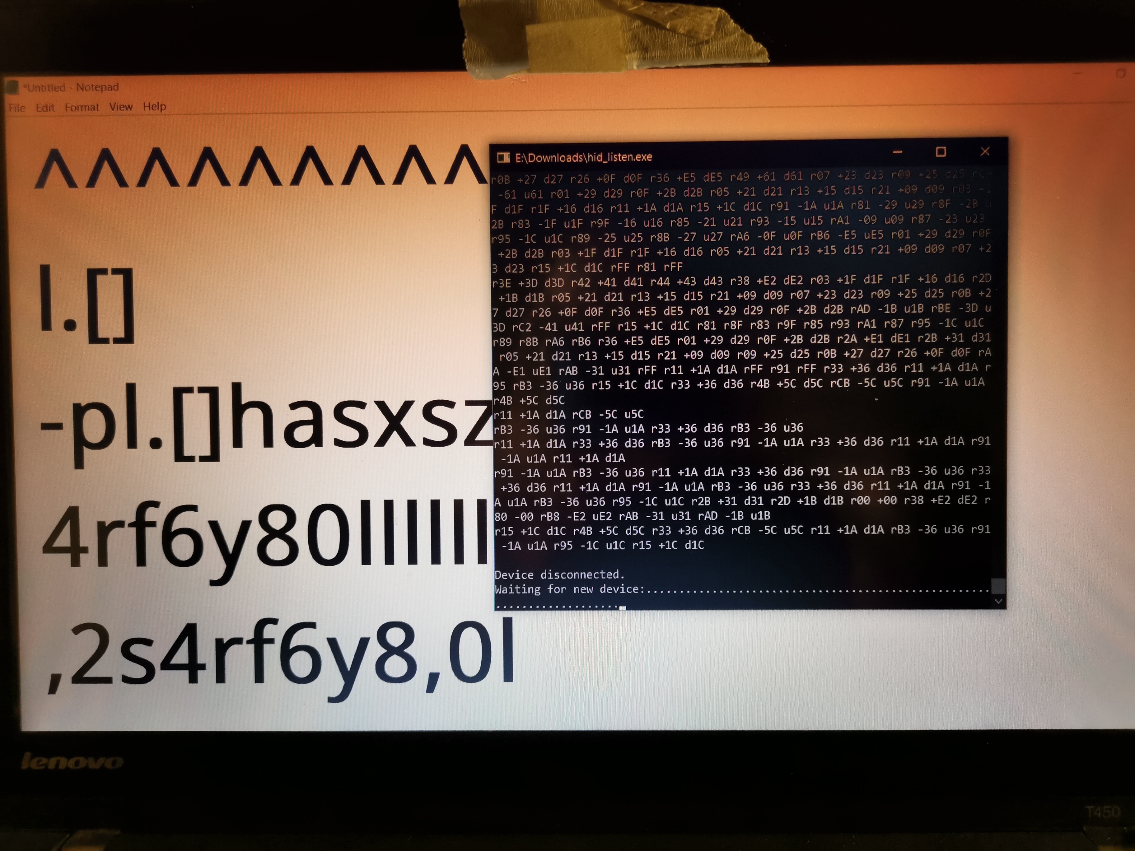

I got some time to remove the incorrect resistor, and that hasn't been able to fix anything.
I haven't deticiated an hour yet to trying an in-chasiss conversion, which I'll be doing very soon.
I have temporarily fixed the shielding (?) connector with some wire.
I'm not well versed in electronics, but the problem might be because I'm using a laptop- due to their poor grounding, but others seem to have gotten it working.
Anyways, this was a quick update, I'll post when I have done the in-chassis conversion.
Edit:
I'm starting to suspect that it might be the teensy, since it seems to glitch, more frequently, if there is any movement or impacts around it's enclosure.

Athen wrote: 07 Aug 2020, 08:45 I have temporarily fixed the shielding (?) connector with some wire.
Did you see my post above? Is the shielding actually connected to anything at the plug end. This is connected to the metal shell of the DIN plug, not the ground PIN (pin 4).

Edit: Disregard that last paragraph, my data wire snapped off
