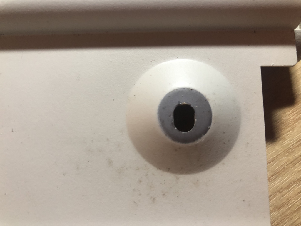

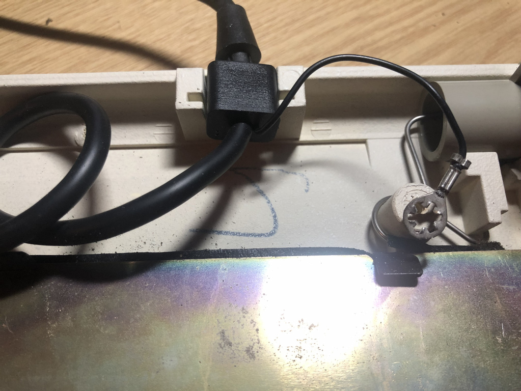

Ok, armed with that I took a look. The first picture I attach is the cable entry so most of the cable goes off to the left to the controller board and there is a single ground connection going to the right.
The toothed ring on the end of this is sandwiched between the plastic post and the metal plate on the bottom. This plate is painted, not be me, but has an area of bare metal exactly where this connection is as shown in the second picture.
