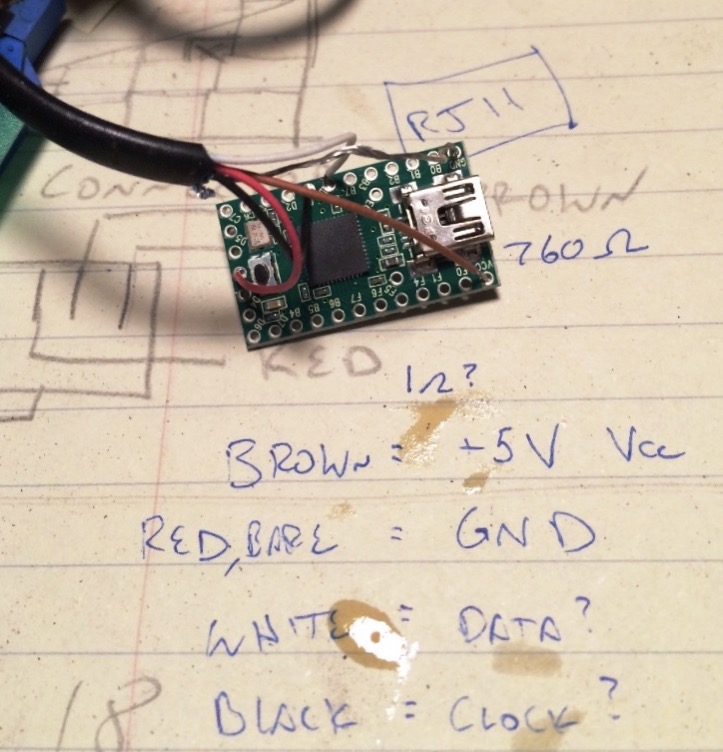

Brown = VccHaquilus wrote: 11 Aug 2020, 04:15 Hi there,
Inside the Model F XT Cable, you will find wires coated in Brown, White, Red, and Black. These cables are for 5v, Data, Clock, and Ground, but I could not find which color corresponds to which function anywhere on the internet. If someone could help me out with this, I would be forever grateful!
Red = Ground
White = Data
Black = Clock
Note of caution: Colours may vary, but the pin sequence on the XT connector (the blue one that goes into the XT Controller) will be the same.

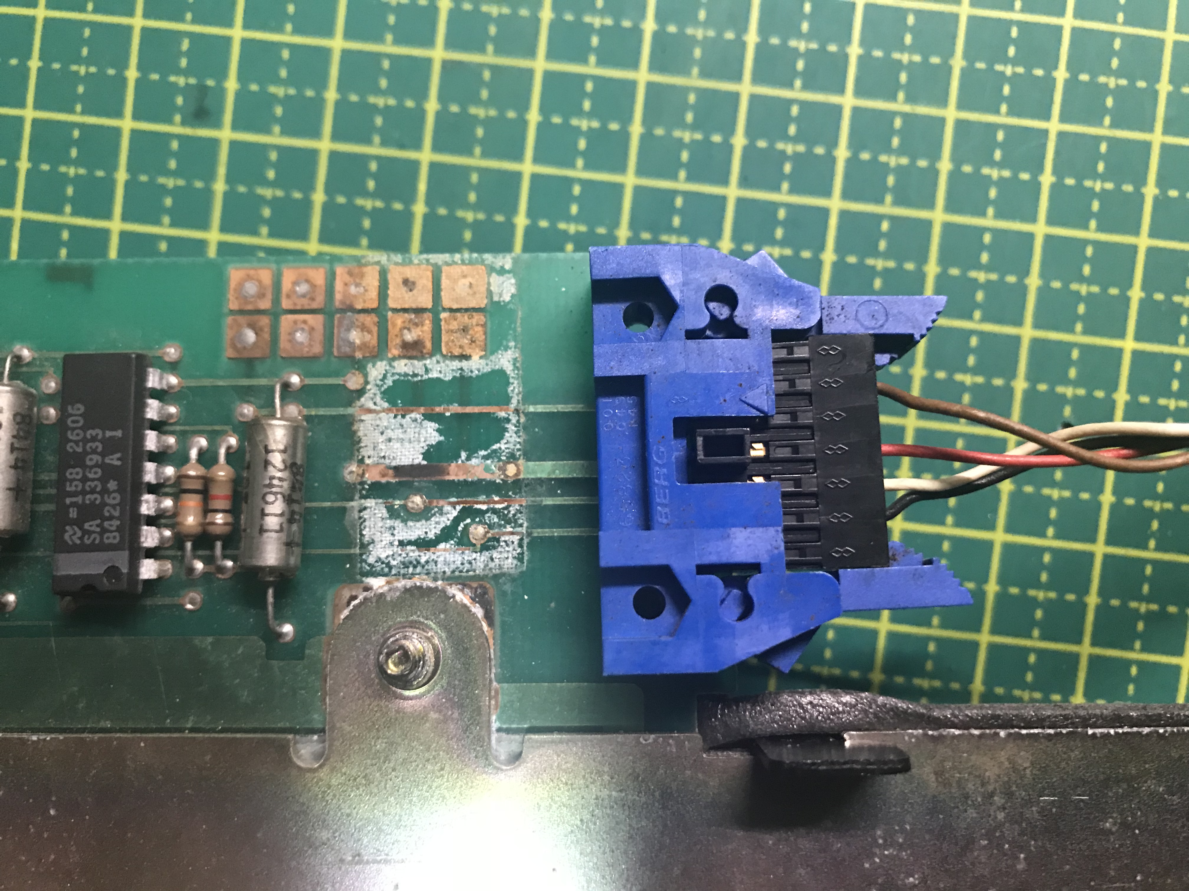

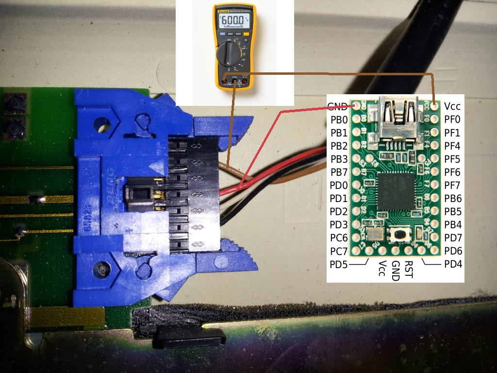

please refer to the pics below and hope this help
- got this from somewhere
- 1DAEEA6F-9A50-427F-971A-44406B03B7F3.jpeg (119.2 KiB) Viewed 2990 times
- from my xt
- E8527FDD-35EB-4E75-B2F6-81E92048AEC3.jpeg (2.6 MiB) Viewed 2990 times
