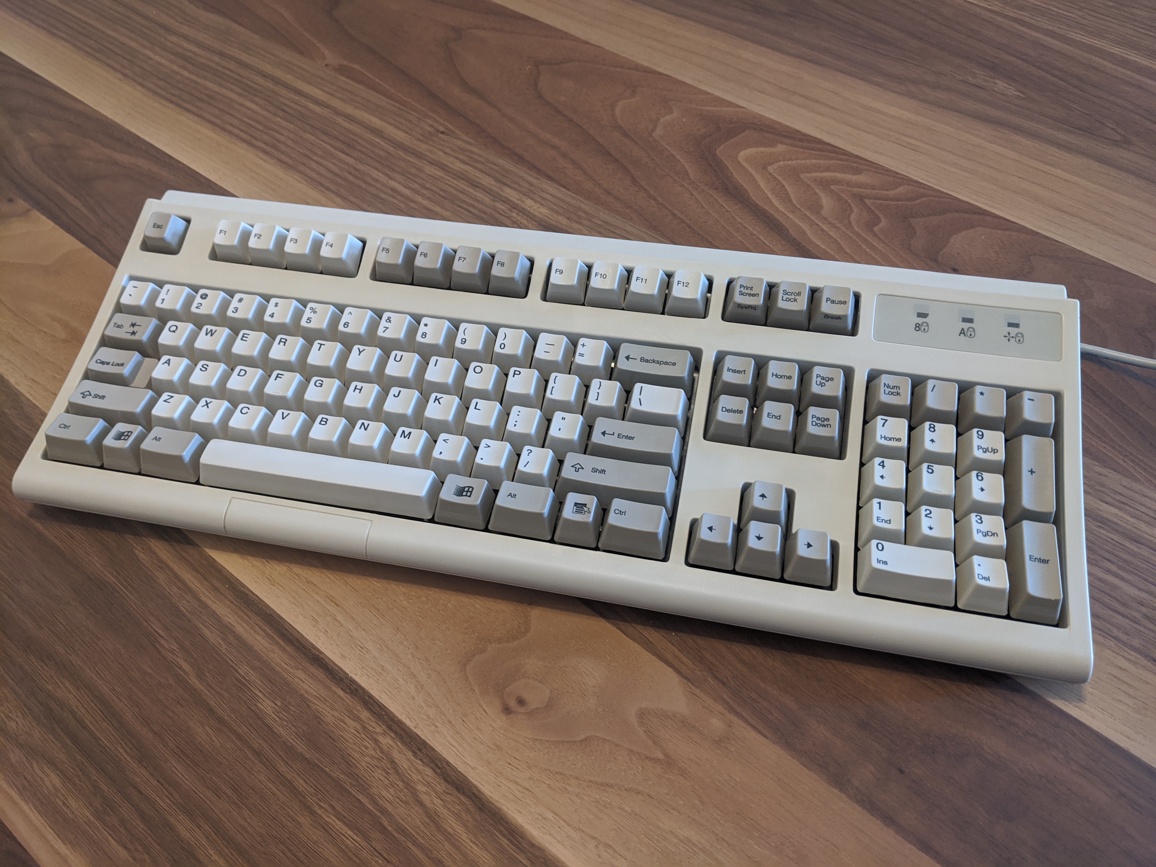

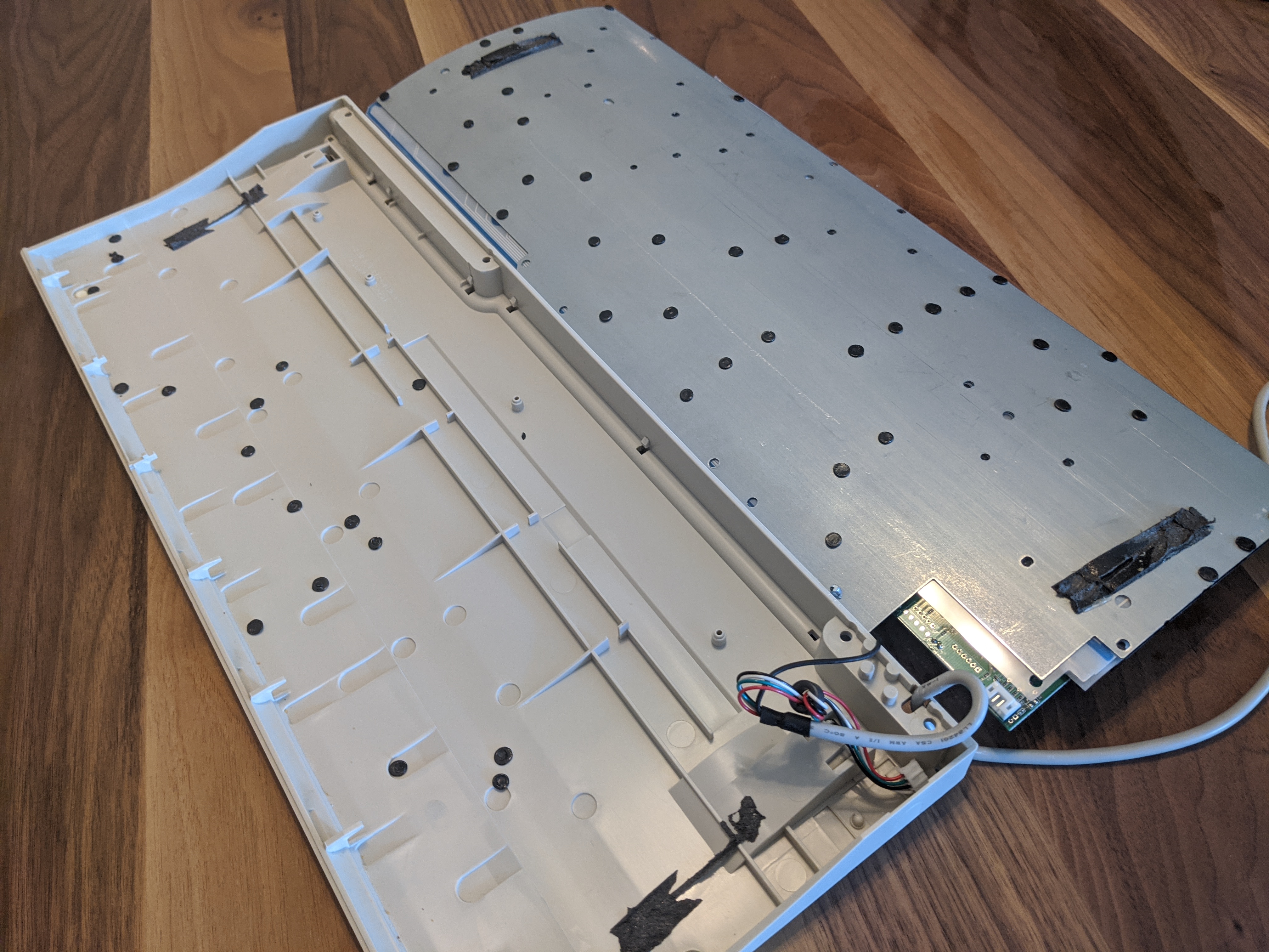

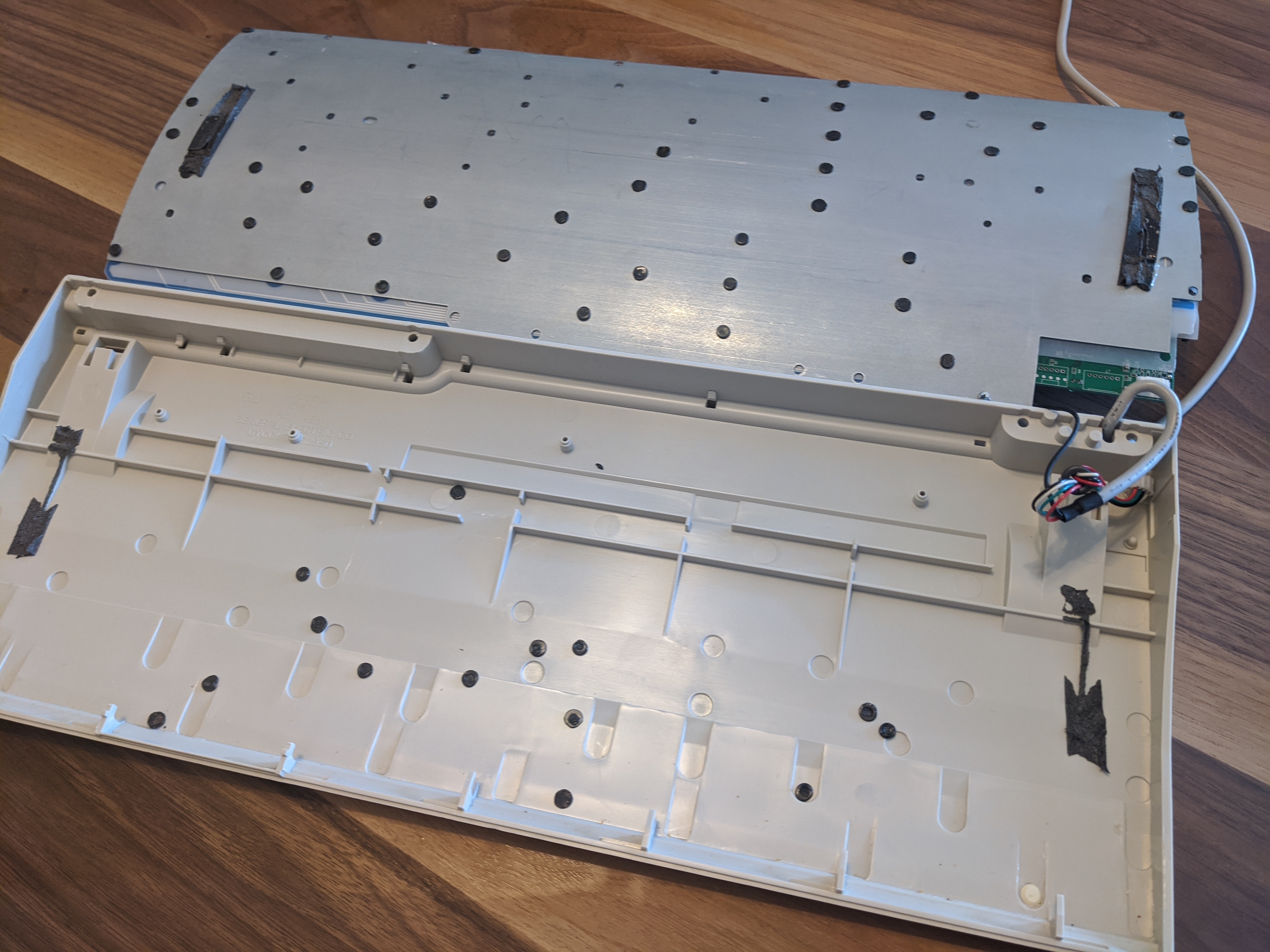

Hello,
This is my first post here. Just like others on this forum, I'm a keyboard enthusiast as well. I have a Model M (42H1292), Model F AT (converted to USB) and plenty of other modern mechanical keyboards. For the past 3 years, I've owned a Unicomp Ultra Classic (membrane buckling spring) keyboard that I've used time/time. I've noticed - slowly over the years, an increase in "plastic debris rattles" when I would replace this keyboard with my daily driver. Today, I opened up the keyboard and I was surprised to see many plastic rivets that broke off :shock: (please see the pictures). I quickly opened up my 1996 Model M to compare and only found one.. yes one rivet that broke off. I wanted to make this post here to see if other Unicomp owners noticed this. This keyboard is only ~3 years old and it's already doing way worse then my 1996 IBM Model M.
ps. All my keyboards are stored in a cool & dry place (AC). Thanks

Time for a bolt mod!
ddrfraser1
16 Aug 2020, 21:34
Yep. To give more context to JPs comment, this inevitably happens to all model Ms. It's one of the few design flaws. Look up how to do a bolt mod on youtube. It's pretty easy once you get your head around it and once your done, your keyboard will be even better than before. The youtube tutorials will point you in the right direction as far as tools and materials needed. If you have trouble, we'll be happy to help! Good luck!

The springs in the model F/M are always under tension with the keycap on. A model M/F flipper will lay flat without a keycap.
Resting down on the pcb/membranes.
With a cap, its up, the spring is flexed with the flipper up. This means the spring is flexed. So the springs are always pressing up between the plate and the barrel plate.housing. The keyboard with keycaps always has a desire to separate and fly apart. Not that much force, but I imagine with pressing keys which both releases pressure in some areas and increases in others, flexes the board and general plastic materials. Seems like the flex over time would shear those rivets.
Not sure if the back plate of the model m flexes, but its not hard to me at least, to imagine how these forces over time would create shear forces on the rivet.
Not 100% sure though.

Also if you want to fix your rivets, do a screw mod not a bolt mod. Bolt mods take forever and produce less uniform results than a screw mod. These are the screws you want:
