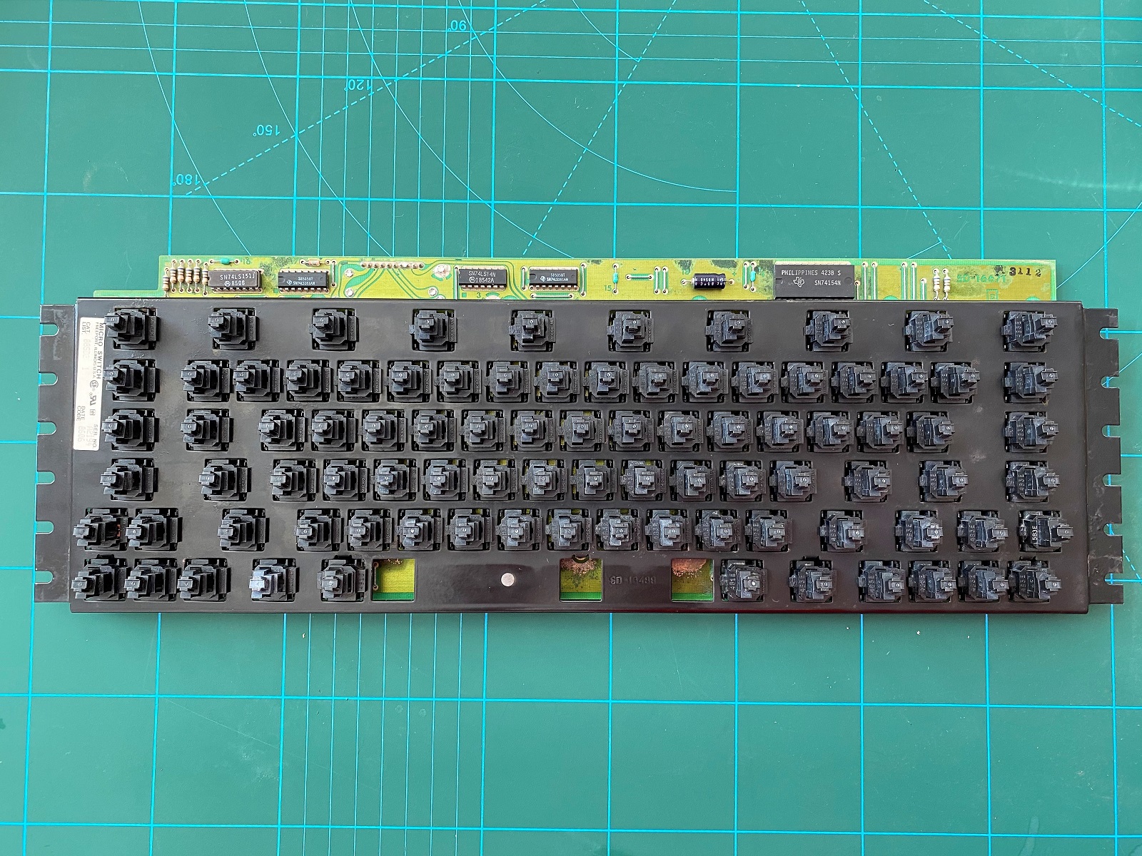

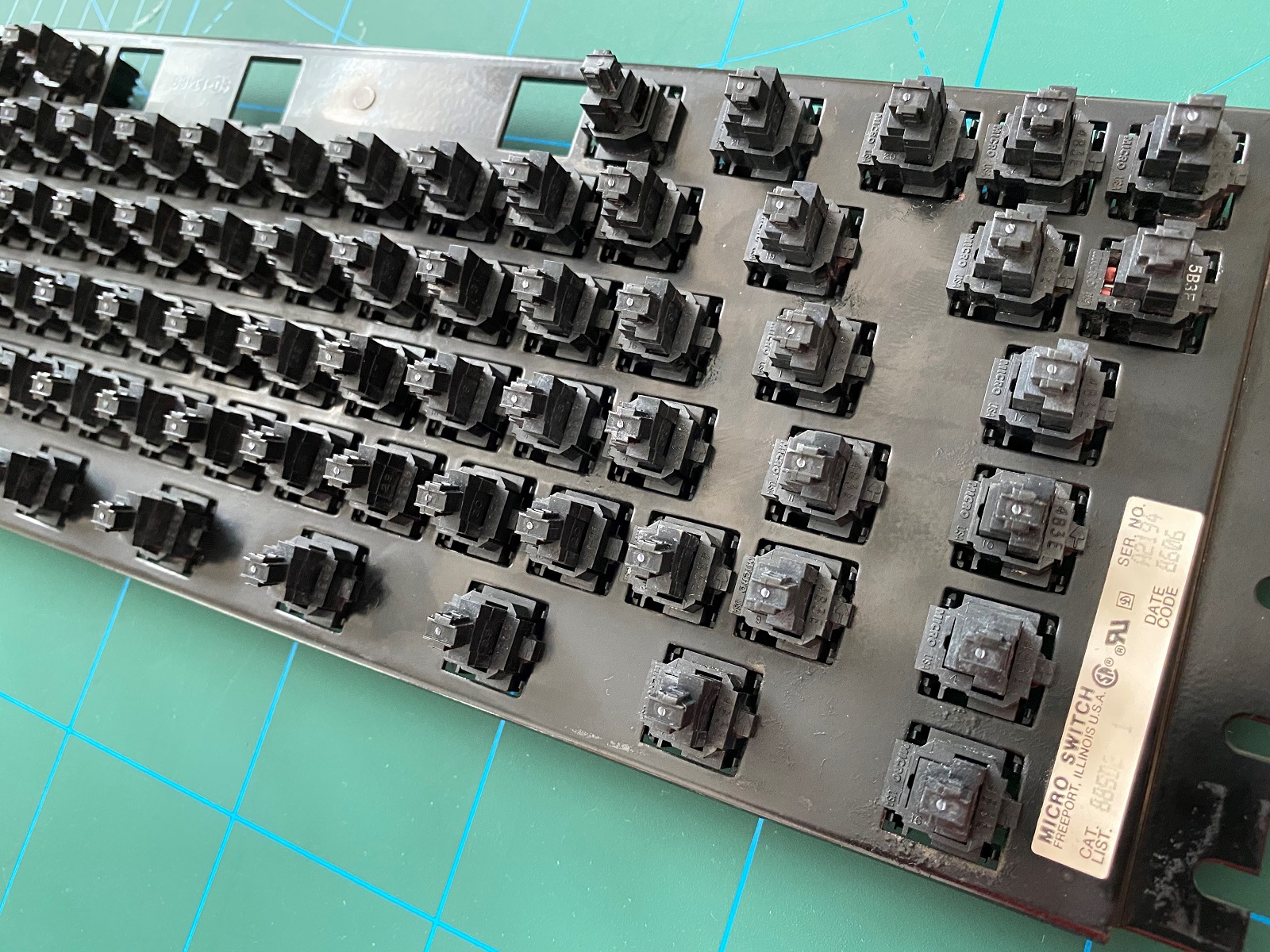

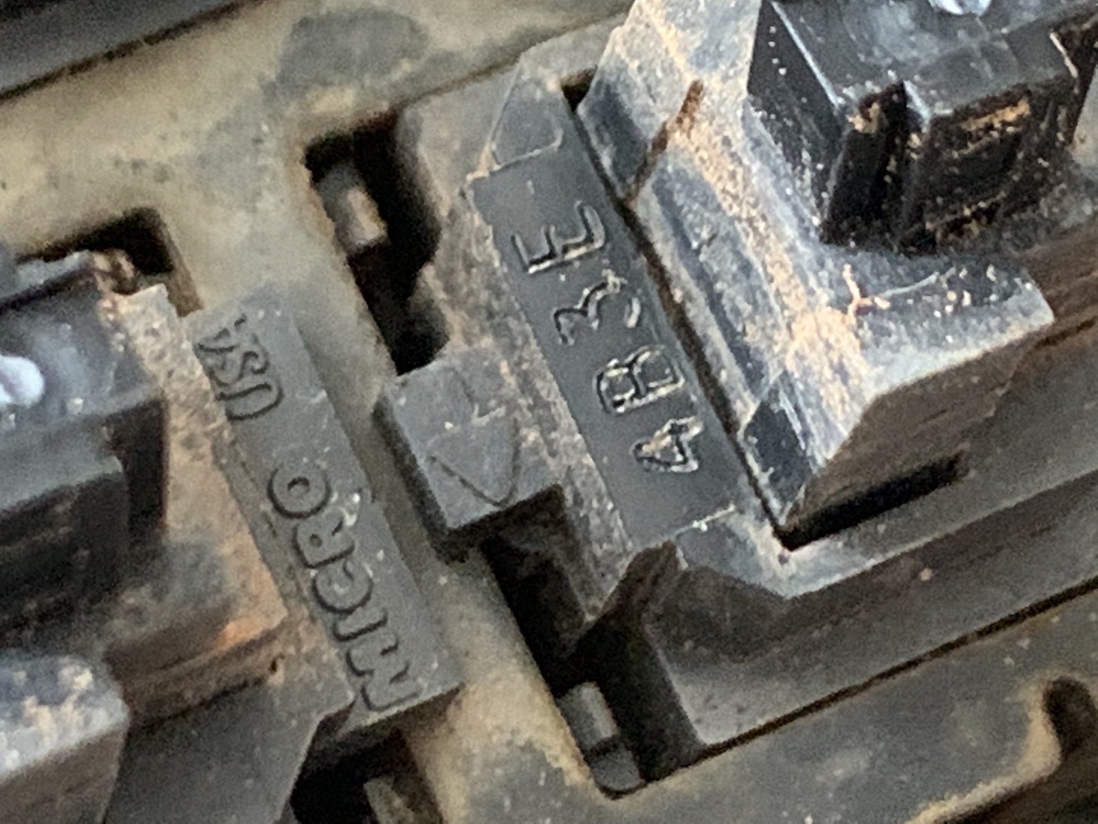

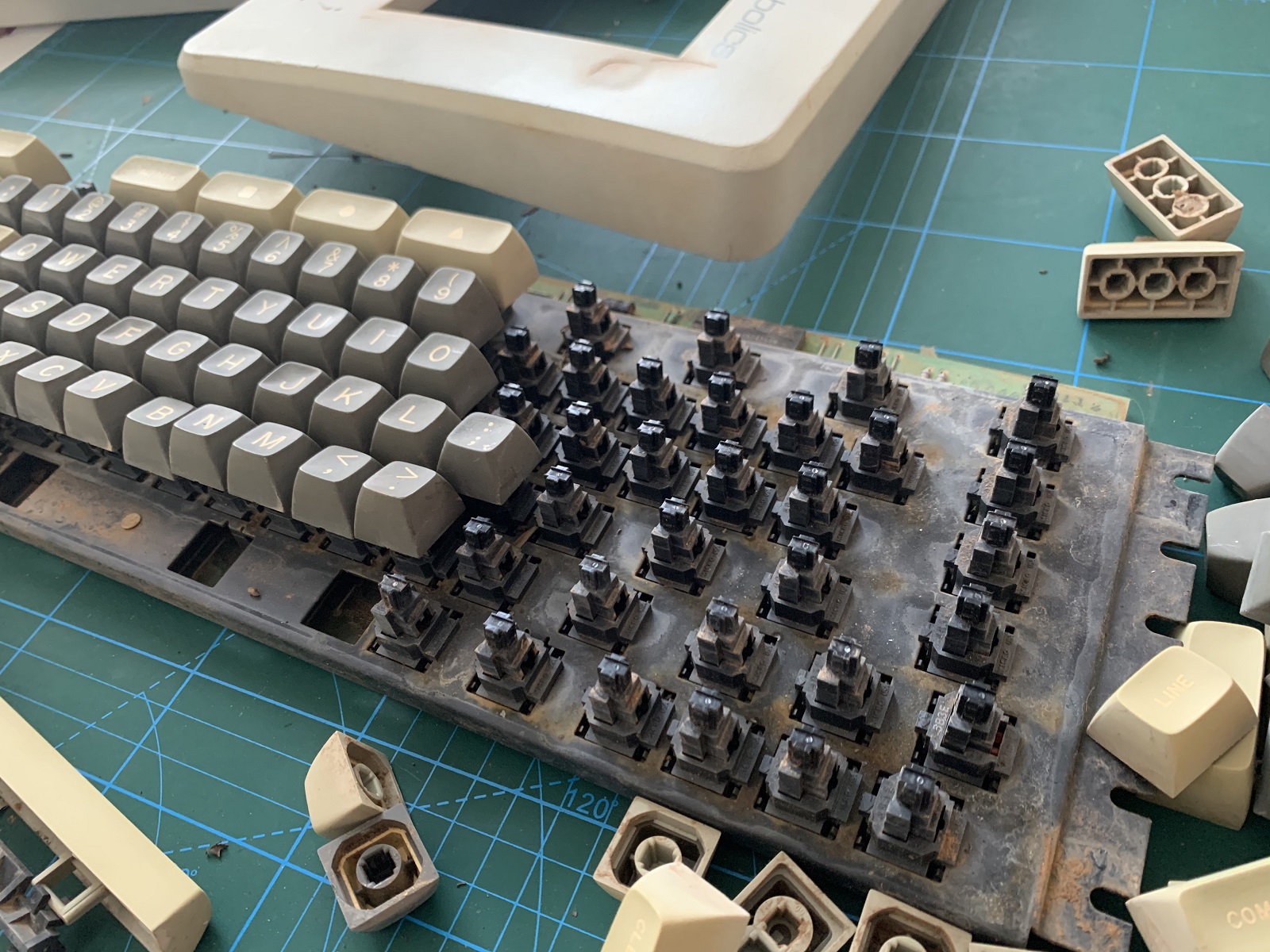

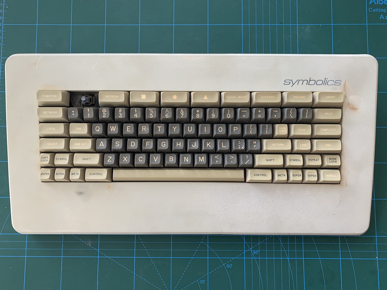

Well, I was the one who acquired the Symbolics 364000 (3600) from eBay recently. I thought it would make a good restoration project but let's see where I can get to this. To say these key switches are "scratchy" is an understatement as they are covered in sand. I am not even sure if these switches can be opened or properly cleaned. Any advise is appreciated.
They are Micro Switch SD series switches with most being of type 4B3E.
This will take me a while so these are the "before" pictures:
Symbolics 3600 keyboard top

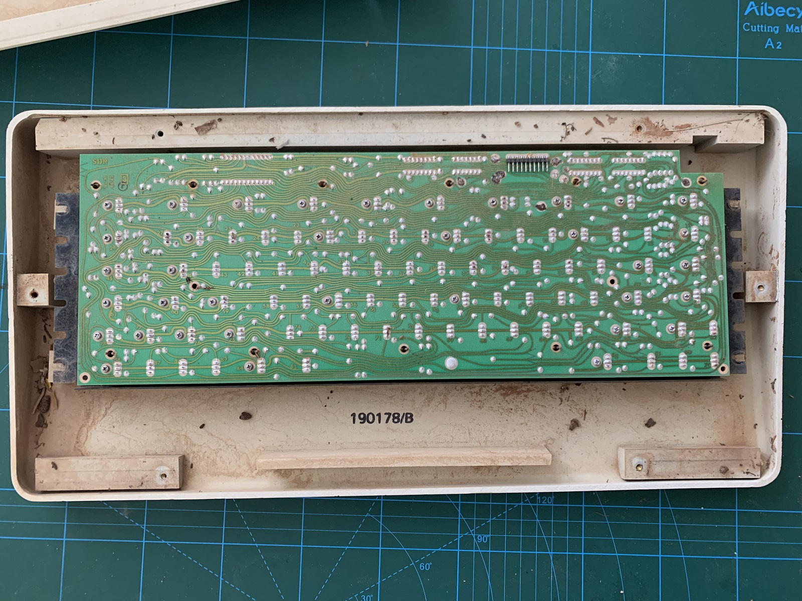

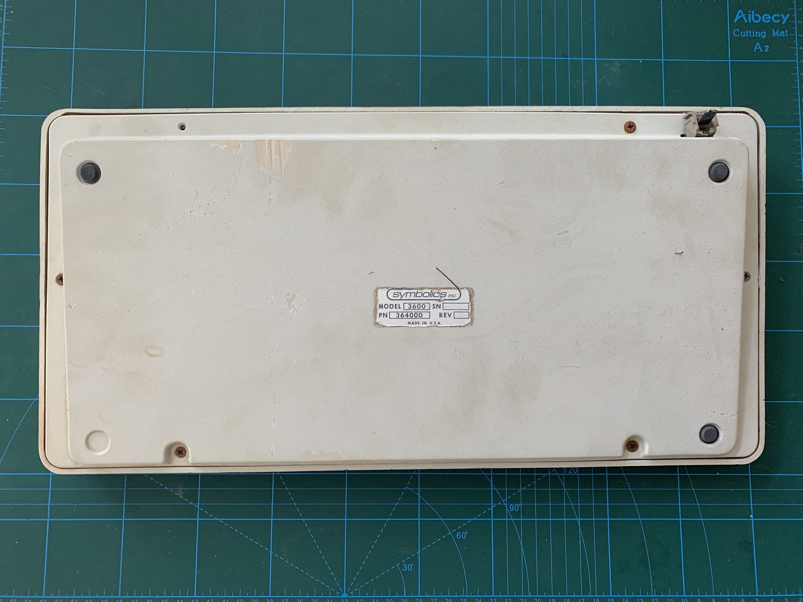

Keyboard rear
Keyboard rear

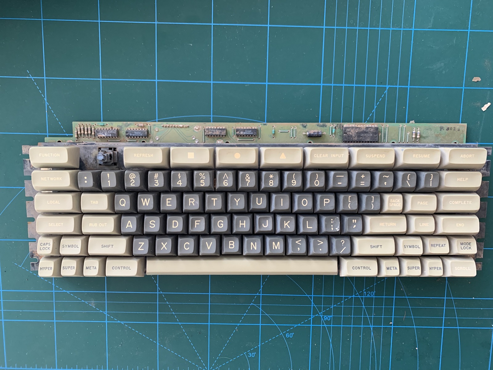

Keyboard mechanism top
Keyboard mechanism PCB
Keyboard condition
Keyboard condition
Symbolics3600before-key switches.jpg (603.03 KiB) Viewed 4877 times
Micro Switch SD Series switch

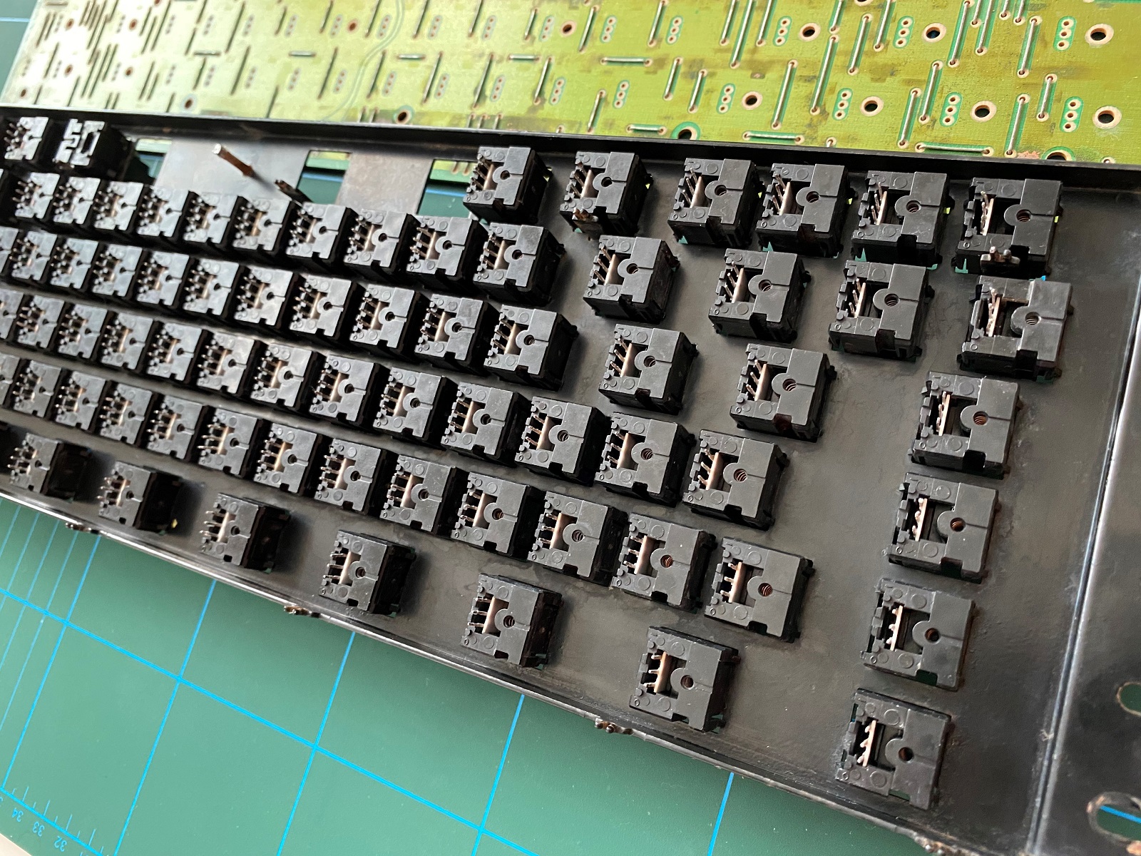

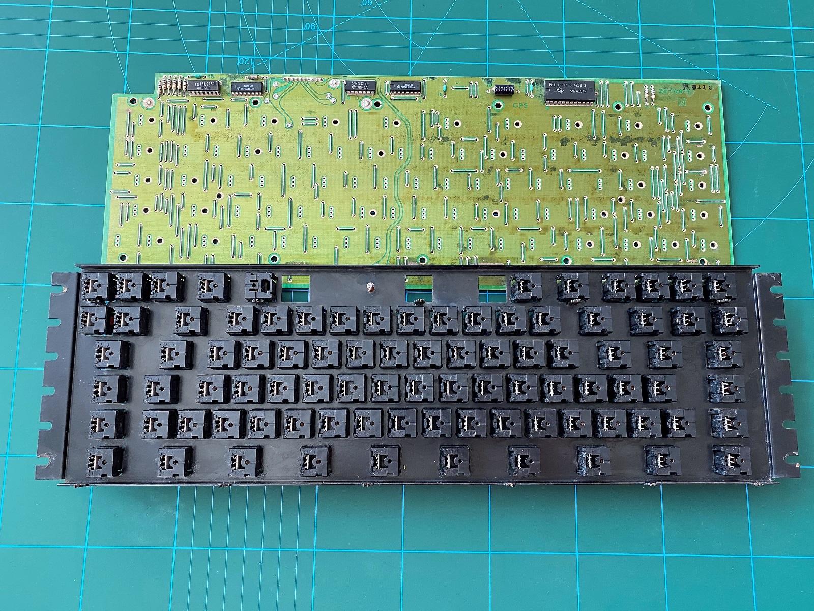

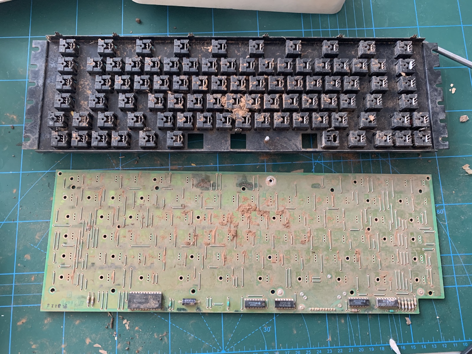

Update: After desoldering all switches from the PCB. Ya, a little bit dusty there...
Mud under switches.
Mud under switches.
Symbolics3600before-mud under switches.jpg (810.63 KiB) Viewed 4823 times

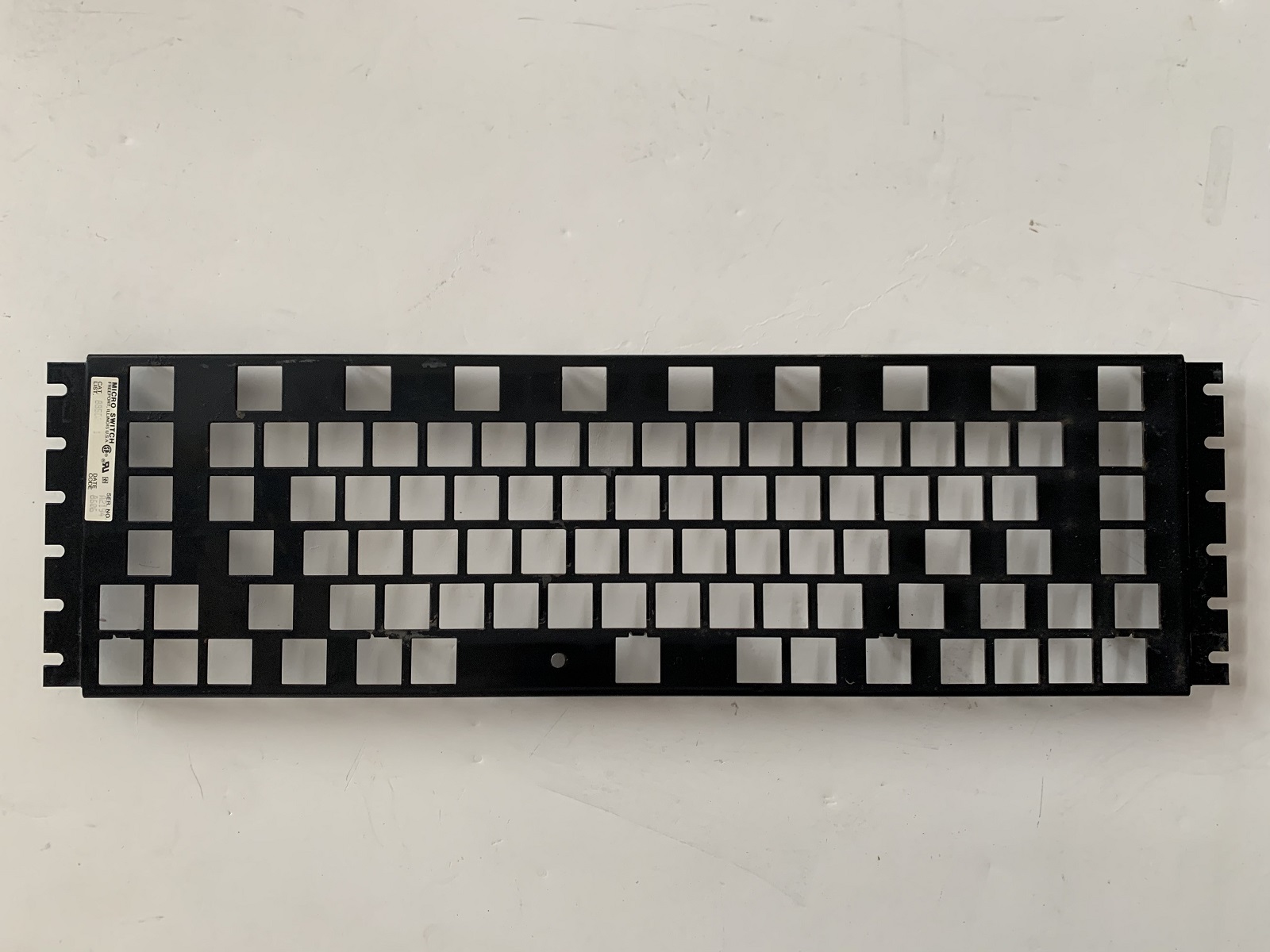

The switch plate:
Symbolics3600After-switch plate.jpg (301.57 KiB) Viewed 4742 times

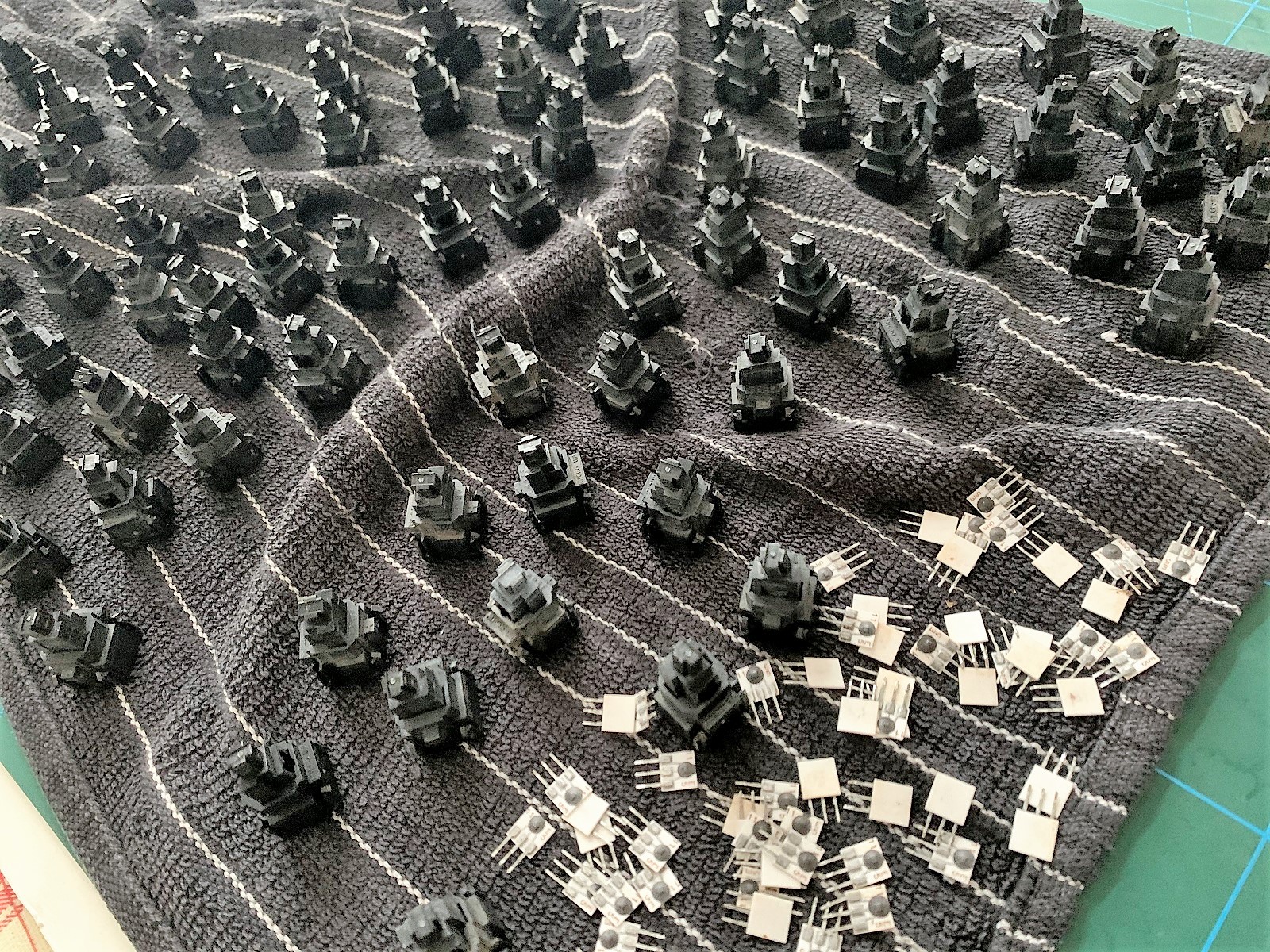

First round of switches washed that are drying. They are a hell of a lot smoother as the odd one didn't even return when depressed before. I'll have to do this a couple more times. First round was water in an ultrasonic cleaner followed by a 99% alcohol bath to remove the water.

Weezer wrote: 28 Aug 2020, 19:09 All things considered, it looks better than I expected.
Yes. While the switch plate looked rusty, it was actually red dirt/dust. The key switch mounting plate actually came out almost like new. The switches themselves will be a whole other matter.
After switch plate
After switch plate
Symbolics3600After-switch plate.jpg (301.57 KiB) Viewed 4779 times

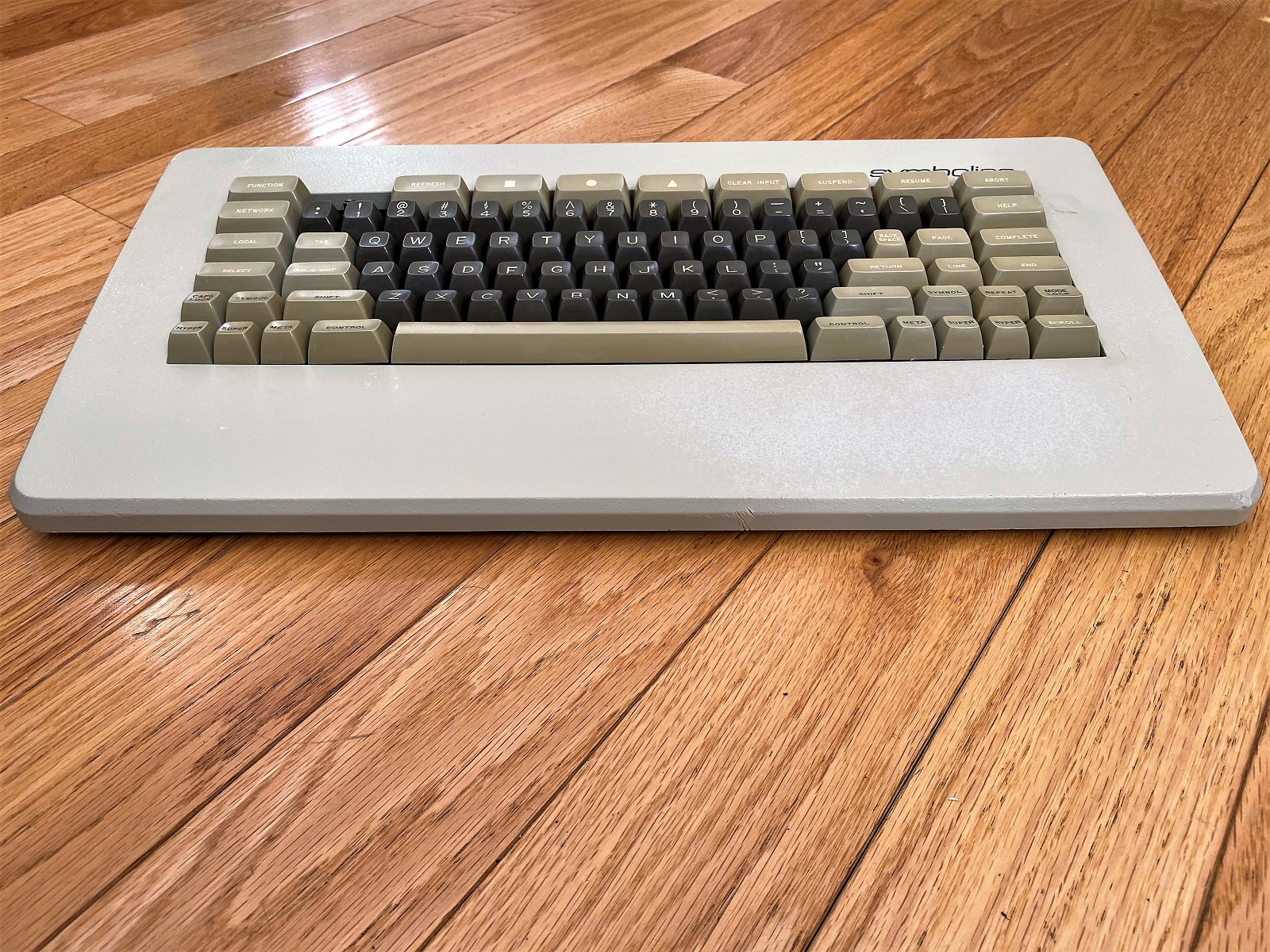

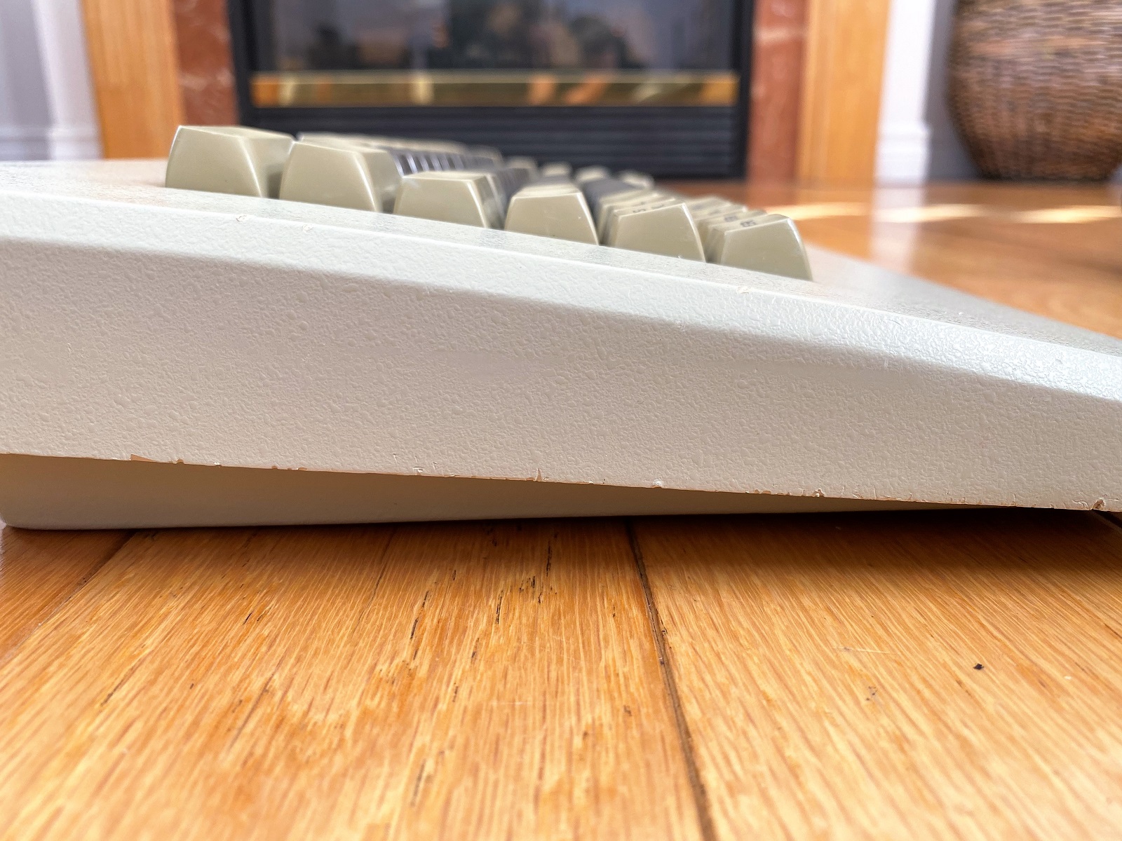

Oh man, that's such a nice keyboard, glad to see it in the correct hands. Would you mind take some pics from the side when you have it done?

PlacaFromHell wrote: 29 Aug 2020, 00:04 Oh man, that's such a nice keyboard, glad to see it in the correct hands. Would you mind take some pics from the side when you have it done?
Will do. No problem.

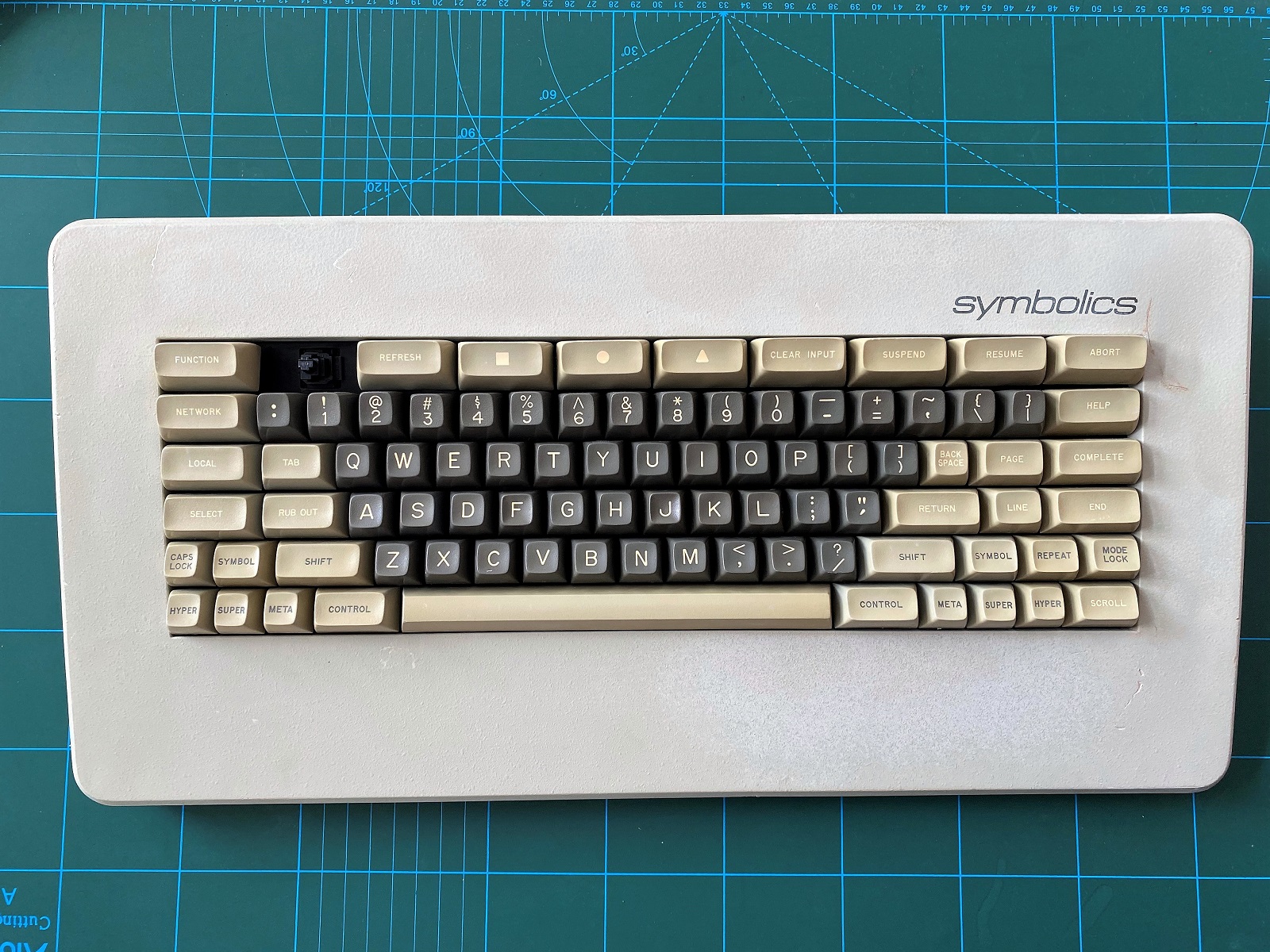

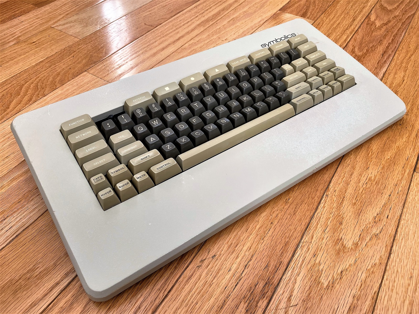

Done.
Looks and feels great considering what it looked like when I got it. I just wish I had the missing "ESCAPE" key but otherwise, I will try to convert it at some point but make sure it is reversible in case I find a Symbolics 3600 series computer to go with this. If anyone has the original keyboard cable they are not using, I'd love to buy it from you.

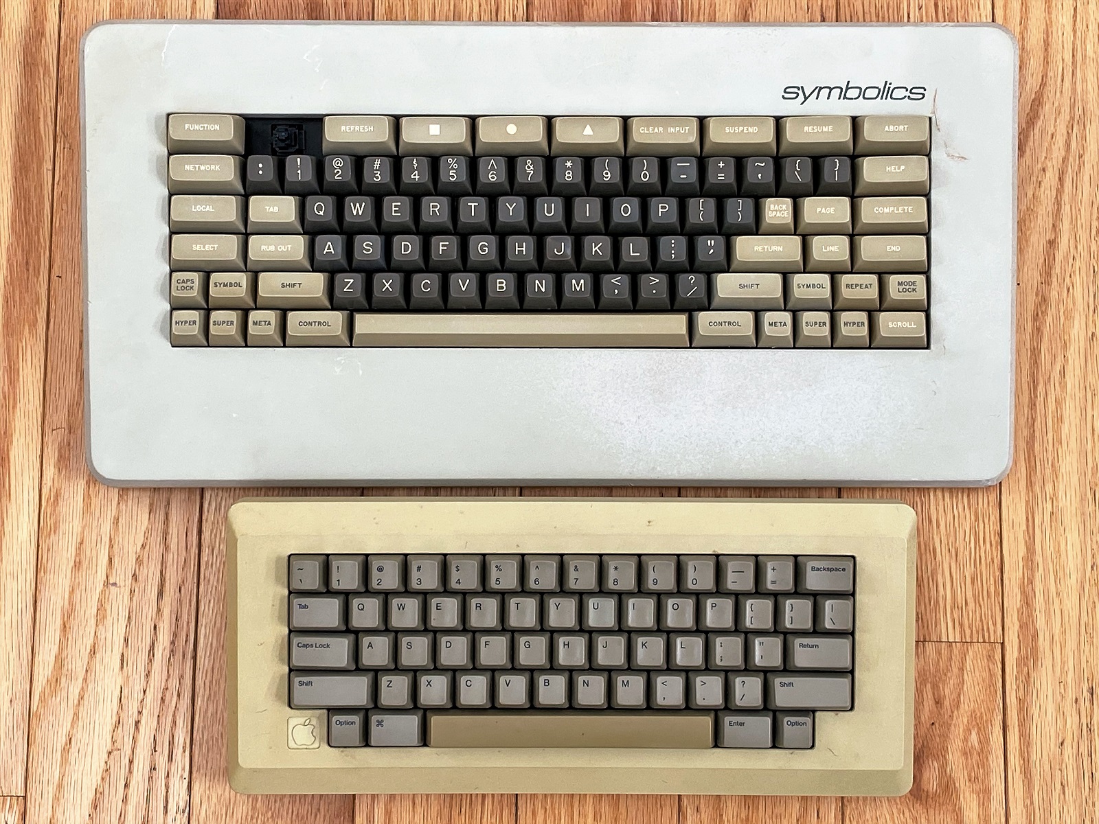

I took a picture of it next to an Apple M0110 Macintosh 128k keyboard as I always thought they might be sort of similar sizes but you can see the Symbolics keyboard is actually much bigger comparatively. The case is made out of a painted composite wood material, I think, which adds some weight to it as well. It's a well built keyboard.
PlacaFromHell
31 Aug 2020, 00:37
Impressive! I didn't expected such a fast work, also it came out very clean. Thanks for the side picture, that curve is unique.

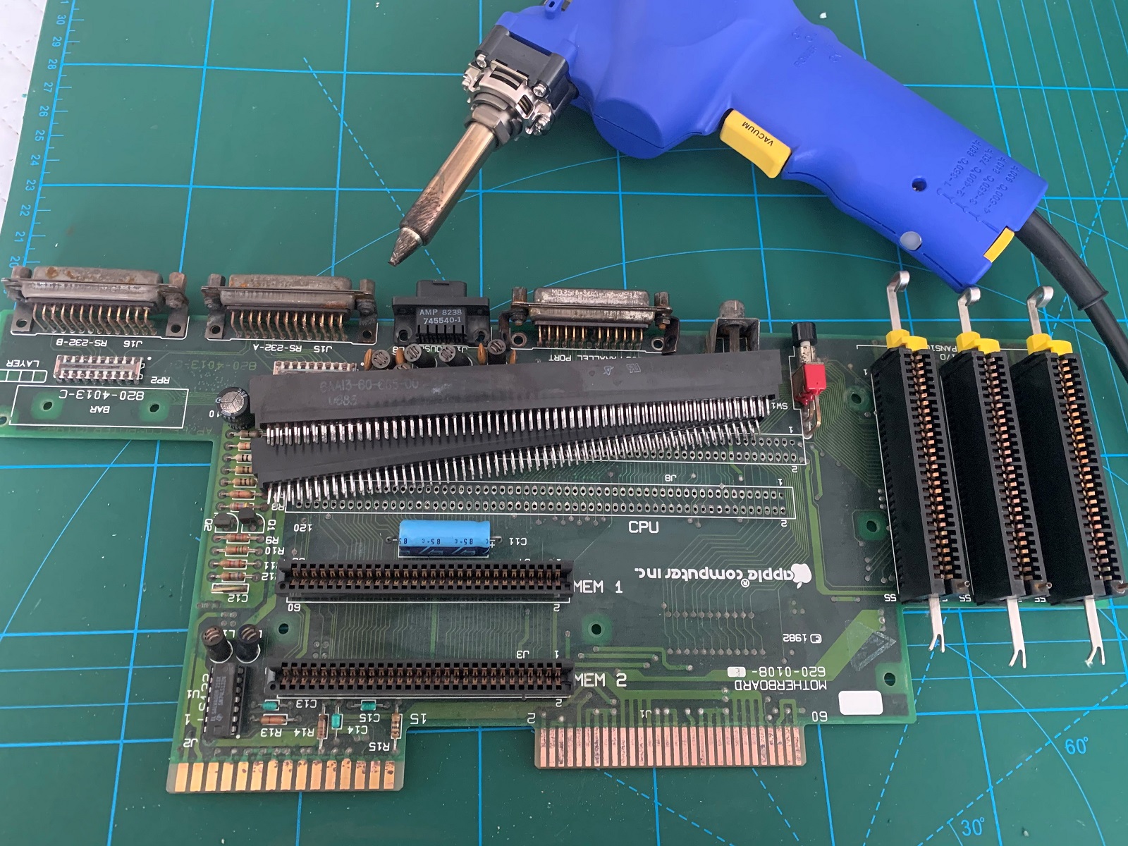

Thanks. There were quite a few steps but I wanted to get this out of the way as I have a few other projects to get to. Thankfully I have a Hakko desoldering gun to remove the switches or it would have taken me forever AND I would have likely done damage. Worth every penny (picture attached for when I was restoring an Apple Lisa).
