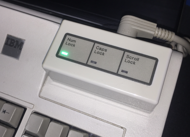

I would add on one or maybe both sides of the board pads for on-board lock leds, with the same spacing as the regular model M leds.
That way, add a case and a legend sticker and you can get a more compact version of what I use for my F/M-122's.
lock leds.png (564.64 KiB) Viewed 10852 times
Mine is just a regular off-white project box with the promicro and leds inside. It is attached magnetically to the F/M-122 case.
It could also be interesting to have a version of the board with the on-board connector rotated 90 degrees, in my case I have it that way as you can see.
For the case, I'm pretty sure someone here could make a fine 3D printed design.

inmbolmie wrote: 05 Sep 2020, 17:55 I would add on one or maybe both sides of the board pads for on-board lock leds, with the same spacing as the regular model M leds.
Yeah, that's a good idea about the lock LEDs. Since they are through hole, you could put them on either side of the board. Finding space for the resistors might be harder, but the box you have looks pretty big. That's a really clean solution by the way. Good work on it.
I could easily design it with the PS/2 connector coming out of another side of the PCB. It would make it a lot larger though. All the cases I've found are big enough to fit the PS/2 connector on any side. Keep in mind this would significantly increase PCB costs (by about triple). My fab charges $5 per square inch for 3 boards. Using my "slightly cheaper" case above at 1.3*2.8 = 3.64 square inches, that would cost $18.20 for three boards. For reference, the V1 prototype was 1.39 square inches, and I paid $13.90 for six.

06 Sep 2020, 11:01
dorkvader wrote: 06 Sep 2020, 04:21
I was thinking more in SMD leds with their smd resistors, through hole would be a little bulky and it's not that hard to solder a couple of SMD components. Can be both things at the same time really, simply putting the holes plus the SMD pads.
