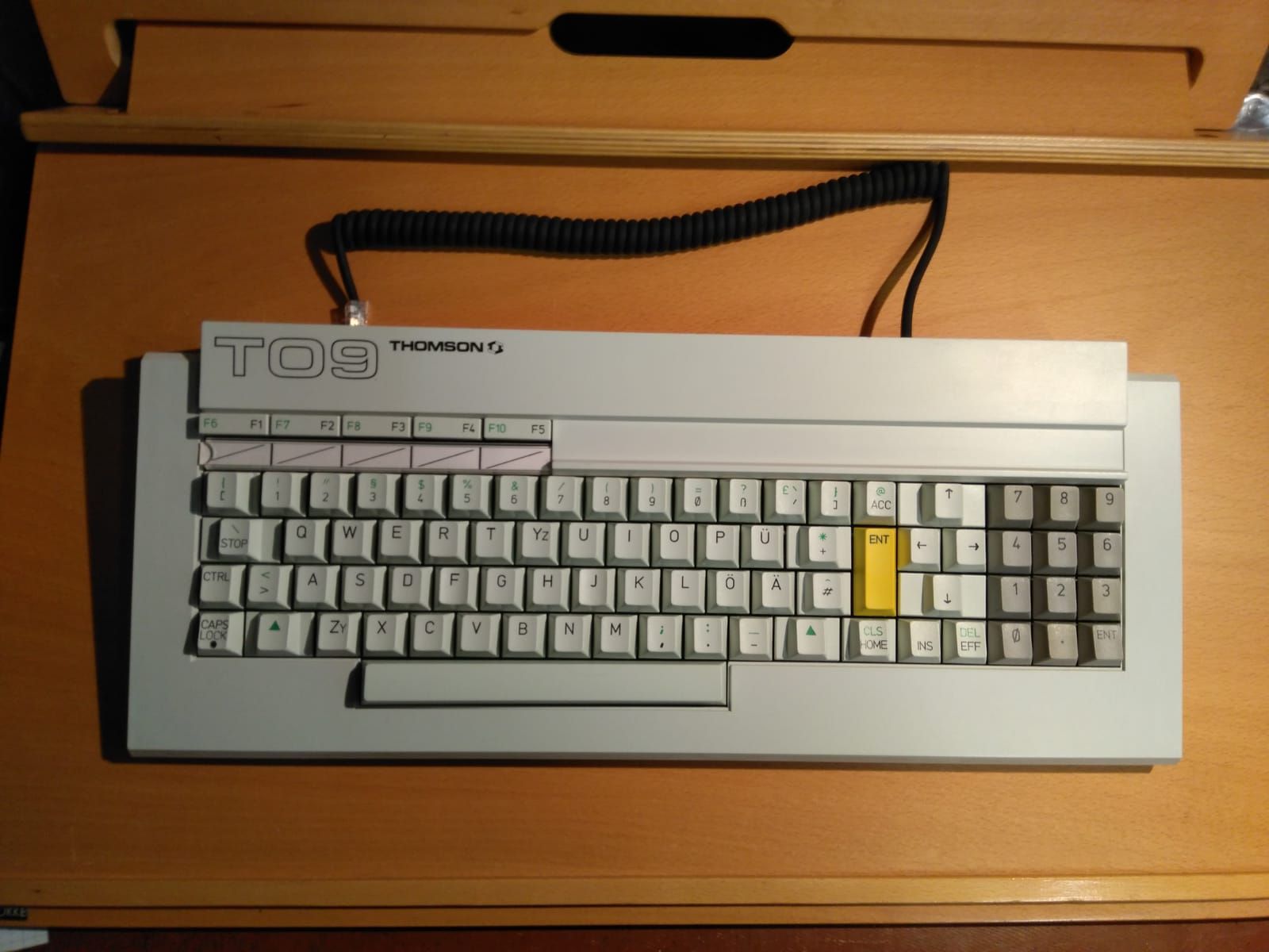

Hey guys,
anyone got experience with one of these boards, by any chance?
to9 2.jpg (86.21 KiB) Viewed 9505 times
It's from a Thomson TO9 Computer and has a 6 pin RJ-style connector. It's quite nice looking and has vintage MX Blacks, so it'd be nice to get it working somwhen at least...

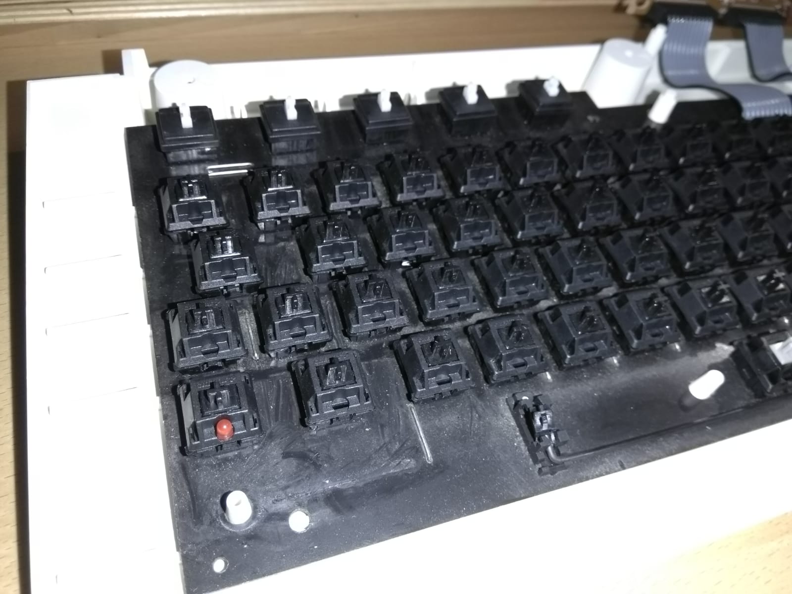

Do you by any chance know, what Switches they used for the Fn keys? They look like M9, but with a weird top housing...
to9 3.jpg (156.84 KiB) Viewed 9447 times
Took this one before cleaning, sry for the image quality
Myoth
08 Sep 2020, 19:14
TNT wrote: 08 Sep 2020, 18:10 Do you by any chance know, what Switches they used for the Fn keys? They look like M9, but with a weird top housing...
They're Cherry M8 switches :) wiki/Cherry_M8

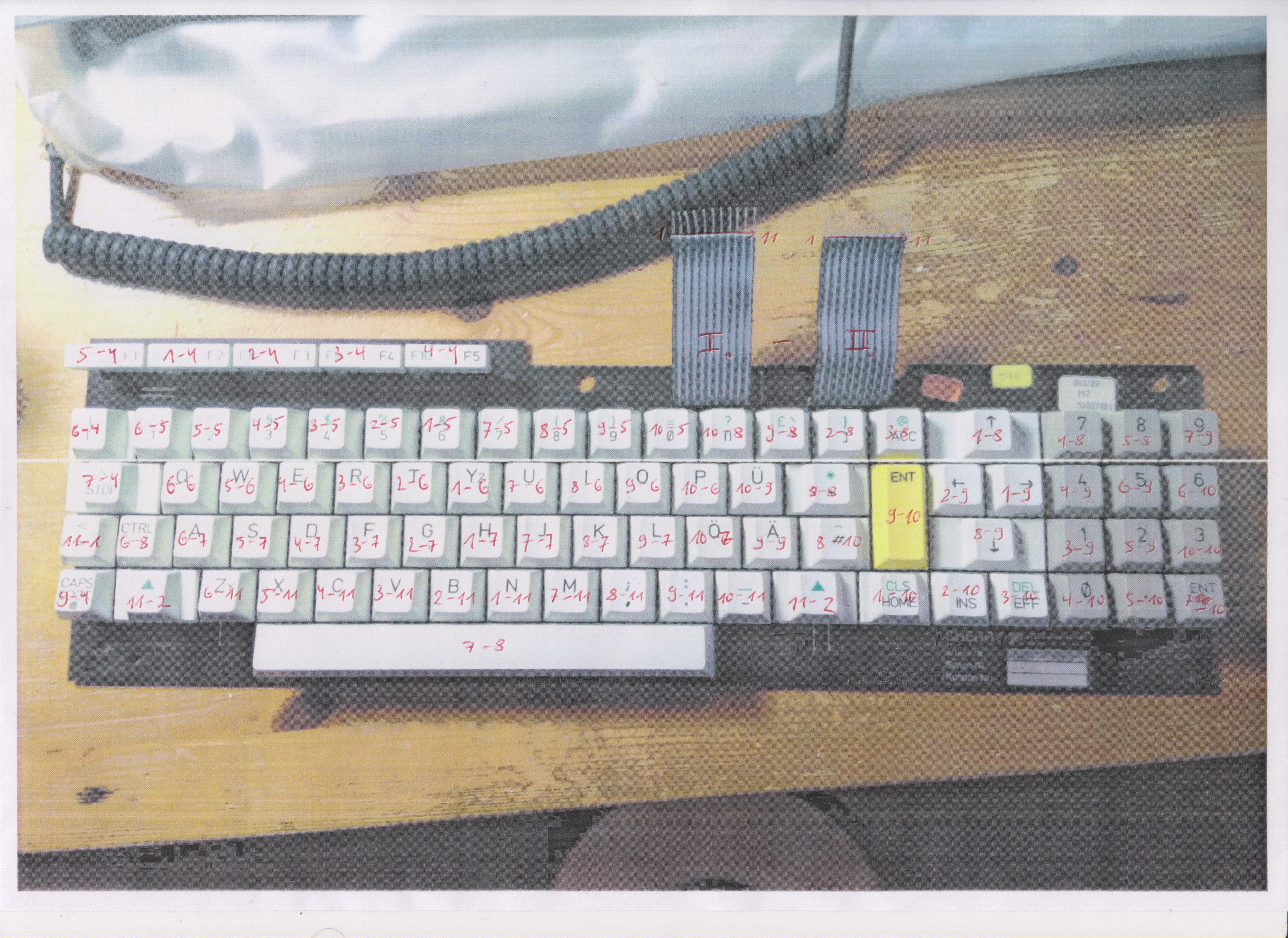

Ok, I procrastinated for an eternity but finally came around to do this. I always assumed matrix and controller unit were on separate boards and therefore could be easily separated to make the board brainless, essentially. It turns out they are, so you just have to unplug the two ribbon cables on the top side of the PCB to make this thing usable. Not a real conversion, but entirely non-destructive and easily reversible. Here are the results (a.k.a. the mapped out matrix):
The picture looks like that because it's a scan of my notes. I just wrote the pinouts directly onto a picture of the board I printed out and had to fiddle around a bit to make the fineliner readable on the digitalized version.
