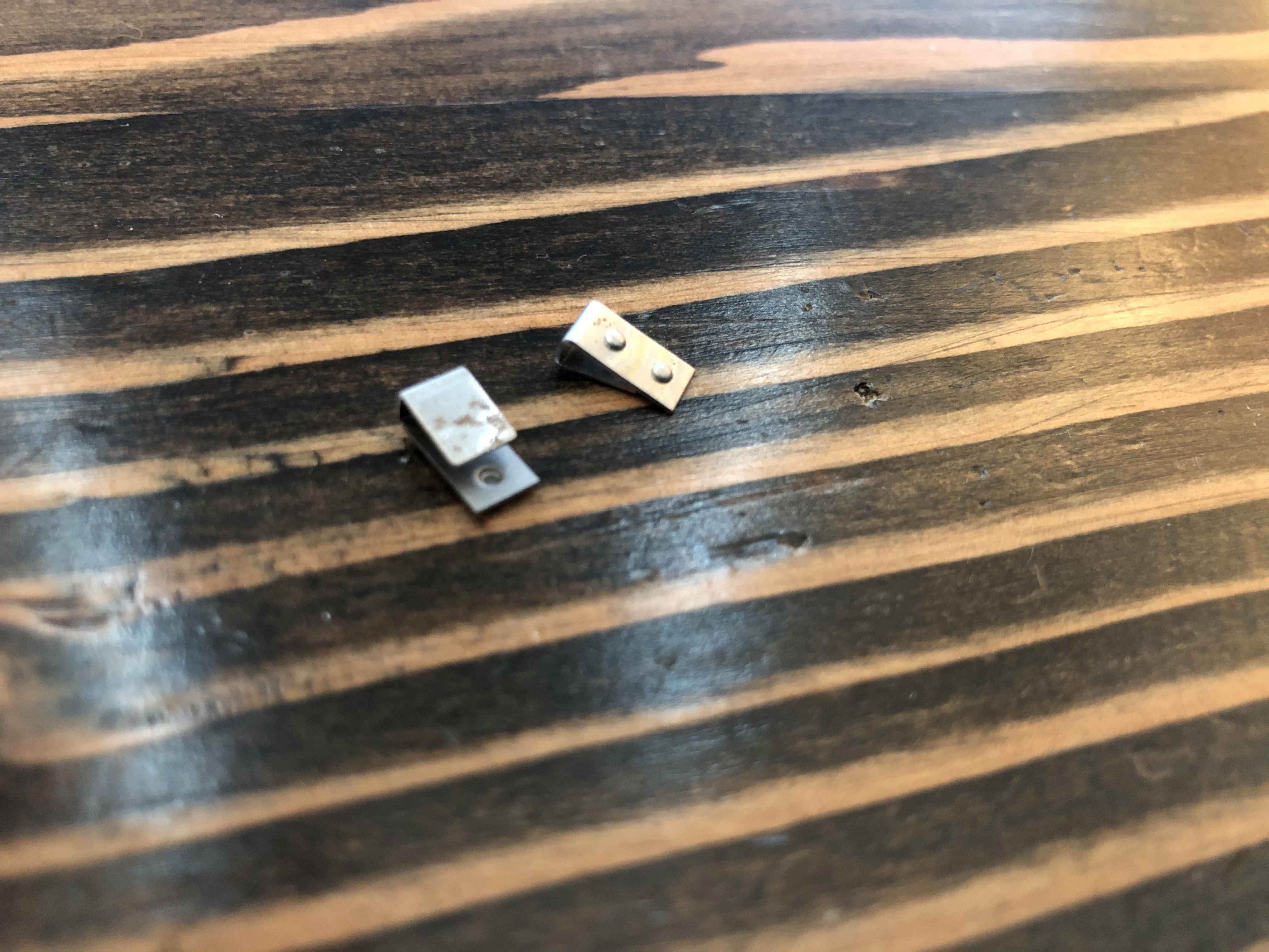

How to install F 4704 stabilizer tabs?
ddrfraser1
10 Sep 2020, 22:10
Got these from modelfkeyboards. Suggestions on how to install them?
Myoth
10 Sep 2020, 22:11
don't you slide them from underneath the plate ?
darkcruix
10 Sep 2020, 23:30
I just recently added those to my F107.
The F107 originally comes with plastic inserts that have a different size. What I did is to remove the plastic inserts and filled the gap with epoxy resin that was already in the curing phase. Then I inserted the tabs into the gaps - they fit pretty nicely. I then let it cure for 24 hours and it is rock solid.
