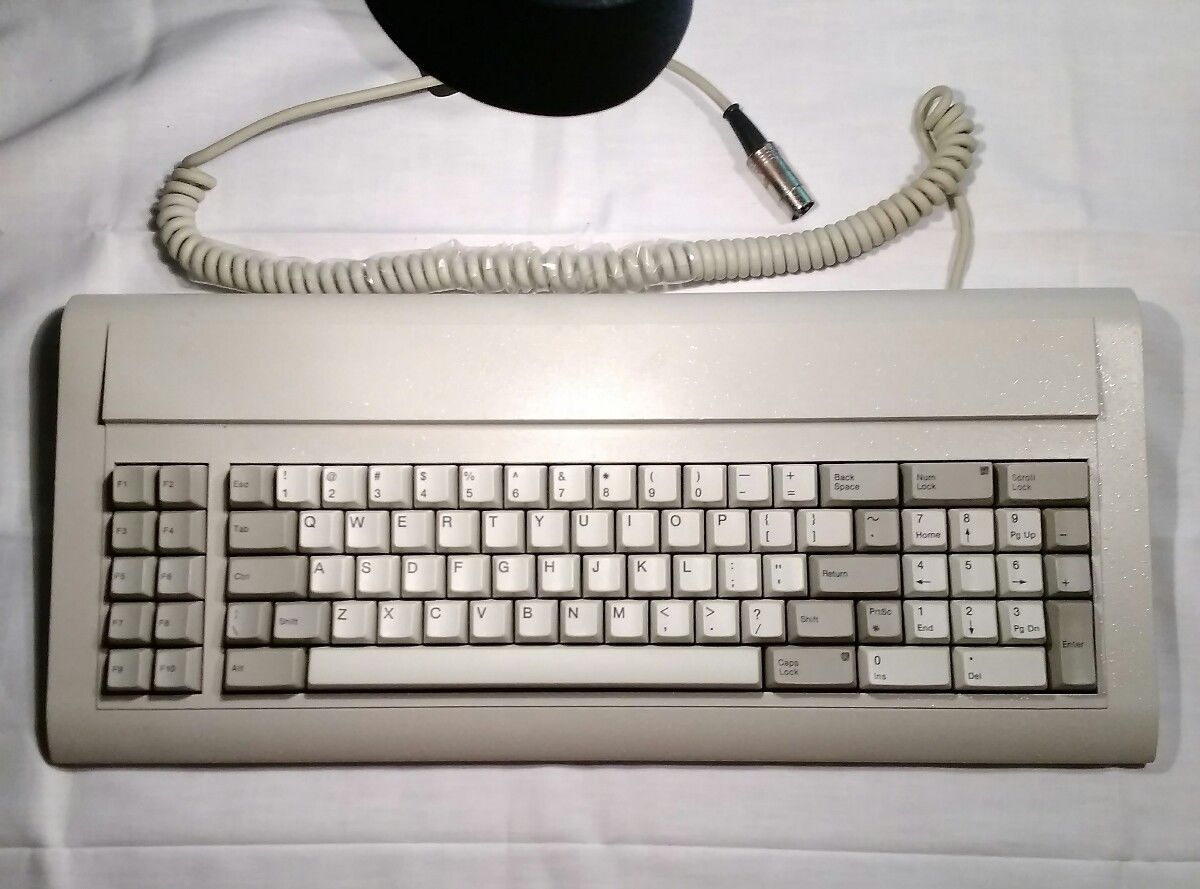

Please enjoy the typing video and my channel!

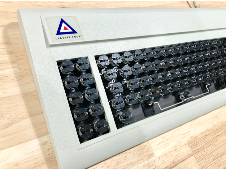

The manufacturer of this model seems to be Oak Switch Systems and its branded(OEM) by Leading Edge. The switch of this keyboard is Oak Full-Travel Membrane(FTM). It looks like a buckling spring switch but it feels like a lubed linear or Topre switch.
leading edge2.png (852.19 KiB) Viewed 1867 times
I think I need to do some work to convert the protocol to be compatible with modern PCs. Does anyone know what the protocol of this keyboard is?
