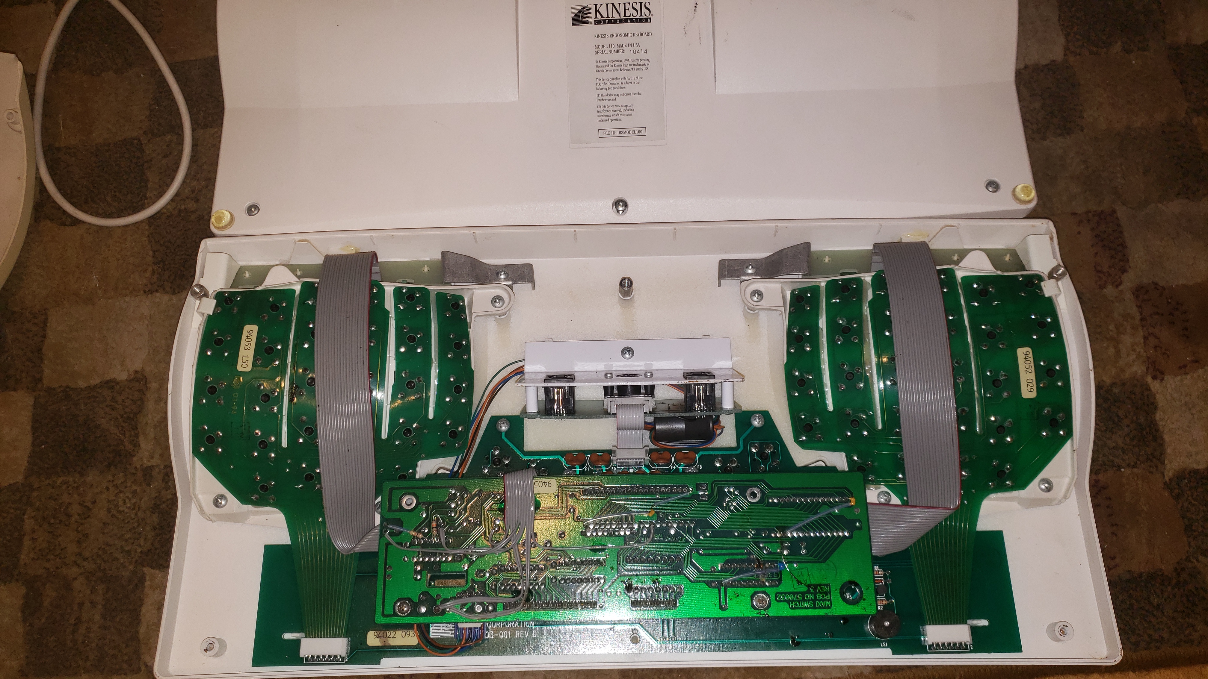

The absence of the arrows on the backspace and enter key must have fooled me (the A in alt definitely isn't the wyse font). I guess those are older pad printed keycaps. I have a model 110 and a model 130 with doubleshot keys (the 130 is marked "Demo 001" and looks like it got shipped around a bit but the keycaps are in good condition, the 110 is heavily used and needs a cleaning or new switches). I ended up buying a very clean Advantage MPC/USB (KB500) just for the new keywell PCBs (Kinesis charges more for parts than they used to). I really wish one of the replacement controllers supported the old keywell PCBs (I guess I could soldered leads to the traces and get that part working but I'm not sure if the columns and rows work the same). I guess I should try it though.

I have got a Model 110 also. It had a huge PCB which took up half of the case and combined thumbclusters and controller components. I've tried to use some leftover Amoeba PCBs for this build among with similar smaller versions, but that turned to be completely unnecessary (it was easier to go with handwiring).

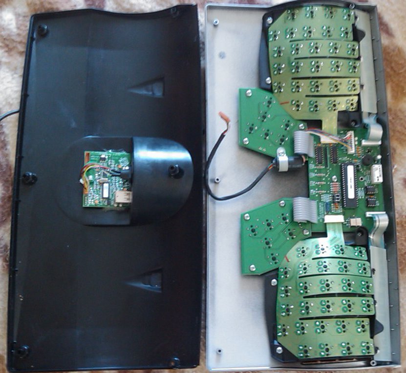

The keywell PCBs have changed a few times. The model 110 is pretty unique all around. I think the Model 130 is consistent with the rest of the standard AT connector models. All USB Advantages used the same PCB until the Advantage 3 if I recall correctly. I believe only very early (pre 110) models have a slightly different physical layout.

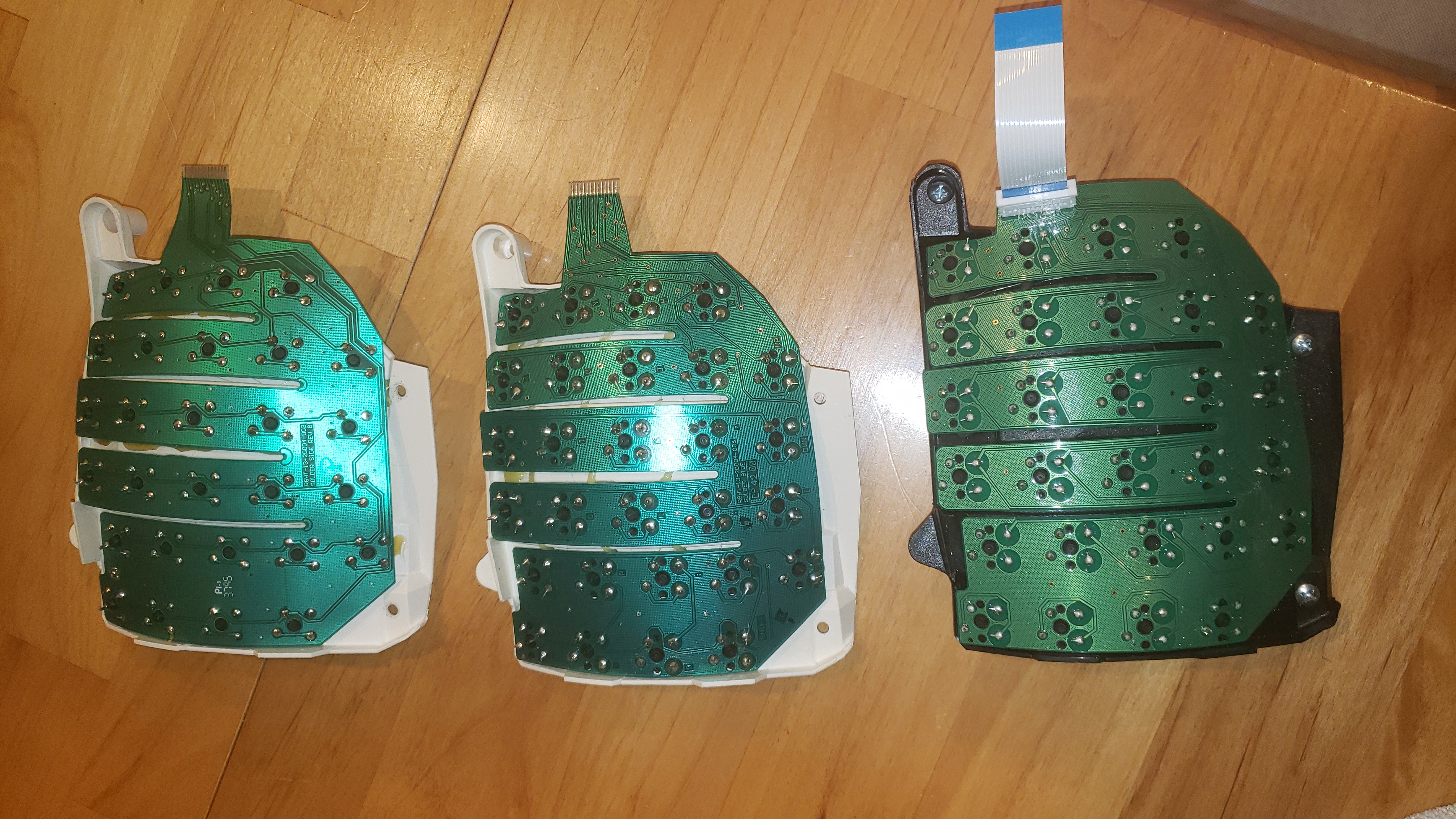

Model 130 vs. KB133PC "Classic" vs. KB500-USB-blk "Advantage MPC/USB"
Rayndalf
23 Oct 2020, 06:37

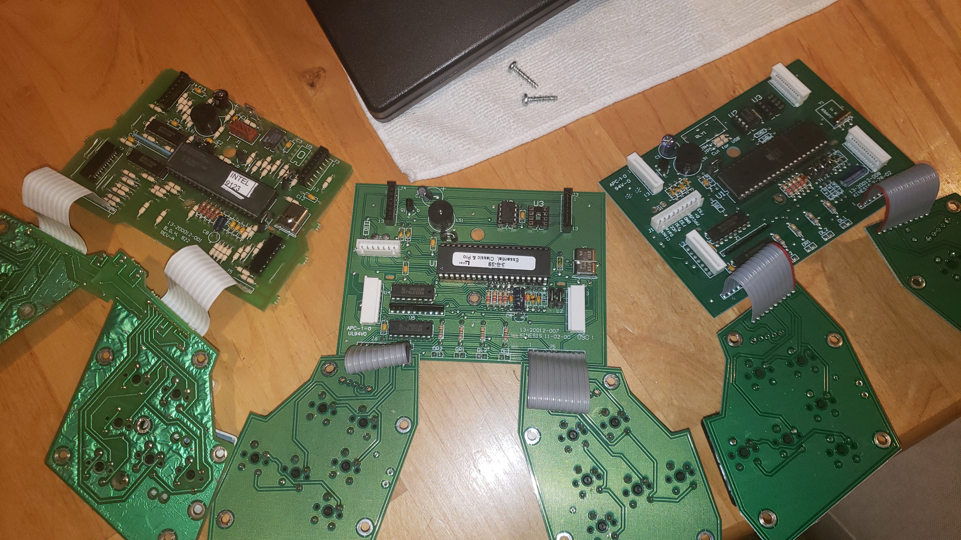

The Model 130 and Classic (KB133) keywells are interchangeable and the Classic and MPC/USB (KB500) main controllers are almost identical. All I need are some jumper wires and the Model 130 or Classic keywells can be wired to a replacement controller like the Kint or Stapelburg.
Why didn't I check before I bought a MPC/USB :?
Rayndalf
23 Oct 2020, 06:51
If anyone was wondering the Model 110 is absolute madness in comparison.

There seem to be small differences all over the Advantage models. Interesting that my model KB510USB (label name Advantage MPC/USB as well) is different from yours KB500USB. Well it is probably only the way how the key wells are connected. Controller HW looks the same.
KB510USB
KB510USB
Rayndalf
24 Oct 2020, 12:59
Interesting, it uses the same connectors for the keywells as my Classic. Just an extra set of holes and the connectors used in these models could directly connect to a new controller (the older connectors used in my Model 130 fit the same keywells but also fit onto the replacement controllers). This whole thing really is strange.
