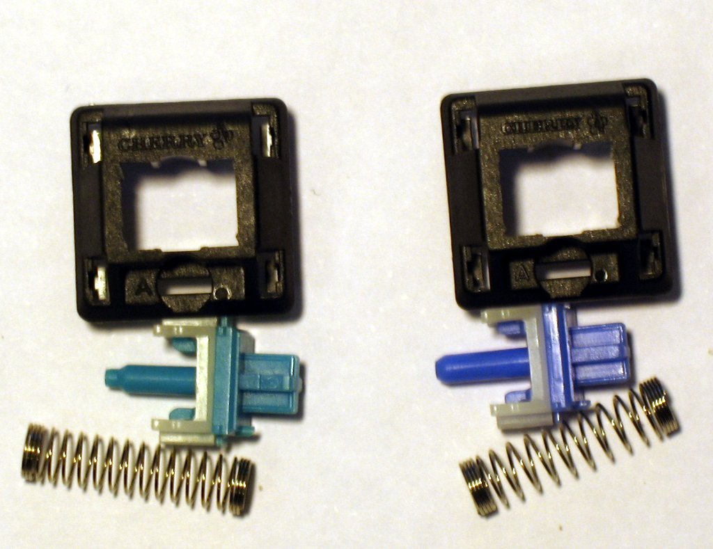

Found this under the spacebar on a Chicony board today. I think it is better we leave the ancient Cherry days untouched. This is slowly but surely becoming just as confusing as ALPS. But now without further complaining, I present you.... the MX Sky Blue switch :roll:
Different slider, different stem, different spring.
Feels like a green, spring looks like a green one too. Probably what became the MX Green switch later on.

oh gosh, not again... I was happy in the days when the known Cherry switches had the colours Red, Black, Brown, Clear and Blue + the corresponding spacebar types. Then the original whites were easily distinguishable from Clears, and everything was nice and easy.
17 Apr 2012, 18:34
sixty wrote:...
The skyblue switch is with the smaller Cherry logo, so maybe a not so old variant?
I should ask my supplier to order 1000 switches of all thinkable product numbers, to see what else they have and maybe still produce!
Just need someone who financiates this.
ps: In the 2nd photo, it looks like a clearblue switch!!!

The color of the top part is the same i pmed you about a while back
Sem título.jpg (118.61 KiB) Viewed 5285 times
yes quality sucks
edit: applied filter..
Edit2: left regular, right chicony

The smaller variant is the older, right?
mintberryminuscrunch wrote:
yes quality sucks
This is yet another variant. Sixty's has got a black thingy in it (what is it called?), while your's is black.

So there's a clearsky and a thunderous-sky?
Where clearsky has a small logo, and spring with less loops (so shorter, guessing stiffer?).

Oh, and the SHAPE of the bottom of the slider is irrelevant.
I once cut the bottom dimple out of a MX switch to confirm this.
Spring coil count and thickness are really the only significant variables..
