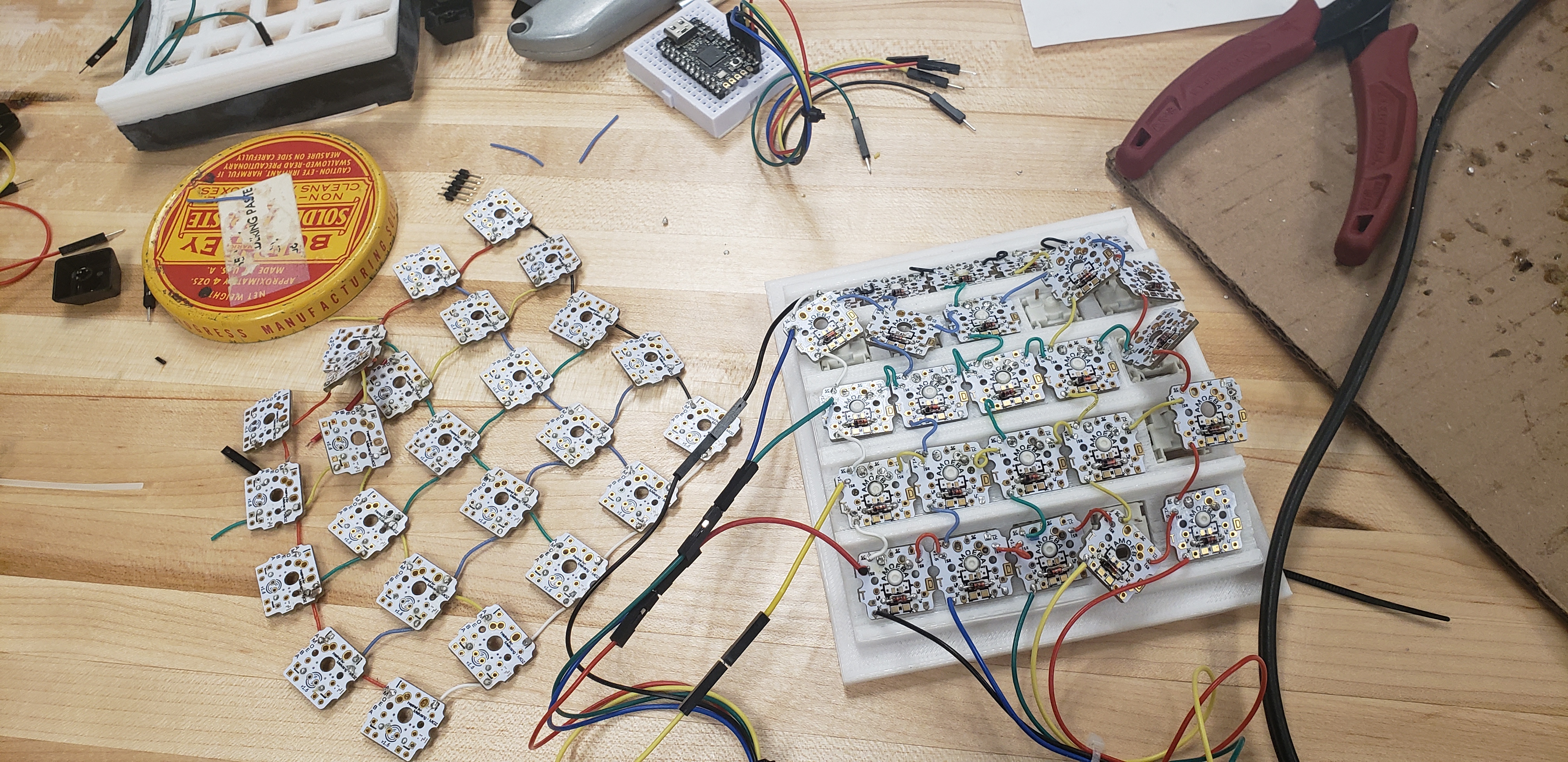

Amoeba PCBs are pretty straightforward, but not exactly easy especially if you haven't soldered before.
I would strongly consider working with an existing PCB (standard 60% or tenkeyless) unless the unique layout is an important part of the design.
I used a Teensy and Amoebas, and got a mostly functional prototype running QMK. There are tools that make the coding part easy, but getting QMK set up on a windows machine still takes a bit of time.

you want to sell your wired amoeba with teensy like in you picture?Rayndalf wrote: 23 Nov 2020, 22:29 Amoeba PCBs are pretty straightforward, but not exactly easy especially if you haven't soldered before.

I'll see if I have better photos. This design has some notable flaws, so I can't move forward until I get better at CAD and have access to a 3D printer again, but as a prototype I consider it a success.vvp wrote: 24 Nov 2020, 11:33 @Rayndalf: A contoured DIY keyboard! Nice! Post some pictures of the overall shape when you are ready.
The matrices are currently attached to switches in white 3D printed "plates". I can remove the switches and reconfigure the matrices next week, (and replace the PCBs and that aren't working). What are you trying to accomplish?danix_danox wrote: 06 Dec 2020, 19:30 you want to sell your wired amoeba with teensy like in you picture?

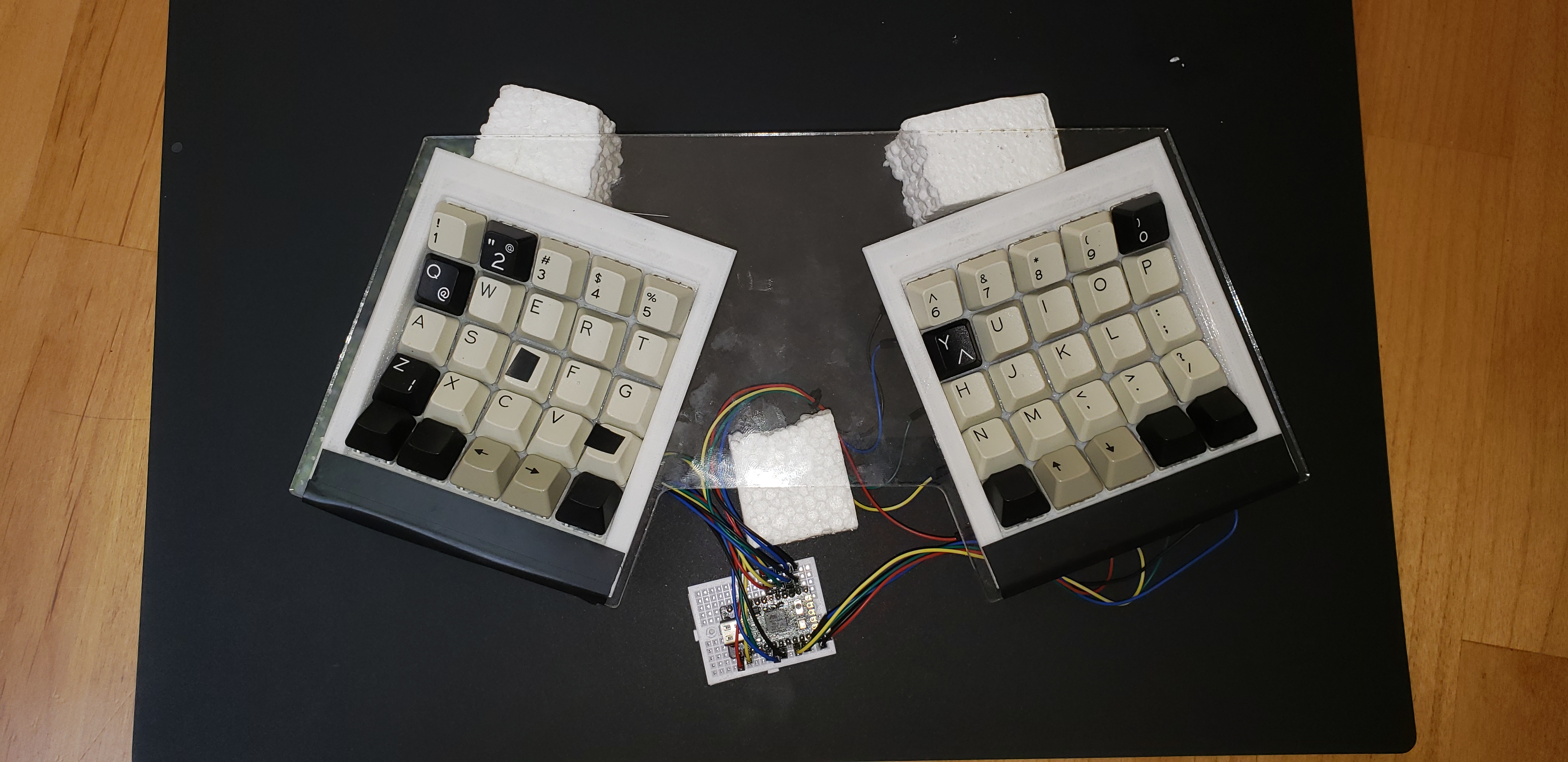

I pretty much gave up (for the time being anyway) after one prototype. It was a bit more challenging than I expected (my 3D modelling skills aren't quite there yet).vvp wrote: 24 Nov 2020, 11:33 @Rayndalf: A contoured DIY keyboard! Nice! Post some pictures of the overall shape when you are ready.
I may try again at some point (I have a set of ergo keys from KAT Lich that will need a home).

Very interesting keyboard. I would love to see a non split board with the same sort of contour, curved plates like that are great.

The two halves are technically linked combined with a plate, but it's far from ideal. Completely seperate halves aren't really my thing, and wouldn't work for this project "a keyboard for VR". Not that I have VR.zrrion wrote: 09 Dec 2020, 21:57 Very interesting keyboard. I would love to see a non split board with the same sort of contour, curved plates like that are great.
As for non split keyboards... how would they work with a curve? I remember seeing a project on Reddit (called the half pipe or something? I can't find it now). That was basically a dished Planck, but I'm not sure how usable it was.
Pretty much what I did, except the "keywells" are held in a piece of polycarbonate. If I had more 3D printer time I could have done something cooler with tenting, but laser cutting was so much faster. I find the Kinesis Advantage to be bulky, but I like that I can use it on my lap if I need to.vvp wrote: 09 Dec 2020, 22:59 Well it is easy to bolt two halves of a split keyboard to a piece of plywood or something ...
