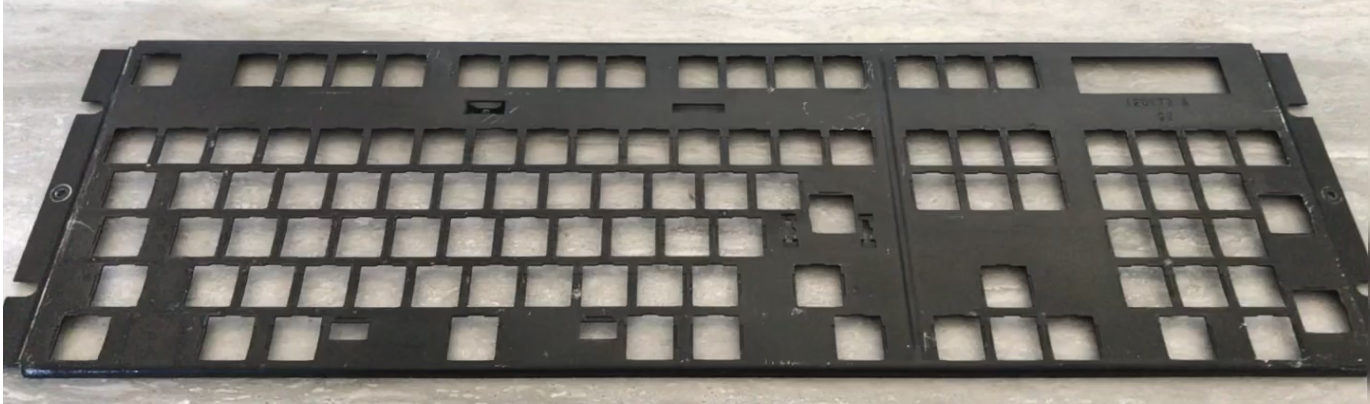

Really, I wasn't going to do this as a Workshop project. Unfortunately, when I removed some of the switches, I found out that the top of the switch plate had rust, so I had to desolder all the switches to get the plate off.
All that white is rust. Forgot to mention that the keyboard is PS/2.

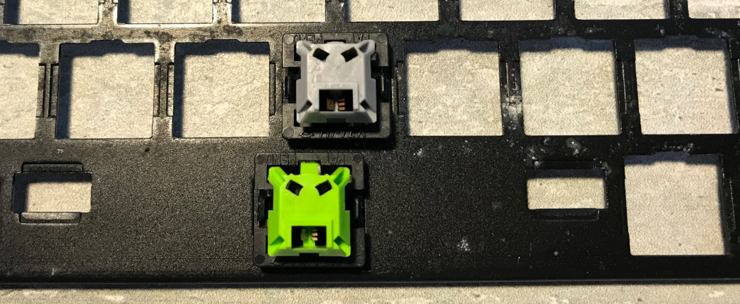

The 'board has linear grey switches with a somewhat heavier neon "green" switch for the spacebar.

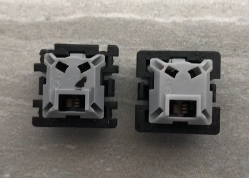

One of the things I found interesting was that the wire stabilizers, except for the ones on the Enter key, are part of the switch itself and the switch has a different housing.
2020-11-16_11h37_39 (2).png (212.75 KiB) Viewed 1409 times
Left, with the different housing. Right, without.

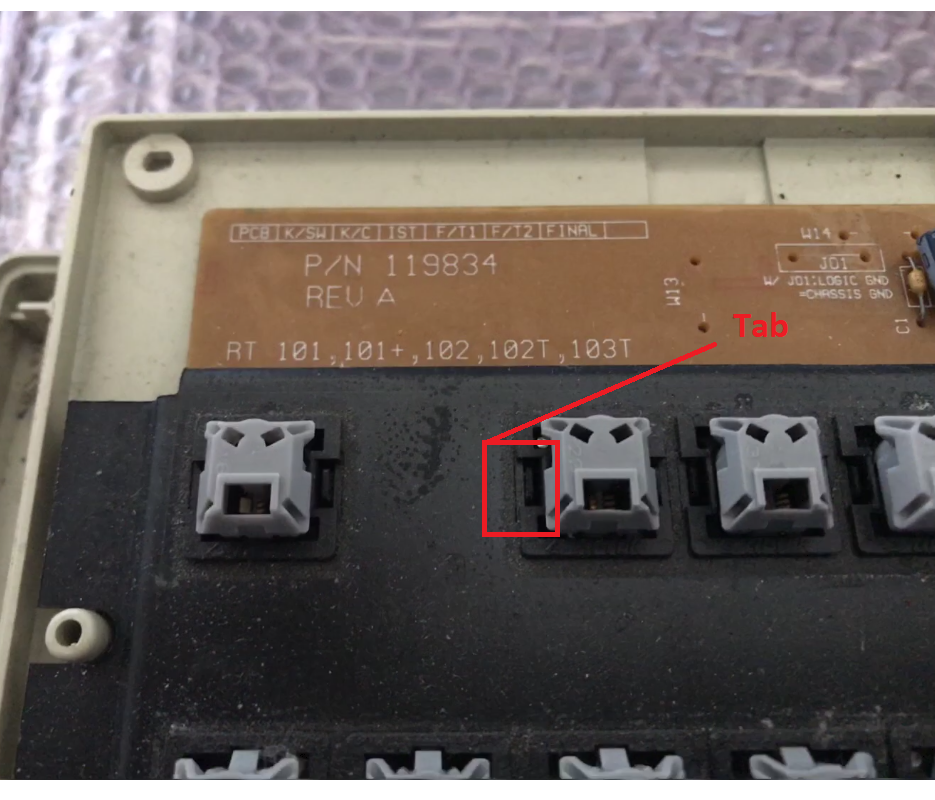

The switches have four pins and locking tabs. It took me a couple bits of trial and error to figure out how to deal with the tabs.
The solution: after you've desoldered the pins, push up on the pins with your thumb. You don't need to use a lot of force. Use the pointy part of a plastic spudger to push in a tab in toward the slider (so, left to right or right to left). When it pops, push in the other tab. You can CAREFULLY pull the switch out by its slider. Easy peasy.

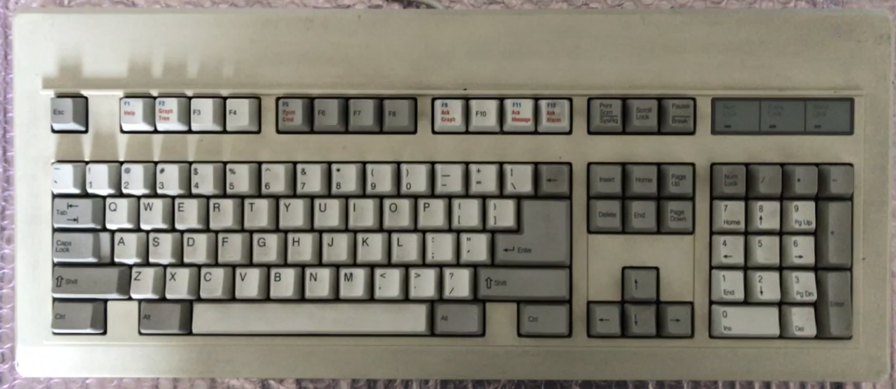

I've already ultrasoniced the key caps and retr0brighted the case, which brings me to one other problem: the lock lights sticker was really just a sticker. That and the back sticker that said the part number, etc. wore away into scrap. I picked up a new Model M sticker and it fits almost perfectly.
