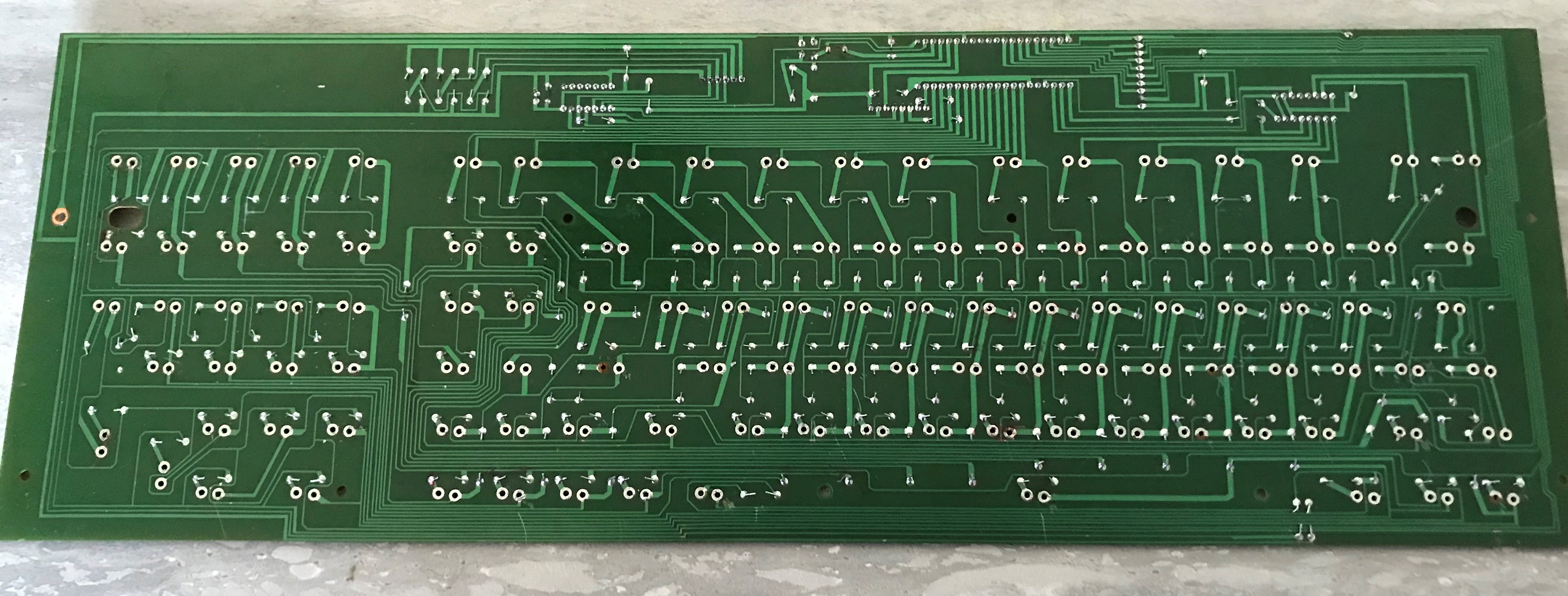

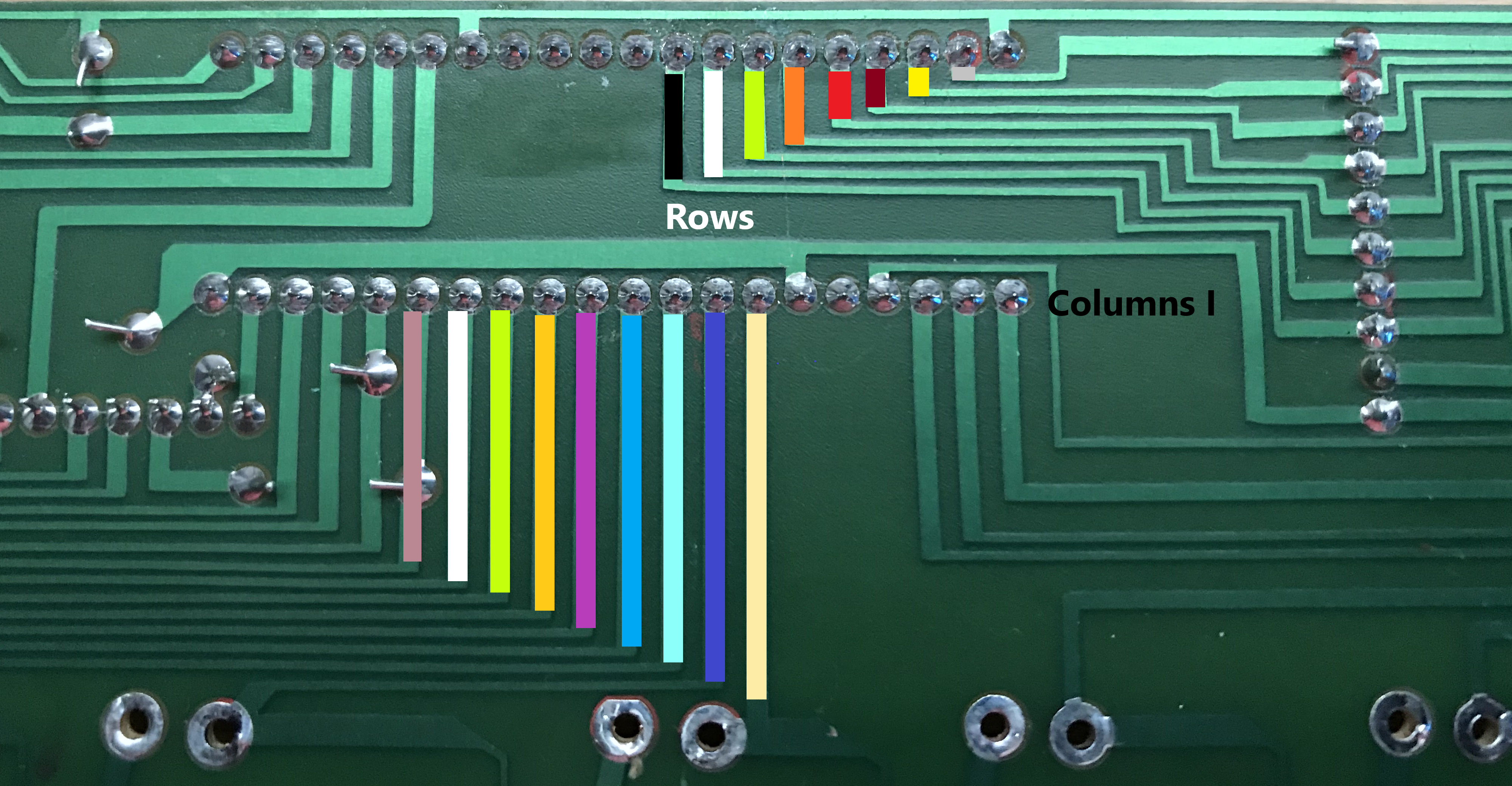

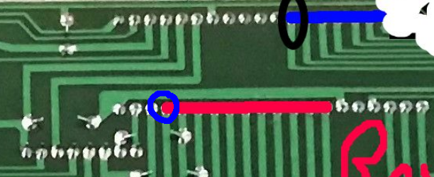

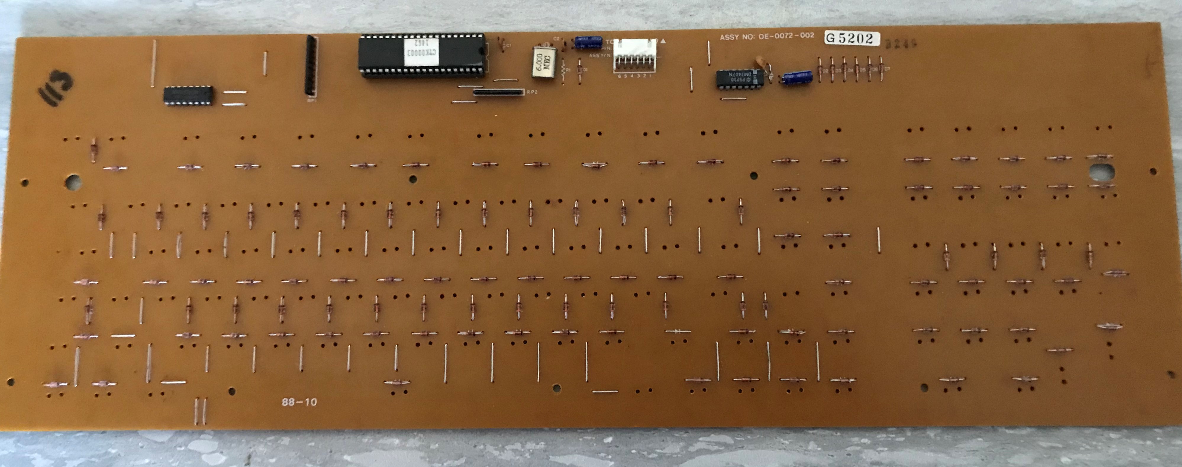

So, I have a photo attached of two random "columns" of switches and where they connect on the controller, highlighted in red dry-erase marker (I wiped it off after I was finished). Multimeter reads full continuity for each column. There are two places where there are soldered wires on the top of the PCB and there's a little "break" on the bottom of the PCB. Those are the little breaks in about the top middle and bottom.
So, does that mean that I could then just attach a wire from the top ("north" side) of the board right to the Teensy? I think the existing controller has 40 leads. Maybe the problem I have is that I don't really see what needs to be connected to a Teensy to make the PCB I'm showing work.
I'd like to get QMK to work. I'm also struggling to get that up and running, but in the QMK case, I just have to find some directions that aren't 11 years old.
kelvinhall05
03 Dec 2020, 04:53
I will give more info tomorrow but you'd likely end up using 20-25 IO pins as the 40 on the main controller are not all used. Only a few will be for IO.
But you've mapped those two columns correctly. I can suggest some faster methods tomorrow morning. I could also help with QMK once you're at that step. Please send full pics of both sides of the PCB and any chips on it.

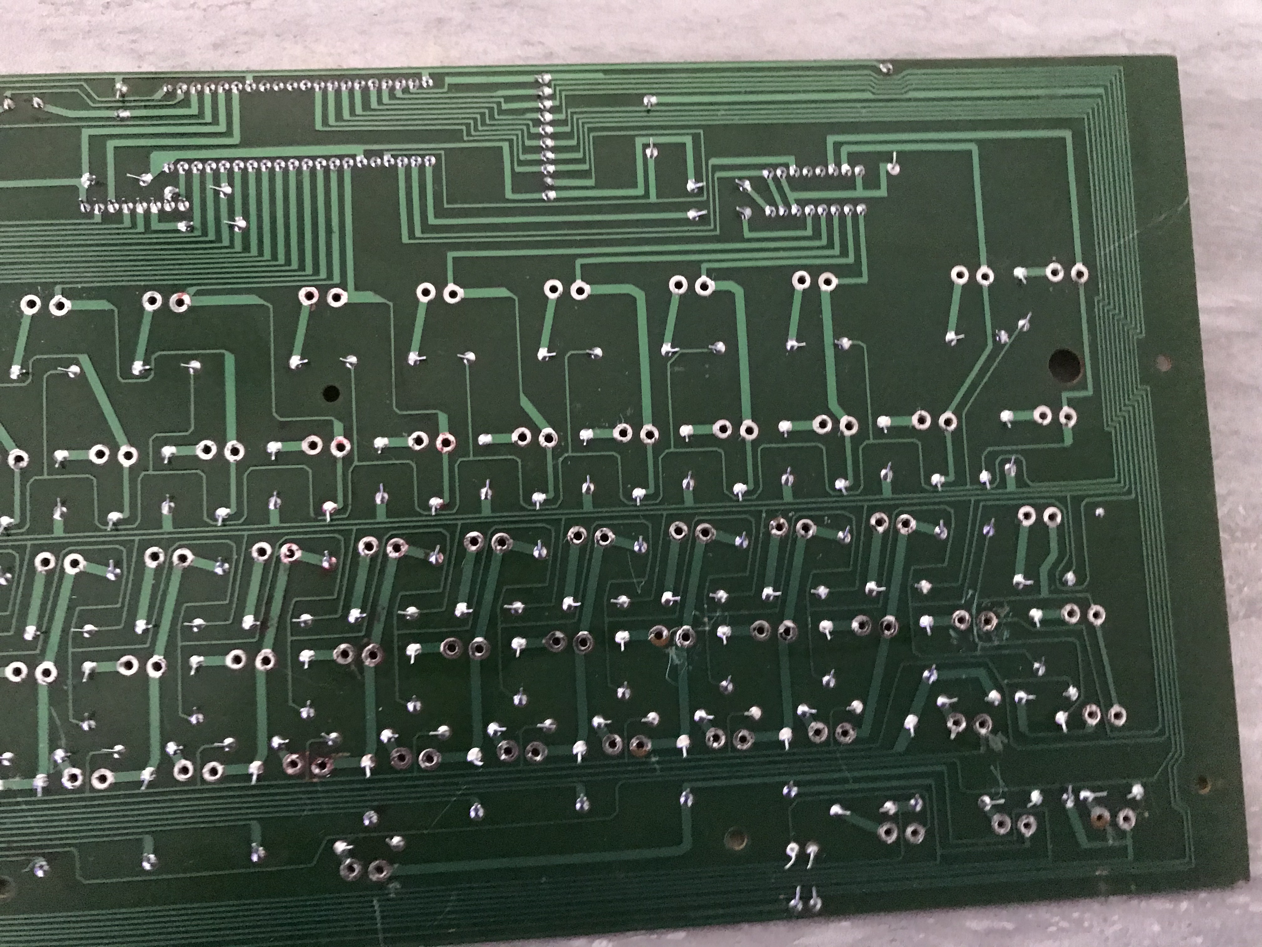

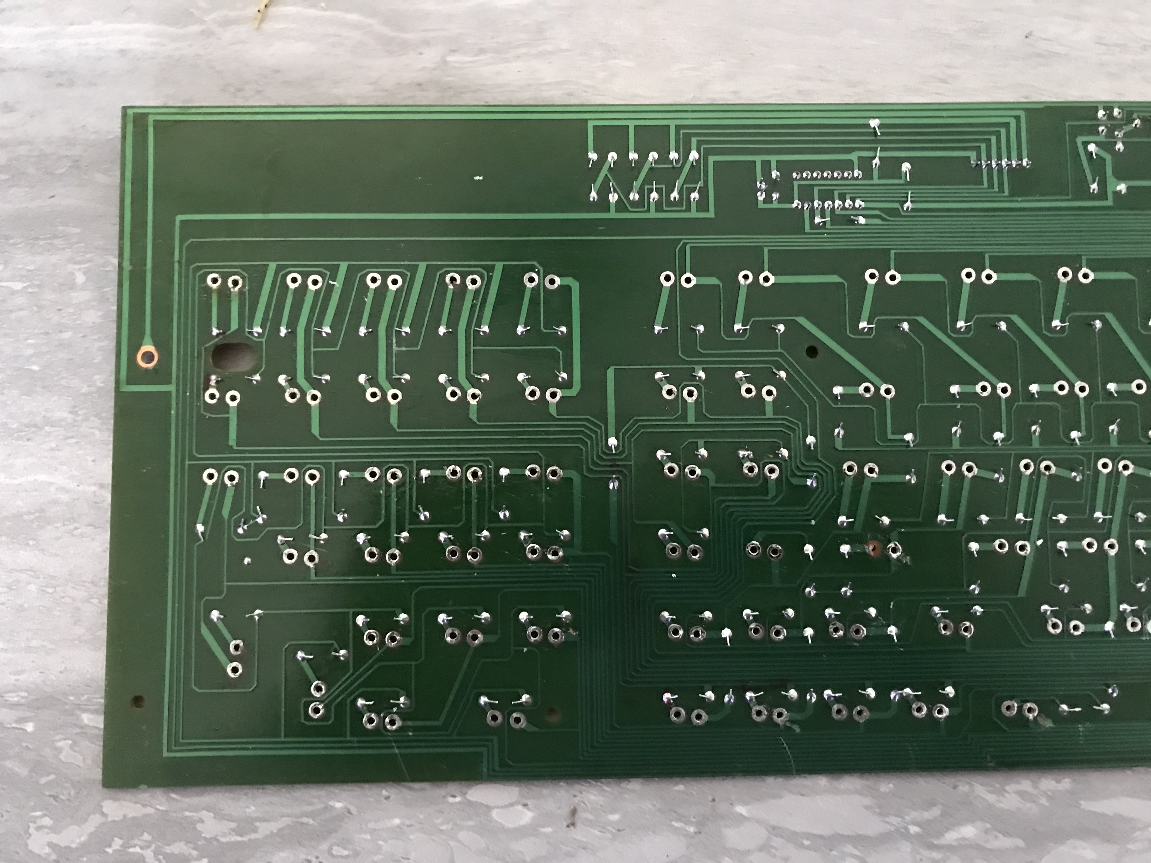

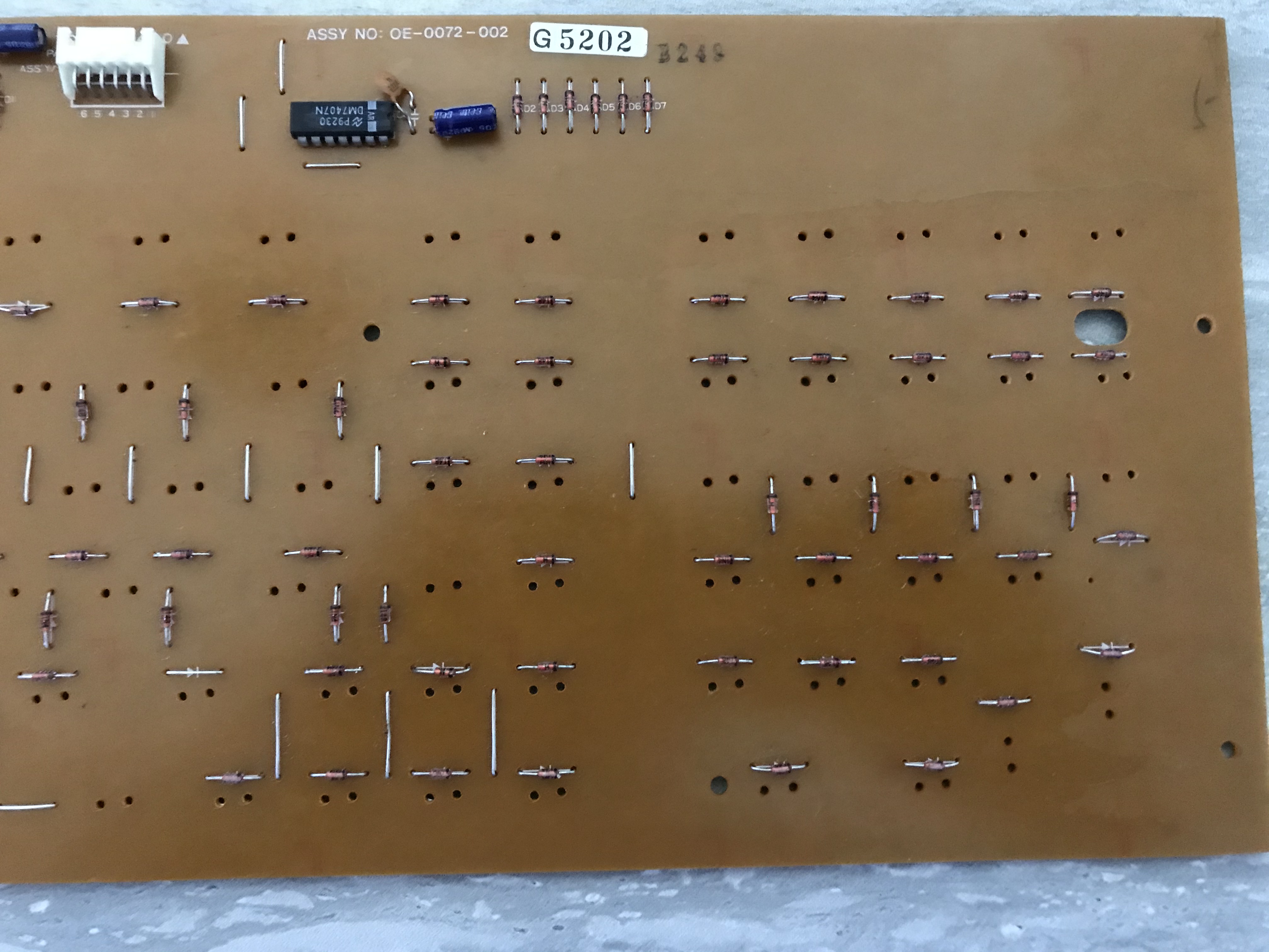

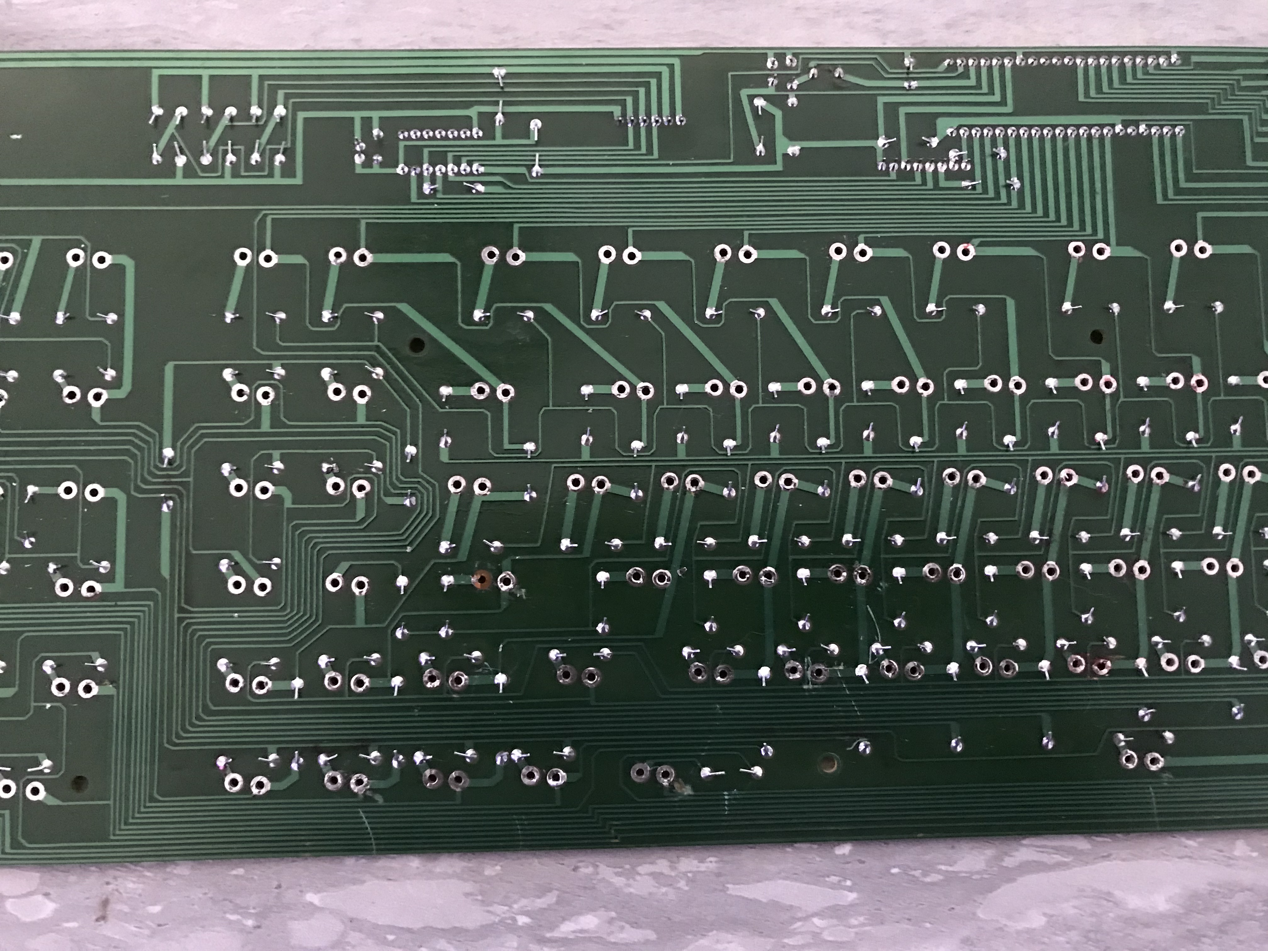

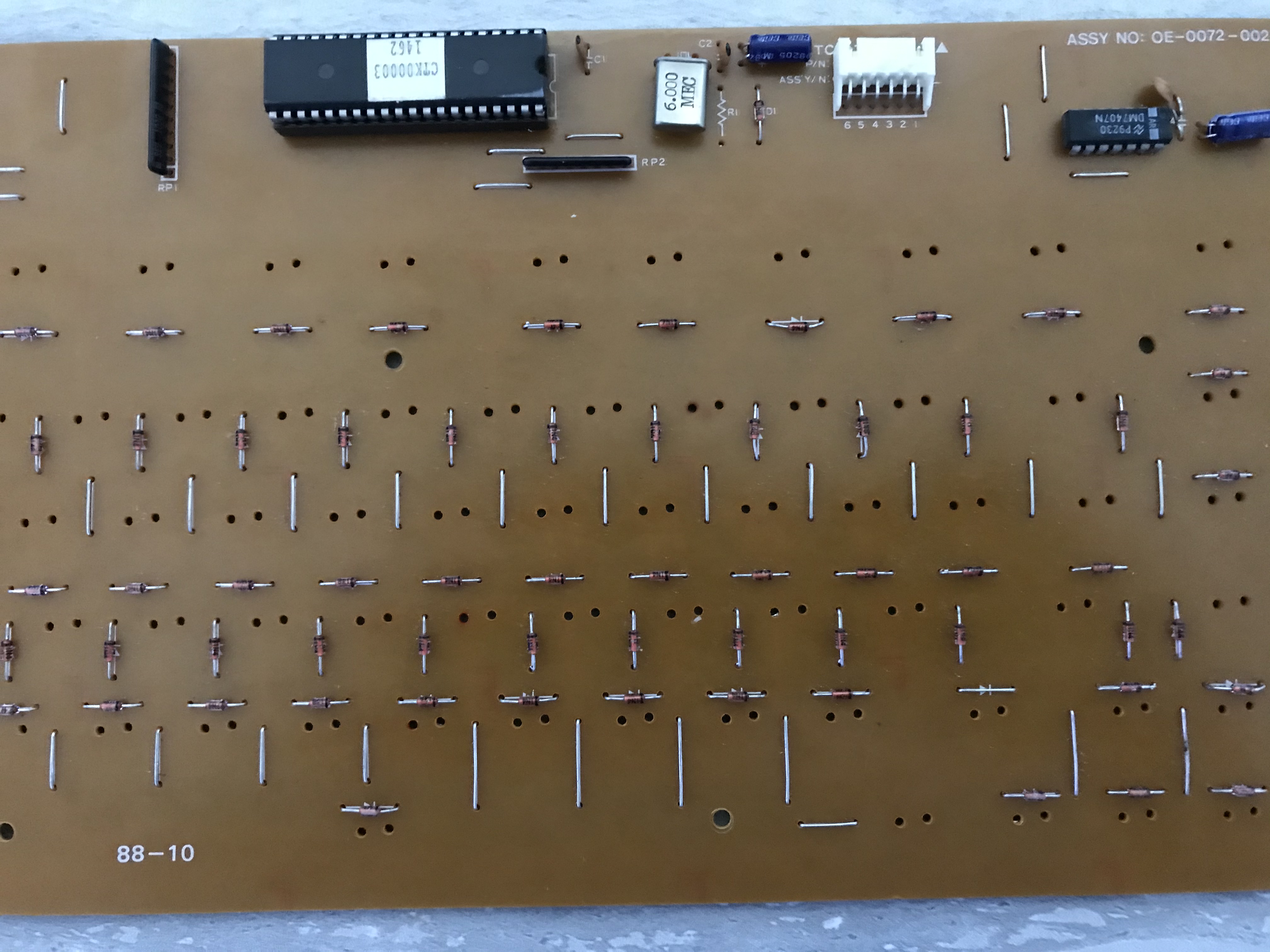

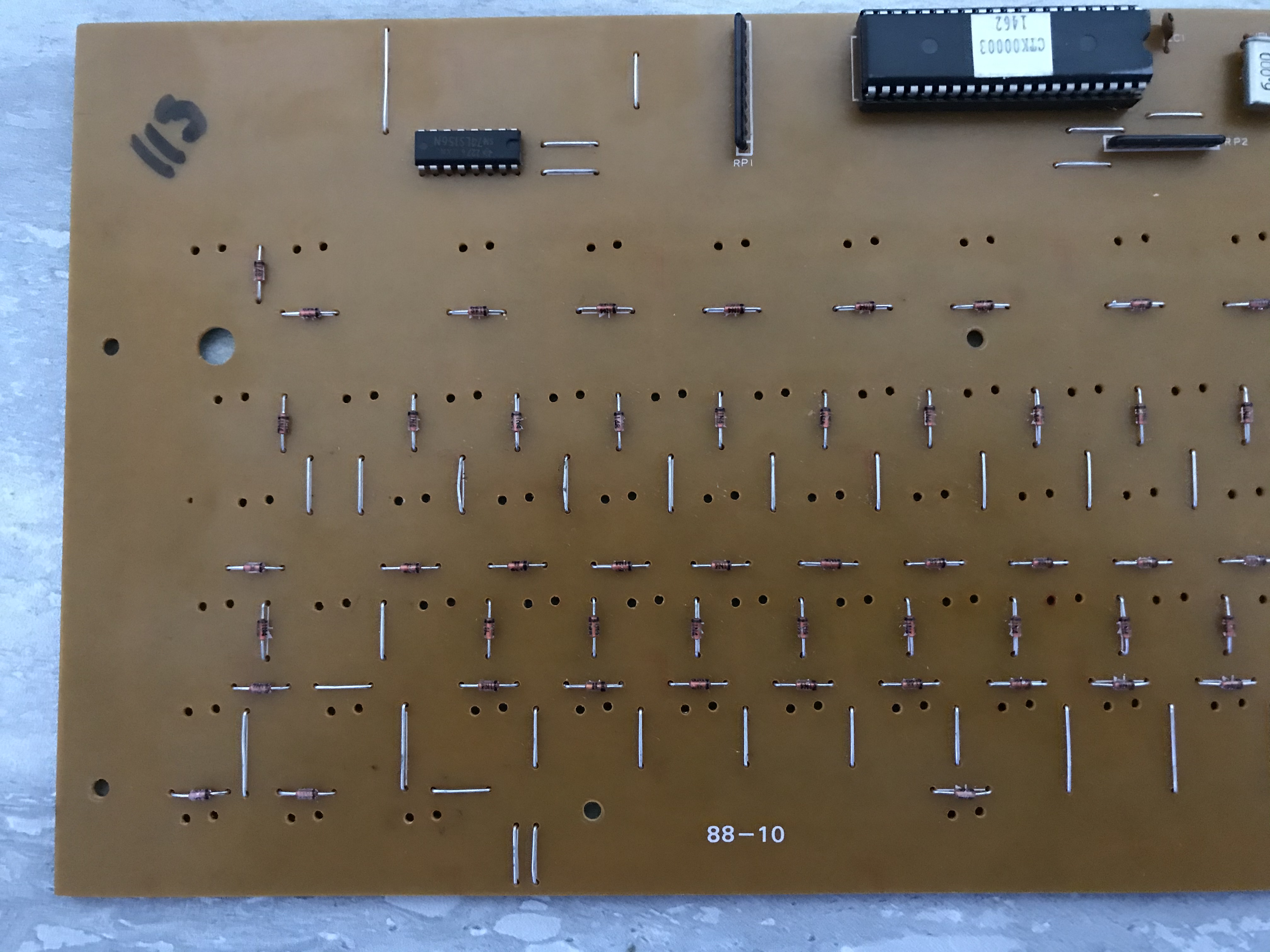

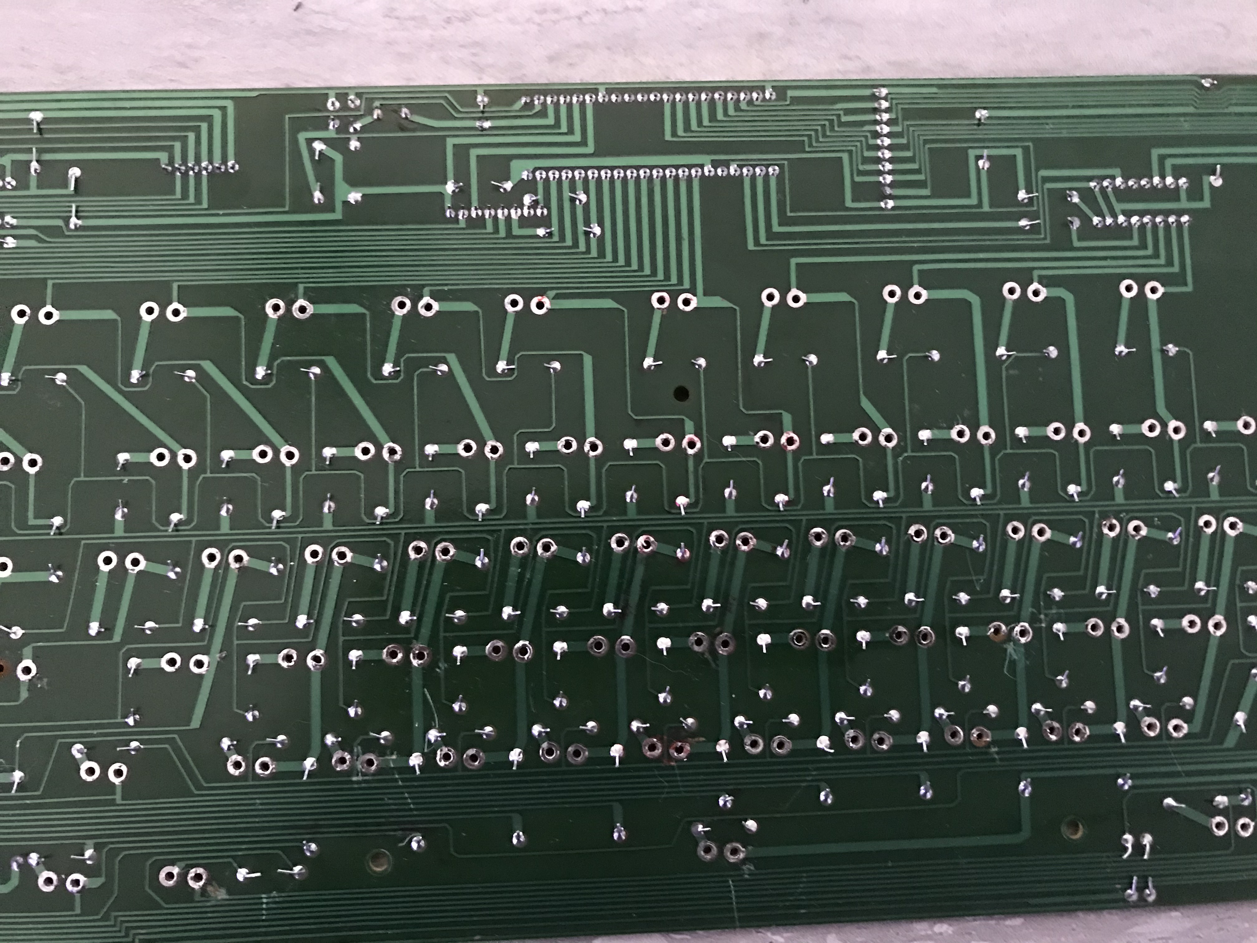

Moar pics.
IMG_1312 (2).JPG (852.62 KiB) Viewed 13397 times
IMG_1307 (3).JPG (1.25 MiB) Viewed 13397 times
kelvinhall05
03 Dec 2020, 20:05

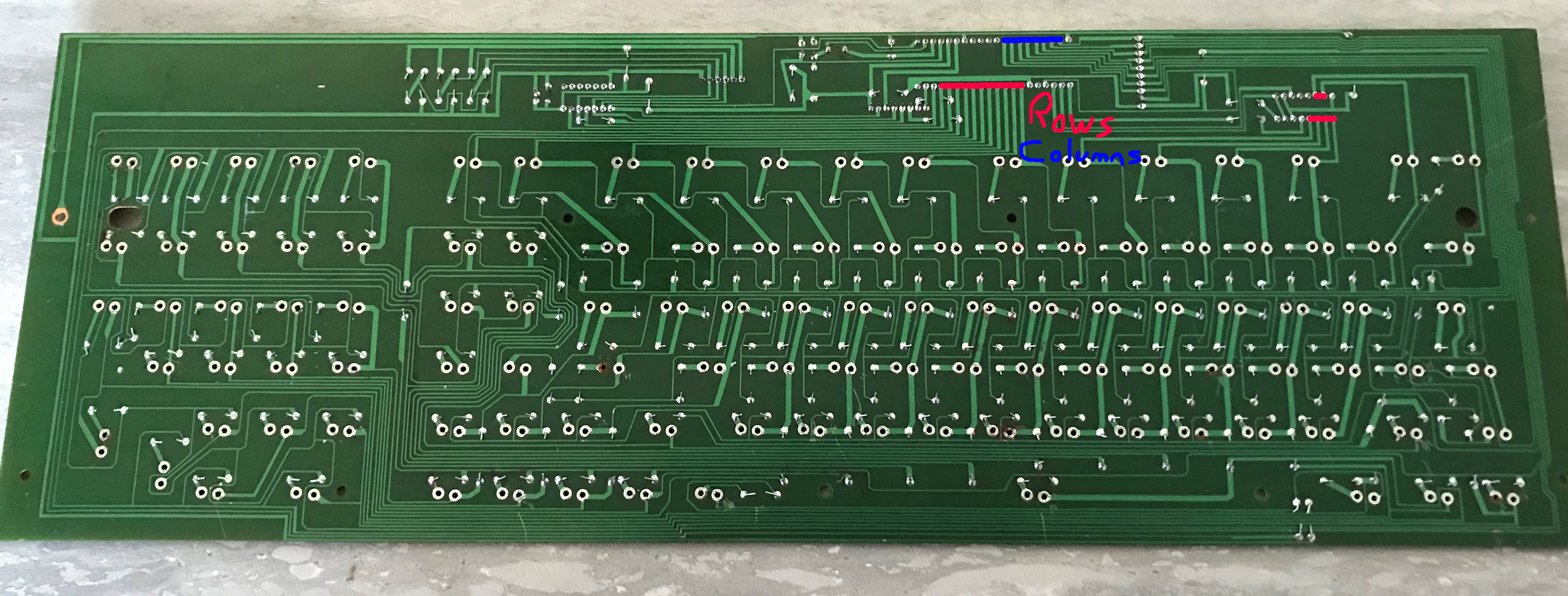

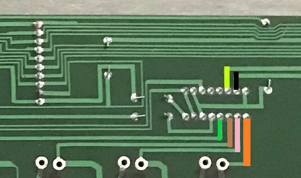

Oh this is a really easy one. Rows are red, columns are blue. Remove all components on the board except for jumpers and diodes and then solder your Teensy in so that all the rows and columns go to io pins (making sure you note which row/column goes to which io pin).
You will also have to map matrix and find which key is on which row and column.

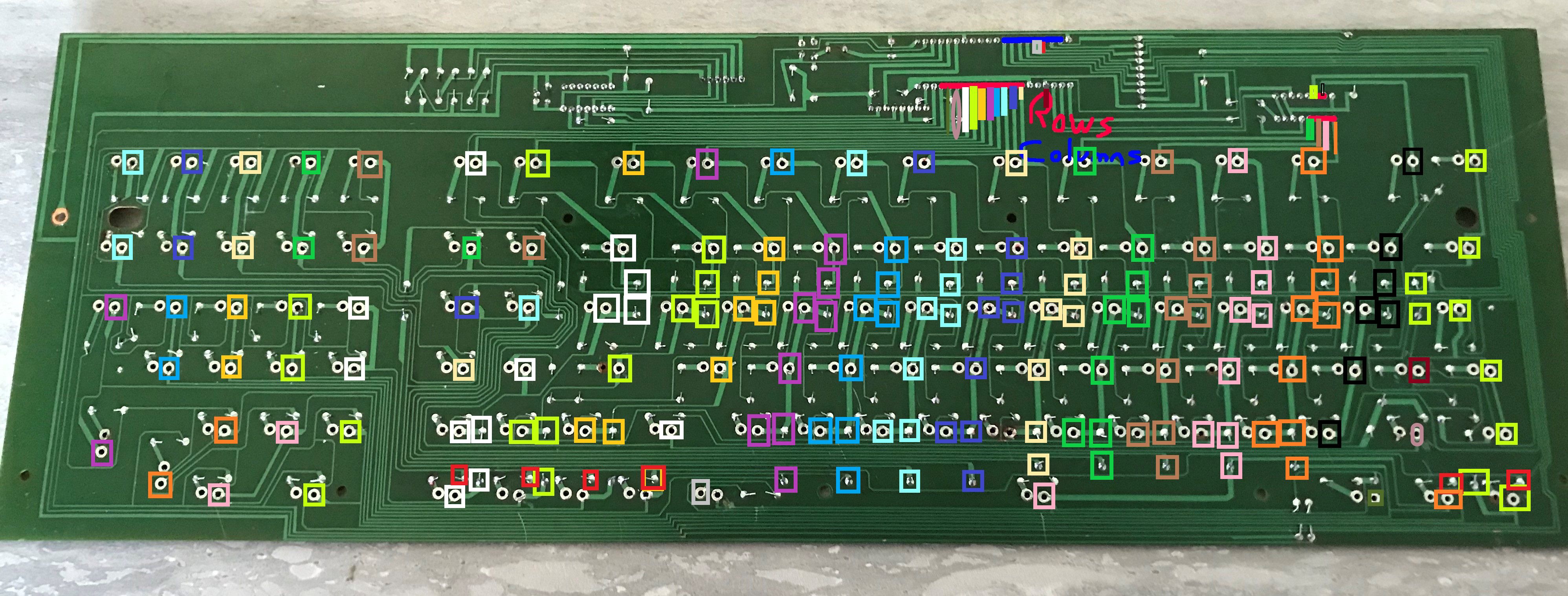

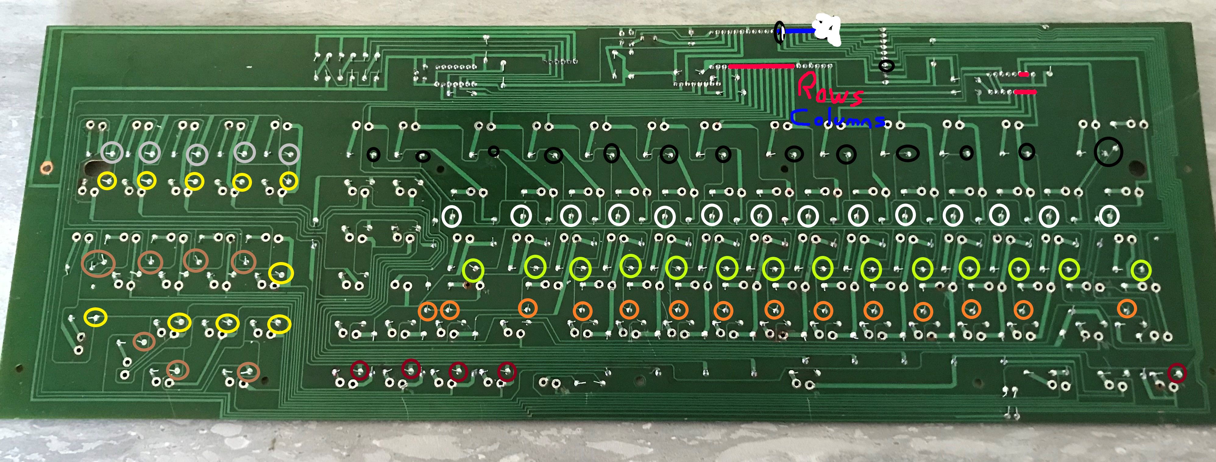

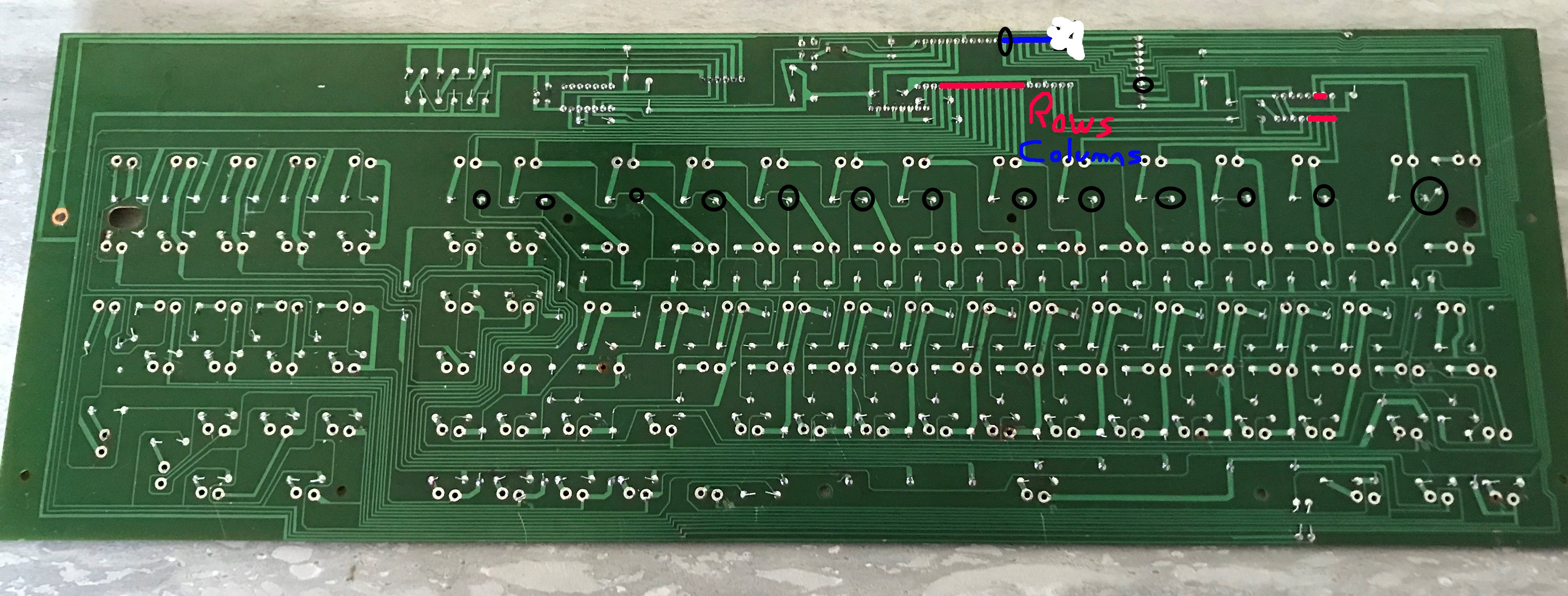

If you don't mind, I'll try to map a row and column or two, just so you can check me before major component removal.
hellothere
04 Dec 2020, 02:13

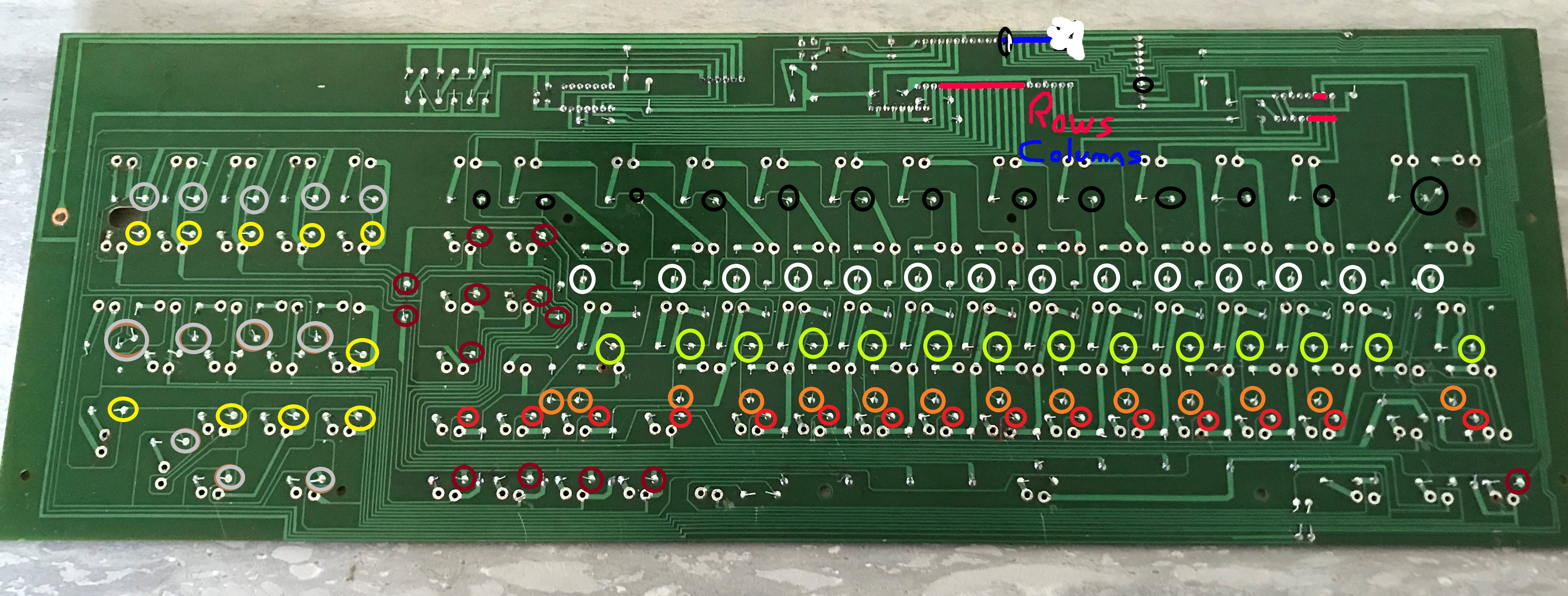

OK. Here's a continuity map. All those black circles and ovals are feeding off that first pin on the controller marked in blue. Did you get columns and rows backwards or am I looking at something incorrectly?

kelvinhall05
04 Dec 2020, 02:36
hellothere wrote: 04 Dec 2020, 02:13 OK. Here's a continuity map. All those black circles and ovals are feeding off that first pin on the controller marked in blue. Did you get columns and rows backwards or am I looking at something incorrectly?
a. Yes, I erased part of the pic.
b. Yes, I know I have great talent in working with Microsoft 3D Paint.
That looks good. Rows and columns aren't necessarily backwards, I just labeled them the way QMK does, if that makes sense. Point is that it doesn't matter, basically just there to differentiate them and potentially save you two seconds when testing firmware (as you might have to "reverse diode direction" in the firmware).
Also I made a slight mistake when colouring the pins you're supposed to use. The red pin circled in blue is not used for the matrix.
hellothere

Anakey
04 Dec 2020, 19:04
That is almost the perfect board for replacing the controller in given it is mostly single sided and also has diodes so you will not have the keypress limit and also should have a fairly logical order. What i find helpful is to draw the layout of the board itself and the connections to the old controller then number the rows/columns starting at 0. As you test continuity between the switch pad and the trace where the controller is write down on the layout the row/column numbers, this way each key will have a different combination of row/column which can then be put into kbfirmware to then generate a working hex file to then flash to the new controller
kelvinhall05
04 Dec 2020, 19:22
Anakey wrote: 04 Dec 2020, 19:04 That is almost the perfect board for replacing the controller in given it is mostly single sided and also has diodes so you will not have the keypress limit and also should have a fairly logical order. What i find helpful is to draw the layout of the board itself and the connections to the old controller then number the rows/columns starting at 0. As you test continuity between the switch pad and the trace where the controller is write down on the layout the row/column numbers, this way each key will have a different combination of row/column which can then be put into kbfirmware to then generate a working hex file to then flash to the new controller
The vast majority of boards from this era used single-sided PCBs, and if they don't have diodes it takes two seconds to define MATRIX_HAS_GHOST or whatever in QMK. From my experience, OP has a fairly average board. Tiny bit worse than average because of the assumptions I had to make about the chips on it as I couldn't find a datasheet for the main chip (likely an Intel 8048/49/50 or clone/compatible, as were most of the boards from this era) and had trouble finding a decent datasheet for the decoder chip used for some of the columns.

Quartz64
06 Dec 2020, 20:25
Good news: your PCB is quite easily traceable and has 8x16 matrix with diodes (ROW2COL direction in terms of QMK).
Bad news: you need 16+8=24 IO pins to drive it. Pro Micro has only 18 and Teensy 2.0 has 21 (AFAIR). The good choise for this project would be WeAct STM32F401. It's supported by QMK, has enough IO, USB Type C, ready to use DFU bootloader and it costs less than $5.
If you already know where your columns and rows go, then you don't need to trace every key in matrix. Use matrix debug mode in QMK. So all this conversion can be done quite quickly. Just desolder all the ICs, capacitors and resistor arrays.
If you aren't familiar with 'layout', 'keymap' and other basic concepts of QMK, I can help with the firmware and specific MCU. Do you have a photo with keycaps installed?
Edit: matrix is 16x8, not 15x8

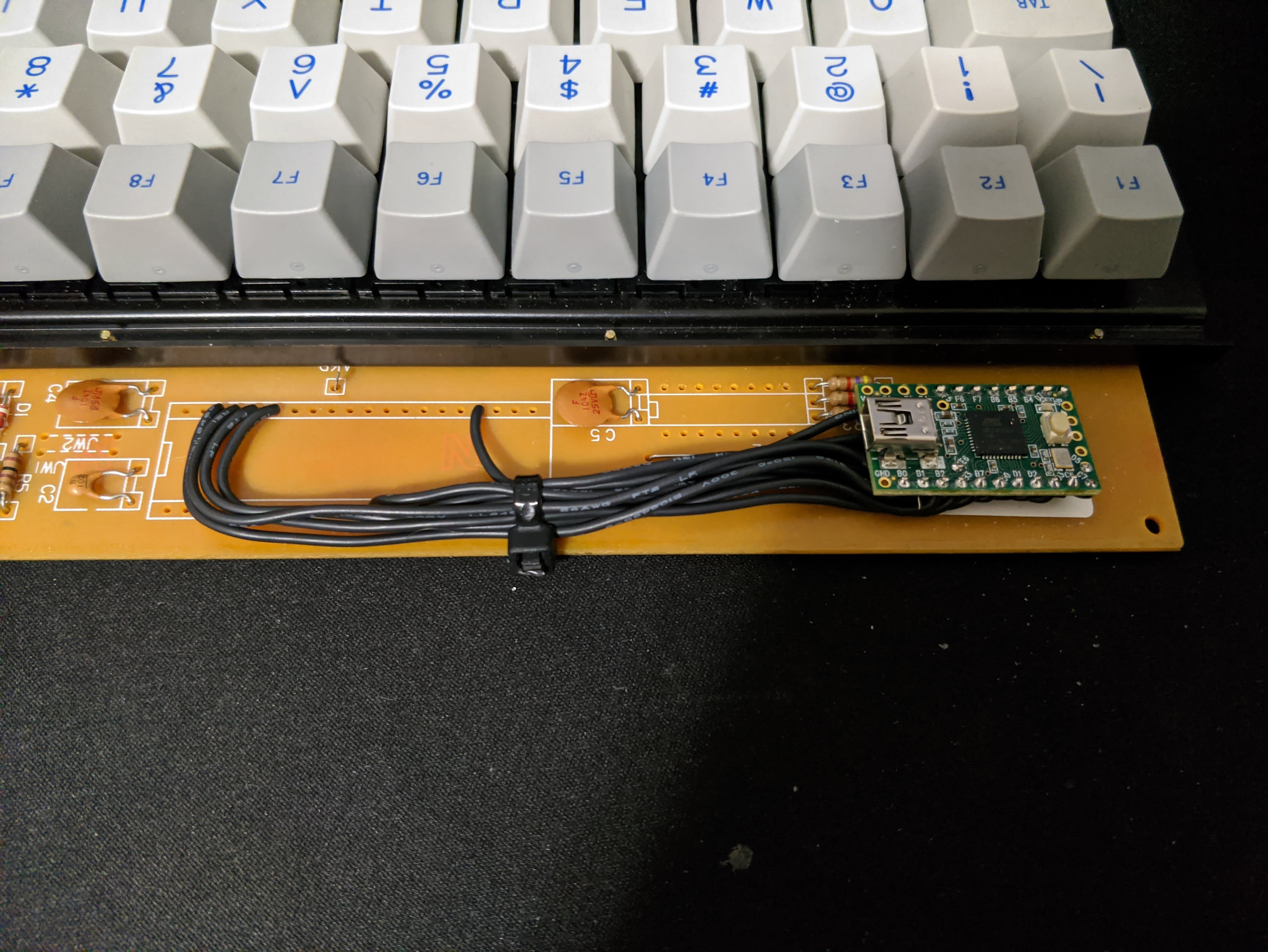

hellothere
06 Dec 2020, 20:58

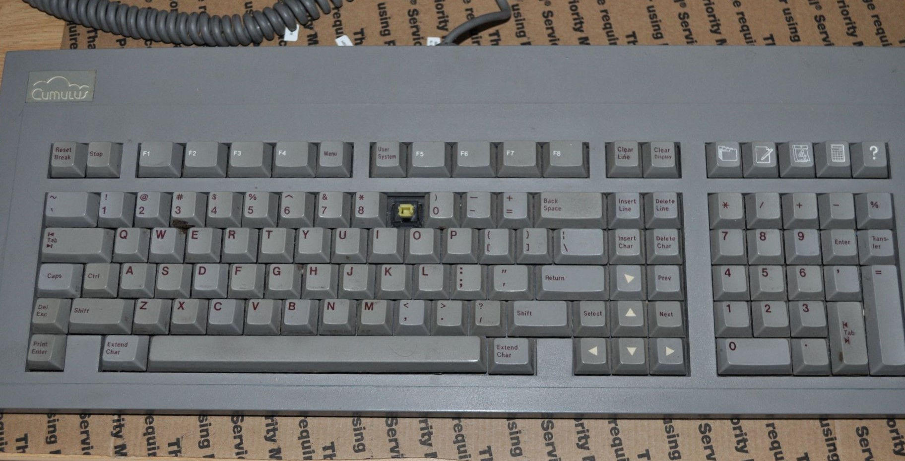

Quartz64 wrote: 06 Dec 2020, 20:25 If you aren't familiar with 'layout', 'keymap' and other basic concepts of QMK, I can help with the firmware and specific MCU. Do you have a photo with keycaps installed?
I'm very shaky on the whole thing. So, I don't mind more info.
Keyboard pic attached.

07 Dec 2020, 12:04
So, here is the firmware (my fork of QMK repo, the code is in keyboards/handwired/cumulus) and brief guide:
  1. Install QMK toolchain (docs), and use my QMK branch from the above link.
  2. Teensy 2.0 mounting position, view from the bottom side of the PCB. Columns 0–9 and rows 0–3 are already aligned nicely to the pins of the Teensy. You need some additional wire bridges to connect the last six columns (A–F) from another area of the board and 4 rows.
  3. Build debug firmware first:
    make handwired/cumulus:debug
    It has LAYOUT_debug macro (see cumulus.h) which describes 16x8 matrix with all positions active. On top of it there is keymaps/default/keymap.c (logical layout). All keys in this keymap don't output any keycodes (they all set to KC_NO), but there is debugging code in process_record_user function that prints row and column numbers of a pressed key to a console.
    Flash this FW to the Teensy, launch QMK Toolbox and start pressing keys. You should see something like this:
    HID console connected: Hellothere Cumulus
    > row 5, col: 4, pressed: 1
    > row 5, col: 4, pressed: 0
    > row 2, col: 6, pressed: 1
    > row 2, col: 6, pressed: 0
  4. Find LAYOUT macro in the beginning of cumulus.h file and replace rows and column keys (K00, K01, etc.) in first half of the macro with real key coordinates from the console. Example: row 5, col: 4 corresponds to K54; row 2, col 11 corresponds to K2B, etc.
  5. Edit the second part of the macro (enclosured in curly braces): replace every key definition which is absent in the 1st part with XXX. The meaning of this: 16x8 matrix has 128 keys, but our keyboard has 111 keys, so we must exclude keys which doesn't have any position in the matrix.
  6. Open config.h, find Bootmagic Lite key configuration section on the bottom of this file and write row and column of the top left key of your keyboard (the one with Reset/Break legend). You can use this to reset your Teensy to the bootloader (normally you use the button on the Teensy for this): to trigger the bootloader, you hold this key down when plugging the keyboard in.
  7. Compile and flash the normal FW:
    make handwired/cumulus:default
  8. Use keymaps/default/keymap.c as a template to create your own keymap

Second, because I was confusing myself when doing rows and columns, I numbered the key "holes" on the PCB: 114. I don't think that changes #5. It just means I have fewer exclusions, right?
I'm about 75% finished coming up with the rows and columns. The number pad and some keys surrounding that are giving me fits.

I have swapped columns and rows, i.e. I treat the pins marked "columns" on your photo as rows and vice versa, just for convenience
hellothere wrote: 08 Dec 2020, 22:26 I numbered the key "holes" on the PCB: 114. I don't think that changes #5. It just means I have fewer exclusions, right?
Take a look at the the photo from the front side. Your keyboard has 111 keys in this particular layout. Those additional mounting holes.are for other layouts. E.g.: your actual bottom row has 9 keys, but has 11 switch mounting holes on the PCB.
hellothere wrote: 08 Dec 2020, 22:26 I'm about 75% finished coming up with the rows and columns. The number pad and some keys surrounding that are giving me fits.
When you have found row/column pins you don't need to trace every switch on a PCB with graphical editor or multimeter. All you need to do is use matrix debug facility of QMK (see my previous answer). Exclusions: 1) Extremely messy PCB layout 2) Some layout modifications needed (e.g. changing a connection of some keys to a matrix) 3) Adding diodes (for that you need to know which pin of a switch connected to row or column.
Just flash the "debug" firmware first, open the console, press every key row by row, write down their row and column numbers to cumulus.h, to the 1st half of #define LAYOUT) and exclude row/col matrix positions which aren't used by your keyboard from the 2nd part of this macro by replacing a corresponding "Kxx" with "KC_NO" or "XXX".
Quartz64
09 Dec 2020, 09:05
P.S. Multi-unit vertical keys (2U "Tab" and 3U "=" on this keyboard's numpad) are considered to be on the same row with their top part. E.g. 3U "=" key is placed in the same logical row as "4", "5", "6" and "," keys (see cumulus.h).

Regardless of whether it's really needed or not, I did ~ mostly ~ finish up mapping row and column matrices. It's got a couple problems, but it took a rather long time to even get to this far, so ...
a) Forget about the "handwritten" rows and columns notations. I did it the other way around, as mentioned in an above post.
b) Key #2 is for more columns.
Quartz64, if I understand you correctly, it's only necessary to know that something like pin A on the controller maps to row A, right? If that's the case, that makes life an awful lot easier.

17 Dec 2020, 16:09
Update:
Looks like this "Cumulus" keyboard represents the case when there is real need to trace all the matrix manually (visually). I've done this in Photoshop (file) and here are my findings:
  • Matrix is 17x9, not 16x8 as we expected from the initial brief look.
  • There are two pairs of keys that connected in parallel: "Shift" and "Extend Char". It will be good to separate them.
Good news: three columns and one row are almost empty, so we can move some of the keys to a new positions in the matrix and pack it in 14x8. There is 111 physical keys, new matrix gives us 14x8=112 positions, so it fits perfectly.
Five keys need to be moved to another rows/colums: Ctrl (the key between Caps and A), Left Shift, Left Ext Char, Right Shift, Right Ext Char.
I have updated cumulus.h, take a look at it. Tomorrow I'm going to add some additional layers to that Photoshop file with proposed Teensy 2.0 pinout and where to cut/reconnect the traces.
