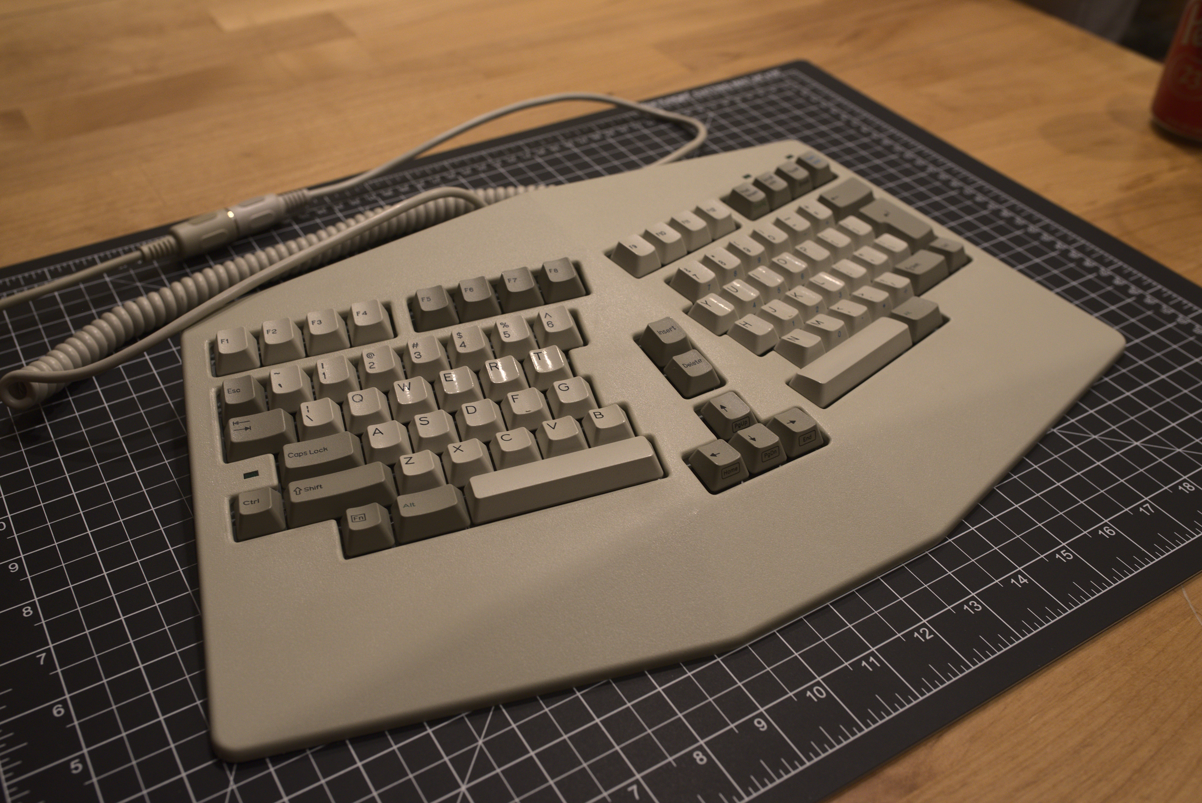

My mind is telling me vertical 2u, but my body is telling be 4u+4u
3u+3u is great. Symmetrical bars are hot. Asymmetrical bars too. Really split bars are great in general.
I should really stop shooting in raw, the color correction is weird with Gimp
- DSC_3450.jpg (2.5 MiB) Viewed 6273 times

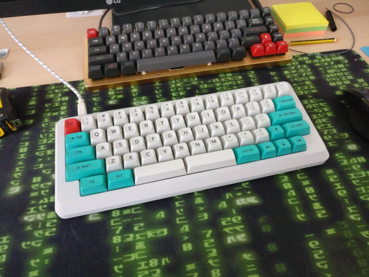

So... I did it. This is just a 3d printed prototype, but it's already my daily driver.
I believe it took me about 4 days to get used to the more recessed arrow cluster position and the right shift, but now it's like second nature.
I'll try to work on a PCB next, possibly to pair with an adafruit BLE controller. We'll see. Hopefully I'll post more about it soon.
