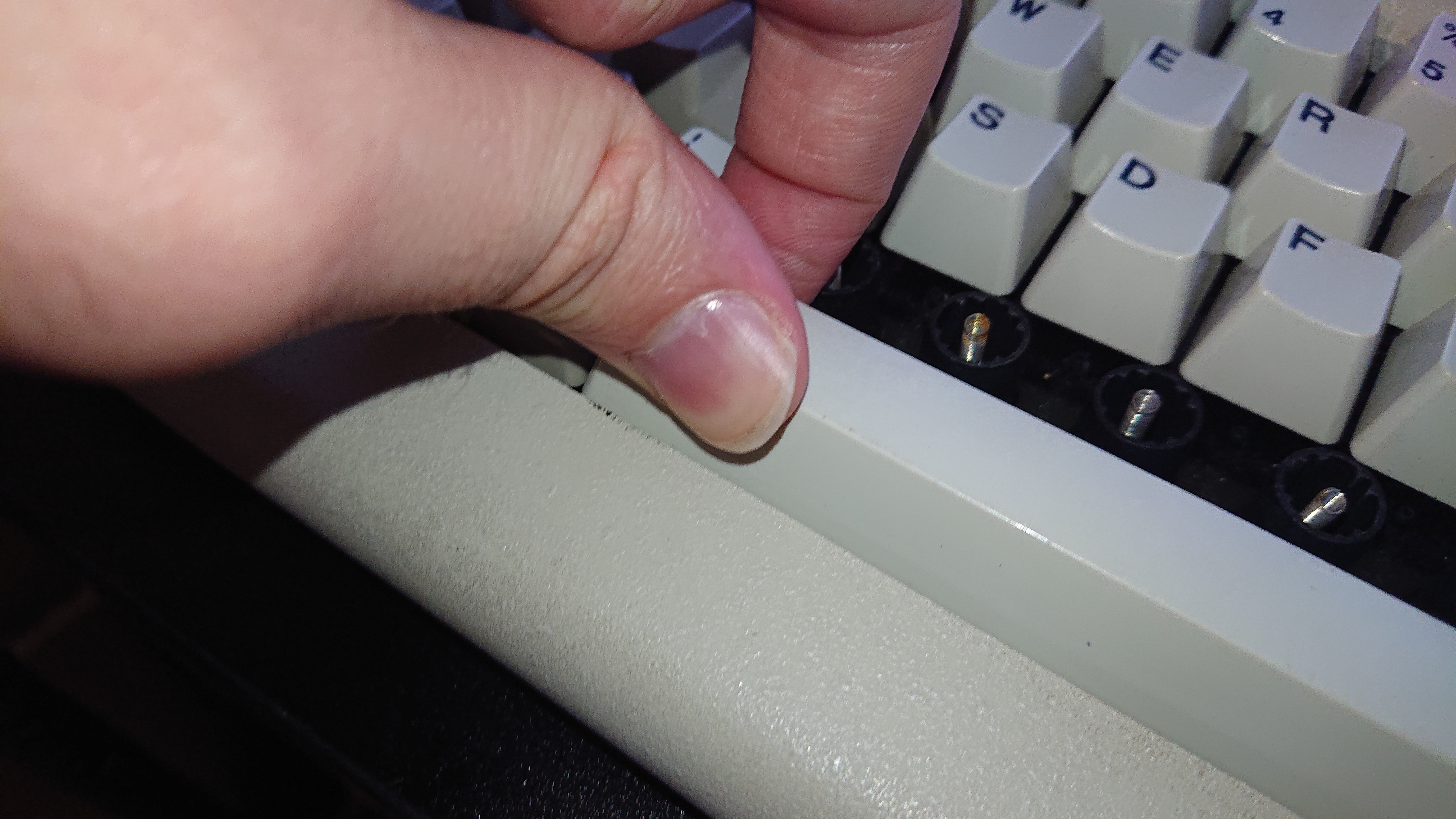

Anyway, a couple years back, I restored my XT keyboard, and in the process of re-assembling I broke the flipper on the spacebar. (Thank you Ellipse for selling me some new flippers! And I'm glad I was finally able to purchase a full keyboard from you!) I ultimately decided that assembling this thing with the spacebar on it was not going to happen.

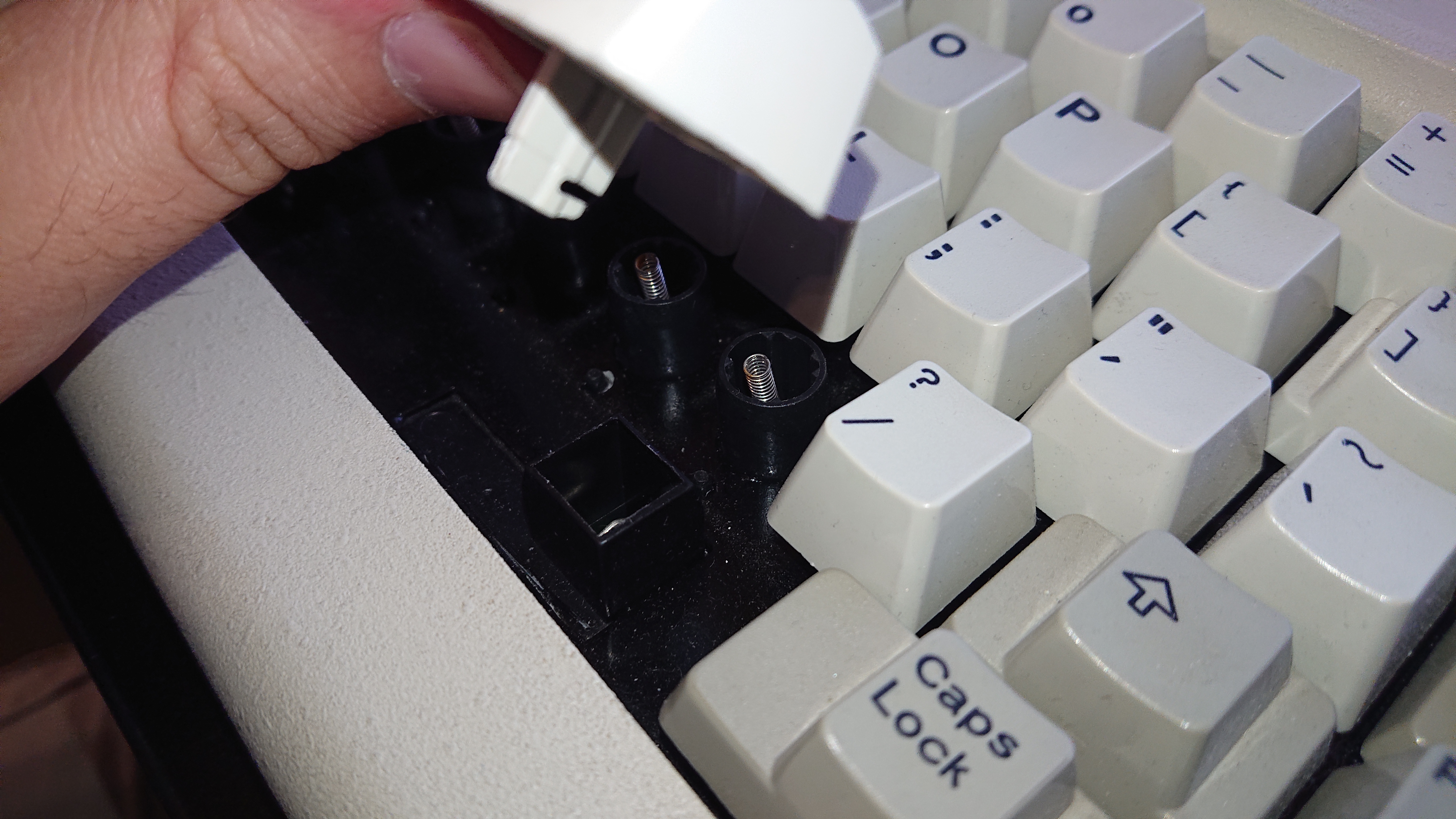

I read up on the whole drill some holes in it and fish it out with floss thing, but I really didn't like that. So ultimately, I ended up devising something that, in my opinion, is a whole lot more elegant. I simply re-shaped the part of the spacebar that holds the stabilizer bar on. I'd previously shared this info on /r/MK, but I hadn't actually joined DT until about a week ago now. So I think it's worth posting here as well in case it's able to save anyone down the road a myriad of headaches. Below are the two images I'd originally posted to /r/MK, which unfortunately aren't very good. And I don't really have a before picture to post sadly:
As well, here is a link to my original Reddit thread.
With these plastic bits reshaped as is, I am able to remove and replace the spacebar without complete disassembly. It does require a little torsion to do so, but not overly much so. The stabilizer is definitely not going to come off by itself, and I don't feel I've weakened the integrity of the plastic in an appreciable way. Ultimately, I see this as a major oversight in the design of the spacebar, and it's really not a hard one to fix.

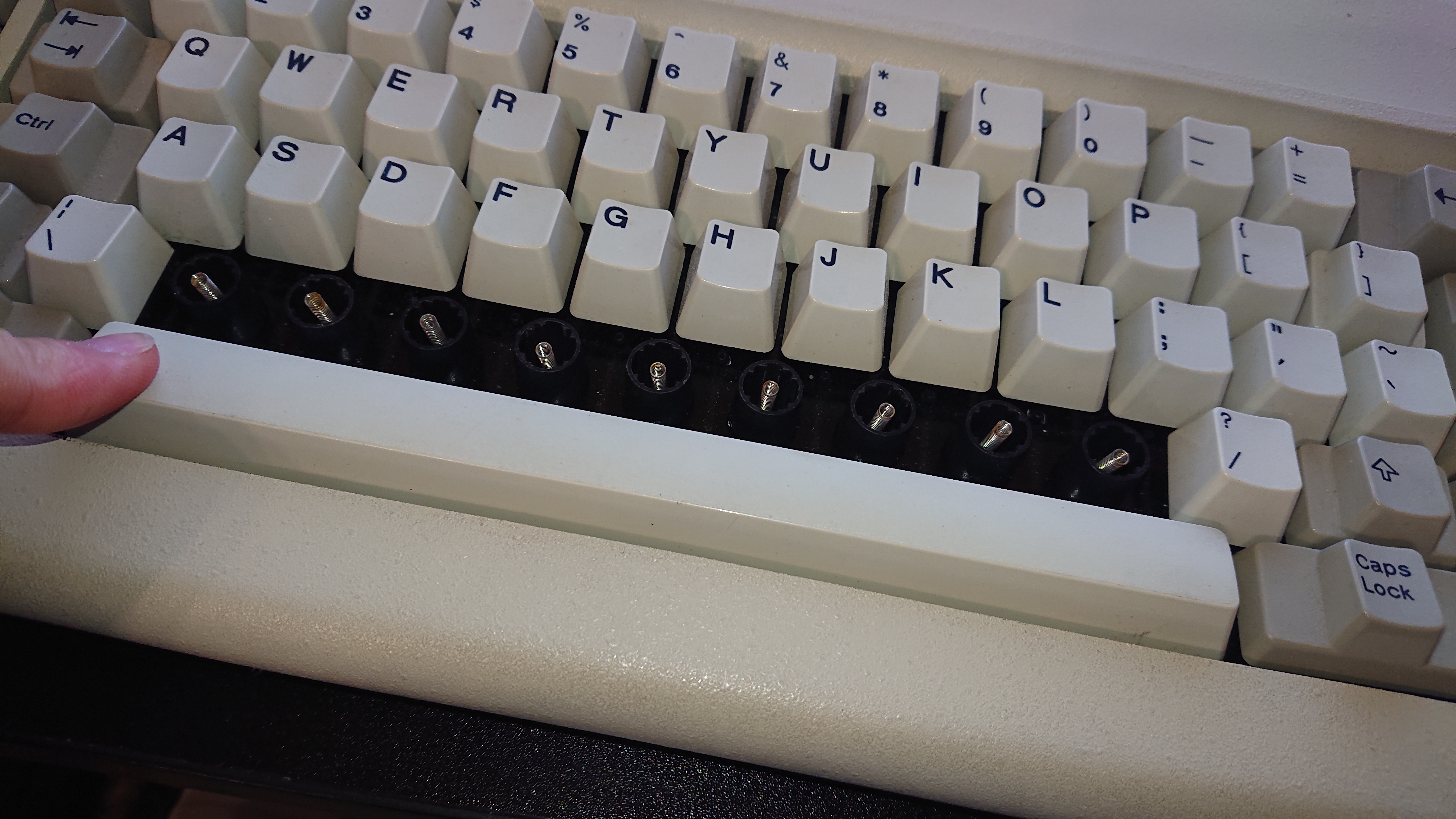

No floss required! I actually just pulled my spacebar off for the first time in a long time to see how exactly this works again. (I use this keyboard with its original XT, so it doesn't get a whole lot of use) I took to opportunity to get pictures and to remember why this works.
First, let's look at where the stabilizer ends are:
This is what makes attaching the spacebar such a nightmare with the typical design. But, with this modification this is not an issue!

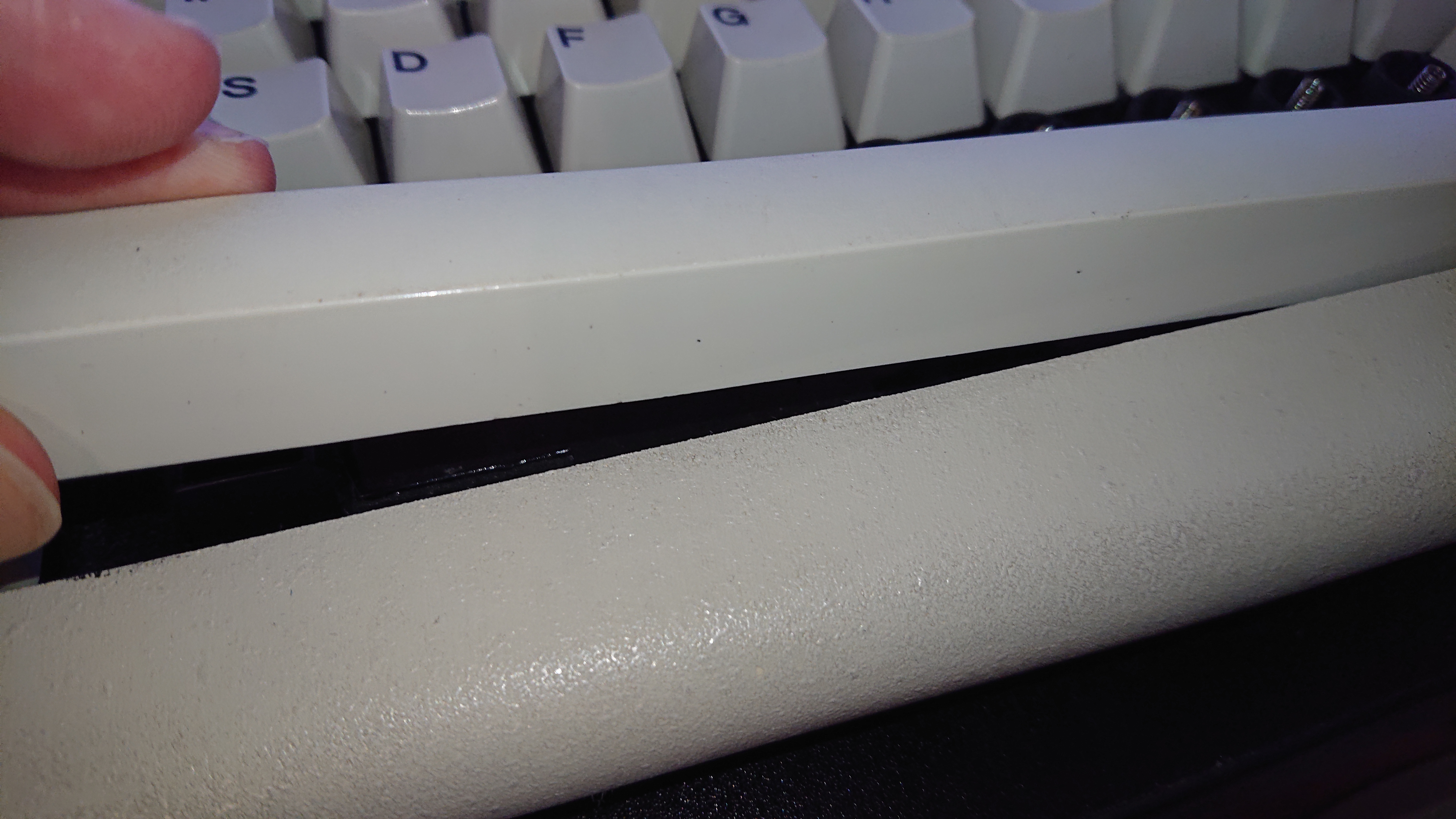

By filing off the back, we have just enough room to maneuver the clip onto this end of the stabilizer bar

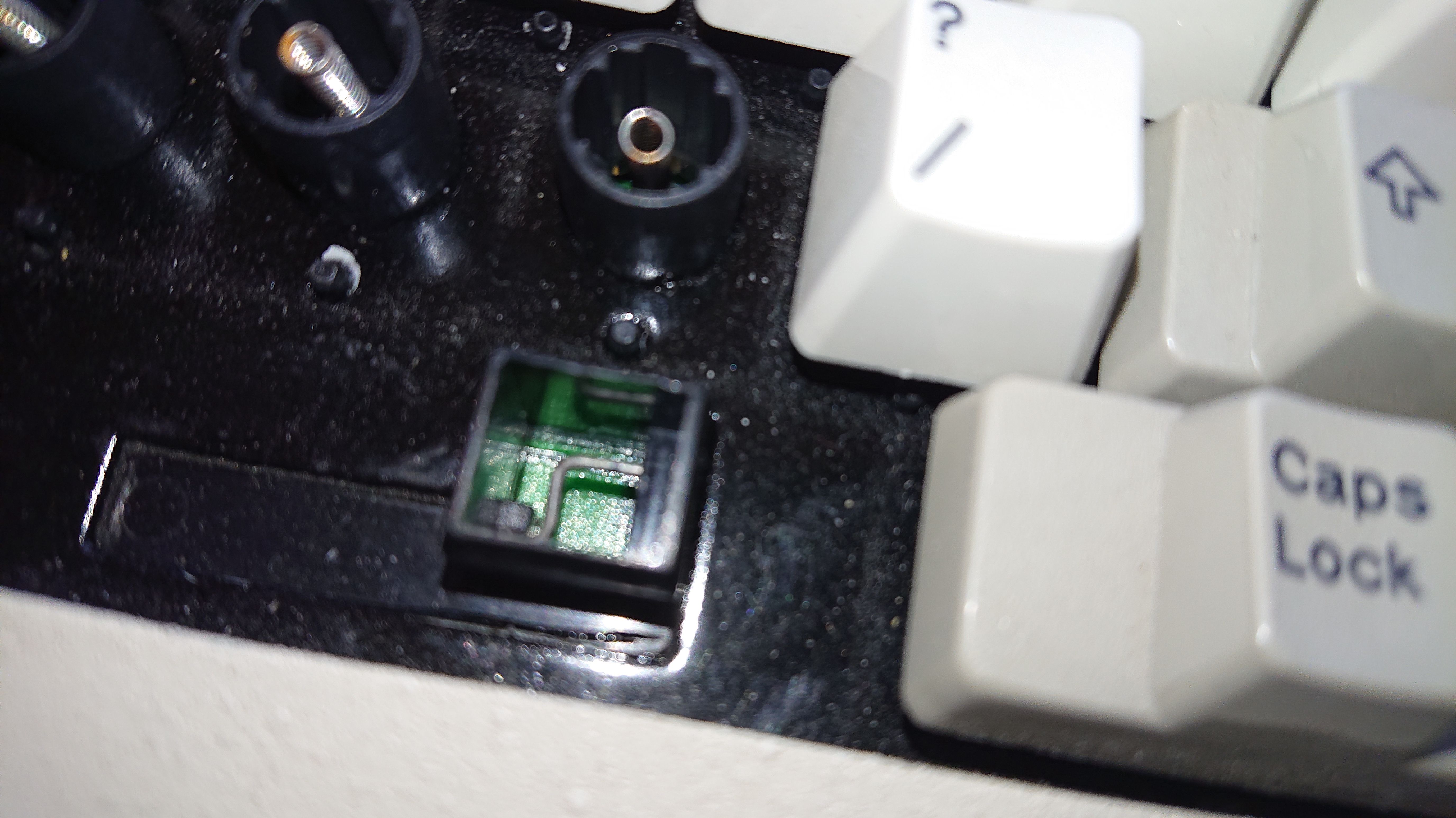

Next we want to set the center into the holiness that is the buckling spring switch

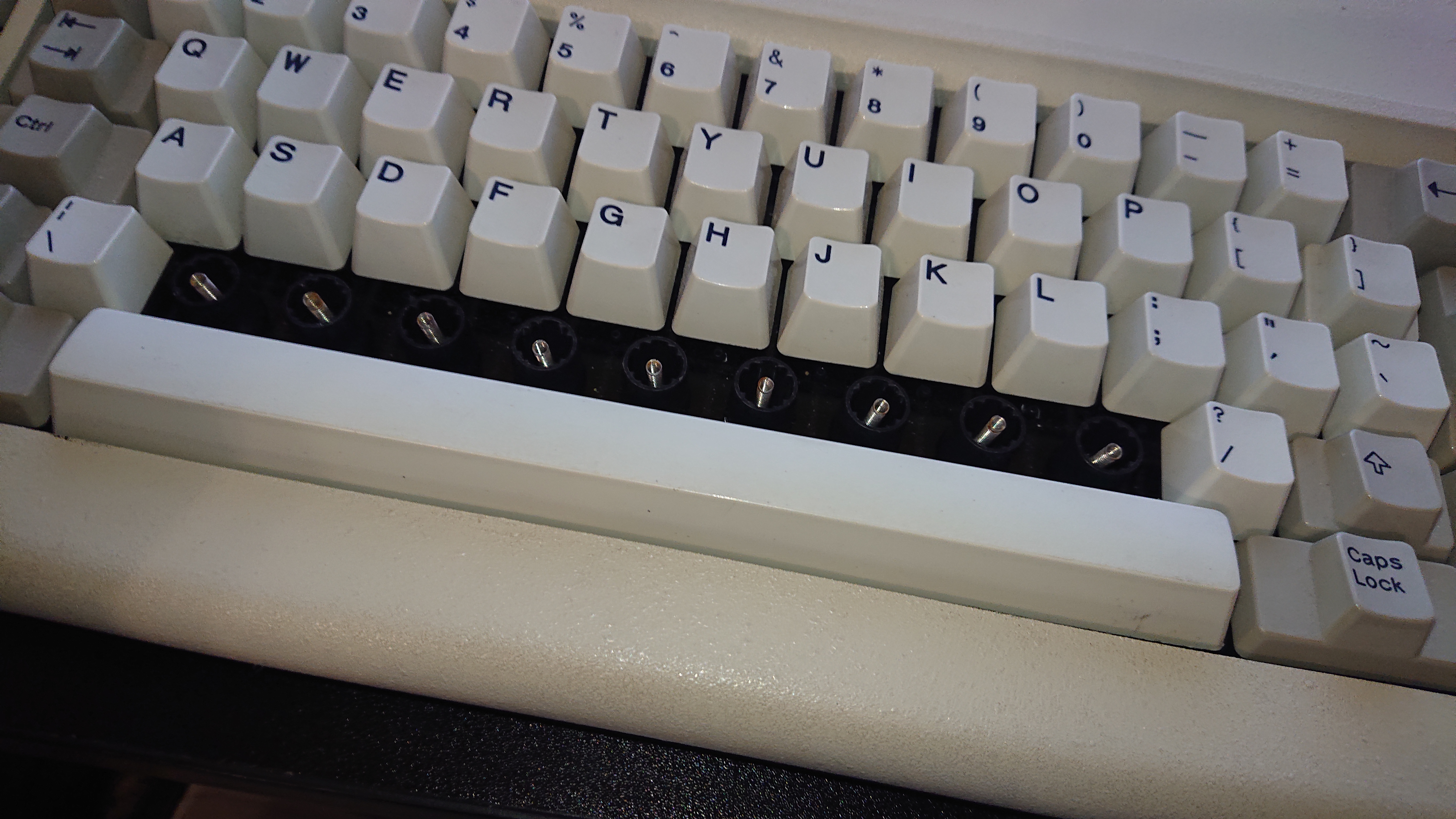

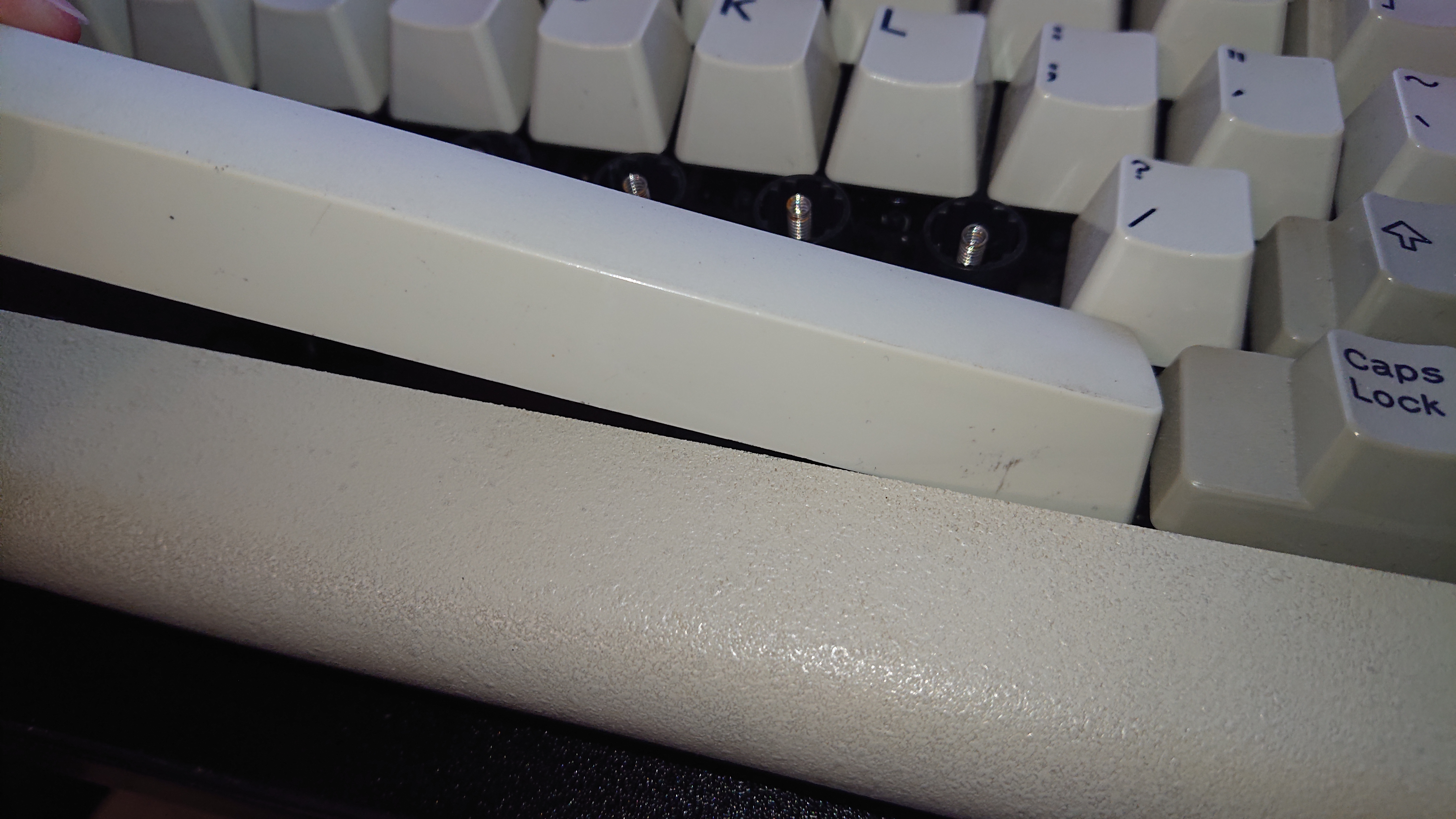

Lastly, because the inside of the slot has been given a slight curve, and the other end of the spacebar is holding the stabilizer bar up, the stabilzier bar can pop into its slot on this side very easily. I have to give mine just the slightest twist, but I think with slightly more filing it might not even need that.
And just like that, the spacebar is attached with little hassle and fully stabilized!
As you can see, this mod is so much less effort than the drill holes/use floss method, and less (but still partly) destructive. If you're 100% hell-bent on leaving your keyboard unmodified, then this method obviously won't work, but given how minor it is, and how much of a serviceability improvement it makes, I think it is very well worth it!

Little bump here, but I have successfully modified my XT with the help of this thread, although the method described here is slightly different from the ideal method. I found that any modification of the hooks on the space bar results in a space bar that will come off too easily. The safer method is to shave material from the back of the spacebar, if you shave off enough material you can torque the space bar enough for an unmodified hook to catch the wire.
