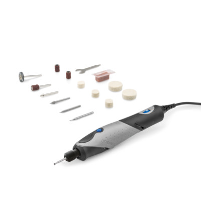

A rotary tool (I recommend a Dremel Stylo which is what I use)

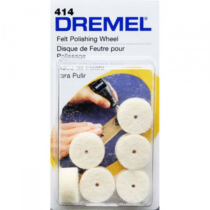

Small cotton felt tips for rotary tools. I only used the Dremel 414, so that is the only type that I can recommend. These are the 13mm size (7mm in thickness).

Polishing a Blue SKCM
Here is a (rough) video of how to polish without damaging, a Blue SKCM switch. After the polish the condition will greatly be improved. Notice the spots that I polish and how careful, quickly and lightly that I do them. You can always test them and re-do them, so it's better to do it lightly.
Tools used:
A Dremel Stylo (rotary tool) in low RPM, (somewhere under 10k RPM), or any rotary tool
A small cotton felt tip for rotary tools. I only used the Dremel 414, so that is the only one that I can recommend. I am sure there are plenty of others in the market though but I don't know if they are of the same quality meant for this job. These are the 13mm size (7mm in thickness).
