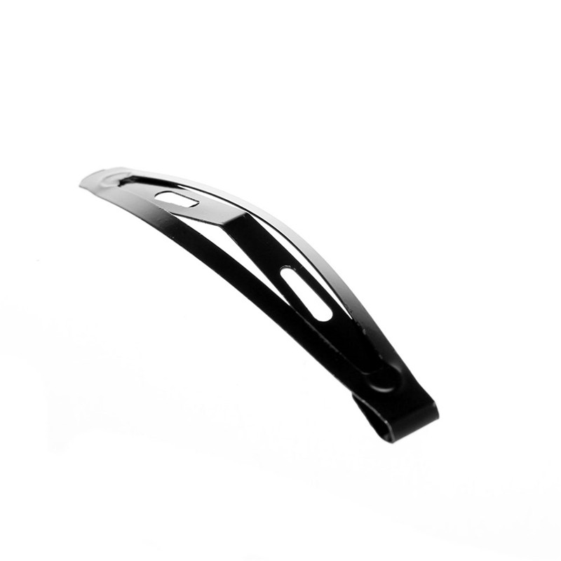

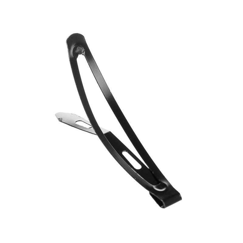

We have buckling springs and buckling beam springs, but are there buckling domes? Those hair clips (hair pins) describe the basic construction closely. They're made from two parts, one buckles and one doesn't. All you need is the part that buckles. I think they could feel pretty good.
The buckling part starts out as a single strip of metal, then a long hole is cut out in the middle. After that, it's essentially two long strips of metal, joined at the end, and they are still parallel. Next up, where they join, a pin is driven into the metal, embossing them. Those are the round depressions. That makes the two halves of the thing assume an angle compared to one another.
The nice thing here is that you only need one part for the spring, instead of two parts that have to precisely mate like they do with a beam spring, which saves on complexity. By changing the geometry of the buckling dome, you can modify the feel in significant fashion:
- width of strips
- angle between strips
- how deep the embossing is at the place where the two strips join
- how thick the metal is and what kind
- how long the metal strips are
- the shape of the strips (straight (before embossing), wavy, etc)
That's six parameters. It's a lot. I feel like you could easily find a lot of fun combinations this way.
