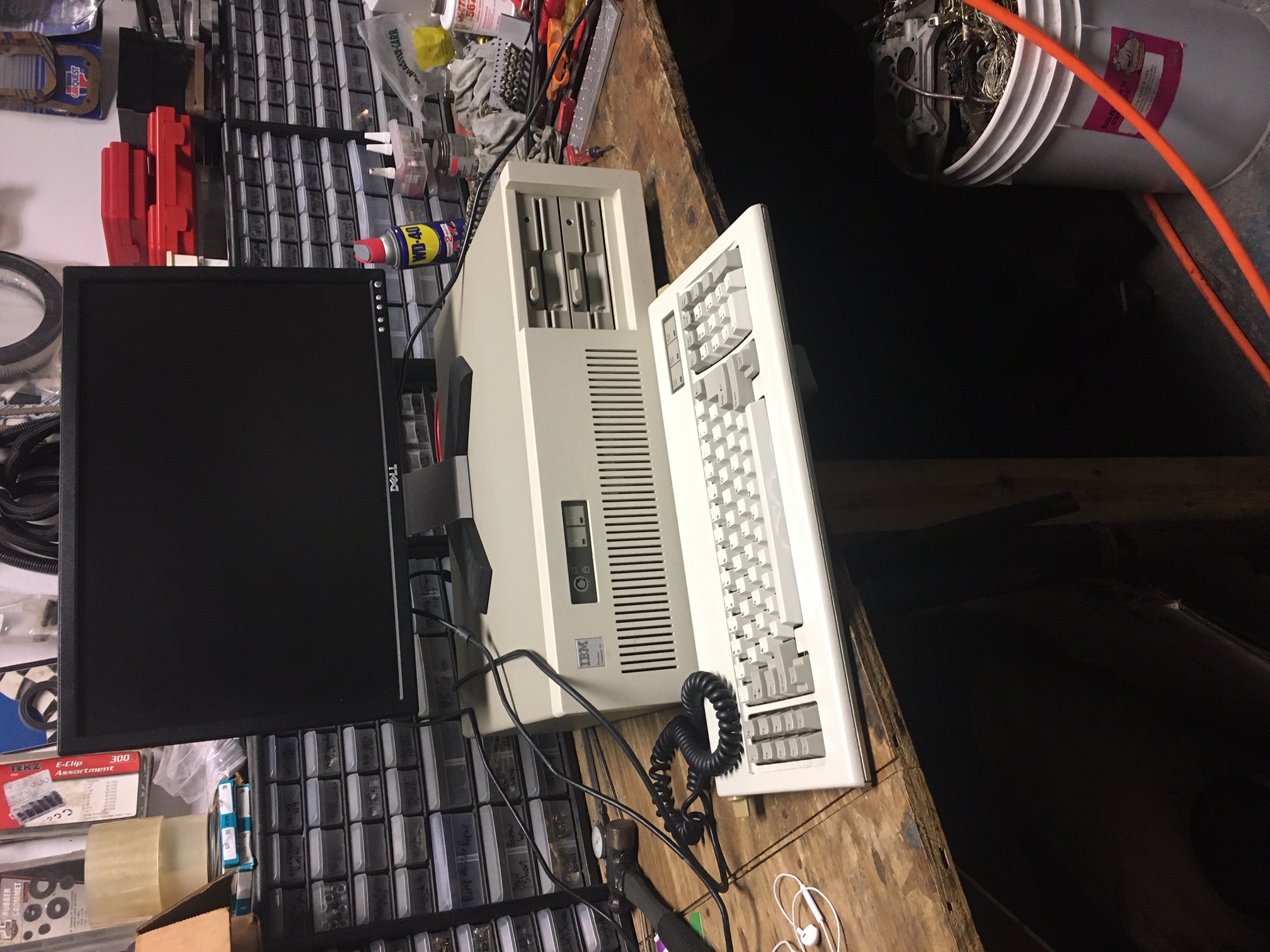

Hello, I've never posted on here before. However recently I acquired an IBM 5170 with its original keyboard. I got the system working after recapping the PSU a bunch. The BIOS chips I think then shat the bed and I am waiting on some diagnostics equipment to come in the mail.

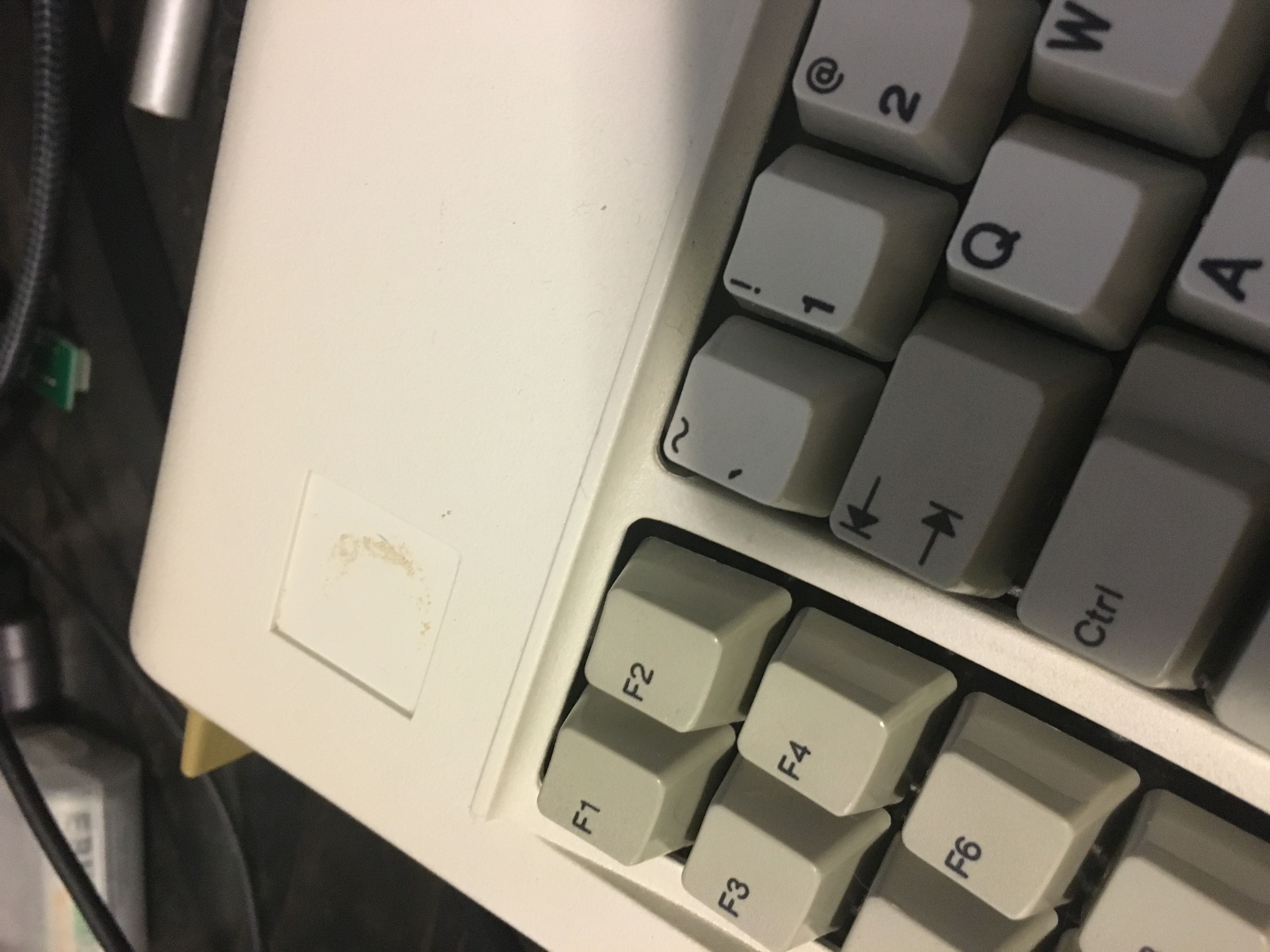

But in the mean time I've been thinking about the model F I am typing on right now, it is in nearly perfect condition and I cleaned it up a lot so its no longer sticky to touch, I wasn't able to open it up without fearing of accidentally breaking it (those bottom latches did NOT want to come loose).
However the the original square IBM badge on the corner is missing. So my question is, where could I find a cost effective replacement for this badge? I don't even care if the replacement is original or not, I just want a form of IBM badge to cover up the blank spot on the keyboard (preferably one that says "IBM Personal Computer AT").

There are some high quality stickers you can get online, not the same but still looks good.

I'm in a similar position, so I'd be equally interested in any suggestions. I recently acquired an XT keyboard, which I've been gradually refurbishing. It does have the badge saying "IBM Personal Computer", but most of the letters have worn off. I was considering possible ways of fabricating a replacement. Dye-sub printing onto aluminium would probably be best, I guess, but beyond my abilities. An easier option would be that transfer paper you can get for inkjet printers: print the label, transfer it to thin brushed aluminium, then spray it with a clear coat for protection.

Been thinking about transfer film as well, would be interested in seeing how it turns out.

A trophy shop or a shop that makes dash plaques for car events should be able to make an exact replacement, or anything you want for that matter.

Interesting, I'll look into using an inkjet printer. If that doesn't work I'll look towards having one made online. I also have the benefit of having a badge that is identical to the original one that is on the AT's case, so it gives me a good reference.

you could use an inkjet printer and then transfer that onto a sheet of adhesive tape using a clothes iron. just make sure it's tape made out of a plastic that can withstand the heat. alternatively, print onto a transparent slide and glue it onto a piece of two-sided metal tape.
