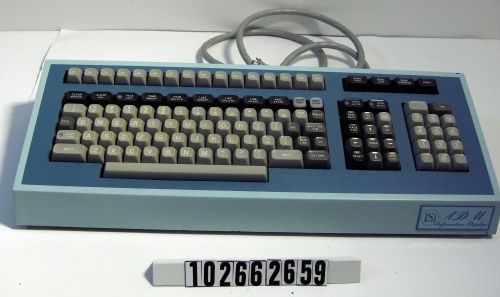

A quick backstory about this keyboard - Every since I first got into mechanical keyboards, more specifically vintage boards, I had gone on a massive scavenger hunt to find all the old boards I like to make a sort of "wish list." The Lear Siegler ADM-2 terminal and keyboard was at the top of this "wish list" for a multitude of reasons. Unfortunately the only recent photo I could find of the keyboard was one on a museum's page. I figured finding another one for sale would be super difficult.
Here's the museum's photo:

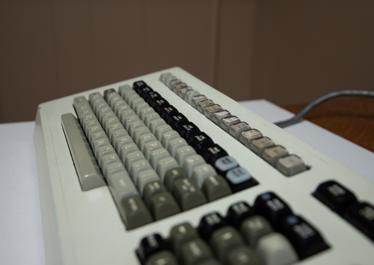

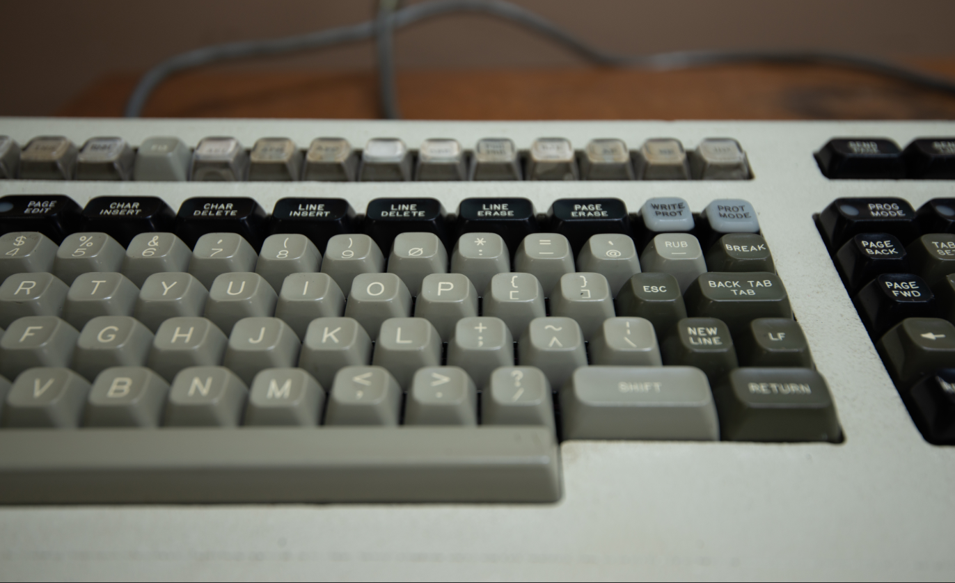

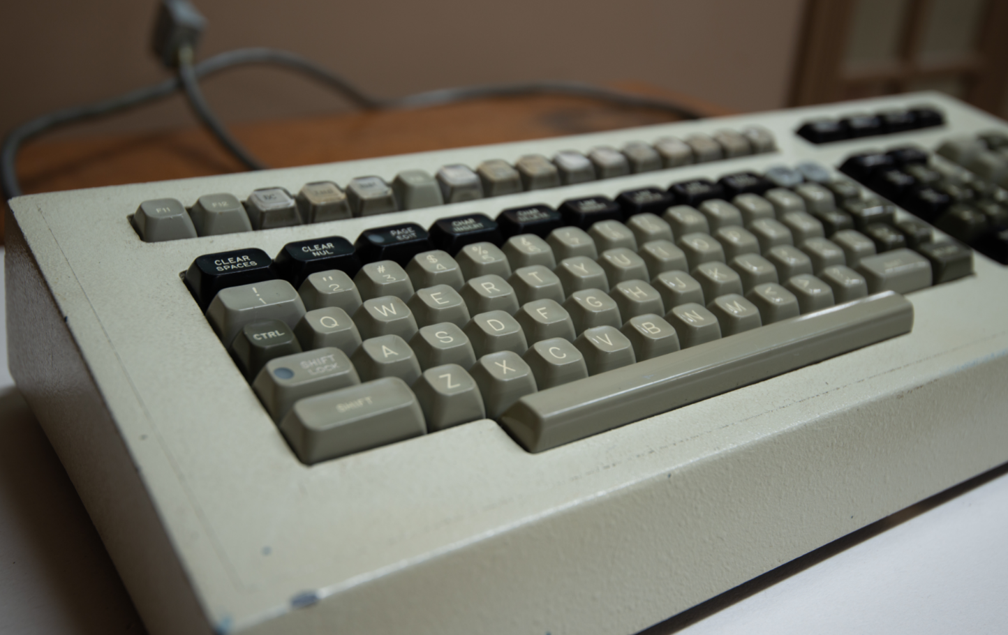

Keyboard pics:

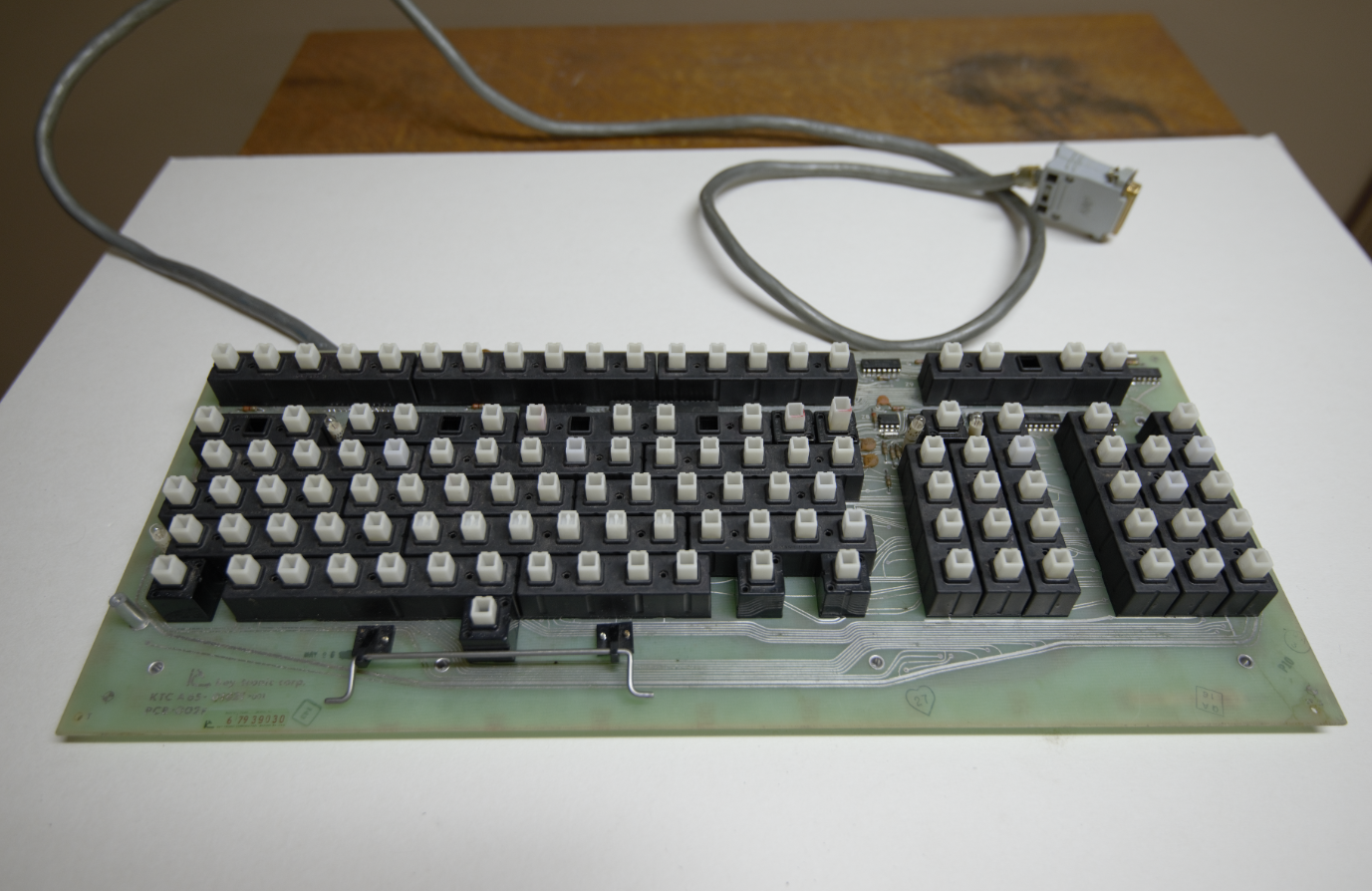

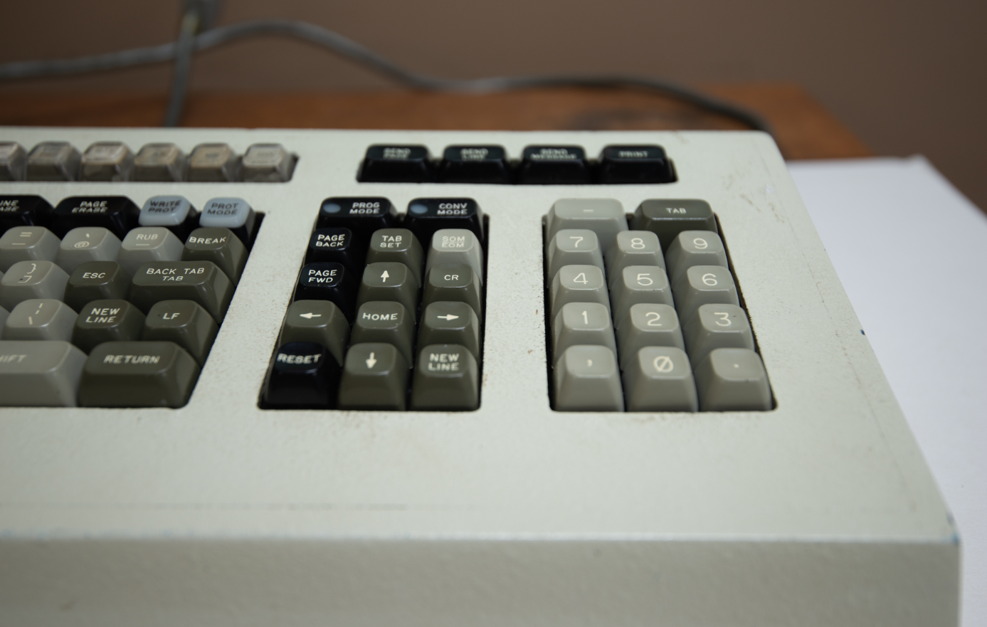

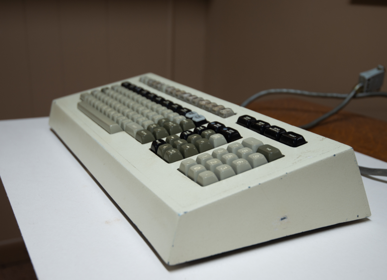

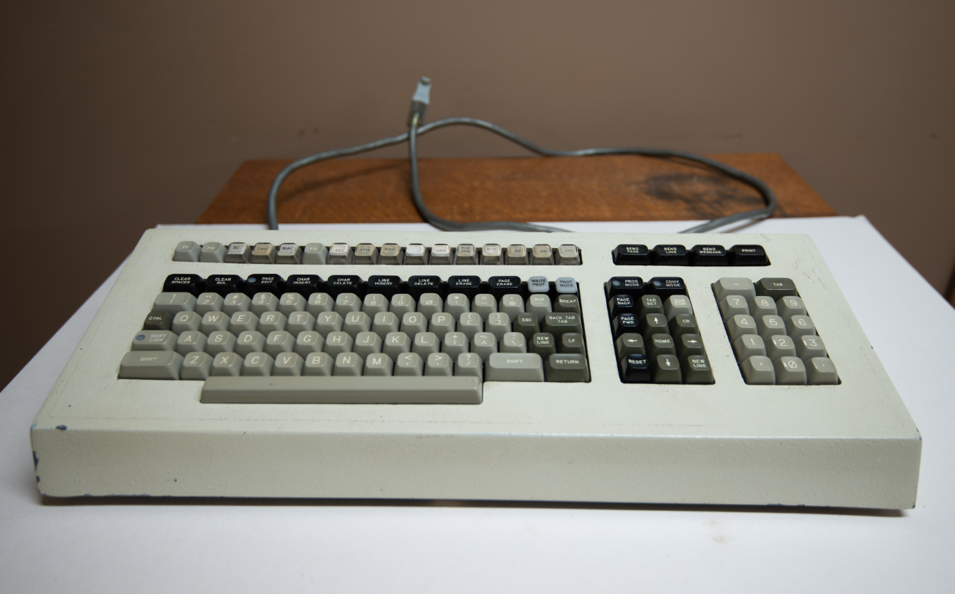

As you can see the board looks quite a bit different than it should. The blue paint on the case is completely gone and the keys have yellowed quite a bit. I'm also just presuming this is the board for the Lear Siegler ADM-2, as there's nothing written on the case or pcb that would indicate it was.

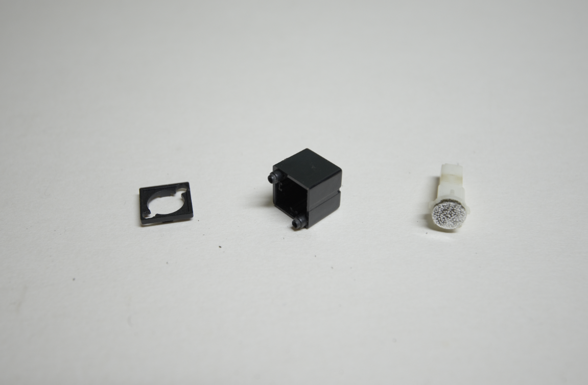

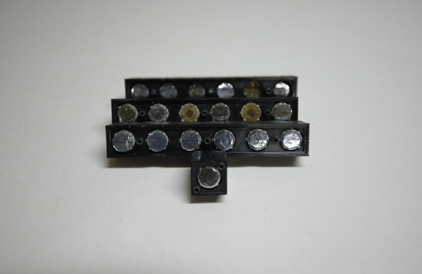

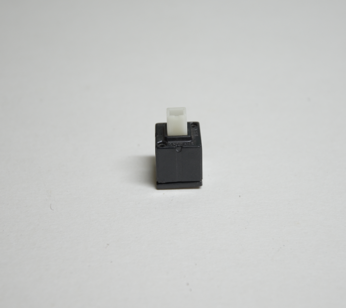

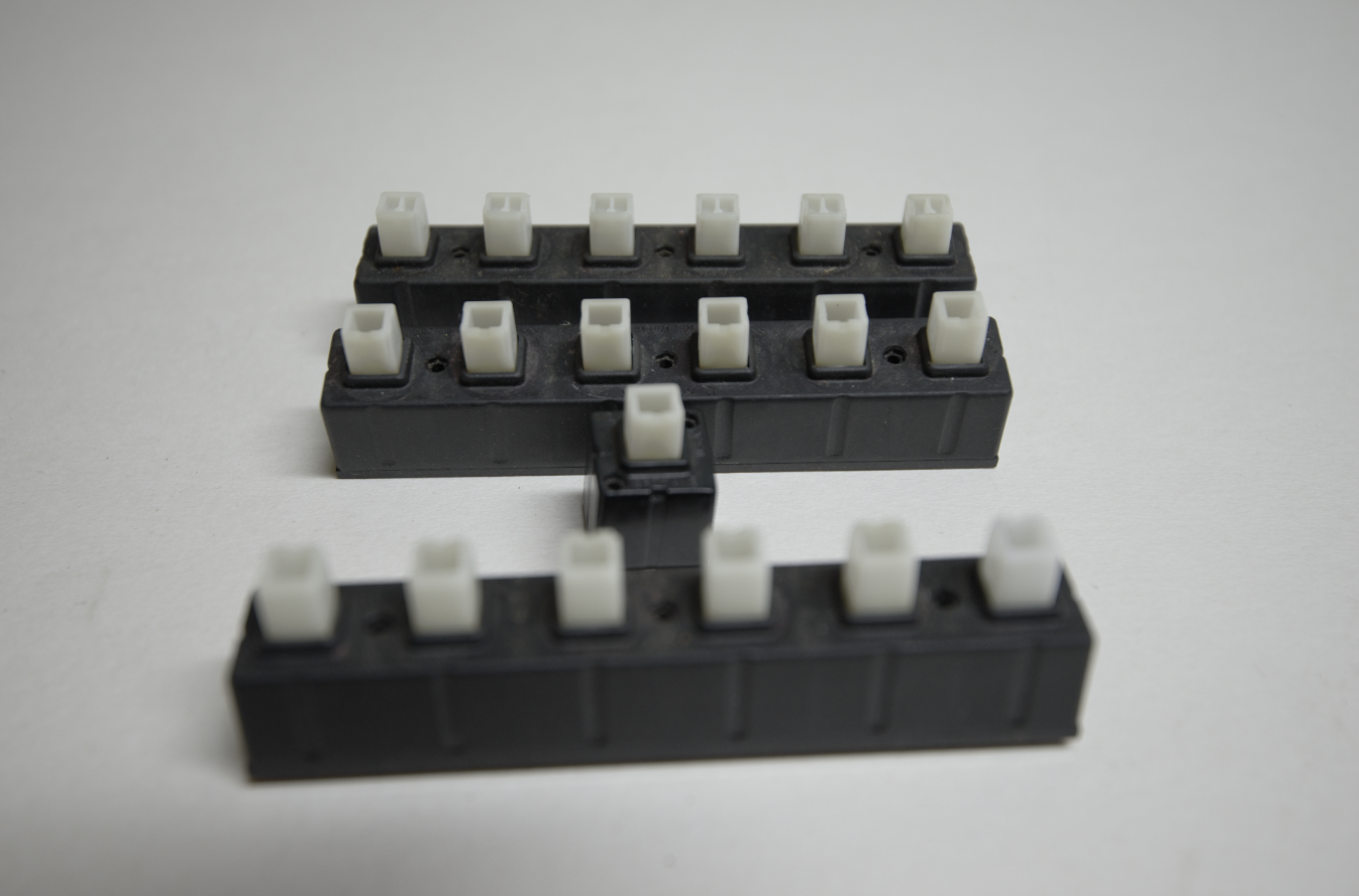

The switches are where things get interesting. We've all seen Key Tronic's "vintage" foam and foil switches. But inside this board houses what I like to call "vintage vintage" switches. They're basically a mix of KT's magnetic reed switches with the foam and foil concept. They work the exact same way as the foam and foil switches used later on except they use a long stem and are housed in blocks. Since I don't have another foam and foil board on hand right now I can't say with certainty that they feel different but I can say they feel very nice and have a very satisfying clack. The case has warped over time and grinds up against the keys on the left side, so I'll need to do some maintenance to fix this.
The switches are a bit annoying to work with. There's probably 50 screws on the back of the pcb that need to be removed to access the switches and when reassembling the board you need to make sure all the stems are facing the right direction (I didn't the first time - ugh) You can see one set of the switches has stems with a line in the middle. I presume these were more modern replacement switches. With these ones you can actually see that they're facing the right way from far away.
