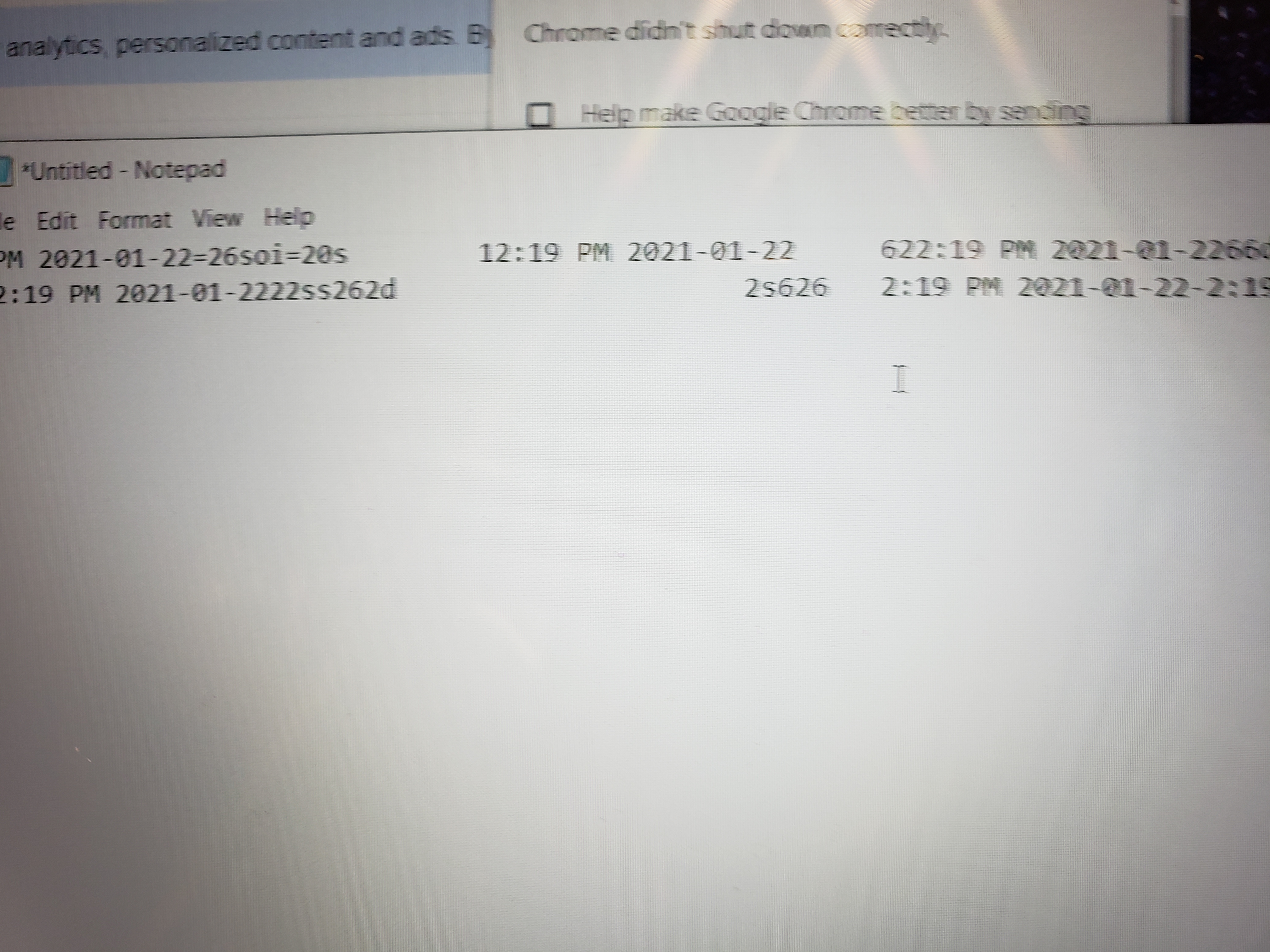

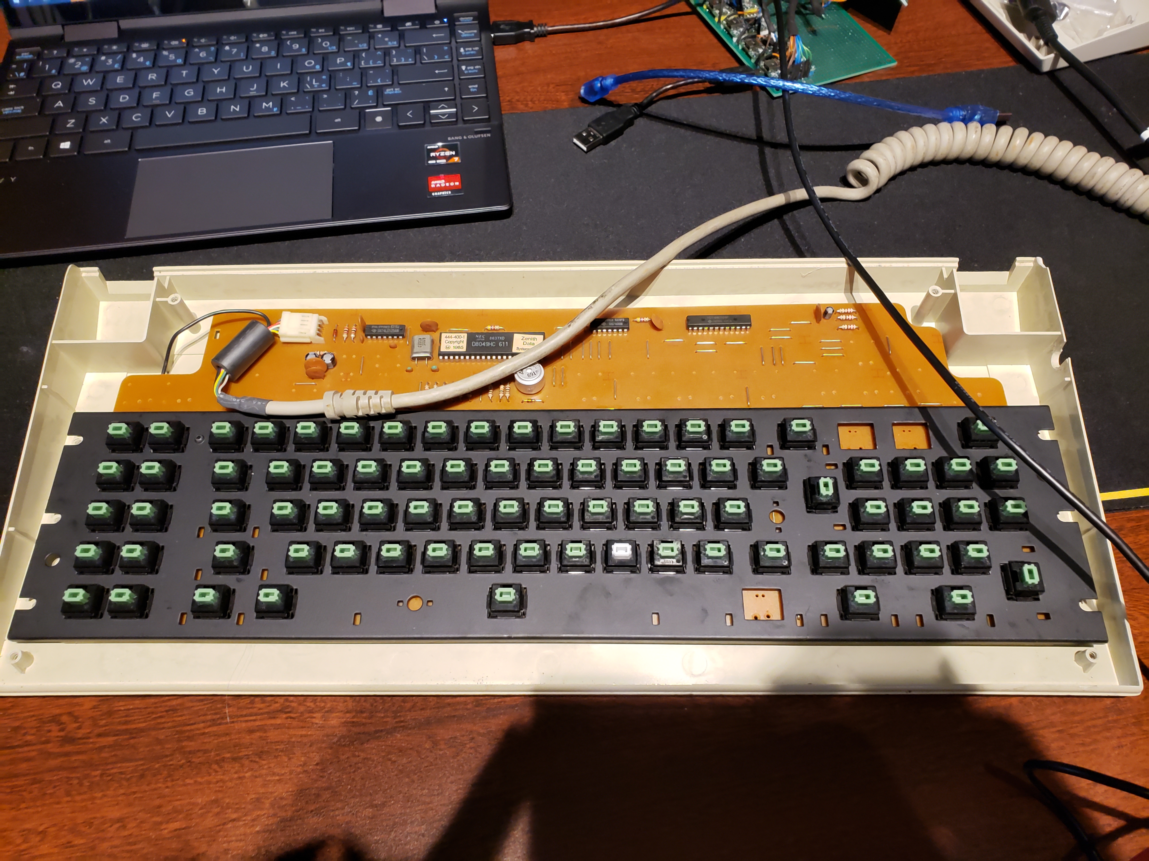

I'm currently restoring this keyboard and I just finished lubing all the switches and soldered them back in, when I tried to use it to test the switches out, it didn't work although the beeper sometimes worked and the keyboard would also sometimes spit out what would seem to be the date and time. I think it could be the capacitors, if so how would I go about identifying their values?

Wow, that plate is clean!
If you don't have a multimeter and wanna go the safe road, just replace all the electrolytic capacitors. Very inexpensive. Their capacitances are written on their sides. Mind the correct direction when soldering them back in.
Also, what's that poor, lonely bamboo white doing there inbetween all of the greens? :mrgreen:

Thanks for the tip! As for the white switch it's just replacement for a broken green lol.
