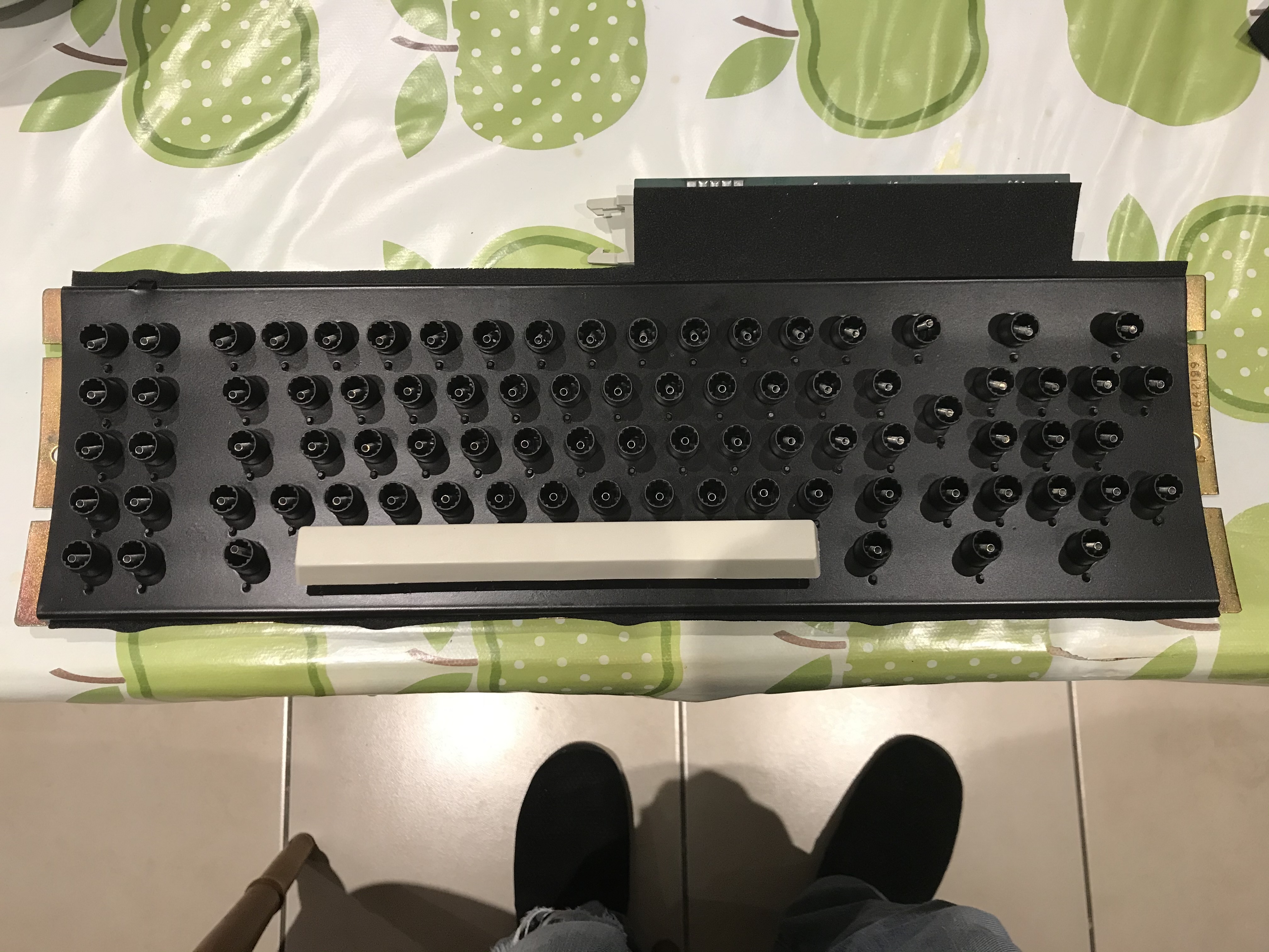

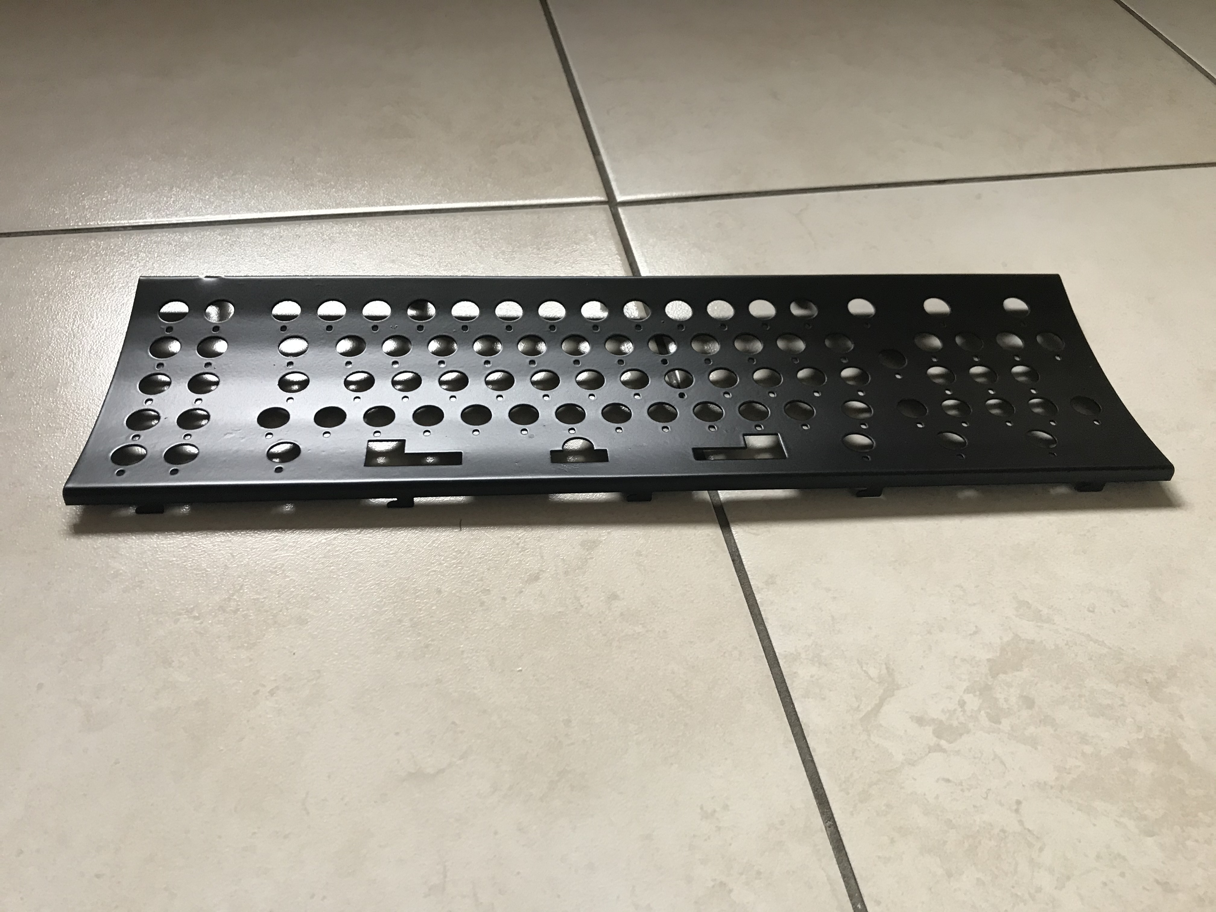

Top plate stripped and resprayed. Not a perfect job but as good as I’m going to manage. I’m happy considering it is going to be under the keys anyway.
mikeyp
08 Feb 2021, 17:40

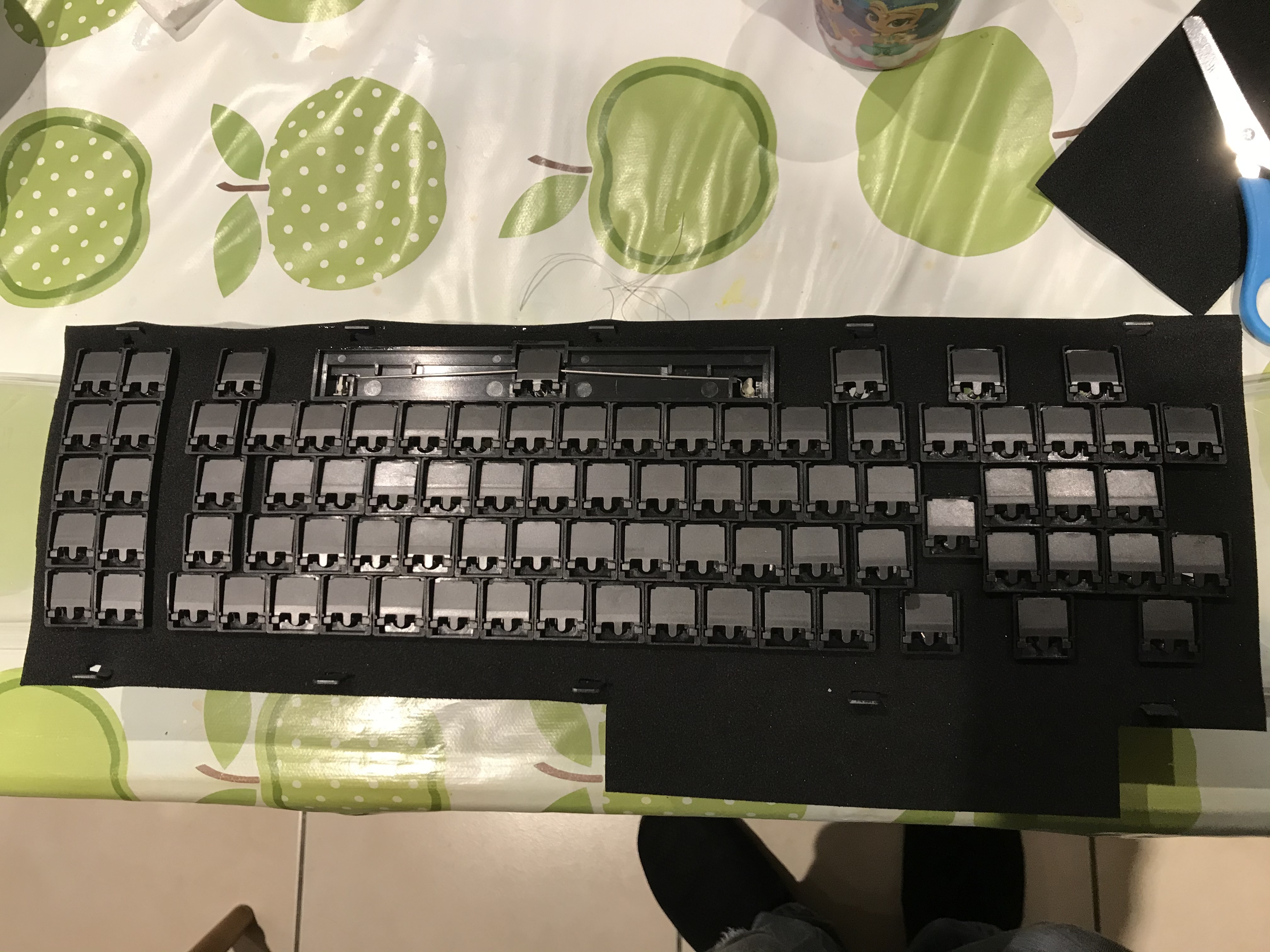

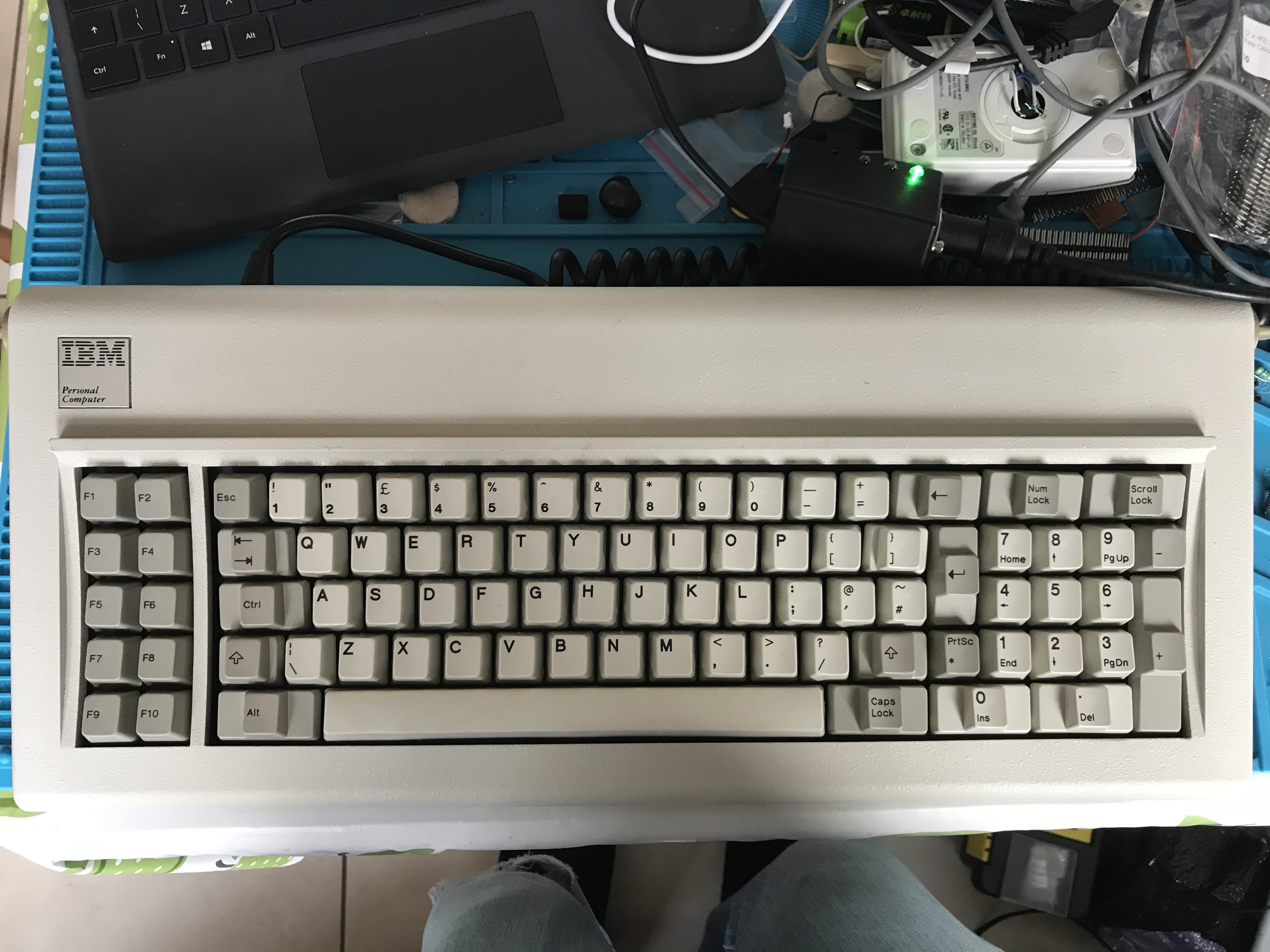

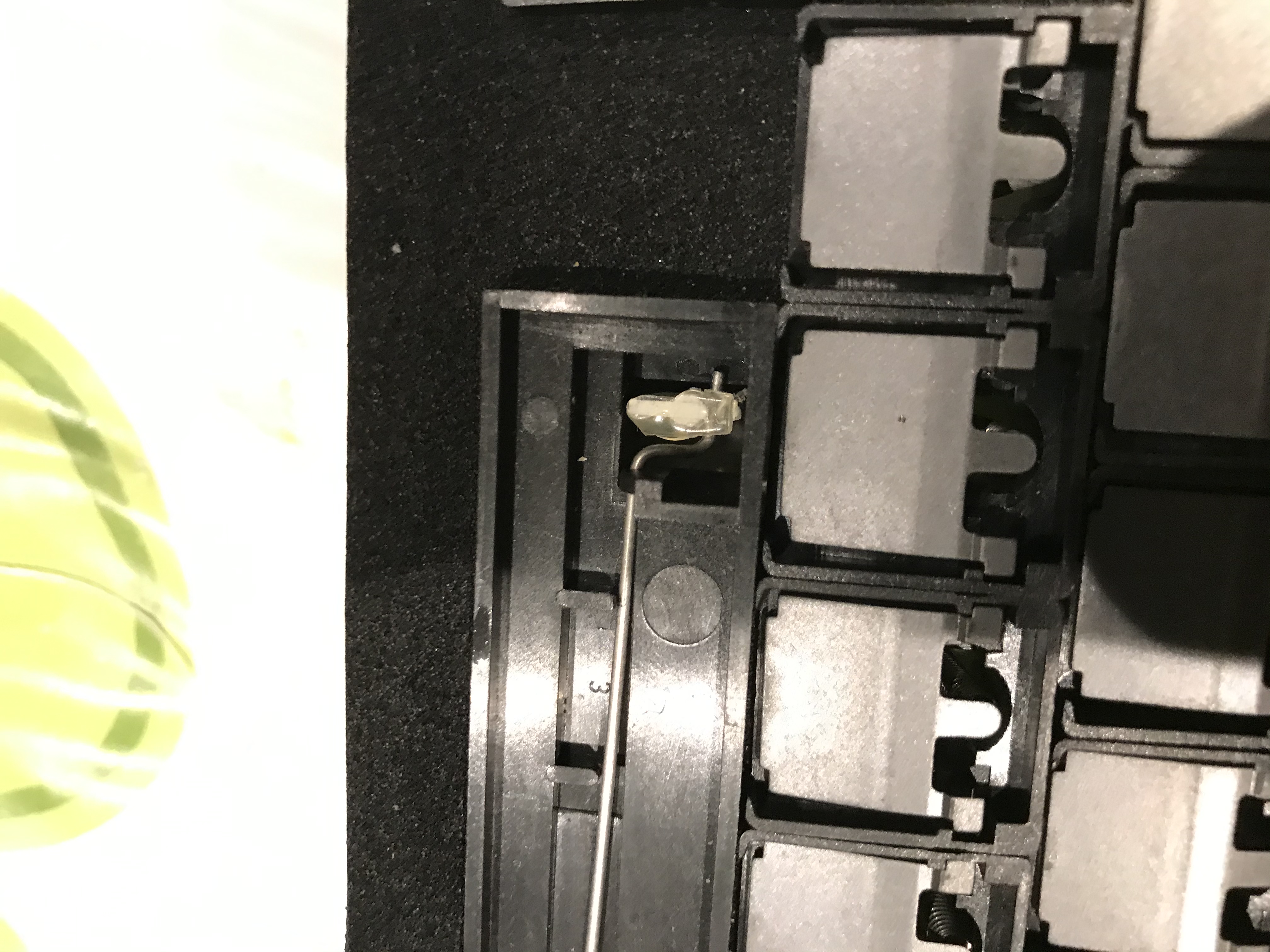

So the adventure is done. I had some fun with this one. Once the paint fully hardened I cut the foam by hand with a scalpel and an 11mm circle punch. Then I started reassembling everything. Only had to disassemble it once because the spacebar came away again because the peg had sheared off. Can you spot the new hot-glue peg? All done, nice and clean and as original as possible. You wouldn’t know I’d been inside. Please excuse the mess on my workstation. I need to tidy up.
