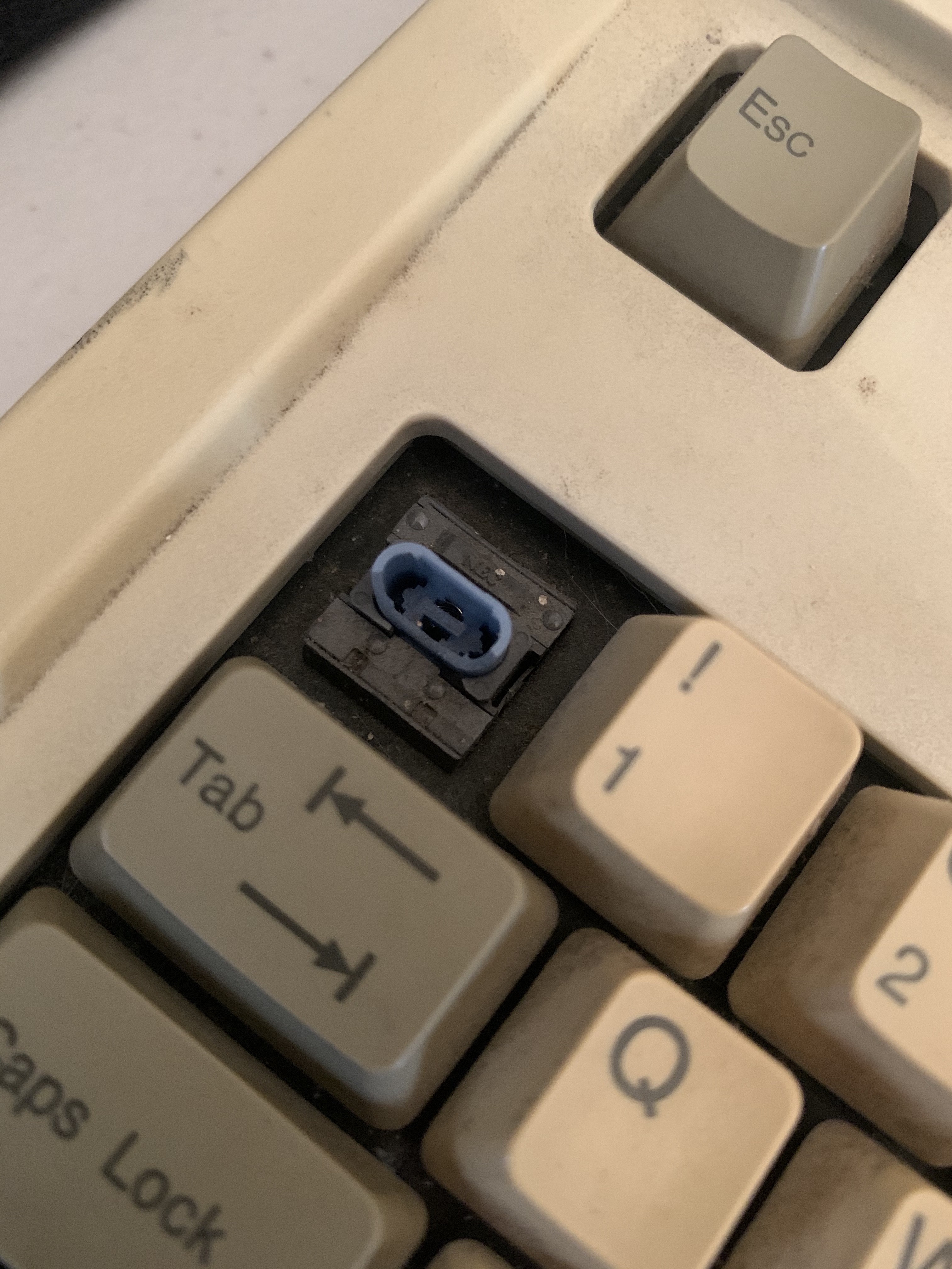

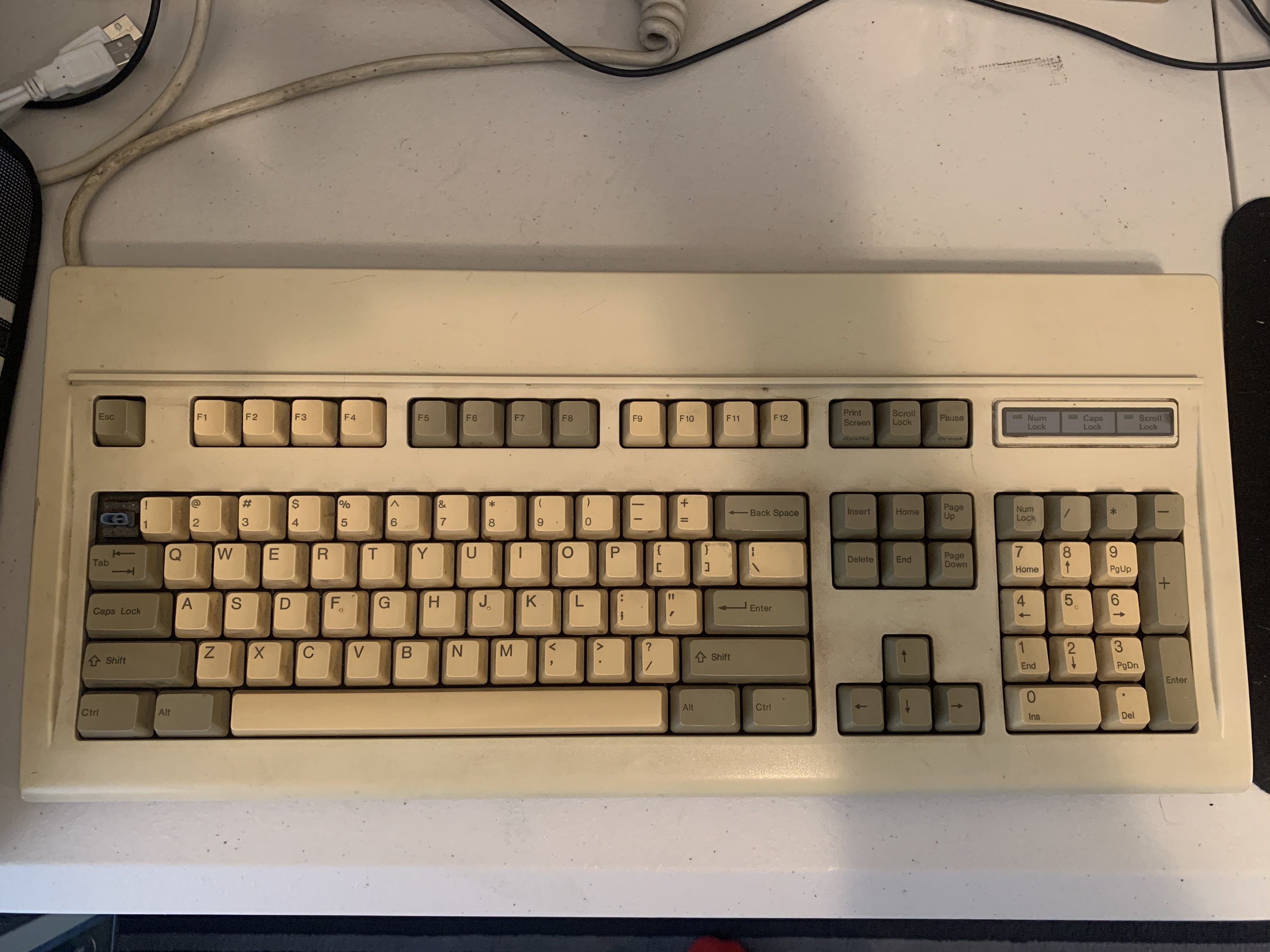

Hi All,
I've recently acquired an old NEC mechanical keyboard, it's missing the `(~) key and the key switch appears to be damaged, the rest also needs a thorough clean.
Does anyone have any idea where I can get a replacement switch and key cap? They appear to be NEC Blue ovals from my googling.
Also generally what's the best process for cleaning these? I haven't had too much experience with vintage keyboards.
Attached are some pictures of the keyboard.
Thanks!
Thanks!

I'm not so sure about cleaning, but I've a few of these with faulty switches, and have fixed a lot of these by desoldering the switches, letting the whole switch sit in isopropyl alcohol for a while and pressing them a lot while submerged. Pressing the switch a lot once you take it out seems to push most of the liquid out of them.

I still have a bunch of "average" condition blue ovals and a partial set of key caps (grey double-shot legends, not black), so you can use me as a contact, too, if you need to. I'm in the US.
I've been able to contact orihalcon mainly through ebay. He doesn't show up here that often, anymore
For removing the keycaps, you do need to do a kind of side-to-side wiggling. Chyros (Chyrosran22) has a video review of a blue oval and, IIRC, he removes at least one keycap. The video's on YouTube.
It's extremely hard to open and re-assemble these switches, so if 4_404 was able to do that, excellent! I wasn't.

Cool thanks! I haven't got a reply from him yet but I'll just wait to see what happens. I'm in Australia so shipping could be a nightmare, but I'll update here if I get a response.
@hellothere do you happen to have a ~ key cap even if its the wrong color?

I'll check.
- hellothere
- Location: Mesa, AZ USA
- Main keyboard: Lots
- Main mouse: CST2545W-RC
Yup. Right on top of the bag. Makes things a bit easy.

Ah awesome, do you have a rough idea how much it would be to ship to Australia? (and the cost of the cap + maybe a spare switch since the "oval" part is broken)
The side you lift from, is it from the left or right of the key, or from top / bottom?ollir wrote: 18 Feb 2021, 07:12The keycaps come off quite safely with a ring puller with a sort of turning motion: you only lift from one side while keeping the other side down.mrve wrote: 15 Feb 2021, 02:18Thanks! I had a look at the wiki, definitely seems tricky to avoid breaking them, hopefully it's mostly surface dirt and I don't have to take the switches apart.TNT wrote: 15 Feb 2021, 00:43 Afaik you can't just pull the caps off like on all the other boards. You have to do somewhat of a twisting motion... Maybe check the wiki on this before you proceed. Other than that I'd say just disassemble and clean like any other board. Those switches are also not easy to open up apparently.
