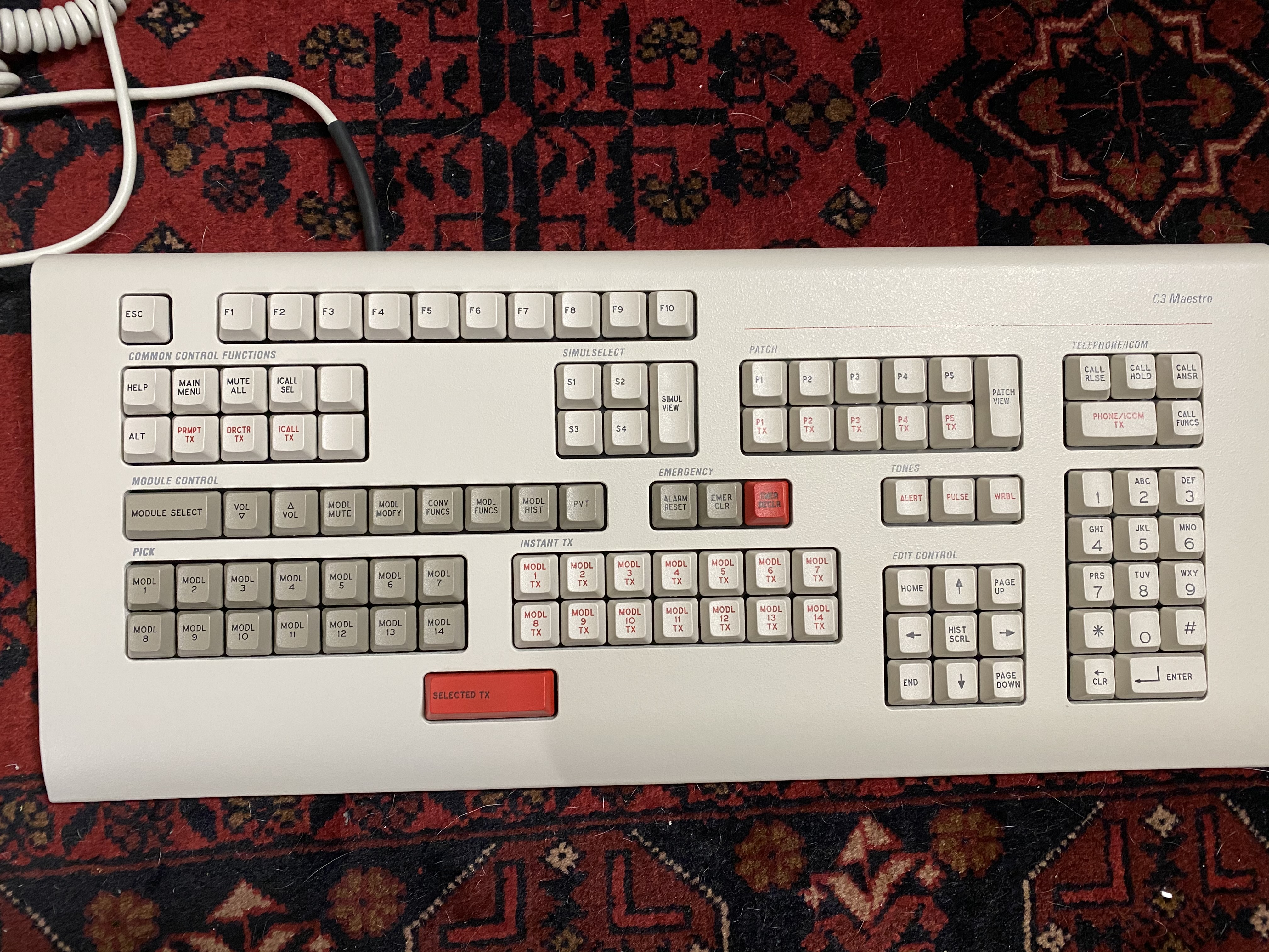

So I picked up one of those C3 Maestro 911 Operator keyboards from eBay and have taken to calling it the MACRO Macro Pad because it's freakin' HUGE. F&F switches, thick plastic top, metal bottom, double-shot caps... It's quite the looker.
The board itself complete with Tetris layout

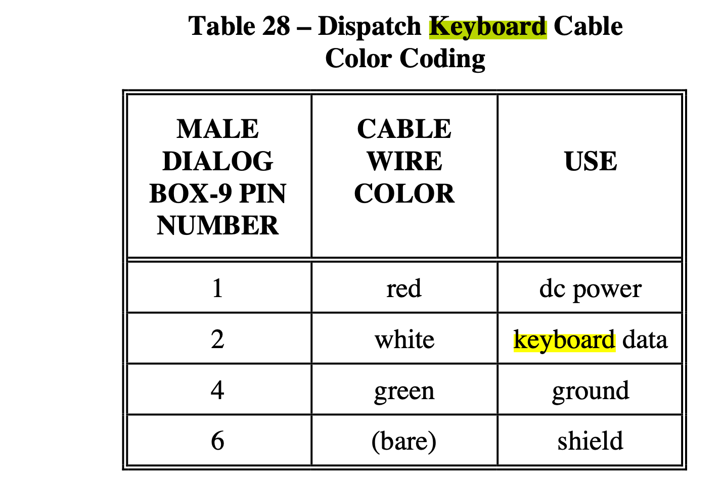

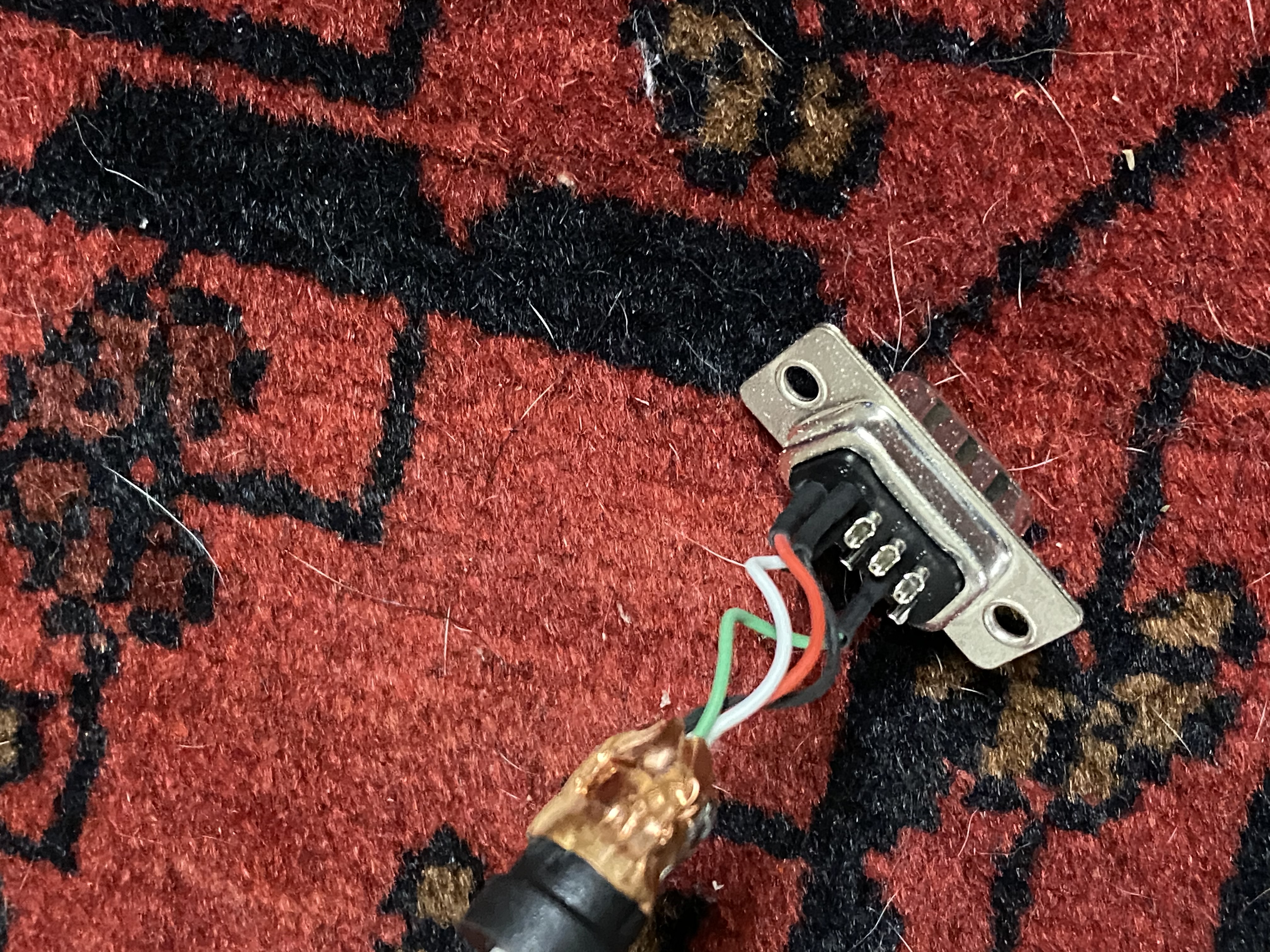

It's some kind of serial protocol, but only with a TX from the keyboard, which connected to an "Enhanced Audio Enclosure" which interfaced with a computer rather than to a computer directly. Its job seemed to be switching between audio sources and radio channels, so it appears it would be some kind of unique protocol. There's no clock and no RX.

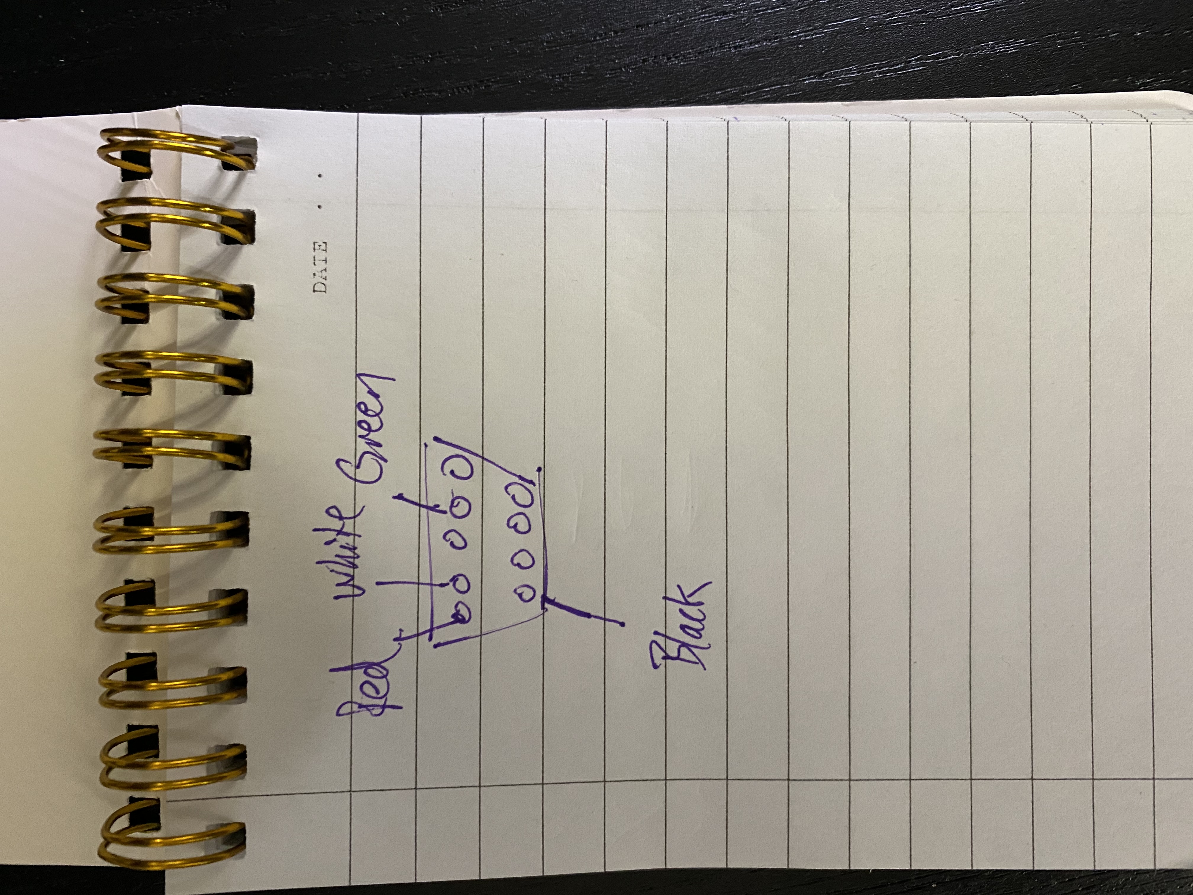

As for the cable, red is VCC, white is data, green is ground, and black is shield. In order, these are pins 1, 2, 4, and 6 on the DB9.
Screenshot of the pinout.
Good pinout.png (133.07 KiB) Viewed 8169 times
Male DB9 pinout
Male DB9 pinout
Male DB9 reverse
Male DB9 reverse

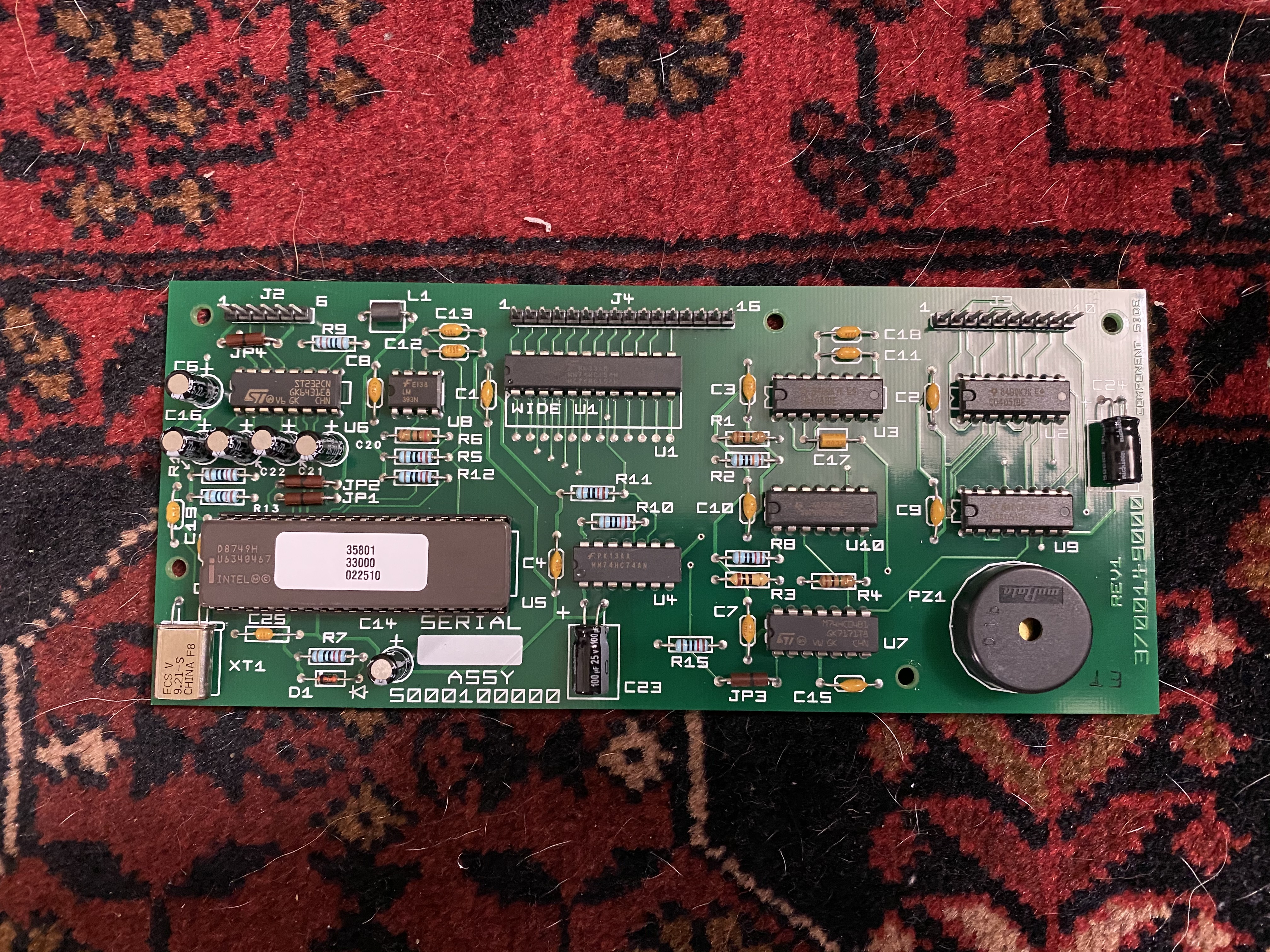

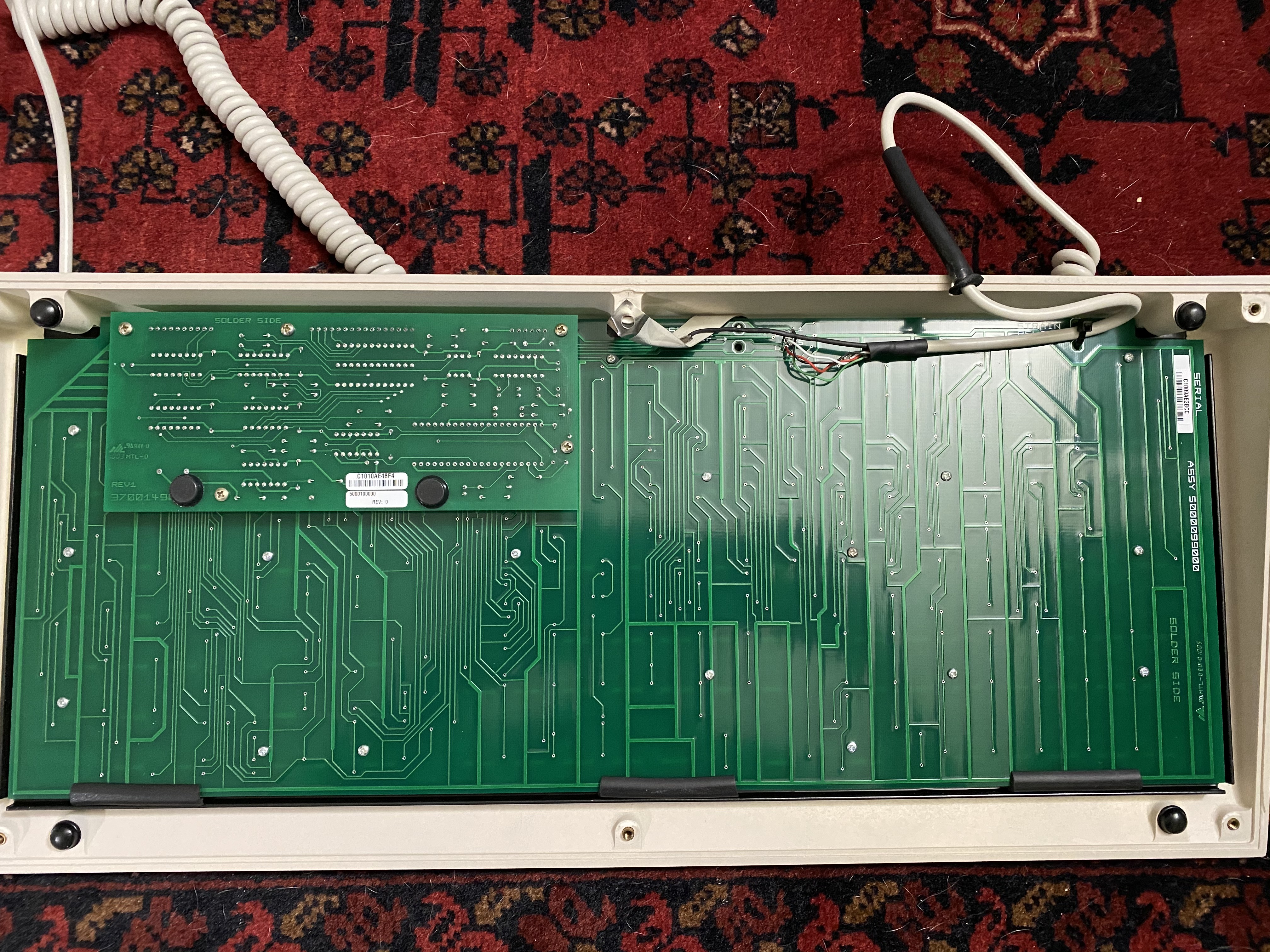

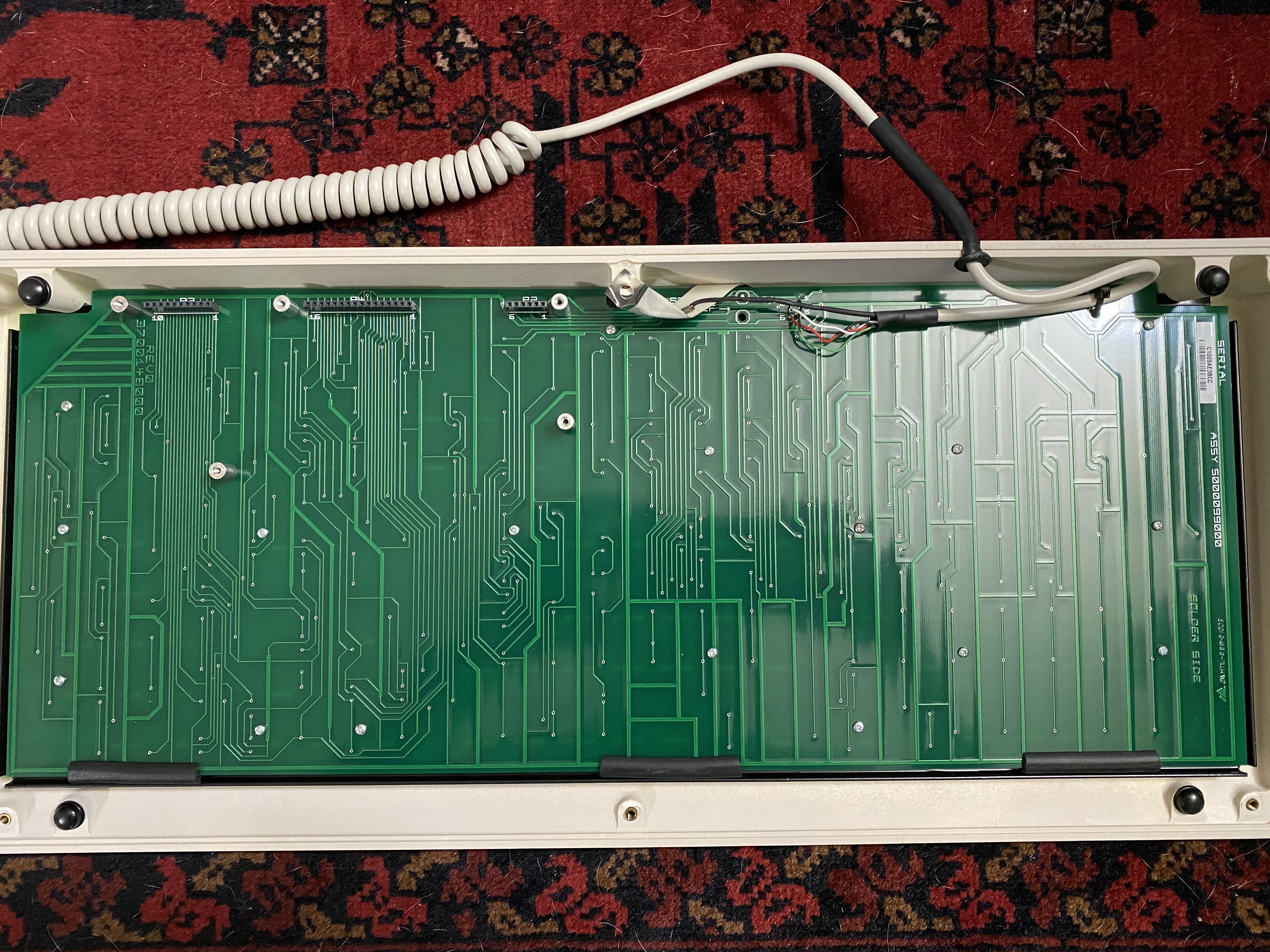

Some photos included of the PCB and controller. It would appear the keyboard uses 10 rows and 16 columns and the controller parses this into serial and sends over the cable.
PCB with controller in place
IMG_0410 copy.jpg (3.05 MiB) Viewed 8169 times
PCB with controller removed
Controller
Controller
IMG_0408 copy.jpg (3.64 MiB) Viewed 8169 times
I've tried a simple Pro Micro with several of the TMK serial converter builds just in case they might work, but no joy. However, when powered the piezo works when keys are pressed and delivers a delightful clicking sound.
Any suggestions for how to get the MACRO Macro Pad working? Is there anything in the photos that might suggest a starting point for firmware? Should I rip out the controller, get a Teensy++, and try to implement a matrix directly from the PCB pins even though it's capacitive? I don't expect to be spoon fed and am happy to read things- I just don't know where to begin. I'm also happy to add anything that would be useful about this board to the wiki!

MMcM
05 Mar 2021, 07:57
Are you comfortable writing an Arduino sketch for your Pro Micro? It's still possible that it really is just plain-old TTY-level RS-232 serial. Connect the data line to RX. In setup, open Serial1 at some baud rate (1200 is a good first guess). In the loop, check available and print any character that comes in to console Serial.
If that doesn't seem to get anywhere, just loop doing digitalRead on the one pin and printing whenever it changes. These protocols were slow enough that you might be able to guess what's going on, even without a logic analyzer or oscilloscope. Like, how many times does the bit flip for which characters?

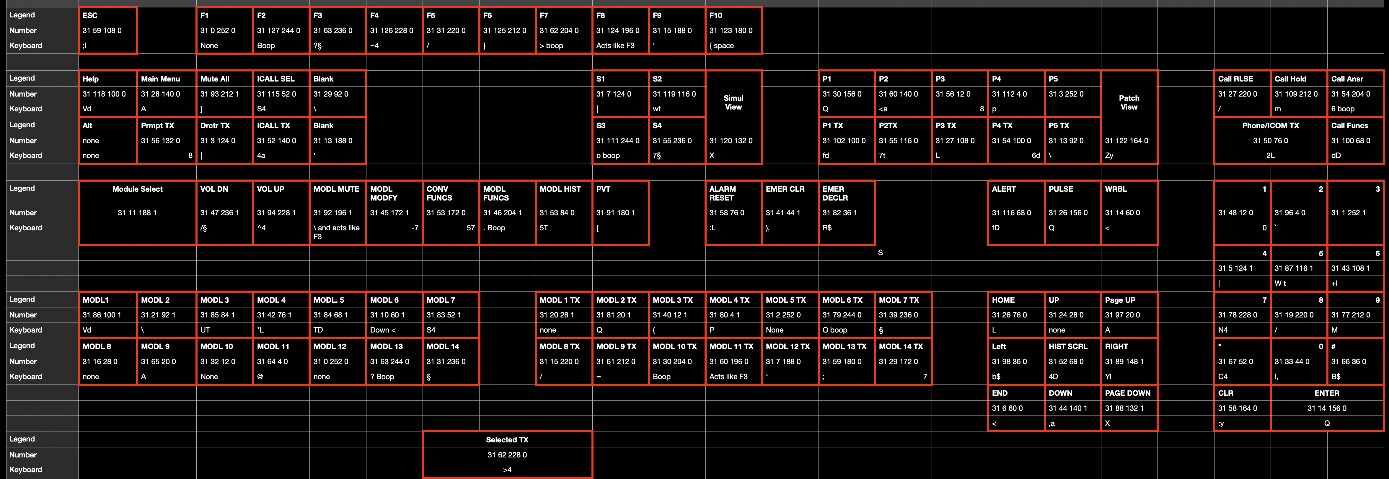

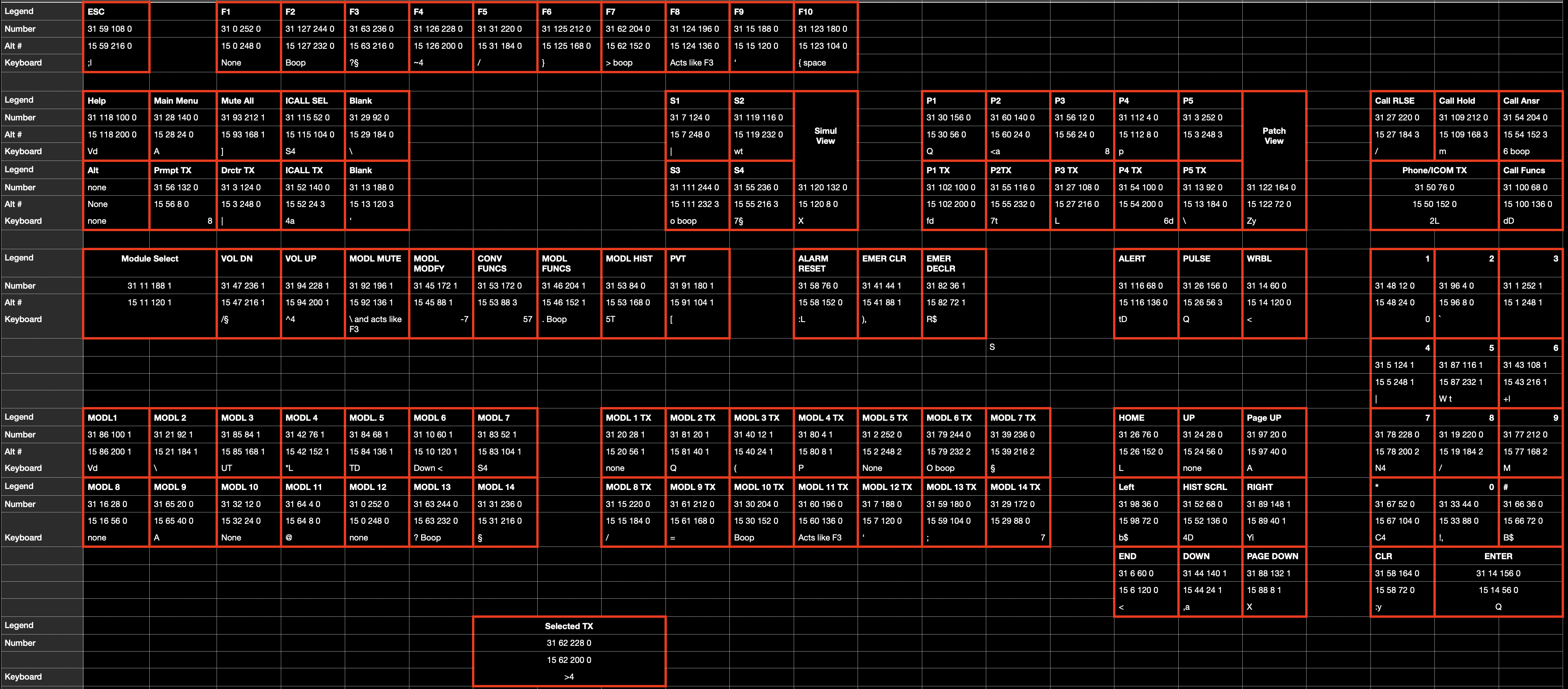

MMcM's idea yielded some great results. I found a couple of sketches having to do with reading serial from the Pro Micro's serial ports and loaded them up.
This sketch below was used to generate the "Number" section of the image below. Each key, with the exception of Alt, yields 4 numbers: two when pressed and two when released.

This sketch below was used to generate the "Keyboard" section of the image below and causes the Pro Micro to translate the serial input into keyboard output and type it wherever the cursor currently is. Each key, with the exception of Alt, yields one or two characters. Some yield a "boop" in that they cause my Mac to go boop.
What it do.png (1.14 MiB) Viewed 8057 times
It's clear that the keyboard is sending two ASCII values when pressed and two when released. For example, ESC when pressed generates 31 59, which an ASCII table says is "Unit Separator" and "Semicolon", then 108 and 0 when released, which is "Small l" and "Null". When the keyboard sketch is running, ESC yields ; upon press and l on release. Some of the keys end with 1 "Start of Header" instead of 0 when released.
What it do with Alt.png (1.5 MiB) Viewed 7868 times
Added codes for each key when holding Alt. The start code is 15 for all keys and the down code is the same as it is without Alt for all keys. Stop code 0 or 1 stayed the same for many keys, but some saw it change to 2 or 3. In some places Alt seems almost like a halving or doubling operation, except when it doesn't. I'm wondering if either the folks who built this just did it willy-nilly or if we're missing something that would make more sense.
First, there's MODL12 and F1, which have identical codes for default and Alt operation. Then there's the fact that the start code for Alt keys is 15, which is not quite half of 31. The Alt up code is a double of the default up code like on ESC (108, 216) and ICALL SEL (52, 104) except when it isn't, like on F2 (244, 232) or F6 (212, 168). Numpad 9 has default stop code 0 and Alt stop code 2.
Scratching my head...

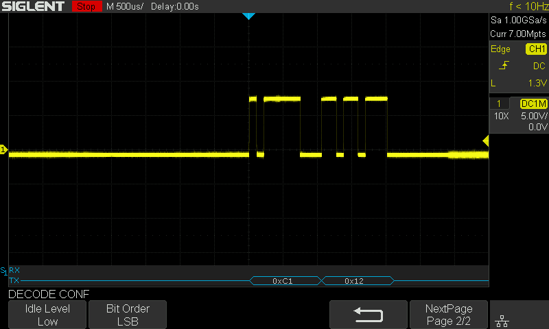

Okay. I believe I know what is going on here.
It is indeed 9600 baud and there are indeed two codes for each key press / release. But it is reverse polarity from what the microcontroller expects, that is, idle low rather than idle high.
Normal key down is C1 and normal key up is C0. ALT is E1 and E0.
This makes the codes look rather more uniform.

What this means in terms of writing a converter is that you either need to add an inverter or switch to a microcontroller that supports inverted serial. The Teensy 3.2 is the only one that both does this and tolerates 5V TTL levels. In Teensyduino, do
  Serial1.begin(9600, SERIAL_8N1_RXINV_TXINV);
micmil
04 Apr 2021, 06:32
That kind of makes sense. Since this thing was designed to plug into an audio routing system that might create a lower noise floor. Absolutely never would have thought of that.
Just another check in the "I need an oscilloscope" box. Great work!

There is no serial output to worry about. All serial input is two bytes, with four possible prefix bytes. You could have a state machine, but it's so simple that just remembering the prefix byte (with some special value like 0 or FF meaning don't have yet) between invocations is probably simpler. When you get the second byte, shift and mask it into a row and column. Turn on or off the column's bit in the row based on whether it's a key press or key release prefix. If it's one of the ALT prefixes, also update the bit chosen for the ALT key.
