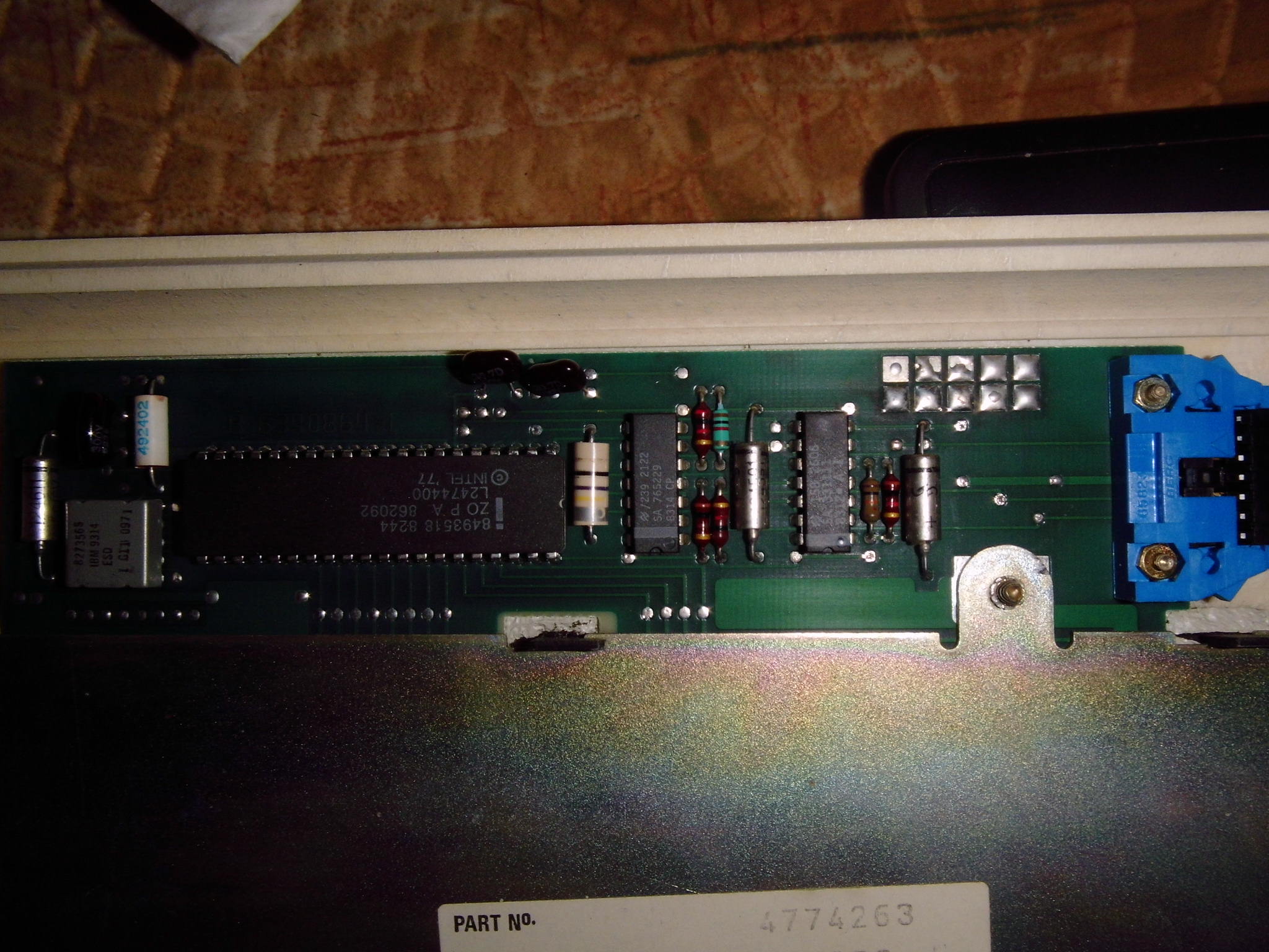

What I want to try now, is to check all resistors (TODO) and swap out all the capacitors in case one of them got out of its original specs. According to my research, my controller has the following capacitors:
  1. 2x"124611", 56pF/6V, Electrolyte (not sure, but it's axial mounted)
  2. 1x"124501", 22pF/15V, Electrolyte (sot sure, but it's axial mounted)
  3. 1x84pF +/-20% 25V (This is a color-coded axial-mounted component and I'm not even 100% sure it is a capacitor. You can see it right next to the MCU in the photo.)
  4. 1x50pF +/-2% 300V, Mica, CORNELL DUBILIER
  5. 2x200µF +/-0.5%, 100V, Mica, CORNELL DUBILIER
It's easy enough to find cheap ceramic caps to replace a) and b) - although I don't know anything about the original caps' tolerance. I can't find any 84pF capacitors, so I'm not even sure I read (c) correctly. There is also a white axial-mounted component "492402" which might be a capacitor, but if so, I have no idea how to identify its specs.
I can also find 500V +/-1% Micas for d). I guess that the tolerance can actually be below the original component's tolerance.
But for the 200µF Micas (e), I really cannot find any replacement whatsoever. At least not with such a low tolerance.
Do you have any thoughts on this? Perhaps, there is something else I could try to do. Perhaps it makes sense to attach the converter internally in order to avoid the cable length.
