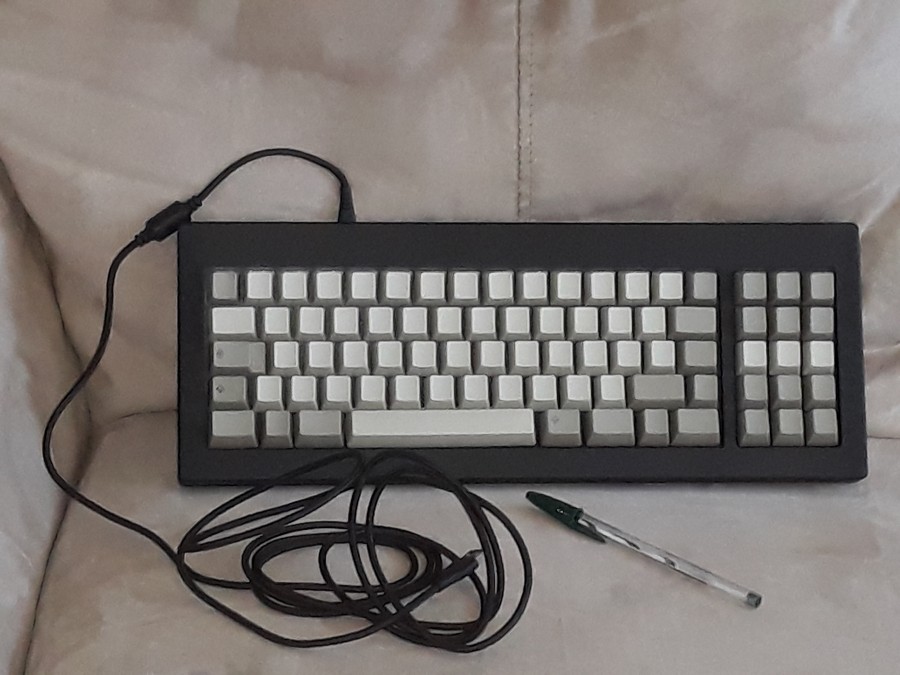

F77 keyboard and green pen.

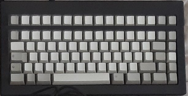

  • Since this was the aluminium, instead of zinc, case, I expected the keyboard to be light-ish. IT IS NOT! This keyboard weighs quite a bit, and that's an immediate reminder that this is a quality item and not some cheap-ass plastic unit or some "kustom" that artificially adds a weight to try to elevate itself to a higher category.
  • The black case looks great and is quite, quite classy.
  • The blank keycaps look just plain perfect.
  • Once I installed (correctly — more on this below) the keycaps, I started typing right away. The keyfeel is the perfect F feel; heck, it feels even better than my old, beaten-up F122 (which does need some new foam). The sound... I just love it. It pings, it sings... this IS a true Model F keyboard.

F77 keyboard, ready for business.
The work of a craftsman (just say yes).
This is temporary, okay? I intend to custom-order a deskmat for the exact size of the keyboard (I seriously dislike those gigantic 900×400 mm² things... and they don't fit in this table).

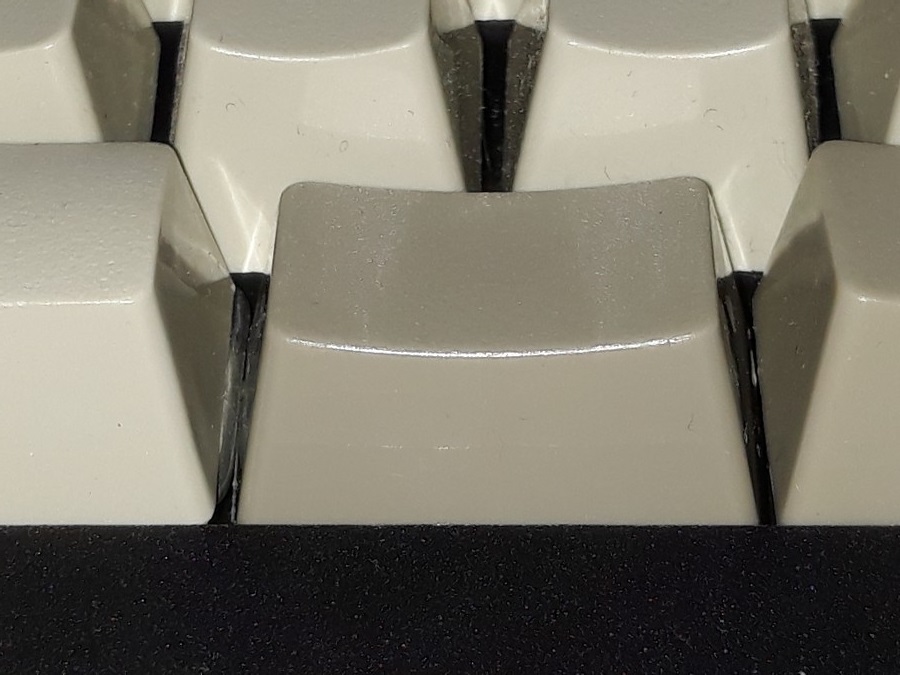

Not everything was well and god, though. The eagle-eyed among you will have already noticed a 1.25U keycap between the space bar and RALT. I had asked Ellipse to split every splittable key, up to and including splitting the 7U space bar into a 5.5U bar and a 1.5U key. I first placed a 1.5U key there, but whenever I pressed it, it would get stuck in the down position. This happened with all of Ellipse's 1.5U keycaps, and with OG IBM caps as well.
Stuck keycap.
Stuck keycap.
As it turned out, the problem is the space bar's wire, which is sliiiiiightly wider than expected and protrudes a bit. Pressing down the key gives the keycap enough force pass the wire aside on its way down, but the release back up lacks that force and the wire impedes the return. I'll note that this does not occur on the left side — LALT goes down and back up without issue.
I tried to fix this issue by nudging the wire a bit to the left, but it didn't help much. I suppose that this is a matter of specs tolerance, and I'd rather not open the keyboard for further inspection (I'll probably screw things up) — instead, I'm working around this with a 1.25U keycap (for now; I'll later get a 1.5U keycap, file it a bit on the bottom left side, and use that instead).

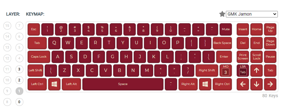

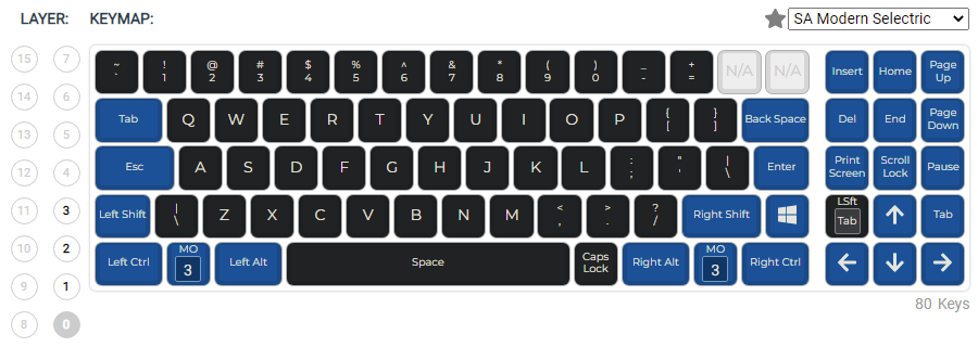

So, logical layouts?
This what I currently have, using QMK Configurator. I might make further changes later on.
my_F77_json.zip
JSON file for my F77.
(772 Bytes) Downloaded 232 times
Logical layout, layer 0.

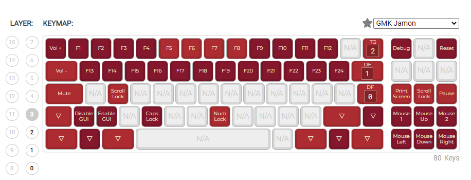

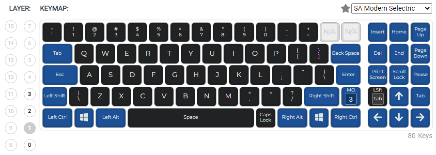

Layer 0 is the most basic layer. Defines the entire alpha block and the pad as a nav cluster. Note both Fn keys placed between Ctrl and Alt, with LGUI (the Windows key) shoved off to a side, but still available for those few times when it's actually needed.

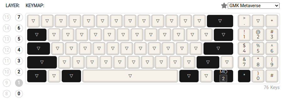

Logical layout, layer 1.
Layer 1 is identical to layer 0, except both Fn keys are now LGUI and RGUI. Fn is moved to the 1U key to the right of right Shift. This setup is a good fit when using this keyboard on a Macintosh, where GUI is equated to Command.

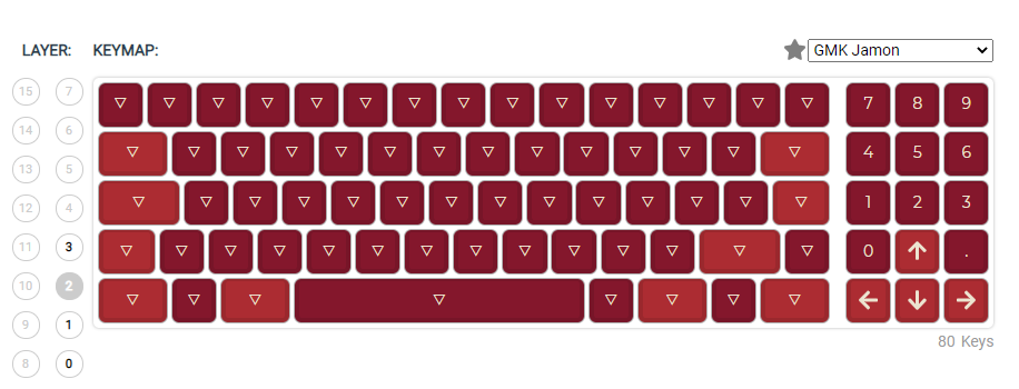

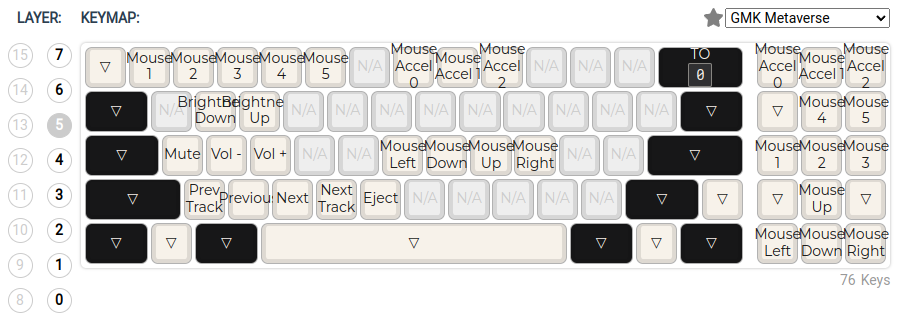

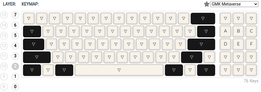

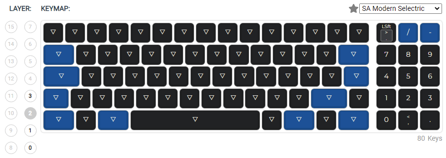

Logical layout, layer 2.
This layer maps the pad as a numpad. Fn+(top right key) in layer 0 and layer 1 toggle this layer on and off. The way this is set up, the numpad works without issue whether the default layer is 0 or 1.

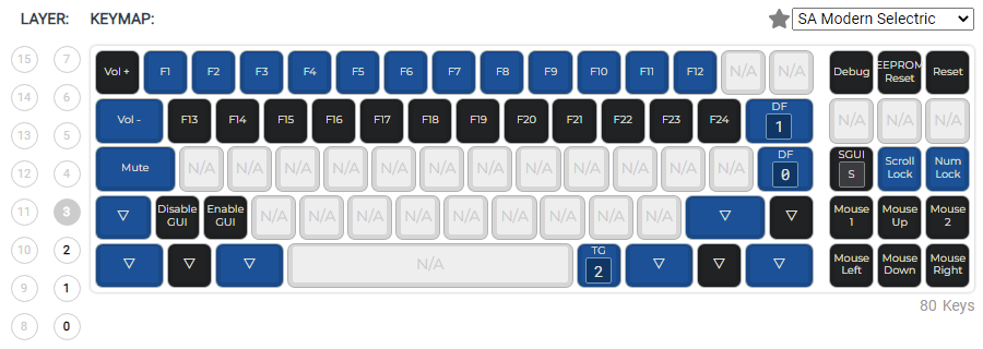

Logical layout, layer 3.
This is the "Fn layer" proper. The F keys, volume control and a few other things are defined here. Note how Fn+Enter activates layer 0 as the default and Fn+Backspace does the same with Layer 1.

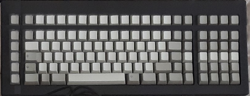

I know perfectly well that the goal of Ellipse's project was to faithfully reproduce the F62 and F77 keyboards of old, and that we have several additional features added on top (a compact case, extra possibilities for the physical layout, QMK programmability, etc.), but...
... it still rushes into the problems and limitations that lacking a sixth key row implies. And boy, those keyboards would be EVEN better if they had it.
I understand that widening the curved inner plate is easier said than done, but then... it doesn't have to be 7U long (a simple separation of 0.25U, as modern compact keyboards to, should be enough). I can't help but wonder how big of a jump would be to go from an F77 to any six-row form factor, which doesn't have to be a TKL or a full-size — how about a 75% or a 96%, form factors that IBM never actually built? Something like this (please excuse my mad Paint™ skillz):
Hypothetical 75%.
Hypothetical 75%.
Hypothetical 96%.
Hypothetical 96%.
I would be the first in line if those were to be announced. Meanwhile, I'll continue to enjoy typing in my F77. :D

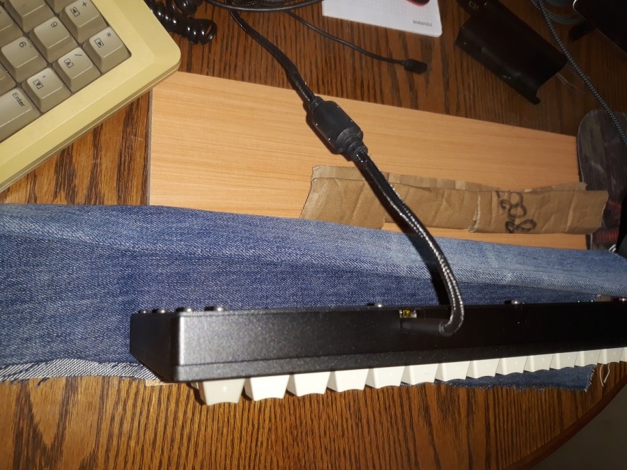

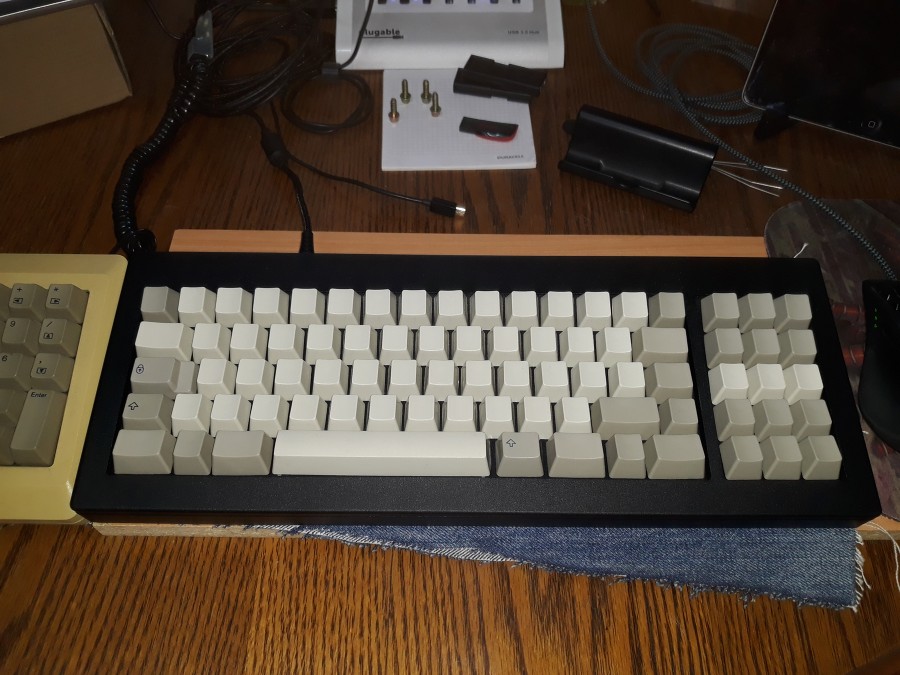

Meanwhile, the F77 continues in active usage.
I'll post a GOOD picture of the keyboard later. For now, a photato of the current messy environment, F77 included, should suffice:
What a mess.
What a mess.

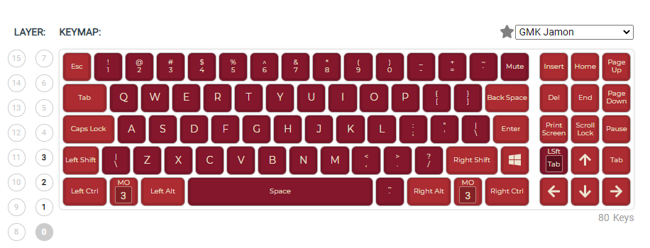

21 Jun 2022, 17:16

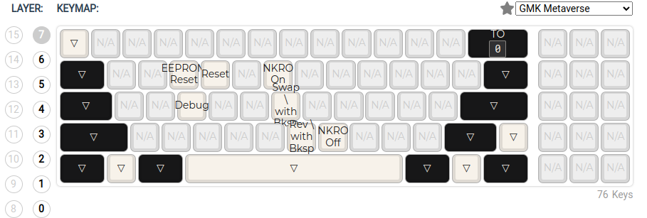

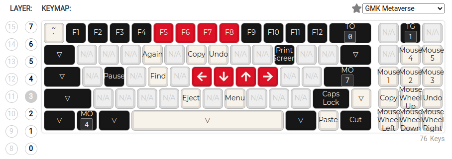

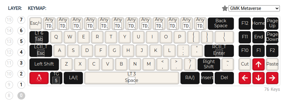

So this morning I updated my F77's layout yet again — this is how it's going now.
Layer 0 (base layer).
Base layer: all alphas in the correct positions; Esc has been moved to Caps Lock, and Caps Lock is in the 1.5U key between the space bar and AltGr. Fn keys between each Ctrl and Alt key pair, The Windows (LGUI) key to the right of the split right Shift. The nav cluster has suffered no changes.
Note the two entirely unused keys above the 1.5U Backspace. If I weren't a clumsy coward, I'd have opened the keyboard and replaced a couple flippers with stabilizers and placed back a 2.0U Backspace key and the ISO Enter key.
OTOH... this gives me space for other experiments. I'm tempted to try marcusos's idea of placing COPY and PASTE there.
Layer 1 (GUI and Fn keys swapped back, for MacOS).
Layer one: identical to the base layer, but swaps the Fn and GUI keys (the latter work as the "Command" ⌘ keys on Macintosh). This works nicely, as the reduced necessity of the Fn layer when the keyboard is plugged to a Macintosh makes it feasible to have just one Fn key.
Layer 2 (date-time numpad).
A newly cooked-up version of the small numpad — instead of arrows and numbers and nothing else, let's try numbers and the signs needed for writing dates and times; the bottom row places a comma in the middle key; in the top row, Shift-., which in my national layout (and most European layouts) produces the colon sign.
Layer 3 (Fn).
Layer 3 (Fn).
The Fn layer per se: volume controls in the leftmost column; F1..F12 in the first row, F13..F24 (because I want them available — I'm that whimsical) in the second row; the not really useful but always desirable option to disable and enable back the Win key in a quiet, out of the way area.
Fn-Enter selects the base layer; Fn-Backspace selects the MacOs layer; Fn-Caps Lock toggles on and off the numpad layer. They way I've set this up, things work transparently and as expected (it remains to be seen wether this numpad design is any good, but that's a different issue).
Fn-Scroll Lock produces Scroll Lock. Why? To be able to access it even if the numpad layer is active. Fn-Pause produces the TRUE Num Lock (because it needs to be accessible).

BuGless
21 Jun 2022, 22:47
Optimising the keyboard mapping turns out to be an art by itself (and still a work in progress). FWIW, here's my current take on it.
BTW, I love your idea about the homing marker on the normal 6/^. Due to lack of keys with a marker (at the moment) I have now opted to the use the keypad-5 (yes, not a perfect fit, I admit) in the position of the 6. It works, because I rarely look at the keyboard anyway.
These layers are vi-friendly.
Base layer (0)
Base layer (0)
  • Esc/~ (Escape when pressed, ~ when pressed with shift). It covers muscle-memory high-escapes, and it also covers typing muscle-memory tildes. Backquotes I need rarely, so they can be obtained either directly below the enter key, or using the function layer (3).
  • The top row keys are all configured to produce a non-repeating Fxx function key if held down for longer than 300ms. I.e. tapping them gives the regular key (numbers 0 to 9 and - and =), holding them results in the corresponding function key (using the QMK tapdance feature).
  • Direct access to Insert/Delete/Home/End/PageUp/PageDown and F1, F2, F10, F11 and F12.
  • Function key is on space-bar hold, it turns on Function layer 3 (for the duration of the hold). Autorepeat space is double-tap-hold.
  • Tab also turns on Mousewheel layer 6. Autorepeat tab is double-tap-hold.
  • The Caps-Lock position is used for the Escape key as well as the Control key on hold.
  • Alt-left produces a ( paren on tap, Alt-right produces a ) paren on tap; on hold they function as regular Alt keys.
  • Enter functions as Control on hold (for symmetry).
  • Left to Alt-left we have a toggle to turn on/off the mouse-movement/media layer.
Numeric keypad overlay layer (1)
  • Reached through the simulated numlock from the Function layer 3.
  • ATM/Phone style, because I use those more often.
  • Below the Right-shift, there is a layer activation key for the hex-overlay layer (2).
  • This layer is indifferent to the state of the real Numlock key (as are all of these layers).
Hex overlay layer (2)
  • Reached through the layer shift key on the numeric keypad layer.
Function layer (3)
Function layer (3)
  • Reached via space-hold on the base layer.
  • The tilde/backquote, just in case.
  • Pause on S and Printscreen on P.
  • Caps-Lock on right-shift, in case some clown pressed it.
  • Cursor keys on the vi-navigation row.
  • Scrollwheel using the cursor keys.
  • Left to Alt-left activates the extended-movement layer while held (intended for alternate functions without moving the fingers of your right hand).
  • Reset-to-default layer 0 on backspace.
  • Simulated numlock toggle with the numeric-keypad layer 1.
  • Enter is the layer-jump to the keyboard-system-layer 7.

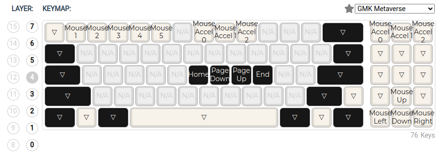

Extended movement layer (4)
  • Reached via left to Alt-left from the function layer.
  • Provides alternate functions on the vi-movement-keys and the cursor keys.
Mouse movement/media layer (5)
  • Reached through the left to Alt-left toggle key on the base layer.

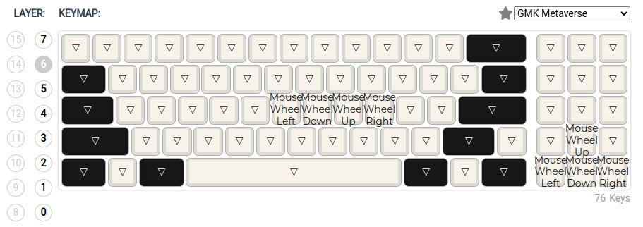

Mousewheel overlay layer (6)
  • Reached through Tab-hold from the base layer.
  • Mousewheel keys on the vi-movement keys and the cursor keys.
Keyboard system layer (7)
  • Reached through Enter-hold from the Function layer.

21 Jun 2022, 23:26
BuGless wrote: 21 Jun 2022, 22:47 Optimising the keyboard mapping turns out to be an art by itself (and still a work in progress). FWIW, here's my current take on it.
In the the F77 keycap set, all keys are blanks, so I'm technically using the (blank) keypad-5 homing key, too.
For the XXK, back when I made the custom order at Unicomp, I needed two homing keys, but I figured it wouldn't hurt to get one more, just in case... which has now come in rather handy.
