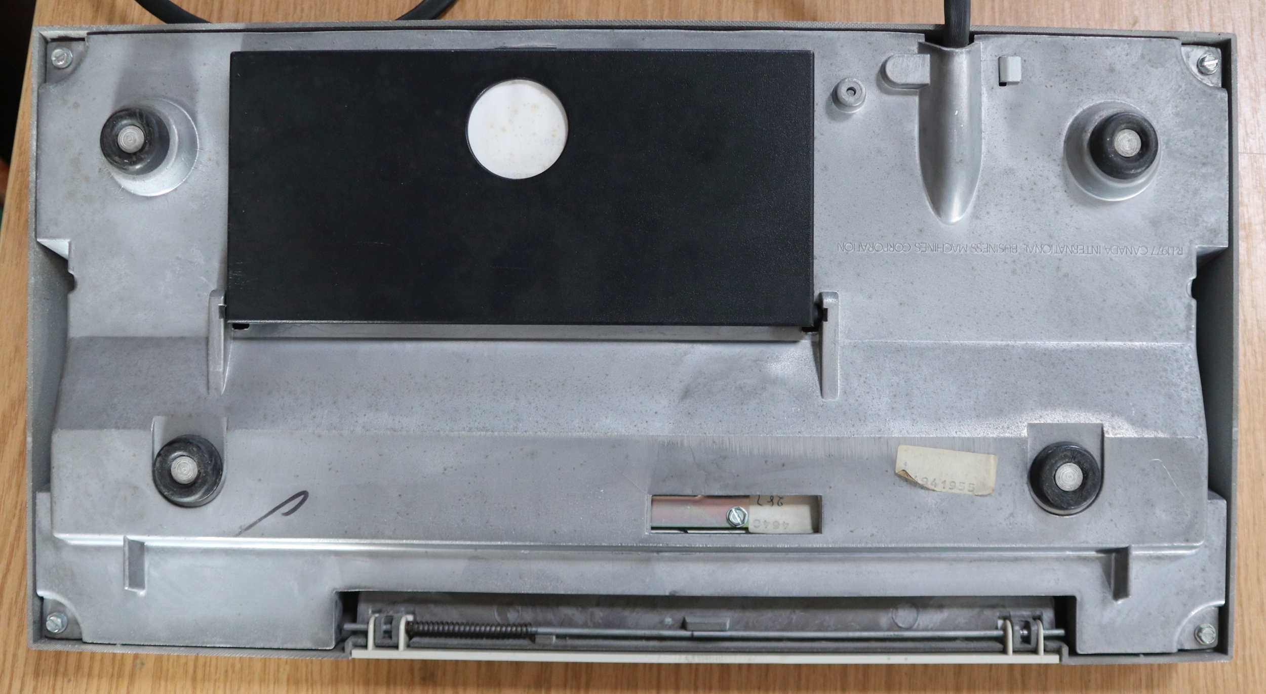

Here are a few pictures of the board:
1) Tools:
What tools should I get for the restauration job? Obviously basic things like a good keycap puller, maybe an ultrasonic cleaner? Recommendations would be great, as I have a high budget for the build :)
2) Good things to know before disassembling:
What are things I should be cautious about? - Keycaps, case etc. I've heard that the keycaps are very hard to take off - I think I have to do a back- and forwards motion while pulling right? If there's something I should be careful about please tell me :D
3) What even needs to be restored:
I've seen a lot of people cleaning the membrane with some special chemicals or even cleaning each individual switch. Is this necessary or just something nice to do? Obviously properly removing the contamination shield will be one of the first things I will have to tackle. Also I will have to make a fitting foam for the keyboard - any experience what foam (height etc.) works best?
4) Overall cleaning:
Should I just wash the keycaps as well as the case in soapy water or do I have to use something more special for that so that it doesn't rust in the future?
5) Converting the keyboard:
I live in the EU and it would be amazing to be able to use the beamspring as an actual daily driver. I would love to convert it to usb + be able to use the solenoid, is there a converter in stock for that that ships to my location :)?
Thanks in advance! I really want to give this beauty the makeover she deserves.

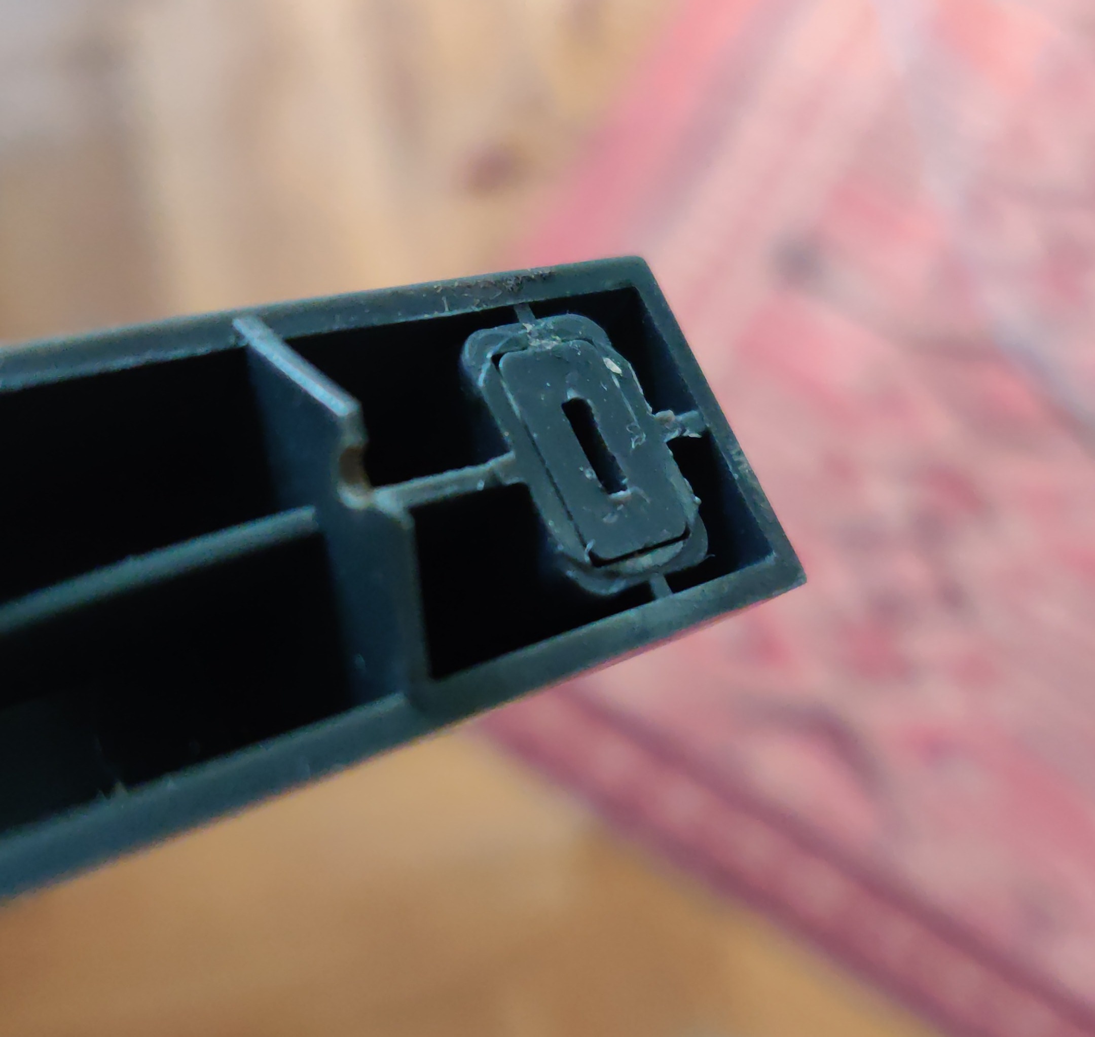

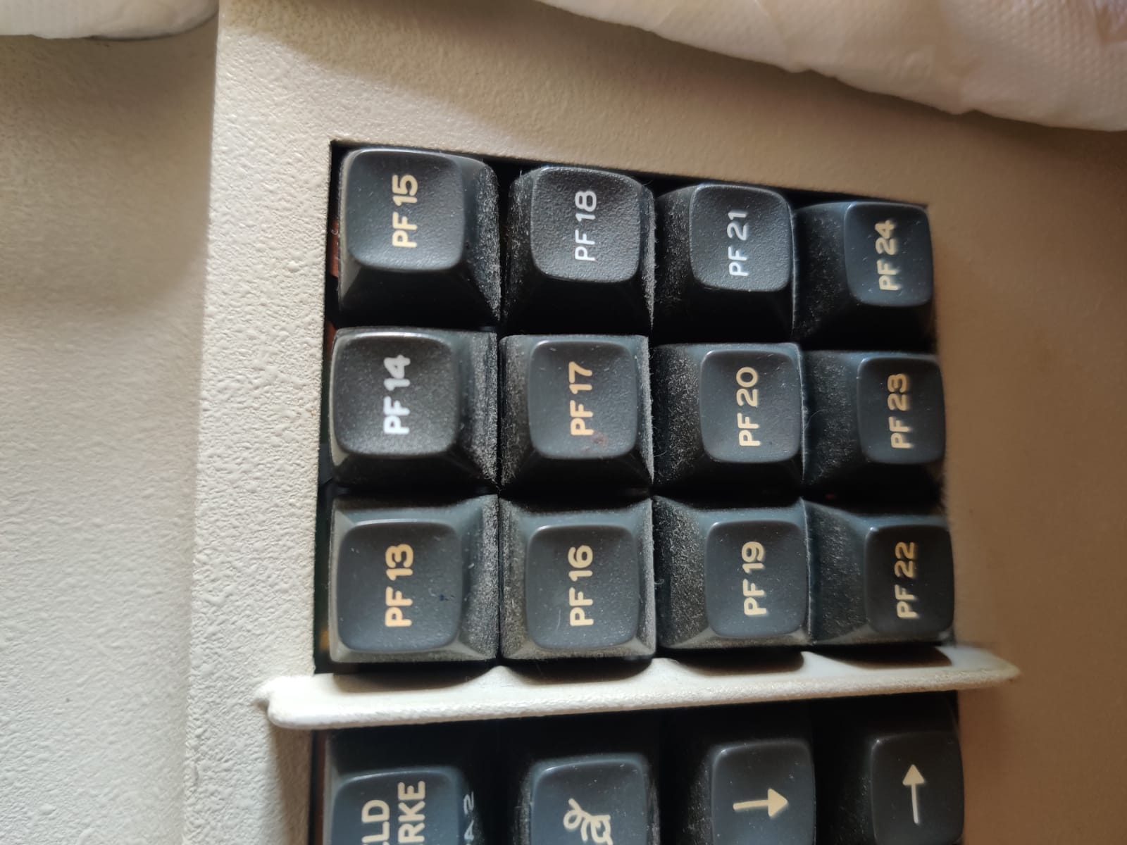

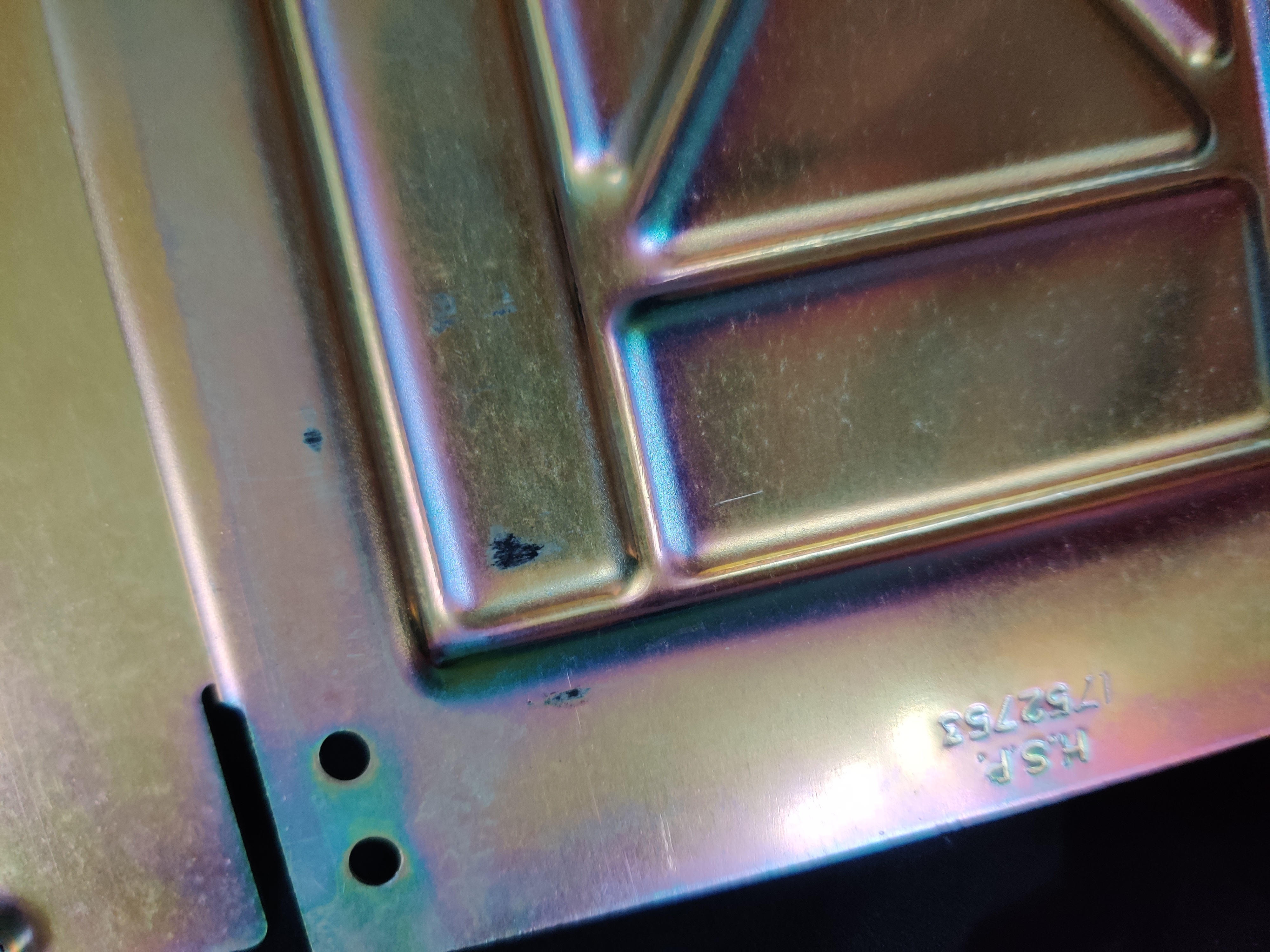

I think I won't do too much for now. There is a little bit of rust inside the case which I'm going to remove as well as an overall clean of keycaps and case.
I'm slightly worried that I will ruin the keycaps when cleaning them - as you can see the PF14 key is kinda weird and I don't want that to happen to other keys when I clean them, so maybe should I just use warm water as they aren't too dirty?
For the rust, I'm just going to use some sort of rust remover. And I don't know yet if I will replace the foam, maybe that will have to wait a bit.

12 Apr 2021, 10:27
My strategy with caps is always hand wash them like they're dishes / cutlery. (Unless they're NIB obviously. :D ) Gentle soaping, gentle rubbing, never seems to do any harm to front legends when I do it. Then let them dry naturally on kitchen towel for a good long time till they're bone dry before they go back on the keyboard.
As the key feel is fine, then I suggest you go straight for a replacement controller and get this beast back into the land of the living! :lol:
Lalaland124
12 Apr 2021, 10:33
Thanks, then I will try to ''do the dishes'' ;) Did you replace the foam on yours or didn't the key wobble bother you?

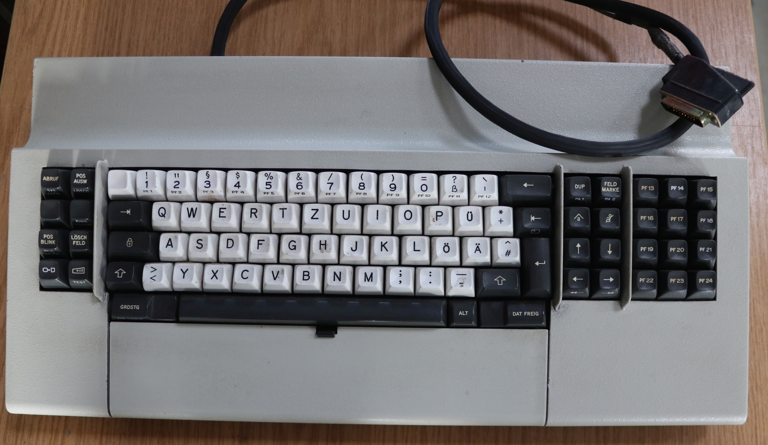

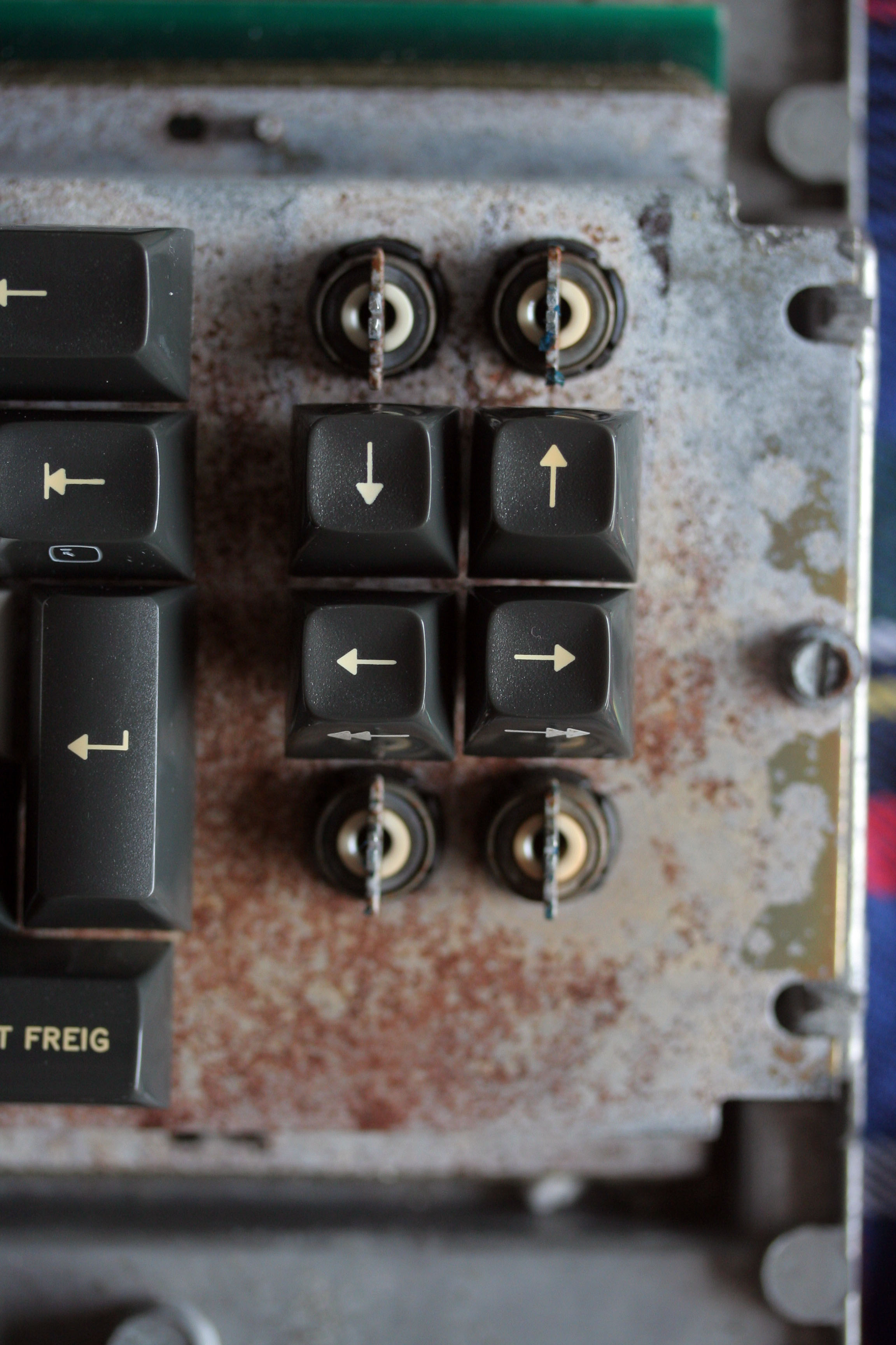

I've had two 3276s through my hands. The first I bought was a German model from the Dresden rustmaster. It had… corrosive character! One of my pics made it to the final round of the DTAs here, but the original thread itself and the pictures are lost to bitrot.
viewtopic.php?f=84&t=9312

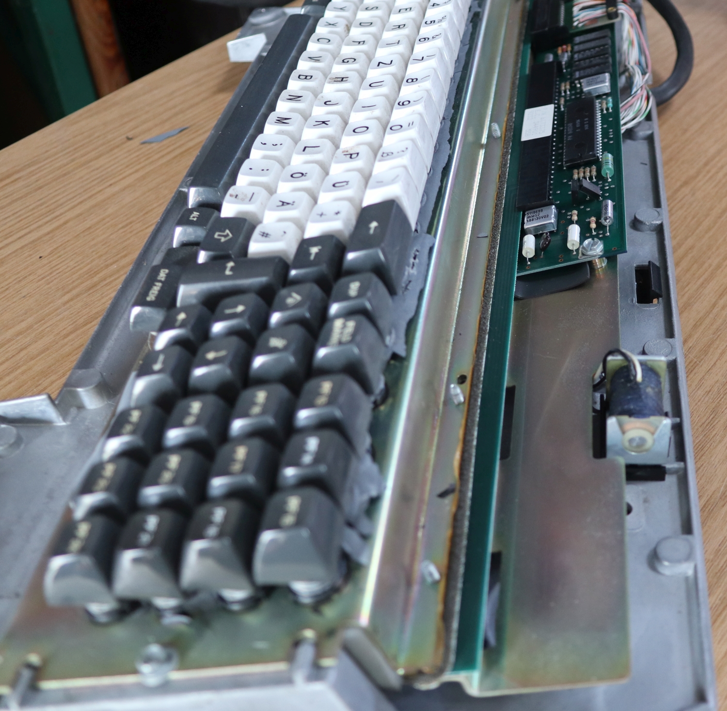

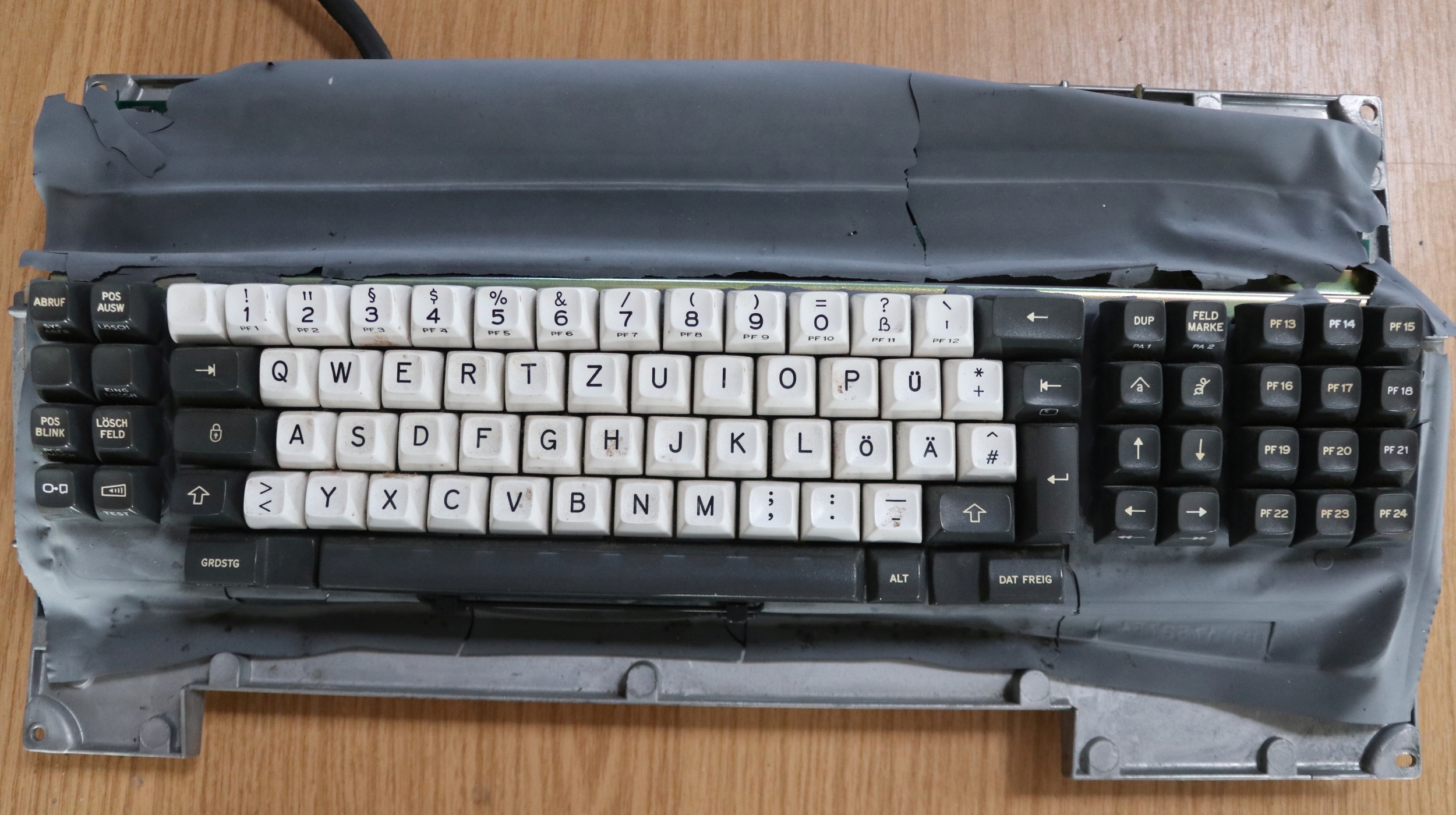

That 3276 was quite wobbly. I went inside to restore it, and didn't much like all the mess! The foam was rotted, of course, but also most (but not all) of the metal surfaces. Beamspring switches come out as complete modules, however they're open at the bottom, and the exposed mechanism is two different flexible metal pieces which have to mated just-so. The fly plate is suspended by just two points of contact, recessed deep inside the shell. Putting them back in is real fiddly, and you have to do it a lot…
Imagine theses guys caked with rust and grime from other bits above them—fortunately the switch innards themselves remained good, once brushed off—and you'll understand where my reluctance comes from! Once I scored my second thanks to Cindy, I sold my German model to Seebart for a price about a tenth they go for now. :roll:
My second 3276, the American one, was in much better shape so I let it be. I cleaned the caps, but I don't recall ever opening the whole thing up. It's already plenty good. :D

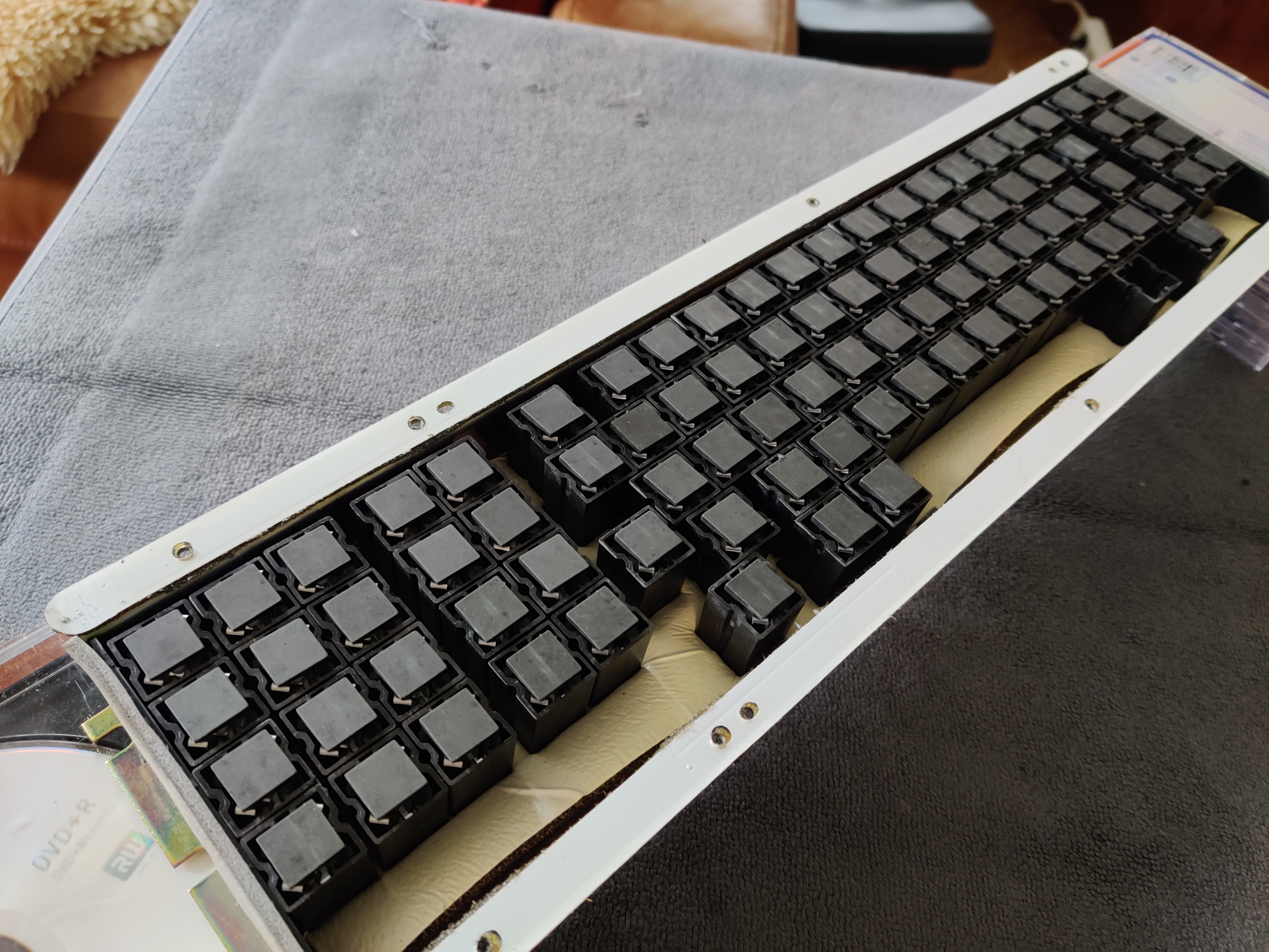

I've opened my switch-assembly last night for the first time. Visually the foam looks perfectly fine, but - as usual - it has no "strength" in it and is totally flat under the switches.
In this condition the key-feel just isn't, what it should be, so I have to do something. But I don't dare to remove the old foam, because I know the now very clean parts will become very messed up, if I try.
When I restored my 5251 keyboard, it was not much fun trying to create a new foam with all the holes in the right places, either. In the end I had do make many holes bigger, because they weren't placed exactly enough.
My current plan this time (not my own idea) is therefore to create a little square foam piece for every switch, so the whole process can be controlled better and the new foam will not interfere with the old one in the places, where it hasn't been compressed by the switches.
Now I "only" have to find the right foam - shopping isn't that easy at the moment.

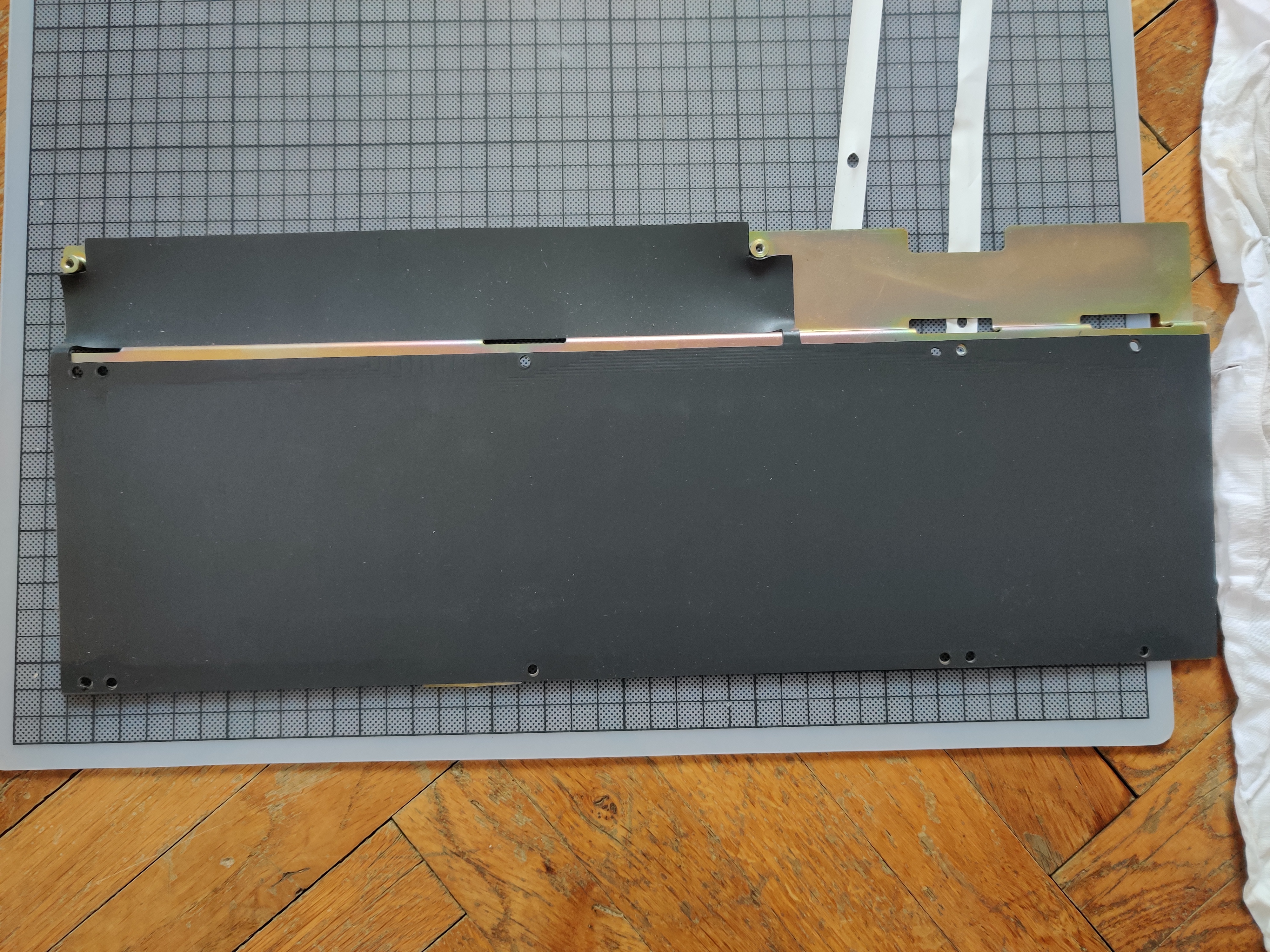

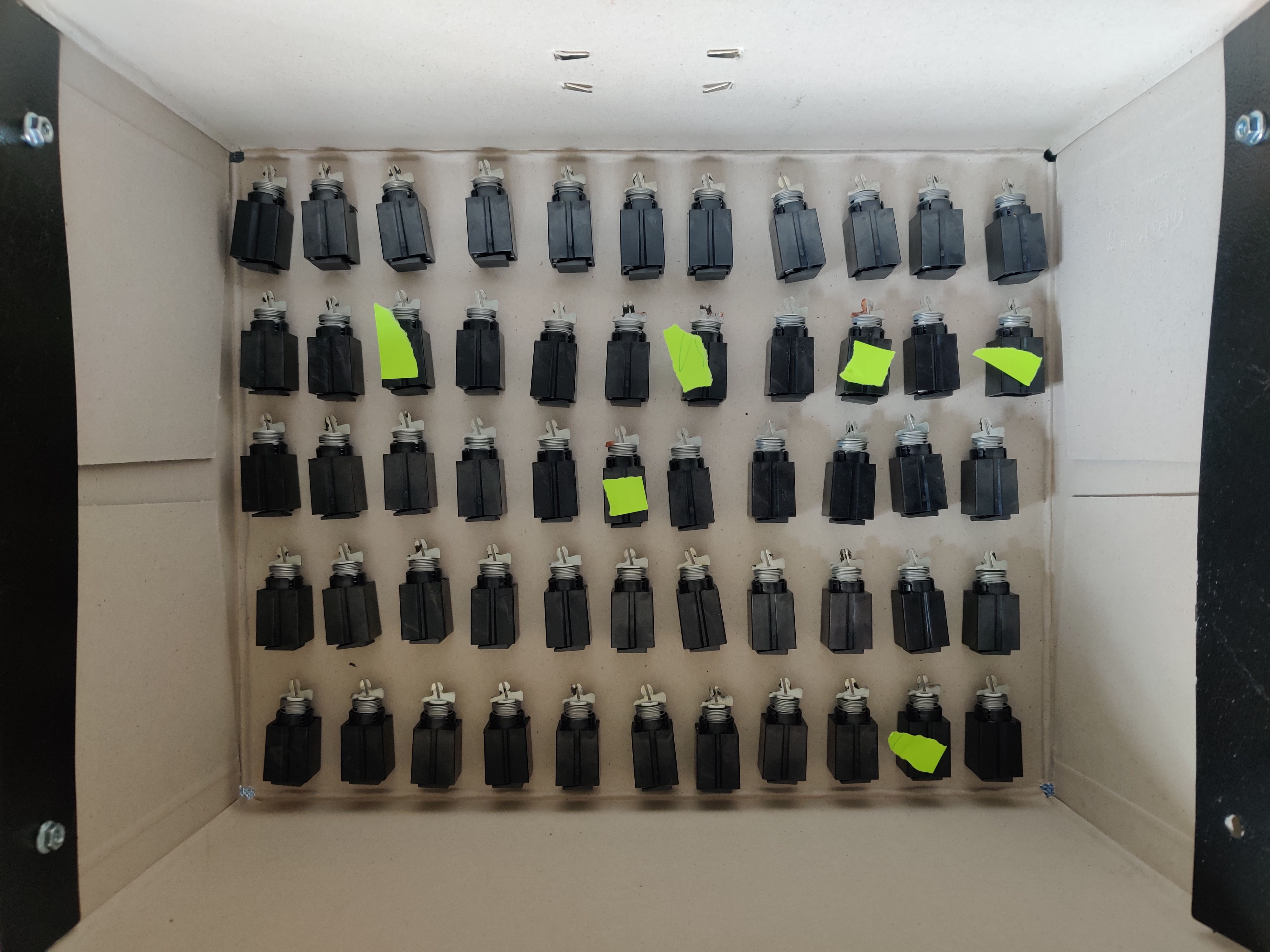

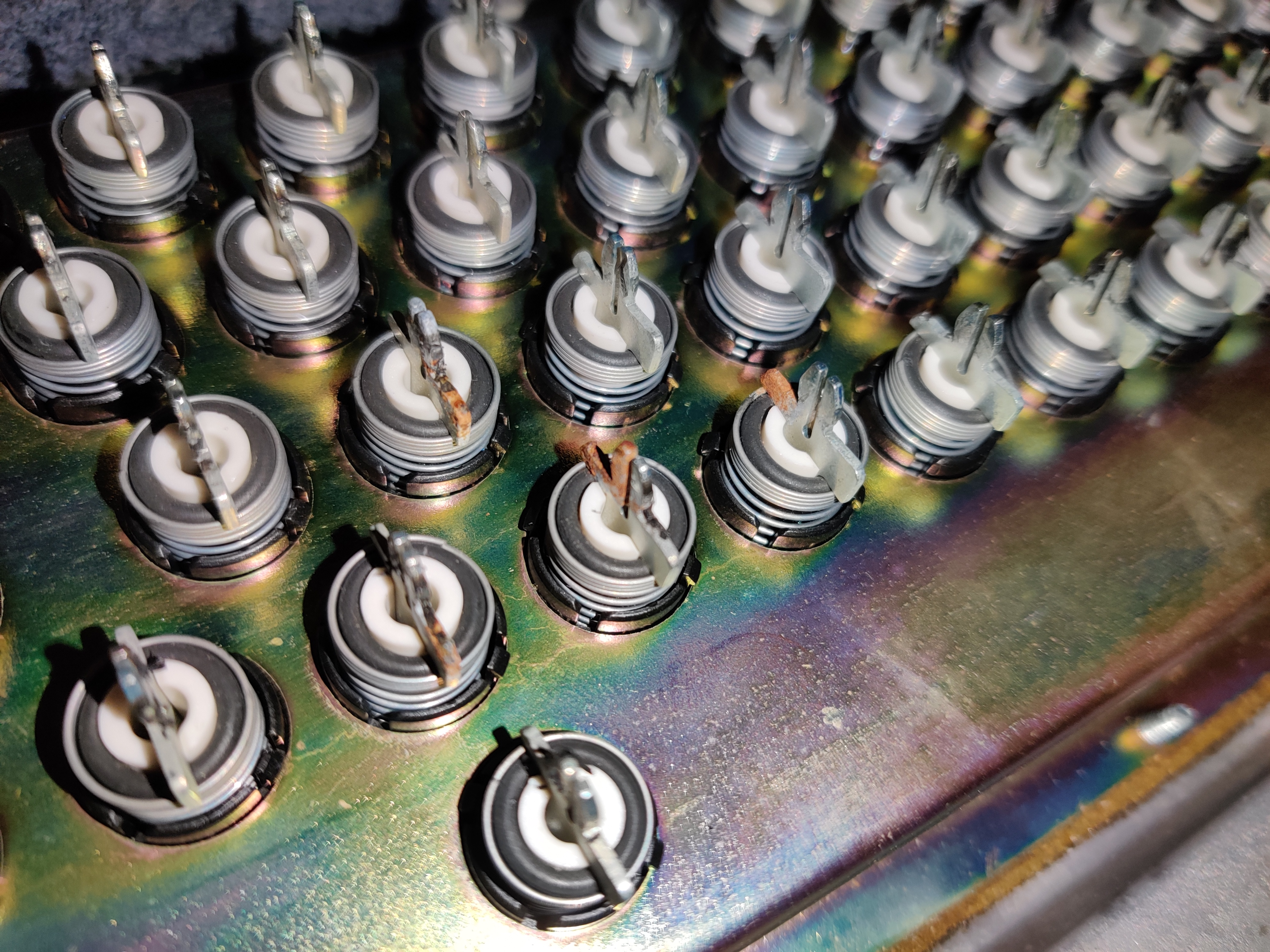

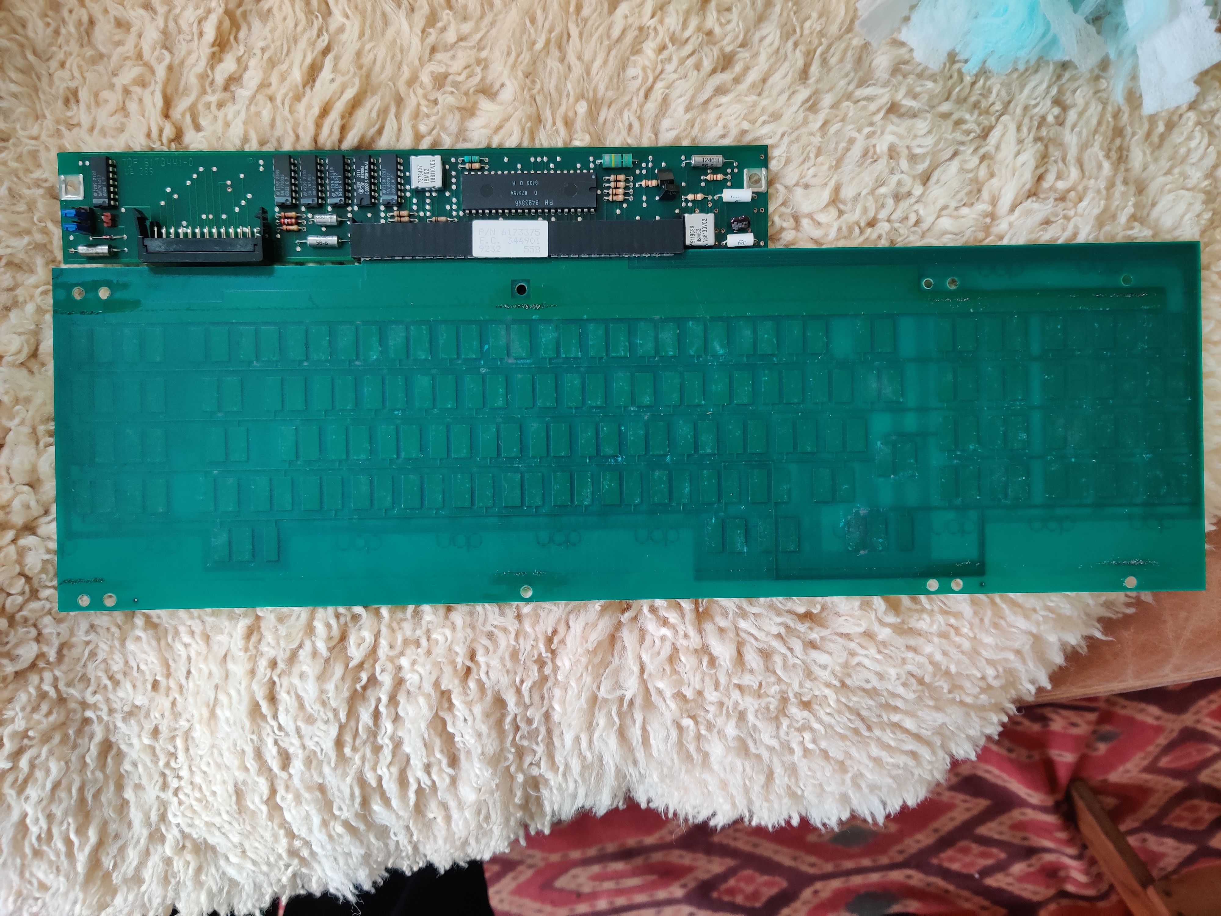

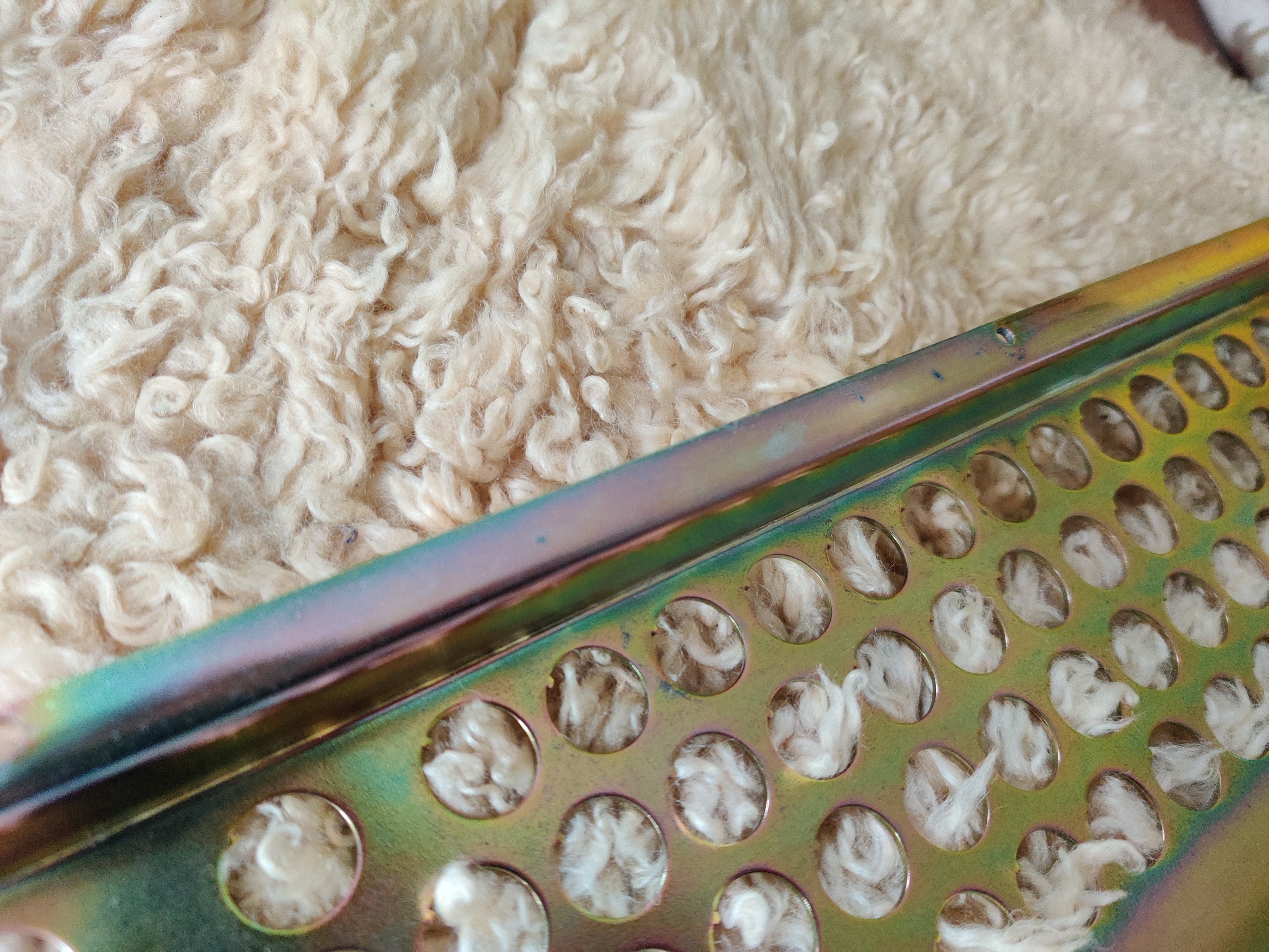

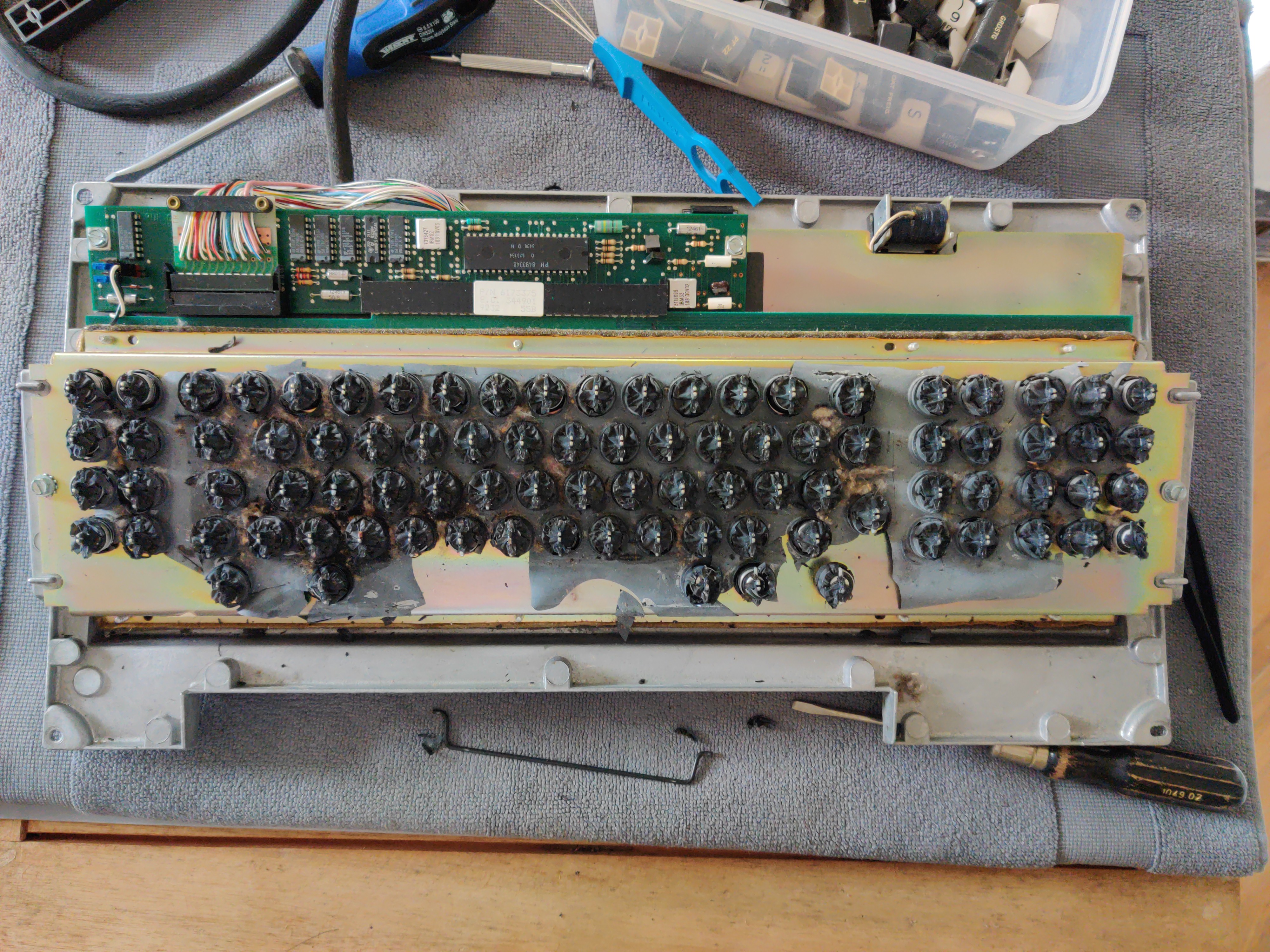

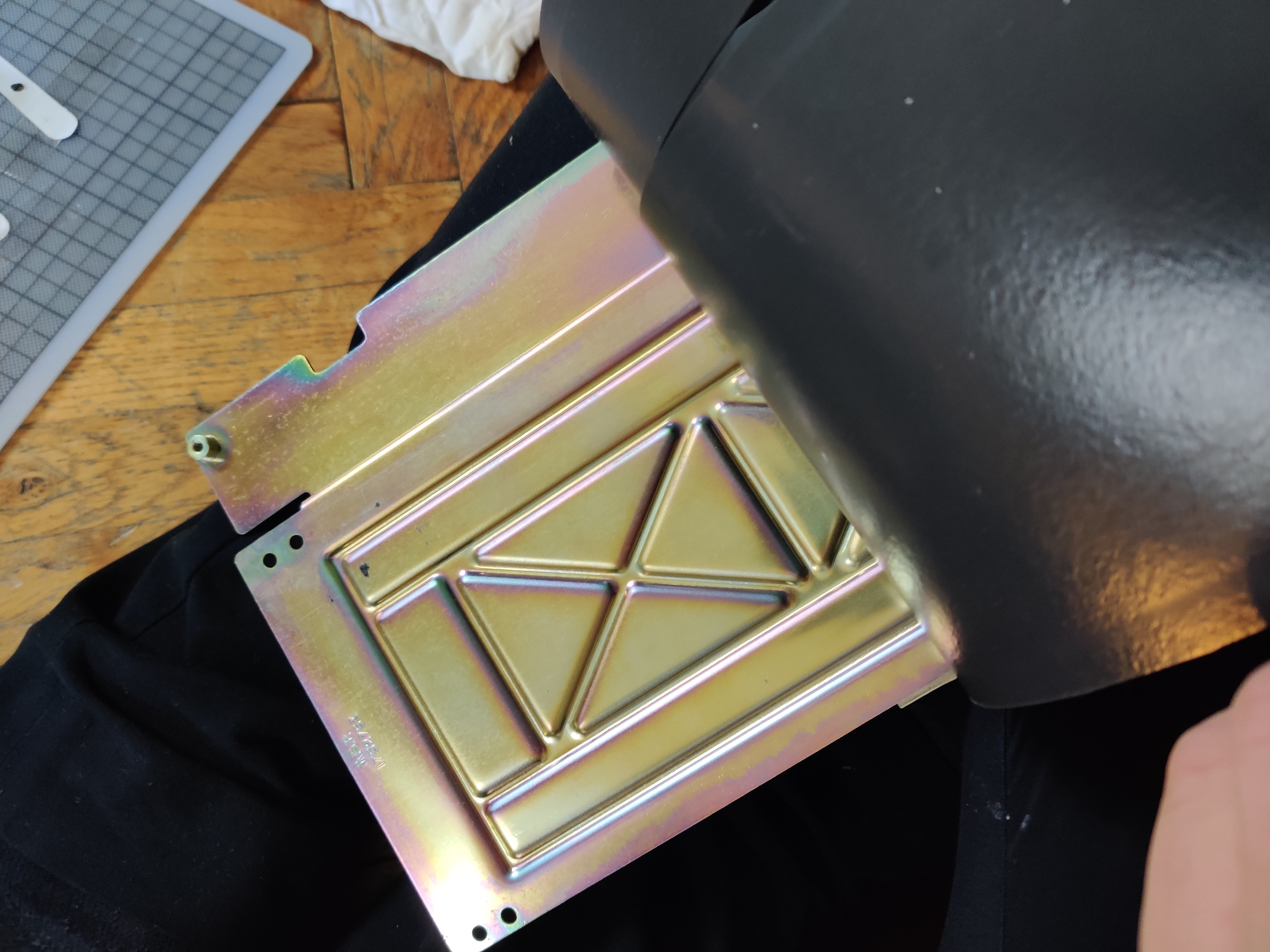

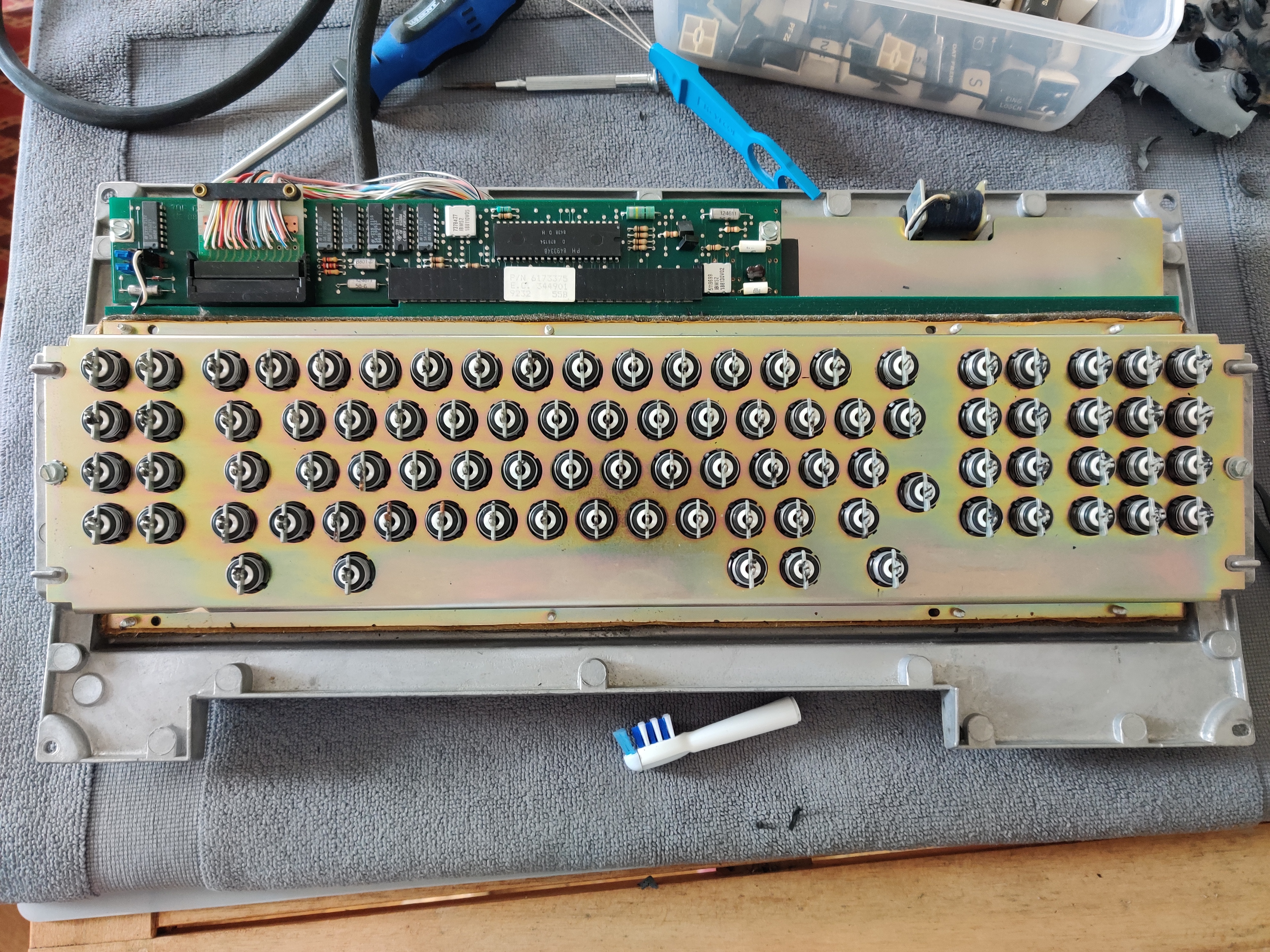

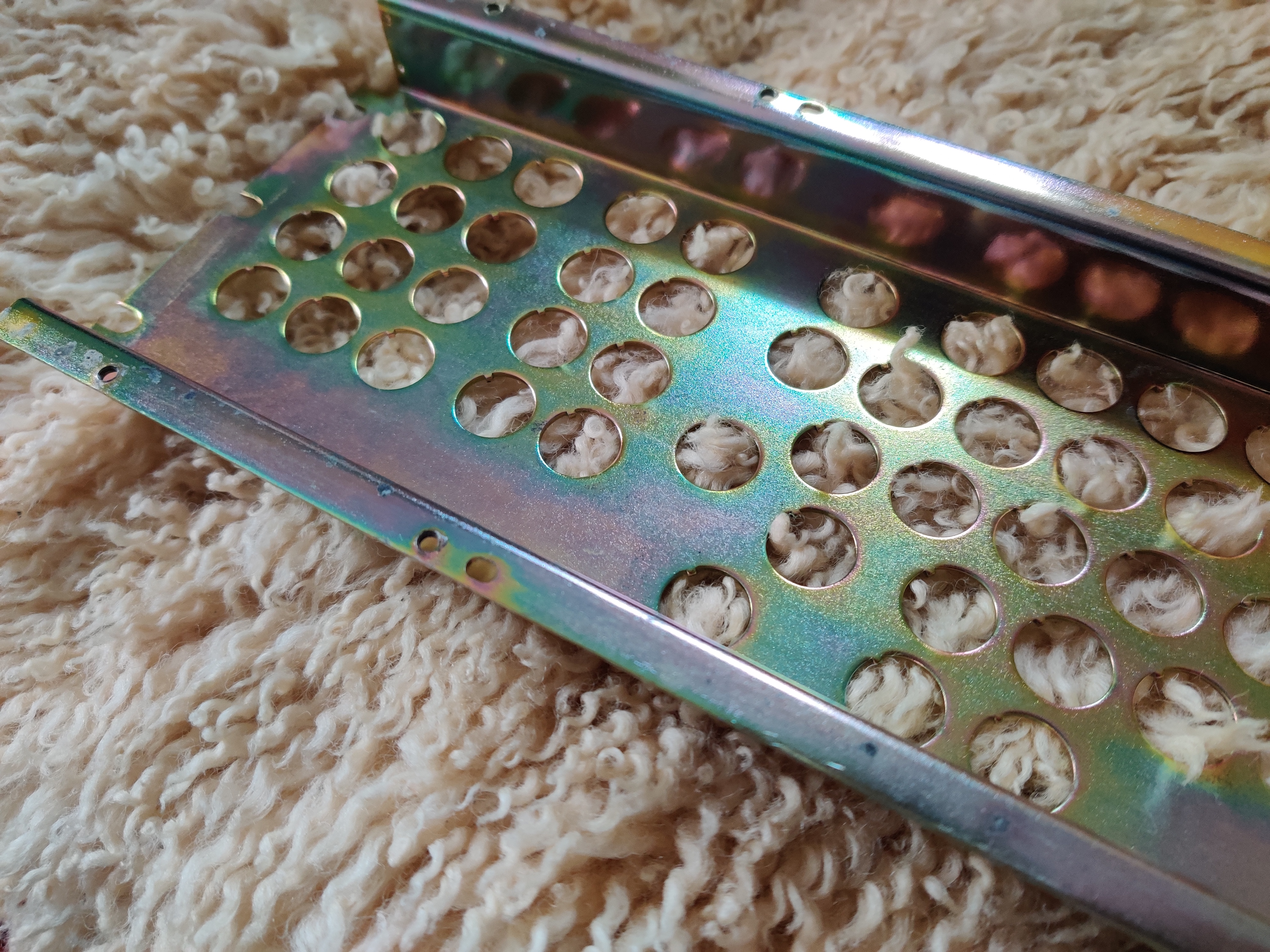

Well, so far so good. I successfully removed the old foam and the only thing that I screwed up in the process was the stabilizer hole in the space bar (fortunately I was able to find that little plastic thing after hours of search and some "Sekundenkleber" did the trick :D )
Here are some pictures:
Is the plate clean enough? There is some foam spots left but after multiple propanyl, vinegar etc. baths I just can't anymore :lol:
Unfortunately some switches are rusty so I will have to disassemble them..
Also, on what parts can I put Ballistol on in order to avoid future rusting :)?

I'm just seeing this thread. Beamsprings are my favorite switch, I daily drive them. I've owned more beamsprings than I can count so I speak from lots of experience when I say the following:
I would highly recommend removing all old foam from a beamspring, because the type of foam that IBM used off-gasses as it breaks down and starts to damage the plastic that makes up the switch housings. It also causes corrosion on the metal where the foam is attached. As the foam continues to break down, it also becomes a prime location for mold spores, and creates a bigger, stickier mess for you to eventually clean out when the foam beaks down so much that the switches get too loose.
Here's a switch thats plastic was in the process of being damaged when I opened the keyboard. I had to take a video of it to capture the crystals on the surface where the plastic has chemically deteriorated.
https://www.youtube.com/watch?v=XSvRPAZ7Sw4
Those are physical crystals on the surface of the plastic. The correspond with the damaged areas of the plastic.
Here's an example of a damaged switch that has been cleaned
Here is a NOS switch that was never put into a keyboard or stored in harsh conditions:
Note the differences in the texture of the plastic after the damage has occurred. It doesn't affect the feel much but it's much better to prevent any further damage that you can.
I would also highly recommend replacing the rubber mat that separates the PCB from the bottom of the switch housing. The mat also off-gasses and will visibly damage the metal plate as well as make it extremely nasty and gooey. The mat is also extremely flammable and will give off toxic gasses if burned.
Here's an example: The black in the picture is mold (product of the way the keyboard was stored). The white is corrosion caused by the breakdown of the clear rubber mat used in all USA models except the Displaywriter, which uses a black mat made of a different, more stable rubber.
I would also highly recommend removing the contamination shield as it will only continue to crumble, and eventually tiny little sand sized pieces of the shield will work their way into the switches as the shield crumbles away and this will completely RUIN the switch feel, because they will scratch up the plastic in the switch. The feel of a switch isn't something that I can show on a forum but the shields are extreme pains in the ass to clean up once they have begun to disintegrate. If yours is still intact, you are lucky and should take it off while you still easily can.

Thanks for all the input! I did already remove the contamination shield and the only foam that's left are those tiny spots you can see in my last picture. If you say they are really bad then I'm going to let it sit in Isopropyl tomorrow again and hope to clean it 100% this time.
Weezer wrote: 18 Apr 2021, 22:41
If I remove the rubber mat with what do I replace it as otherwise PCB and the plate would be in direct contact.
Also I guess it makes sense to open all switches and clean every part individually right? I think that's the only way to remove all leftovers of foam and pieces of contamination shield.
Thanks for all the tipps :)

You can replace it with any material that's convenient to you that's nonconductive. It just acts as a spacer. The thickness of the material doesn't matter as long as it's within reason. I've used: large sheets of printing paper, wood veneer, and non-corrugated cardboard on various keyboards. I chose those because they are substances that won't break down easily, and they were also available to me for free. You might also want to use some eco friendly art foam or a safer type of rubber. I prefer using the box from a 12 pack of soda (USA) because it's already the perfect length and width.
For the keys the correct way is to take each one apart and clean each piece fully. But if the keys feel nice already you can get away with not taking them apart. Instead what I would do is remove them from the metal housing, then take some Q-tips and dip the end into some ethanol or isopropyl alcohol and clean the sticky foam off the top of each switch. I'd then take some compressed air and just spray a little bit into the switch (careful not to dislodge the flyplate) to remove any dust that might be in there.
The thing that I was trying to stress though was the removal of the foam and rubber that will continue to break down even after you've finished the restoration and cause problems down the line.
That said you did a nice job on the contamination shield and your keyboard looks really nice!

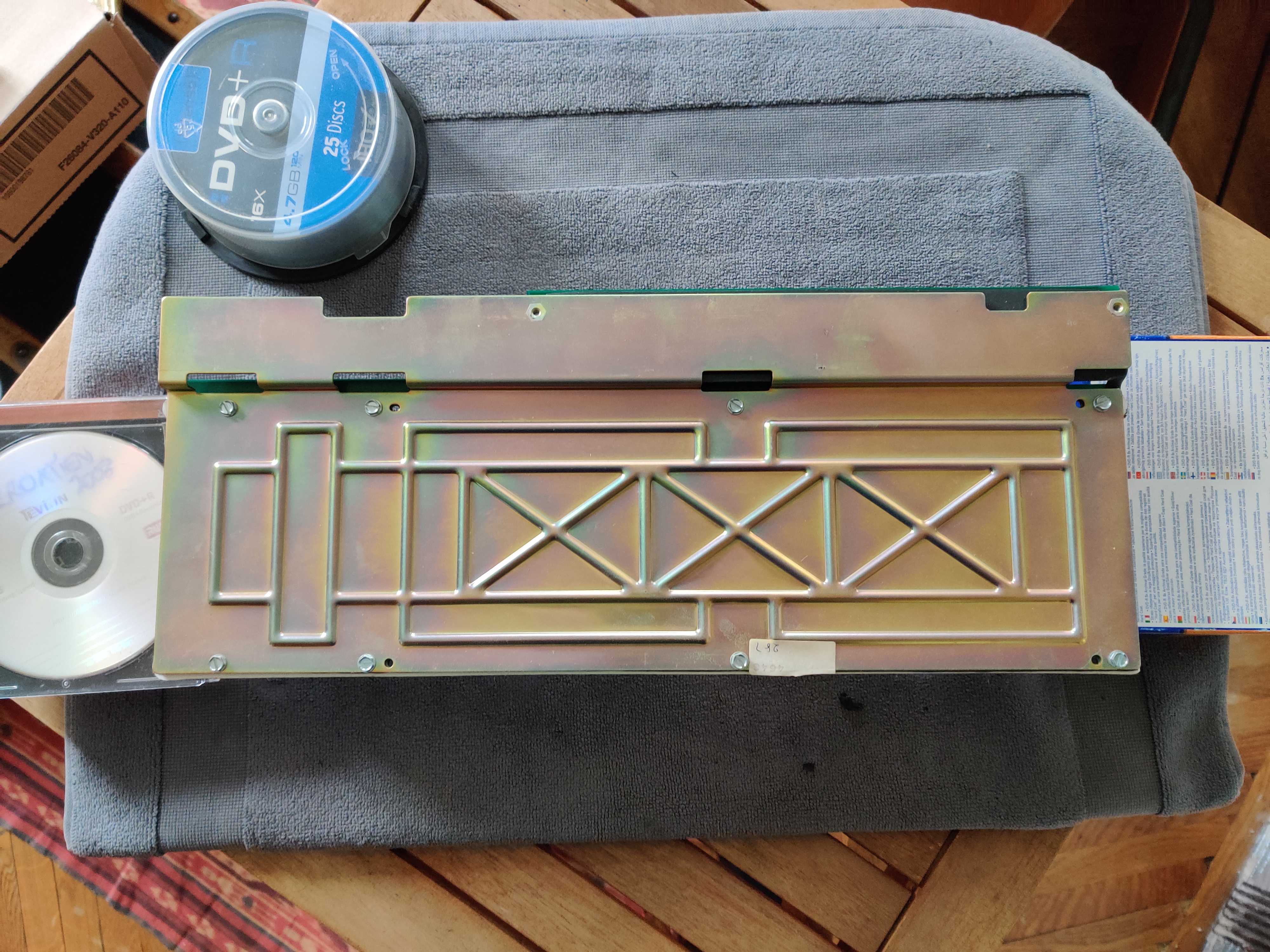

Weezer wrote: 18 Apr 2021, 22:41 I would also highly recommend replacing the rubber mat that separates the PCB from the bottom of the switch housing. The mat also off-gasses and will visibly damage the metal plate as well as make it extremely nasty and gooey. The mat is also extremely flammable and will give off toxic gasses if burned.
I took a picture of the mat today:
Did the mat already damage the plate or could it be that the German one uses a different rubber material?

Hey that's the good mat that is used on the USA model displaywriter. It breaks down much slower. The mat material that breaks down and creates the damage I showed is the clear mat that is found on the other USA models. All rubber has a lifespan, so it will need to be replaced at some point but it won't break down as fast as the other kind.
Lalaland124
19 Apr 2021, 19:53
Weezer wrote: 19 Apr 2021, 19:49 Hey that's the good mat that breaks down much slower. The mat material that breaks down and creates the damage I showed is the clear mat.
Now I finally think I got it thanks! But just to be 100% sure, so that I don't remove the wrong thing ( :roll: ): I remove the clear mat and the rubber mat or just the clear mat :)?
Weezer
19 Apr 2021, 20:01
Lalaland124 wrote: 19 Apr 2021, 19:53
Sorry I edited my post to make what I was saying more clear. On USA models except for the displaywriter, a clear mat is used. That's the mat that breaks down aggressively and causes the damage that I showed. You have the black mat that is used on the USA displaywriter model which breaks down much slower and causes less damage.

Lalaland124
24 Apr 2021, 18:25
I'm almost done with the restauration and so far everything went pretty well :D I have on question tho, does anyone maybe have a picture of the little compartment for the IBM manual? I took apart the spring mechanism and don't really know how to put it back together :mrgreen:
