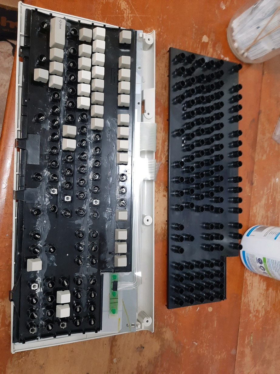

A while back I knocked on my IBM Model M, 1993 a little too hard and knocked loose a buckling switch. I took a look and saw the keyboard needed a good cleaning. Also, a lot of the rivets fell out.
I decided to fix the cracked barrel plate while I was sprucing things up.
I didn't fully appreciate or understand the mechanics of the keys while I was fixing the barrel plate with epoxy. I ended up getting too much epoxy on some of the barrels. Scraping away the excess epoxy had been somewhat helpful. I'd also read that using denatured alcohol could help clear up the extra epoxy (I didn't have any luck with that).
I contacted clickykeys and they said they only provided barrel plates to refurbish customers - not as a part to purchase.
I contacted Unicomp and they said that they did not sell the plates. [I did try buying a barrel plate available on their site - but it wasn't suitable for my model M - it's their new version.]
I have had no luck with Ebay.
I've seen some old threads where people were printing / selling barrel plates. Is there any source for barrel plates that you are aware of?
Aside of that, any clever / pragmatic ideas for clearing of the extra epoxy?

Can the flippers still move freely or is the epoxy inside the barrel plate inhibiting the movement of the flippers?

The flippers can move freely as far as I can tell. The barrels don't have epoxy on the inside from what I've seen. It seems that where the movement is limited - is occurring from epoxy on the outside of the barrels.
I've had some success scraping epoxy of the outside of the barrels - the keys can then move freely up and down.
But other barrels are proving more problematic to scrape off the epoxy or sand off with a little file.

Despite that in direct communication with Unicomp I was told that they don't sell the barrel plates - or frames as they refer to them, I had ordered a frame. It is the new style - which is incorrect. I looked at my invoice and it seems that's what I had ordered.
I have now ordered the 101 key - I hope that is correct. cf. https://www.pckeyboard.com/page/product/CVSET

So why wouldn't these fit your model? I've been reading up on M restorations and people mention the Unicomp barrel plates as viable replacements.

Jan Pospisil wrote: 11 Apr 2021, 23:53 So why wouldn't these fit your model? I've been reading up on M restorations and people mention the Unicomp barrel plates as viable replacements.
Look at the pic. Wrong layout. The bottom rows don’t match. Won’t fit in the winkeyless case or use its caps.

Oh, so do they not sell winkeyless types of the barrel plate anymore?
12 Apr 2021, 10:40
Unicomp likes to be confusing—maybe they are just confused? This link looks right to me:
gnudon wrote: 11 Apr 2021, 23:09 I have now ordered the 101 key - I hope that is correct. cf. https://www.pckeyboard.com/page/product/CVSET
Select the right item in the dropdown list "Frame 101 key" and it's still in stock: "Style: FR101"
