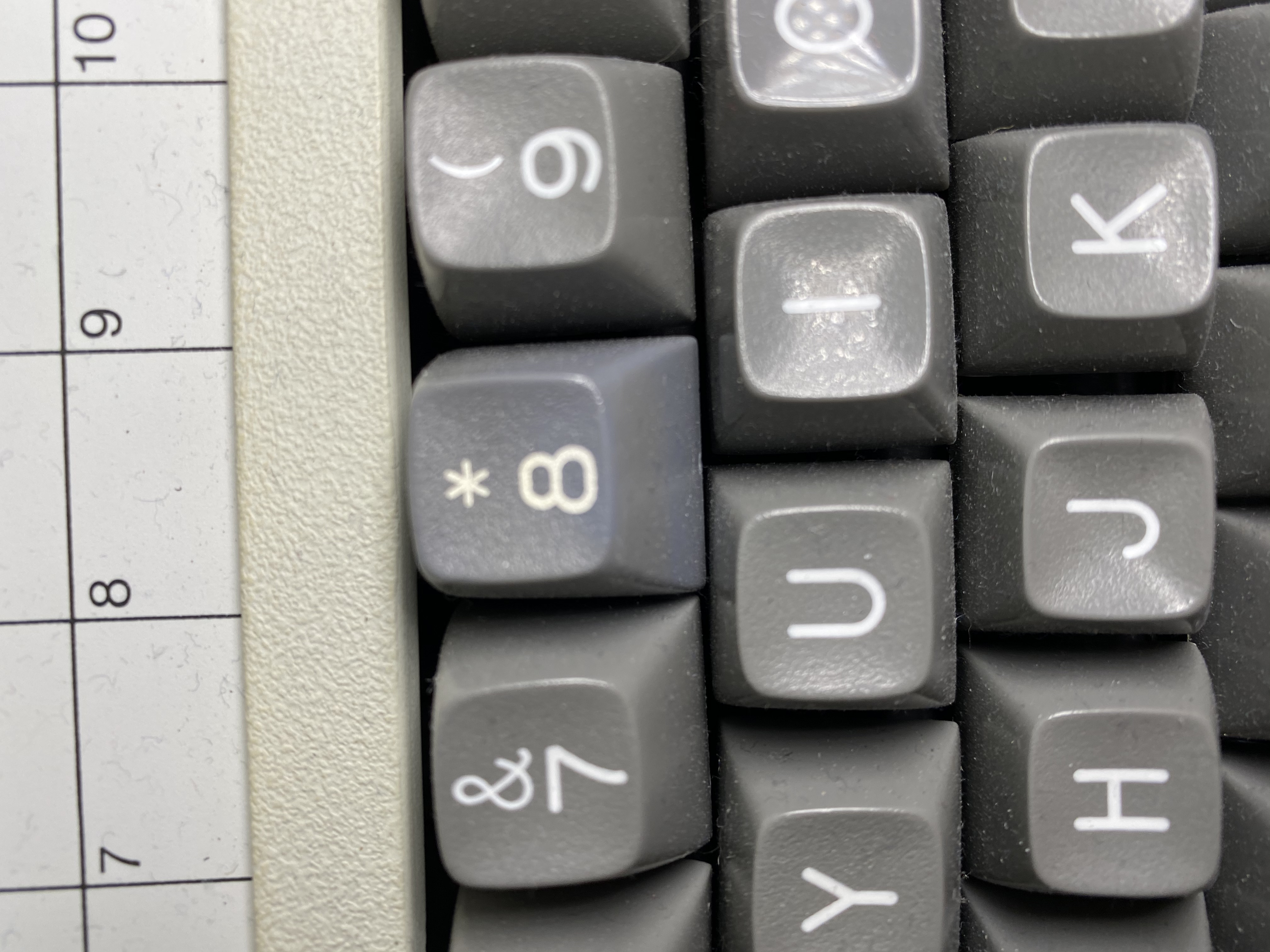

I had to sand down my 3278 case and get it powder coated again due to a lot of chipped spots. Prior doing that I have cleaned it with a cloth (Mikrofasertuch) and some soap and warm water.
btw: I saw that some of your keys have yellowed plastic. I had a few of those as well and used a modified retr0bright method. A fair warning here, if you plan to do the same. While the white on the key really did lighten up, the rest of the key did also. Below is a (bad) shot of the 8 - key. You can see how different the gray is compared to 7 and 9 .... (and while taking a picture ... I saw it is horrible dusty also :) ...)

Thanks for the replies! I think I won't have to sand down my case luckily, also for as of right now I'm staying away from retr0brighting until I have more experience with it :) I think I will just try to get rid of the dirt and dust with a mikrofasertuch and that should be enough :D
