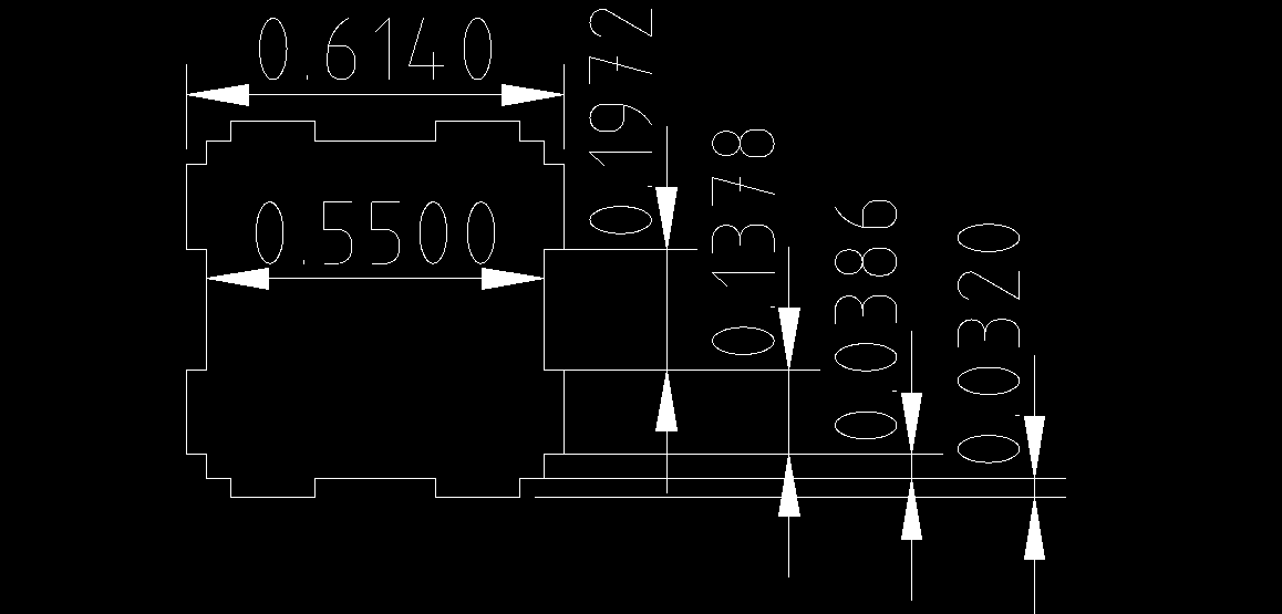

- Cherry MX datasheet in german, not a lot of information but worth a mention : wiki/File:Cherry_MX_datasheet_(July_1985).pdf
- Cherry MX datasheet, the best one in my opinion, has the most amount of information in the most compact format : wiki/File:Keymodule_MX.pdf
- I pray to god no one uses Imperial units to CAD, but if there are some heretics, here is an imperial datasheet : https://cdn.sparkfun.com/datasheets/Com ... Series.pdf
In case the link dies :
MX Series.pdf
(134.68 KiB) Downloaded 136 times

Myoth wrote: 27 Apr 2021, 00:29 There's also a lot of information you give but don't source, I know they're right, but I think I would be scared to use information I found from someone I don't know.
In case the link dies : MX Series.pdf
I totally agree on your statement about the usage of Imperial units in CAD :D
I see you have linked the datasheets. That's a great idea. Thank you! I'd make sure to do the same in one of the next edits.
Fair point, but can you please point which information you are saying can be given a source but I haven't?

Sure :
ifohancroft wrote: 26 Apr 2021, 04:58 - A unit (written as 1u) in terms of keyboards refers to the distance between two switches (measured from their centers), as well as keycap sizes. 1u is 19.05mm / 3/4" / 0.75".
- The cutout in a plate, for an MX type switch is a 14mm square for a regular switch cutout. Stabilized keys and cutouts that allow you to open the switch without having to de-solder it (for non-hotswap boards) are slightly different (although the 14mm square can easily be spotted in their design so you can still use that for centering).
- The actual size of a keycap of certain amount of units is less than those units multiplied by 19.05. A 1u keycap's actual size is more like an 18mm square (this is a back of the envelope measurement and varies between keycap profiles. However, this isn't meant to give you the actual size of keycaps, but give you a good understanding of what the units are and aren't and so the formulas later make sense).

Myoth wrote: Sure :
Thank you! That's a good catch/point. I'd link the datasheets.
