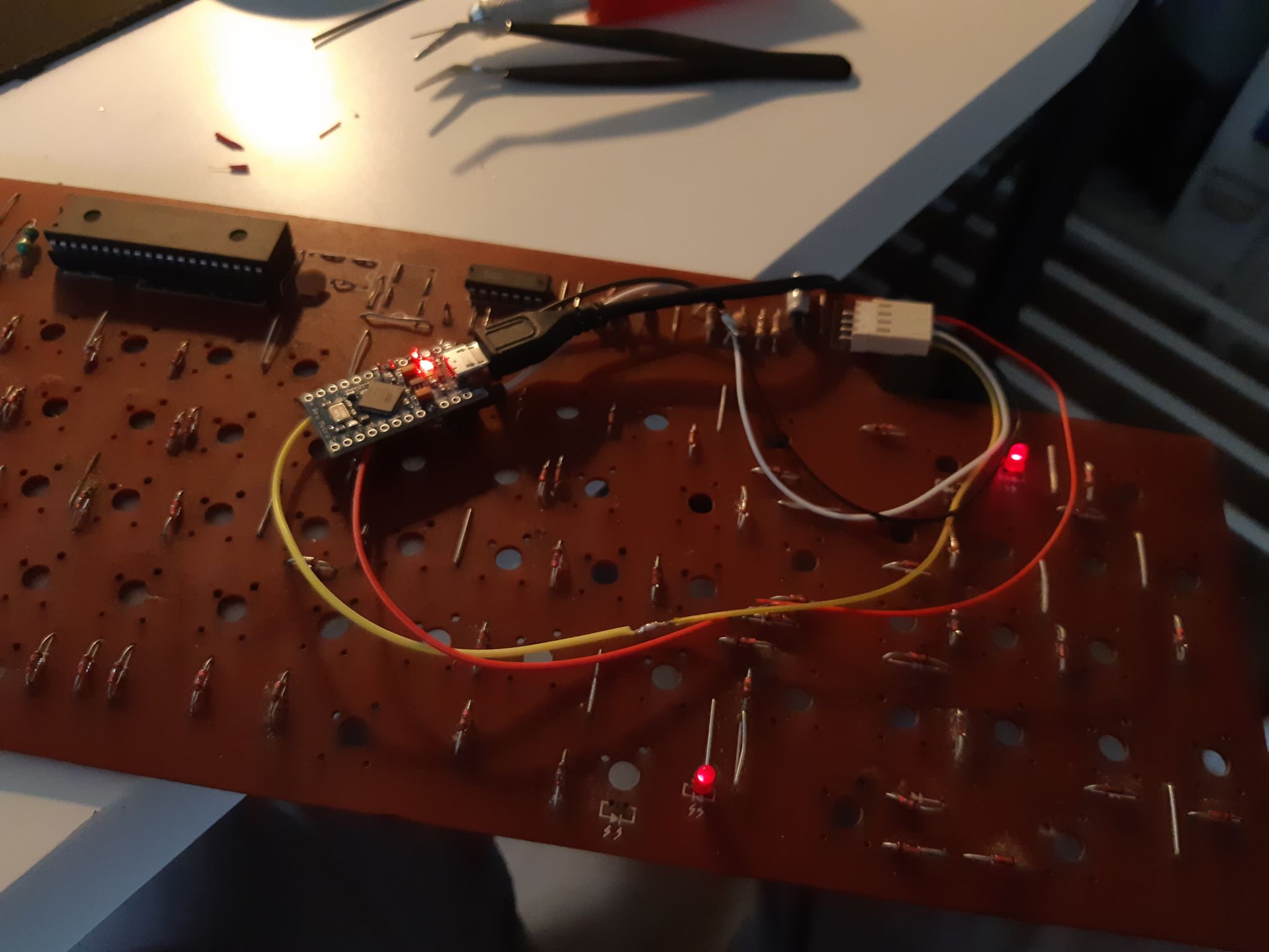

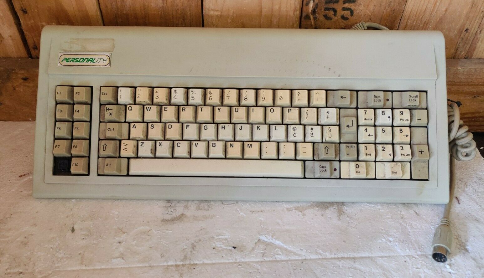

Hi fellow DT members, currently trying to get this to work, to no avail. I couldn't find any answers on GH, DT etc, so I'm willing to give 5$ to anyone that can help me out. Flashed the promicro with soarer's software, soldered it to the internal wires and it isn't registering any keypresses although lock LEDs are on. R04, R05 and R06 errors pop out in hid_listed on connect, then it's silent. Pics:

The Keyboard ID and Code Set are correct for an XT keyboard, so the converter is at least talking to it. The lock lights shouldn't be jammed on, though.
Is there an XT/AT switch on the keyboard? If so, switch it into AT and try again.

No, there is no XT/AT switch on the keyboard. It had a DIN5 connector by default, and overall I can't find much info on the keyboard itself
Oh, and the LED on the pro micro is also on at all times, I don't know if this is supposed to be this way, it's my first time using it. Maybe I got the wiring wrong?

The LED being lit up on the Pro Micro is probably a bad sign. I think Soarer uses it as a warning indicator. I had similar issues with my IBM Model F AT on one of those. It just drew too much power for the Pro Micro to handle. Went with a Teensy instead. That handled the extra load.
The wiring is probably right—or you wouldn't see the Keyboard ID stuff at all—but always worth double checking.

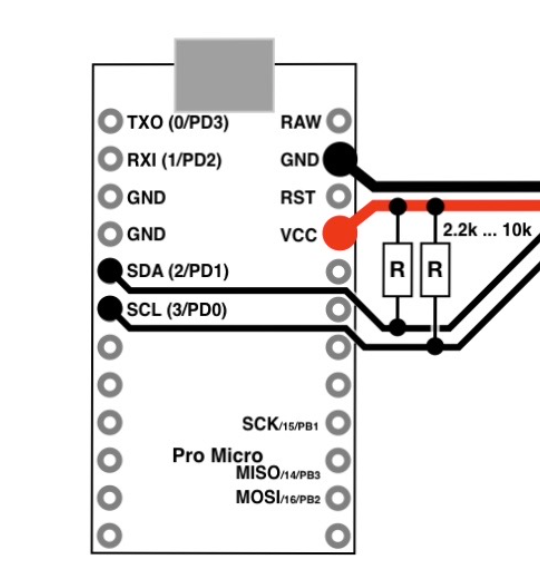

Red light on when plugged in is normal for QMK but if Mu says it's not normal for Soarer I'd have to defer to his judgment. Did you add 1k pull-up resistors from VCC to clock and VCC to data?
- raoulduke-esq
- Main keyboard: Current in the rotation: Silver Badge
- Main mouse: Magic Trackpad 2
I had a lot of errors with an ADB QMK converter I was making until I added external pull-up resistors. Pro Micro is supposed to have internal pull-ups but they can seemingly be insufficient for some vintage boards.

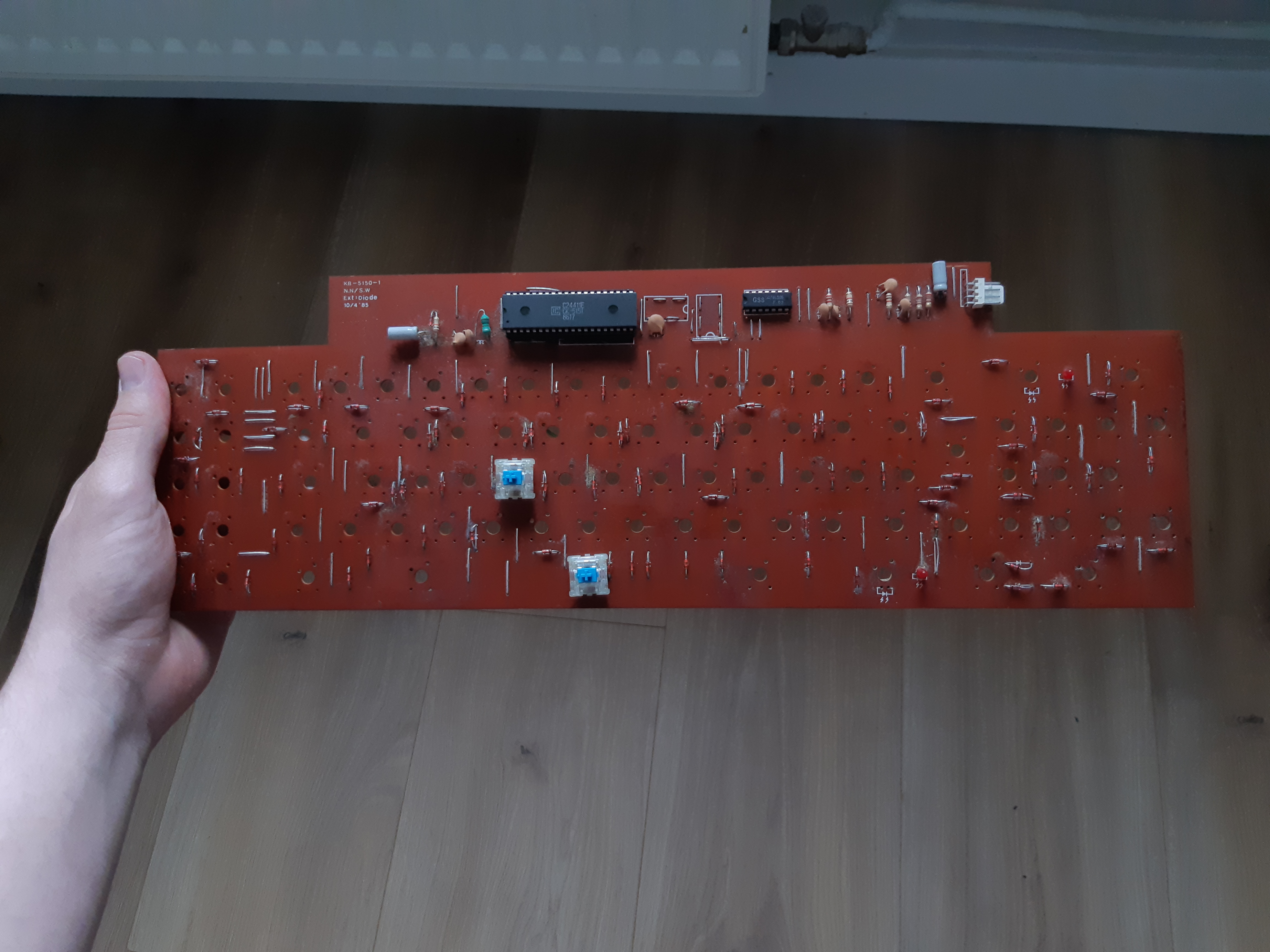

What if the PCB is dead? I had no other way to test it, other than using a Soarer's converter, that means it can be dead and it not being the converter's fault, since no keypresses (I soldered in a couple of switches to test) or shorting pads manually output any codes to the converter itself.

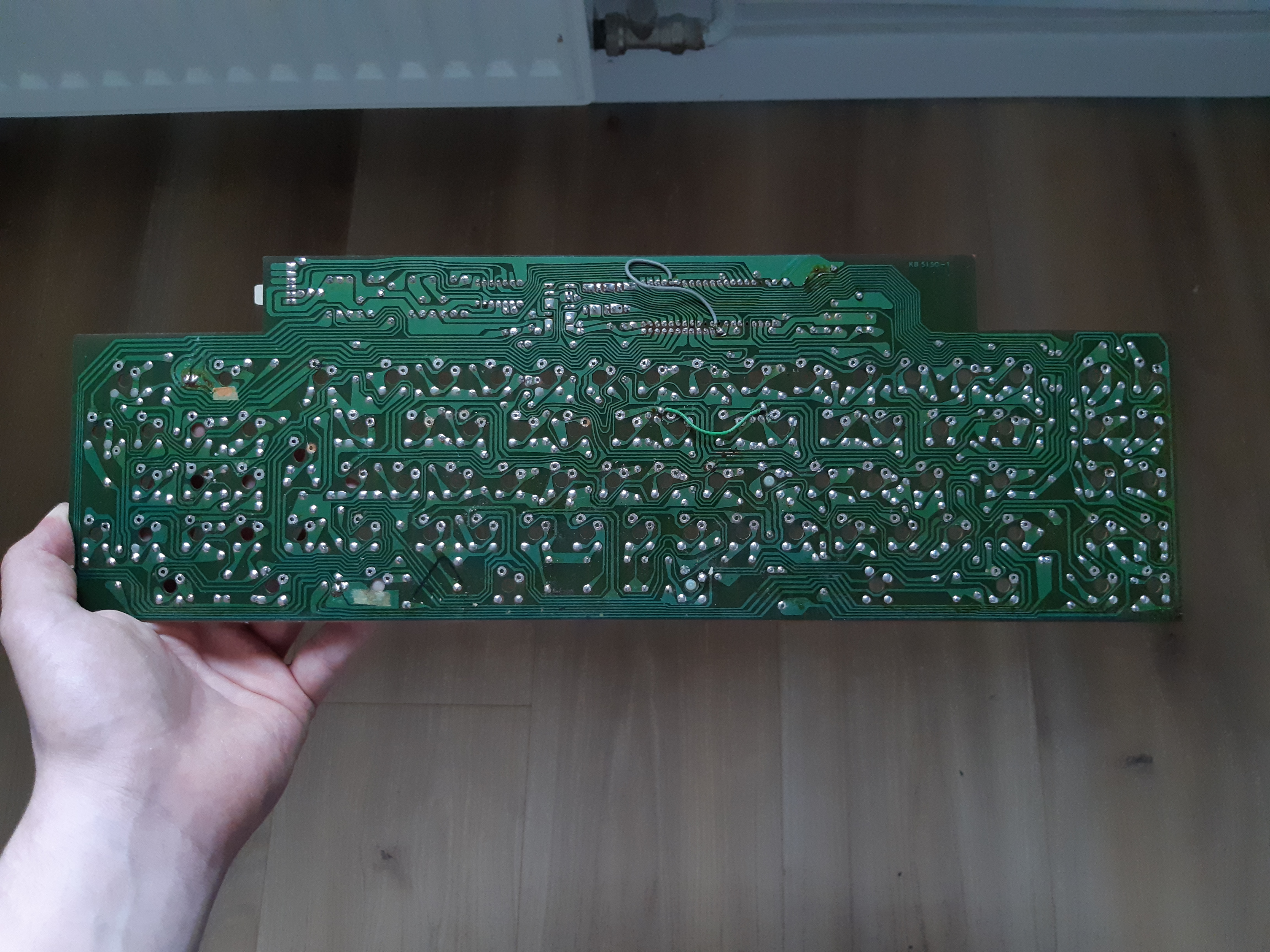

Try swapping clock/data, can you also take good pics of both sides of the PCB?

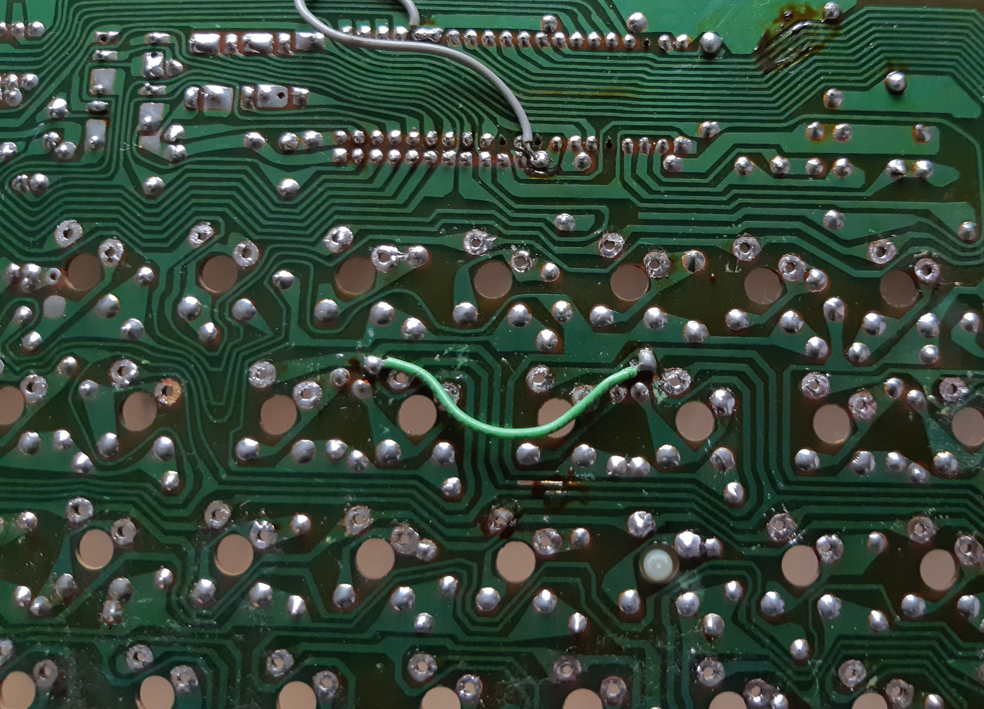

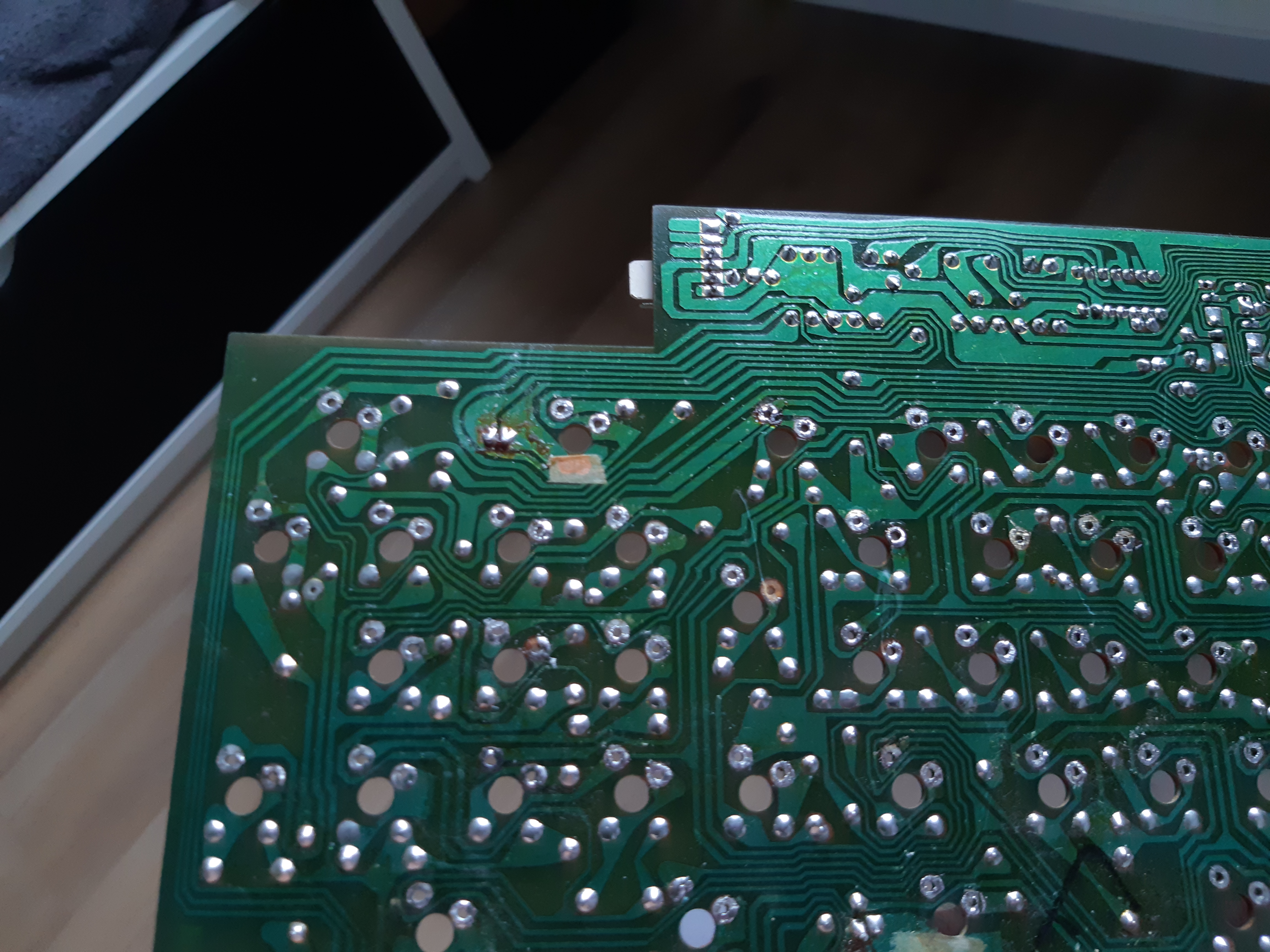

Alright. The condition of the PCB is... worrying to be honest. I got it this way, it had some bridges already done (in the pics)

I had an issue with a iiGS keyboard recently where it seemed dead when plugged in. Looked like there was some corrosion on the PCB around the connectors. Desoldered them and found that the pads were corroded/lifted. Wired some jumpers from the connectors to the next point along the traces and now all is good!
Here's an illustration of the concept. Hoping another comrade will chime in with a photo!
Any 1k ohm resistor should work. I used these https://www.amazon.com/gp/product/B0185FGTSS/
Someone may have a reason for not doing what I did, but I ran my resistors under the Pro Micro, inserting the legs up through the appropriate holes and connecting the wires to those. It worked in my case, but I was just experimenting. There are a lot of people with a lot more knowledge of circuits and controllers here so if they say that's a bad idea I'd listen to them!

Can you try TMK?
Also I wanted pics of PCB to check if it had the MCU reset line connected to what would've been the original cable but it doesn't appear to.

Hmmmm... Sounds like the controller is happy now (pull-ups fixed my errors too). It's a shame about the board- looks like there was a fair amount of jiggery-pokery done on it. Beyond those jumpers I see some burns and such and it almost looks like the controller jumper is bridging two pins at the top. That might be part of the problem. Looks like seller tried to fool with it and gave up.
