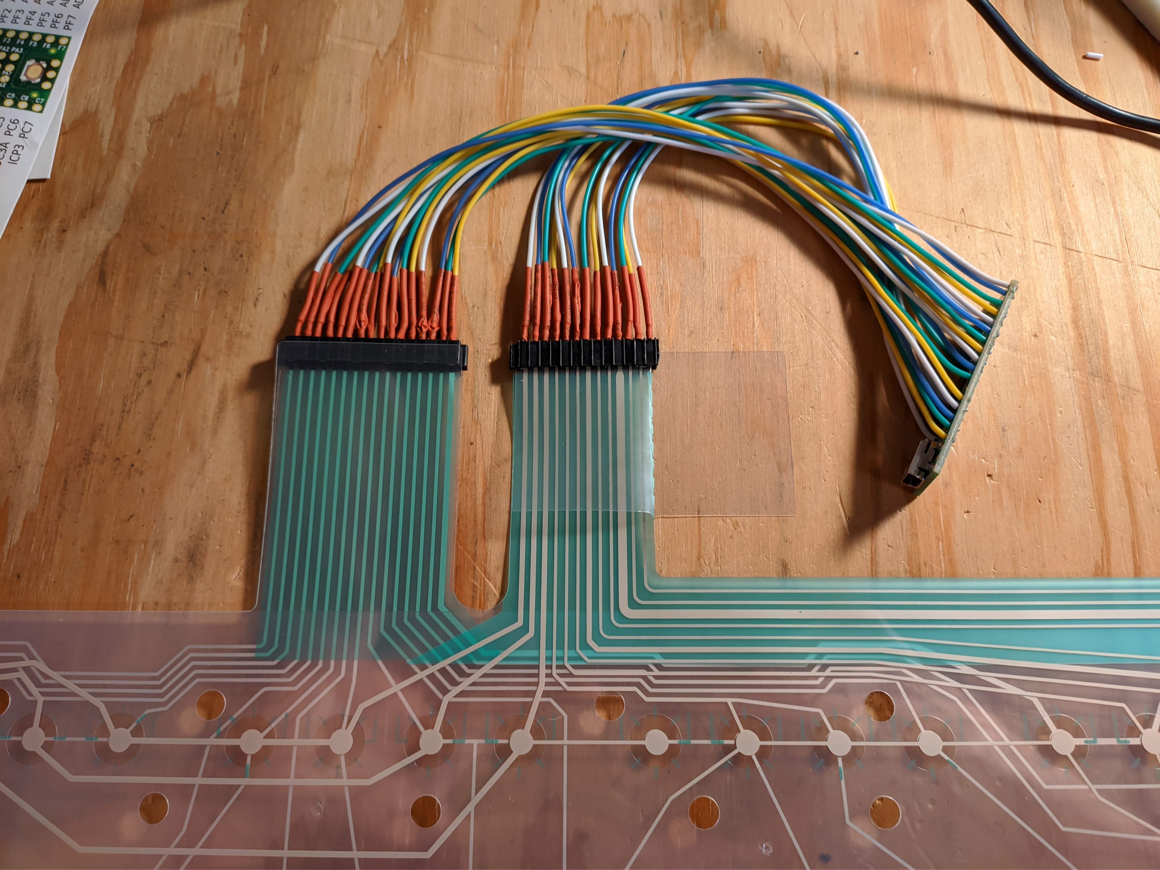

QMK should be able to interface with the stock controller board just fine as a converter. If you're really wanting to do direct matrix connection I'd recommend just harvesting the FPC connectors from the controller board kinda like this.

jsheradin wrote: 02 Jun 2021, 01:26 QMK should be able to interface with the stock controller board just fine as a converter. If you're really wanting to do direct matrix connection I'd recommend just harvesting the FPC connectors from the controller board kinda like this.

Why harvest the connectors? Those Trio-Mate connectors are still available. When I built a test board for diagnosing matrix problems with an M122 recently, I used Mouser part numbers 571-7-520315-0 (20-way) and 571-5-520315-8 (8-way).

Sheepless wrote: 02 Jun 2021, 02:05 Why harvest the connectors? Those Trio-Mate connectors are still available. When I built a test board for diagnosing matrix problems with an M122 recently, I used Mouser part numbers 571-7-520315-0 (20-way) and 571-5-520315-8 (8-way).
The new Mouser parts are actually what's shown in my picture, one of them is just trimmed short. I just figured if the controller board is getting replaced anyways then the connectors might as well be put to use and keep cost down a bit in the process.
I guess if the controllers are going to be used for repairing a different board or something then sure, keep them in one piece.

I bought 10 each of the connectors from Mouser. (After fighting and losing to Digi-Key's online ordering system...) And I'm replacing the controller to get the power draw down, as well as save room in the case for the Raspberry Pi.
