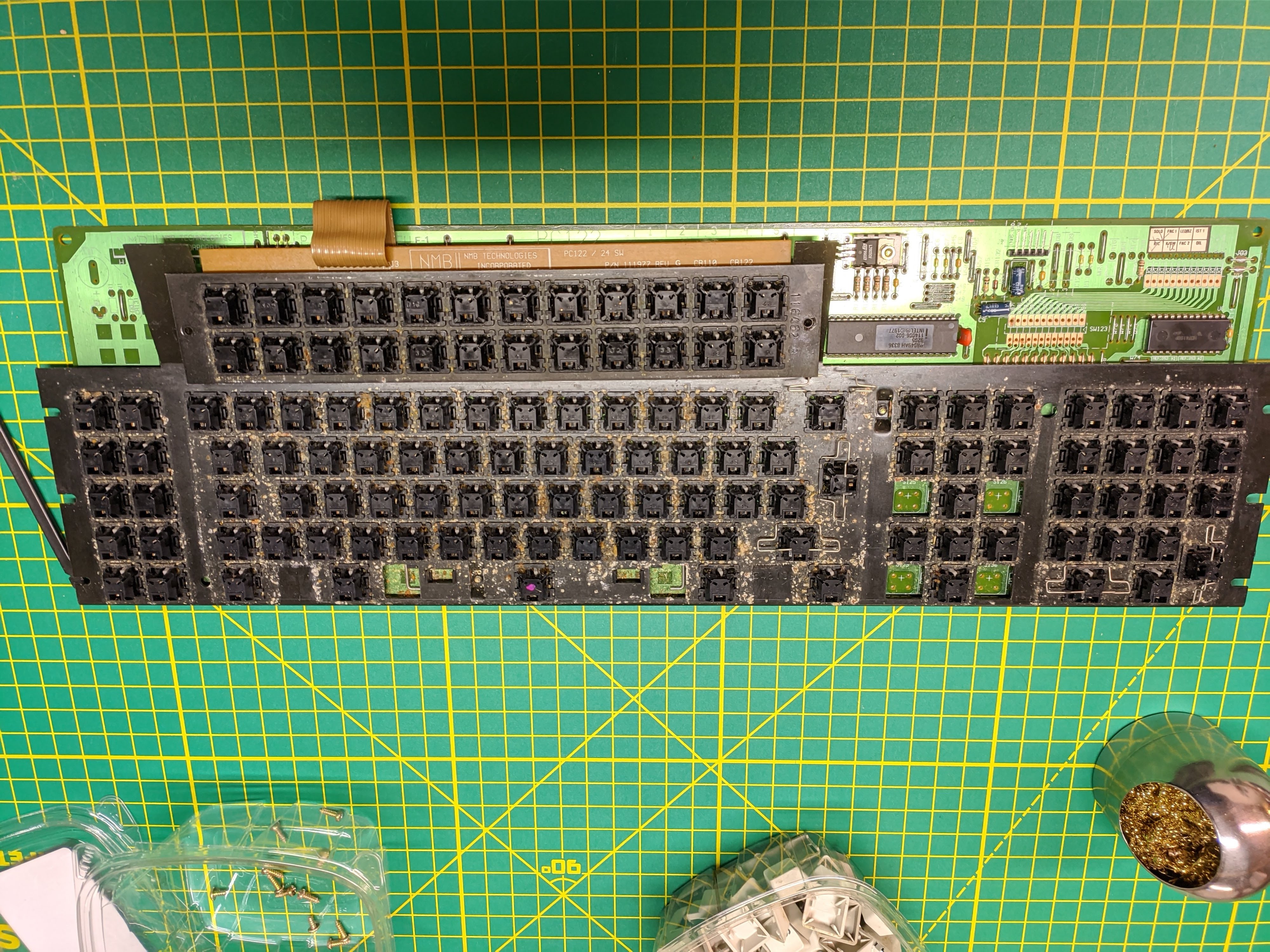

How does an ISO pcb/ footprint for SI look? I'm having trouble finding a photo of an ISO space invader board with the keycap taken off.
None of the public libraries seem to have an ISO footprint, usually only a BIGass enter one.

I cleaned up a crusty NMB PC-122 a while ago if this is what you're looking for:

Yes, thank you!

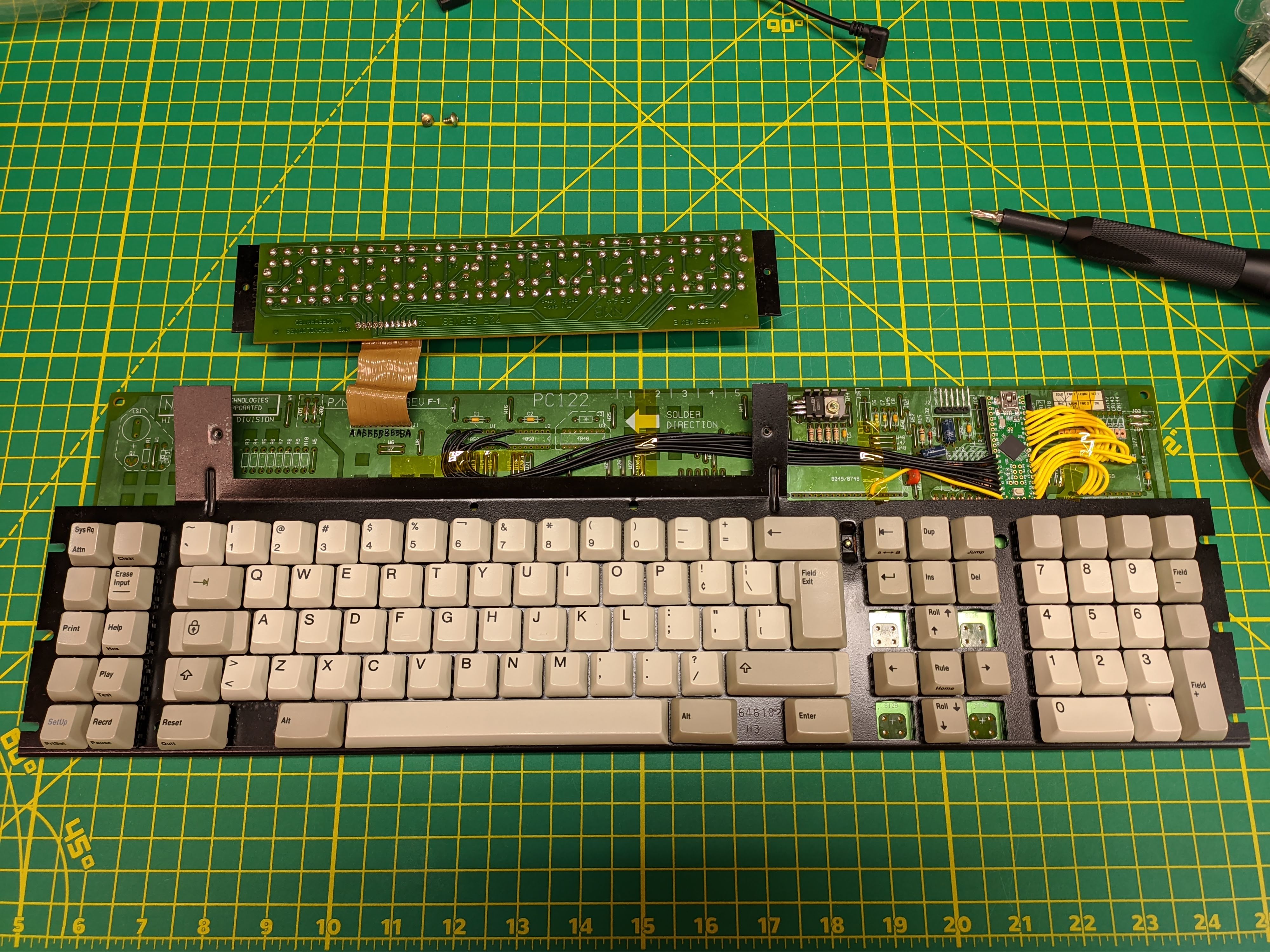

1. Board originally had a 5 pin DIN and spoke XT with the exception that it did not send release codes.
2. Soarer's worked but again, didn't send release codes. Every time you press a key it's like its pressed forever until you unplug the board.
3. There seems to be a few variants all bearing the same model #, case design, etc. I'm not sure if there's any way to tell them apart without hooking up a Soarer's and seeing if it plays nice. Some variants do supposedly work fine with the stock controller.
Although it looks daunting, a controller swap is pretty easy on this board. It's a full diode NKRO matrix with a pretty logical row/column layout. I already have mine mapped so I can provide the PCB pickup points and config if anyone wants it.

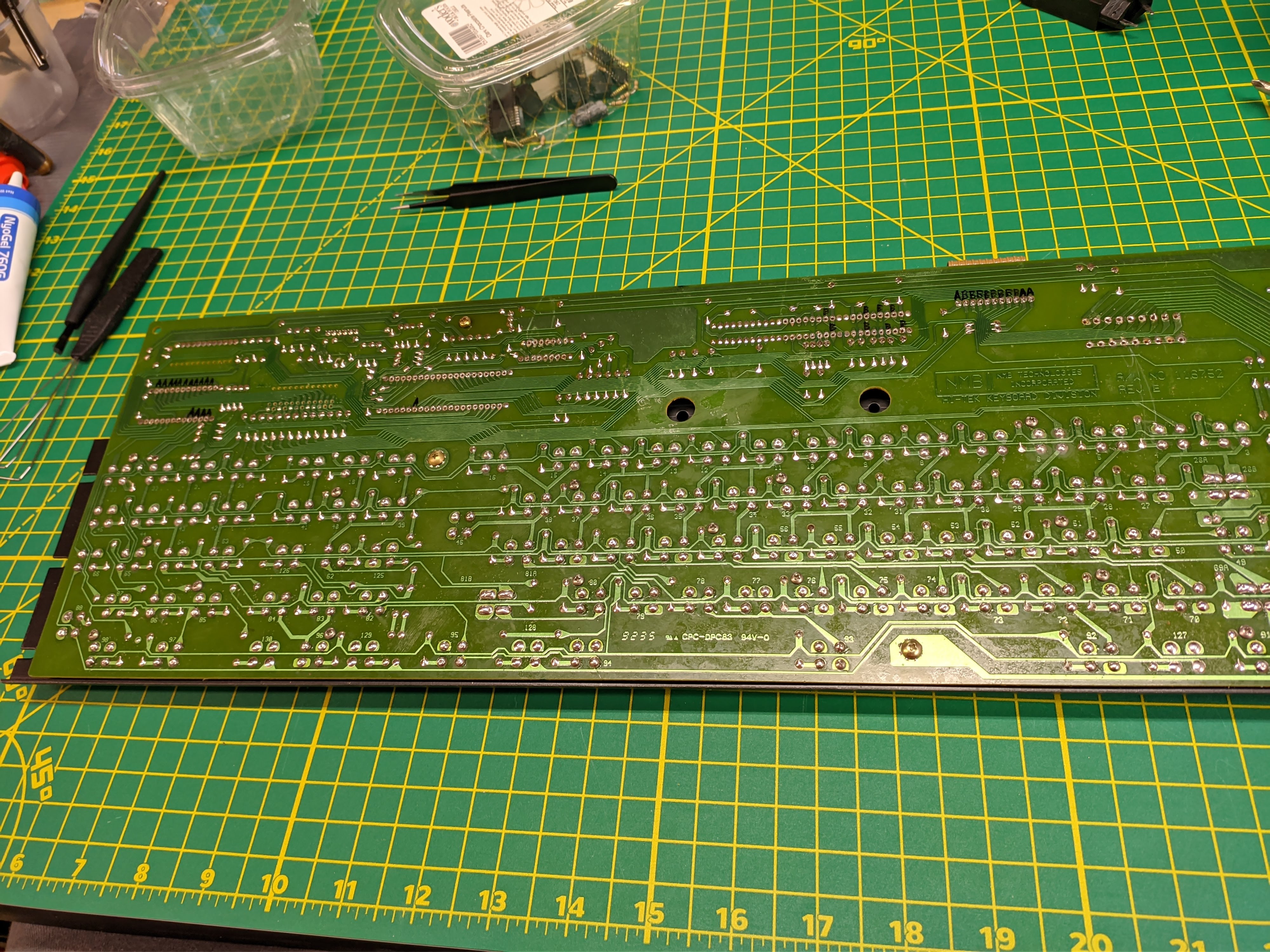

Some more pics of the board here:
jsheradin wrote: 07 May 2021, 03:17
Unfortunately didn't send release codes so I did a full brain replacement.

Like jsheradin stated the only real way to know is if you open it up and there is a voltage regulator. Otherwise, all other versions of the PC122 Rev. C should either speak XT/AT.
I have also replaced the controller with another refurbished chip instead of using a teensy. See here for more information: viewtopic.php?f=7&t=20935
