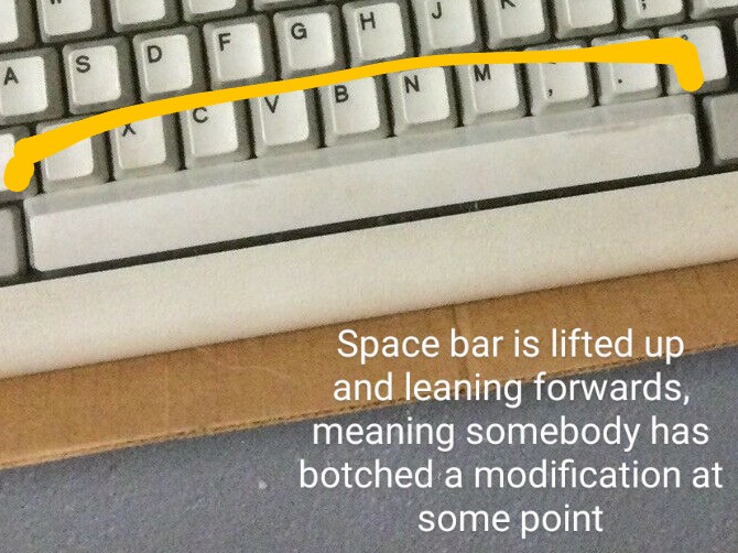

Just to dip my toe in the waters I might just pick this up. Only thing is the space bar’s a little off, tilting backwards as though it’s been dislodged, rubbing against the keys above it.
Do you guys reckon it looks like it’ll just twist back into place or will it need the board taking apart & some surgery?

any spacebar issue will be a more involved process to repair on an F XT or AT because those spacebars have an internal stabilizer wire that you have to take apart the barrel assembly to get too.
Yes I agree it looks odd, good eye.
btw that is an F XT not an F AT I thought you said you wanted.
F AT's are rarer and have a separated numpad area and are easier to mod, F XT's are built better but have a weirder layout that is not modable.

the spacebar could be a bit more than a simple project if its stab inserts that hold the wire have broken off. it will be very difficult sourcing a new spacebar for cheap. it's not a common issue but something you should be aware of.

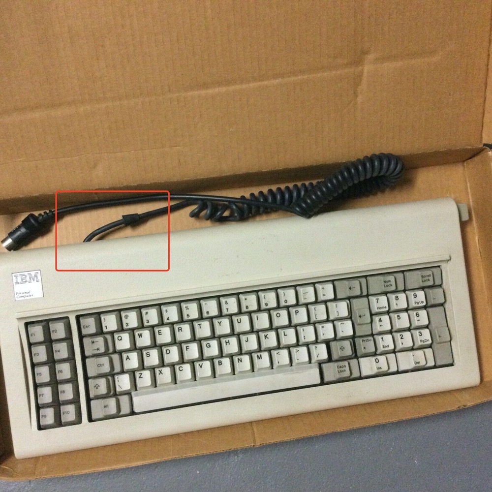

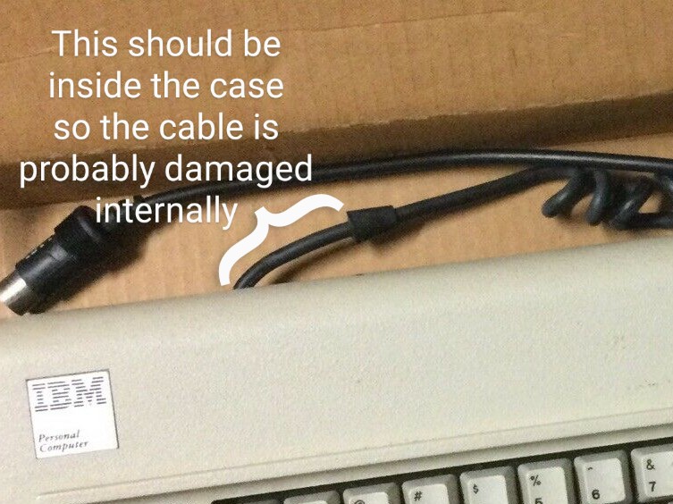

Probably no need to continue to give a reply, but incase someone still wanna that xt and care the entire condition, better remind of this. Photo speaks, no idea how the cable will be like inside part of the shell, but little bit concerned. :)
an_achronism
07 Jun 2021, 08:07
John Doe wrote: 07 Jun 2021, 07:26 Probably no need to continue to give a reply, but incase someone still wanna that xt and care the entire condition, better remind of this. Photo speaks, no idea how the cable will be like inside part of the shell, but little bit concerned. :)
Aye, I spotted that. It's a tad suspicious to me that they "have no way to test" but the cable appears not to be held in the retainer which suggests it has been disassembled then reassembled incorrectly.
Tritian
07 Jun 2021, 08:24
Probably not the only thing assembled incorrectly. It seems obvious the wire hooks are not inserted into the stab posts on the spacebar.
My guess is this was a botched attempt to lighten the spacebar. There could be physical damage to the wire or stab posts on the spacebar which would be very difficult to repair.
Or maybe when the guy opened it he saw the foam was so far gone that he hastily re-assembled it and decided just to pass it on...
Avoid.

Tritian wrote: 07 Jun 2021, 08:24 Probably not the only thing assembled incorrectly. It seems obvious the wire hooks are not inserted into the stab posts on the spacebar.
Avoid.
Hahah I just came back to the thread to say precisely that, I had noticed the space bar sitting pushed up and forward so clearly not mounted right. Looks scratched as well.
I'd also guess that since these things have evidently been done wrong, the inside is almost certainly messed up as well. The assembly is probably forced shut such that the module is pressed up against the adjustable legs (in which case they won't be able to move and have an immense amount of pressure exerted on them). God knows what the hell they've done to the space bar wire, as you say.
