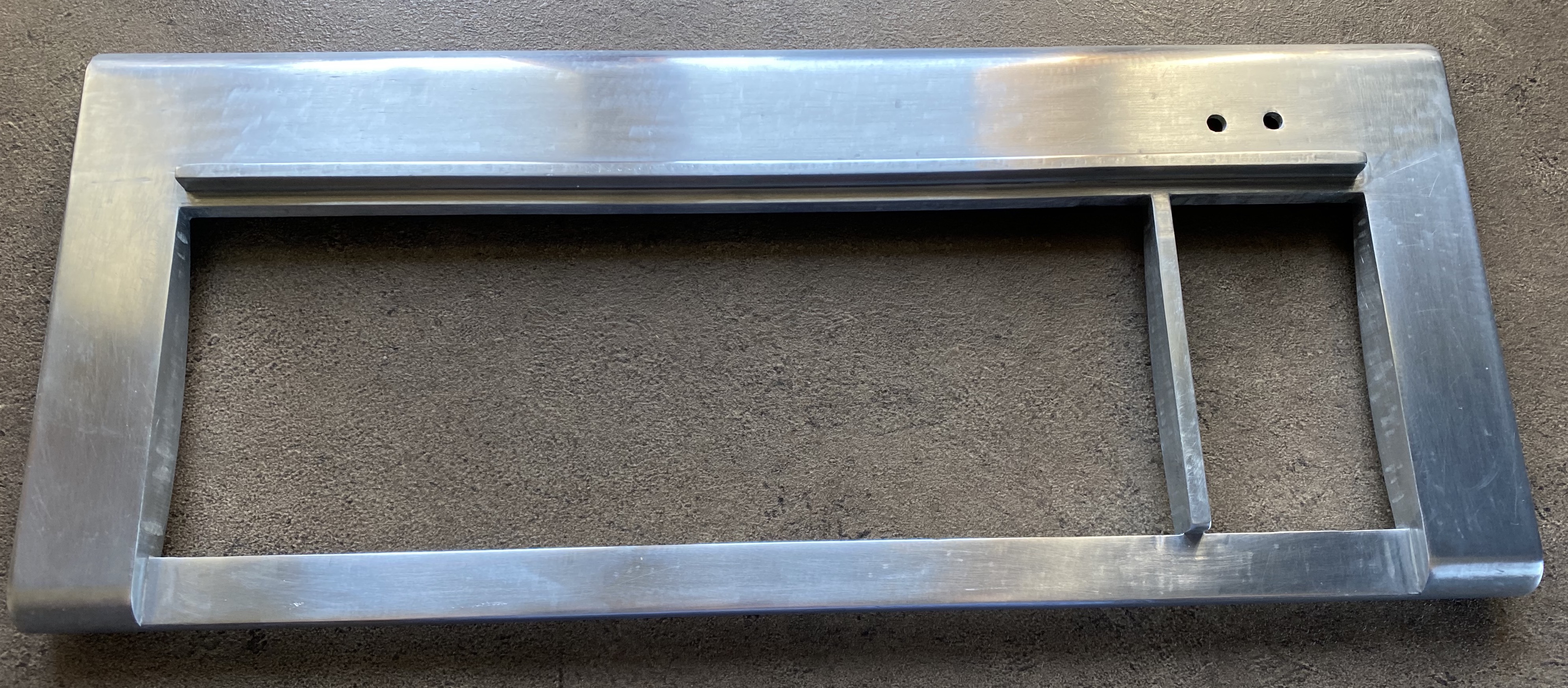

For those who wanted to see how the F77 zinc case without powder coating, I worked my way up till a 800 grid today... Still a few steps to go until it is shiny (I plan to go up to 2500 grid and then polish it). Finally I plan to put a clear coating over it.
Yes, I have multiple blisters on my hands ...

Please keep us posted. When I stripped my original 107 and took it to the metalworking shop to get it shot-blasted, they told me that they would never be able to get it to a smooth and consistent finish.

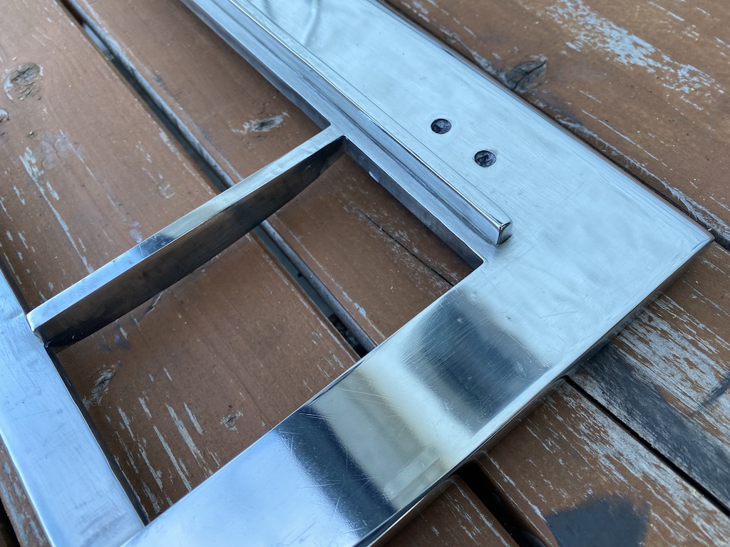

Just ran up to 2500 and tried to polish a part of it. So far, I think I can make it quite clean looking. I don't want it perfect, otherwise I'd paint it with a chrome finish.
I want an industrial style, where you can see that it is real metal.
13 Jun 2021, 18:05
darkcruix wrote: 13 Jun 2021, 17:38
Now time for polishing compound.

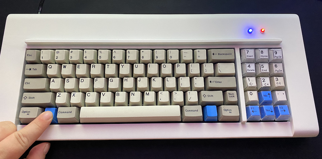

Are the two holes for lock lights?
darkcruix
13 Jun 2021, 19:19
Weezer wrote: 13 Jun 2021, 18:48 Are the two holes for lock lights?
They are :) Actually I programmed them so they show Layer 1 or Layer 2 (or together = Layer 3).
While Layer 2 is numpad and Layer 3 is mouse movement.

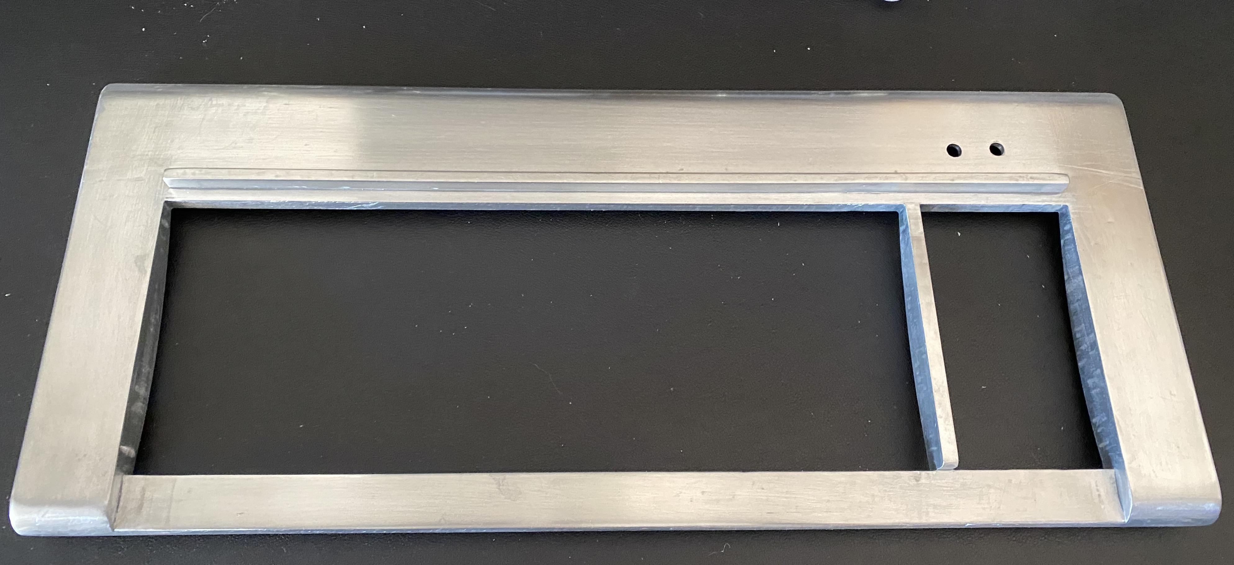

I tried very hard and went all the way from 320 to 3000 grain (with intermediate steps using 600, 1000, 1500, 2000). In the end I gave it a good polish (about 5 complete rounds). I think I am just not skilled enough to get it properly done:
Maybe an important note for others: the zinc casing was very well done and I had only very limited casting issues (tiny holes etc). Nevertheless, I didn't succeed. I have added 2K clear coating and it looks horrific at the moment. Open for any additional ideas (including getting the keyboard powder coated again) :)

Looks pretty good without any sort of coating. I may need to sand my compact case as the paint layer was extremely thin and has already begun to show marks.
darkcruix
20 Jun 2021, 21:09
wobbled wrote: 19 Jun 2021, 21:49 Looks pretty good without any sort of coating. I may need to sand my compact case as the paint layer was extremely thin and has already begun to show marks.
I used enamel paint in pure white for the case. It should be very durabel and feels very smooth.
