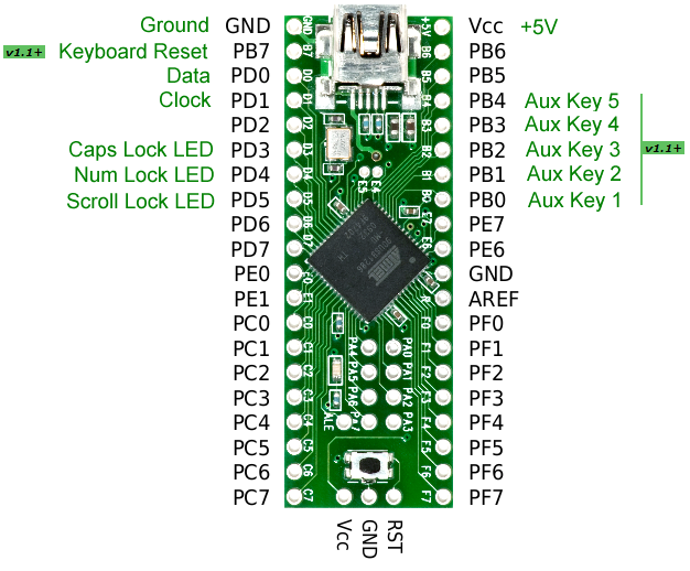

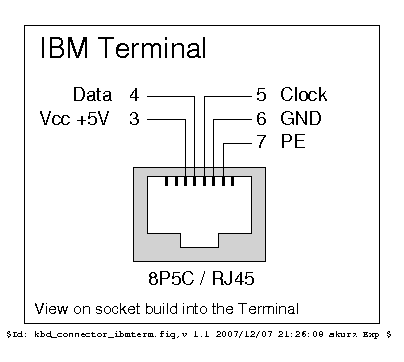

As shown in the pictures above, IBM terminal keyboard has a pin called "PE" on the 7th. Where should I connect this one to? :shock:
In addition, in order to complete this converter, is everything I have to do is the following?:
1. Solder/Connect/Wire RJ45's 3, 4, 5, 6, 7 (pins) to teensy++'s Vcc, PD0, PD1, GND, [?]
2. Install hex in teensy++
3. Done :!:
I would be grateful if someone can confirm myself if they are correct and the existence of the PE pin! :roll:

On my M122-conversions I never connected the PE pin.

PE is likely protective earth and not necessary to wire up to a controller board.

feltel wrote: 15 Jun 2021, 17:56 On my M122-conversions I never connected the PE pin.
Thank you for the opinion! :D
licrefin
18 Jun 2021, 09:22
soyuz wrote: 15 Jun 2021, 18:16 PE is likely protective earth and not necessary to wire up to a controller board.
