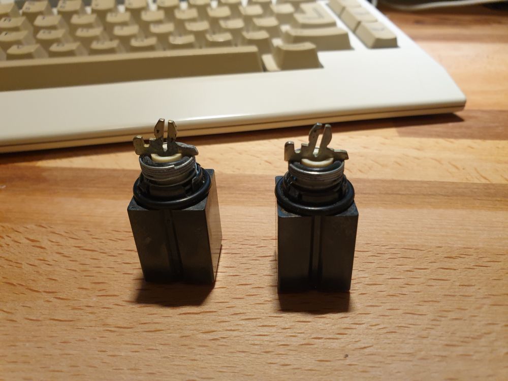

You can use 14x2mm o-rings too if you don't want to mess with foam. That's what's on my displaywriter.

soyuz wrote: 26 Jun 2021, 12:16 You can use 14x2mm o-rings too if you don't want to mess with foam. That's what's on my displaywriter.
Original ? or a mod. How do they compare ?
soyuz
26 Jun 2021, 18:10
Never used foam, previous owner did it - no key wobble to speak of, feels nice, would rate rather highly tbh

rpl wrote: 26 Jun 2021, 15:18
It's a mod, I've done this before. It's a good alternative. There's a how to thread somewhere on the site.
