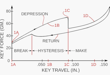

Sorry if this topic has already been discussed here.
I know there are Unicomp or New model F keyboards.
There is a great guide on MechanicalKeyboards.com but it doesn't contain charts like the attached one.
So what's the closest non buckling spring buckling spring alternative? I mean in tactility. The sound may be different.
Rubber dome? :oops: There is a mechanical alternative with a similar tactile bump, isn't it?
Thanks!

I'm sure there are switches that replicate the gradual tactility of buckling springs, but I doubt they're common.
As far as common boards, I think I heard some people bring up the Fujitsu FKB4700. Can someone confirm or am I mistaking it for another board?
I've heard mixed feelings about them, but I personally never tried it.
I'm actually curious myself on how similar they are. Is there a force curve about them anywhere?

Thanks for the replies.
To sum up, if you want buckling spring feel, you need a buckling spring keyboard. Take it or leave it - if you want to quiet it a bit, use the known dental floss solution.

I don't think any of them are quite as tactile (or indeed as satisfying) as actual buckling spring, and the force curve isn't very similar because they're more or less "linear then click bar then linear", so bear that in mind, but there is a certain amount of similarity and they're the only ones I've tried that have even the slightest resemblance imo.
