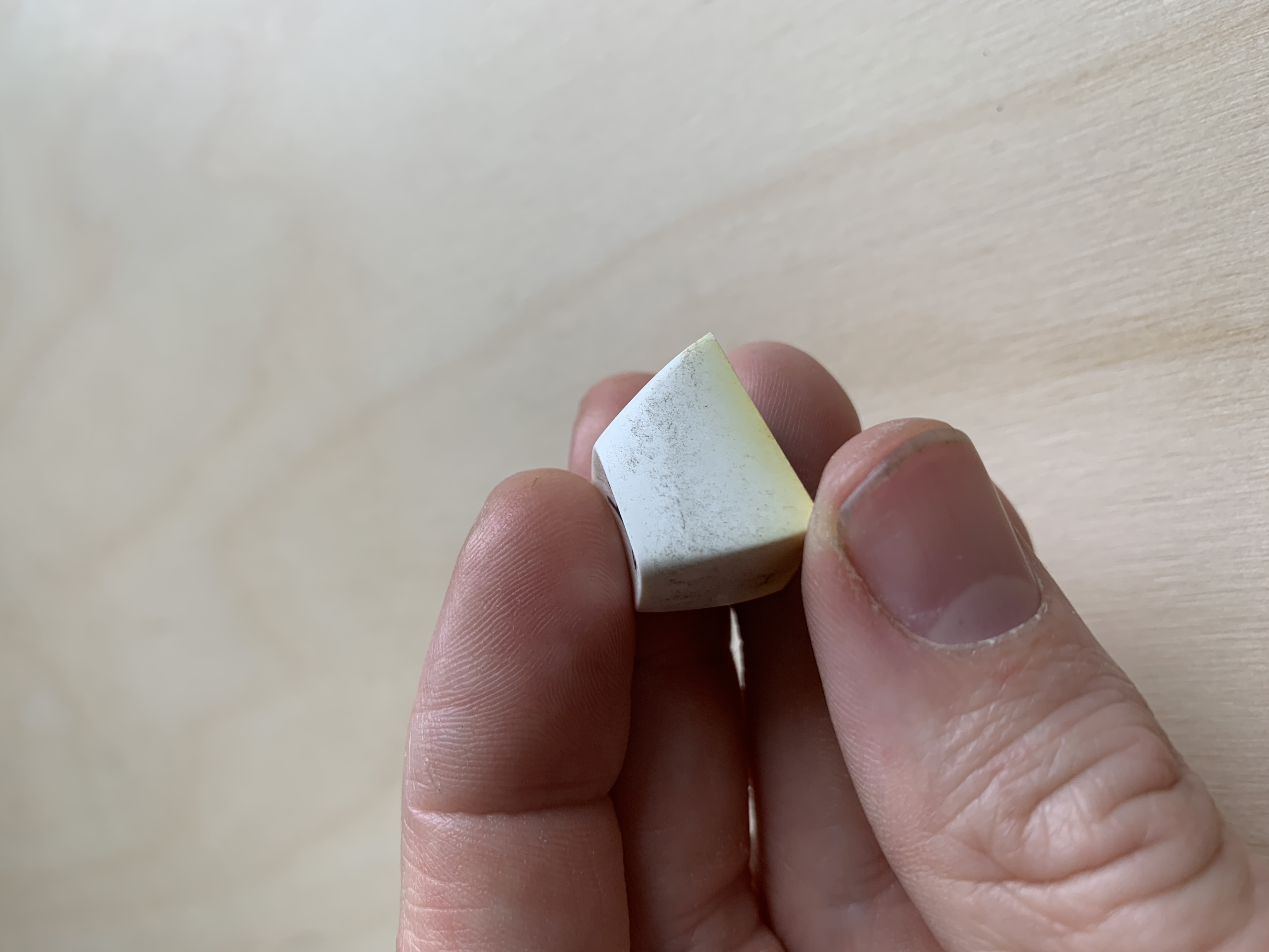

Attached is an image of one of the keycaps in question, before the ultrasonic bath.
I'll post more images of the keycaps (and boards) if anyone wants to see more. :)

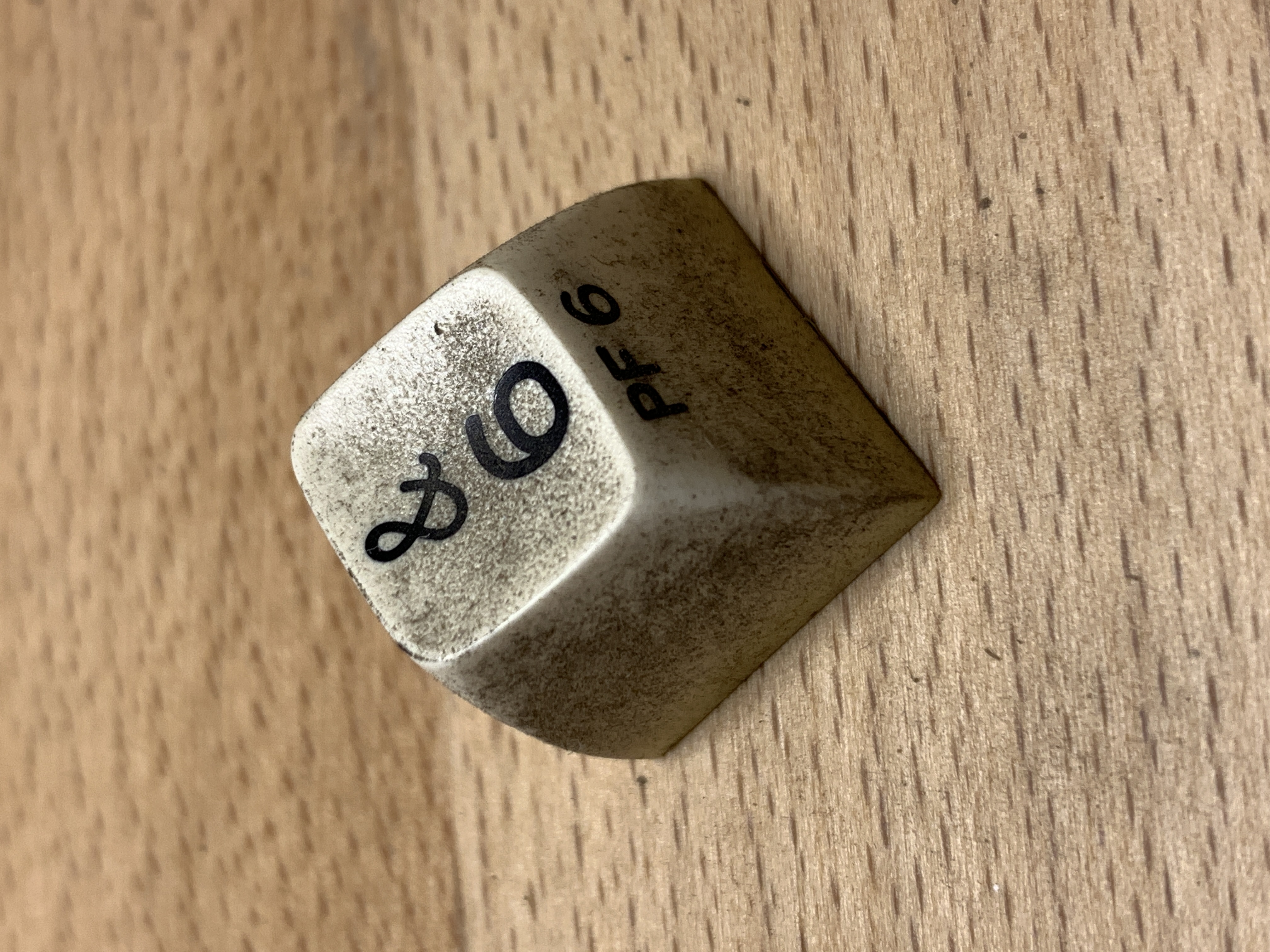

Also be careful it's not that hard to remove the front "PF 6" legends by abrasion!

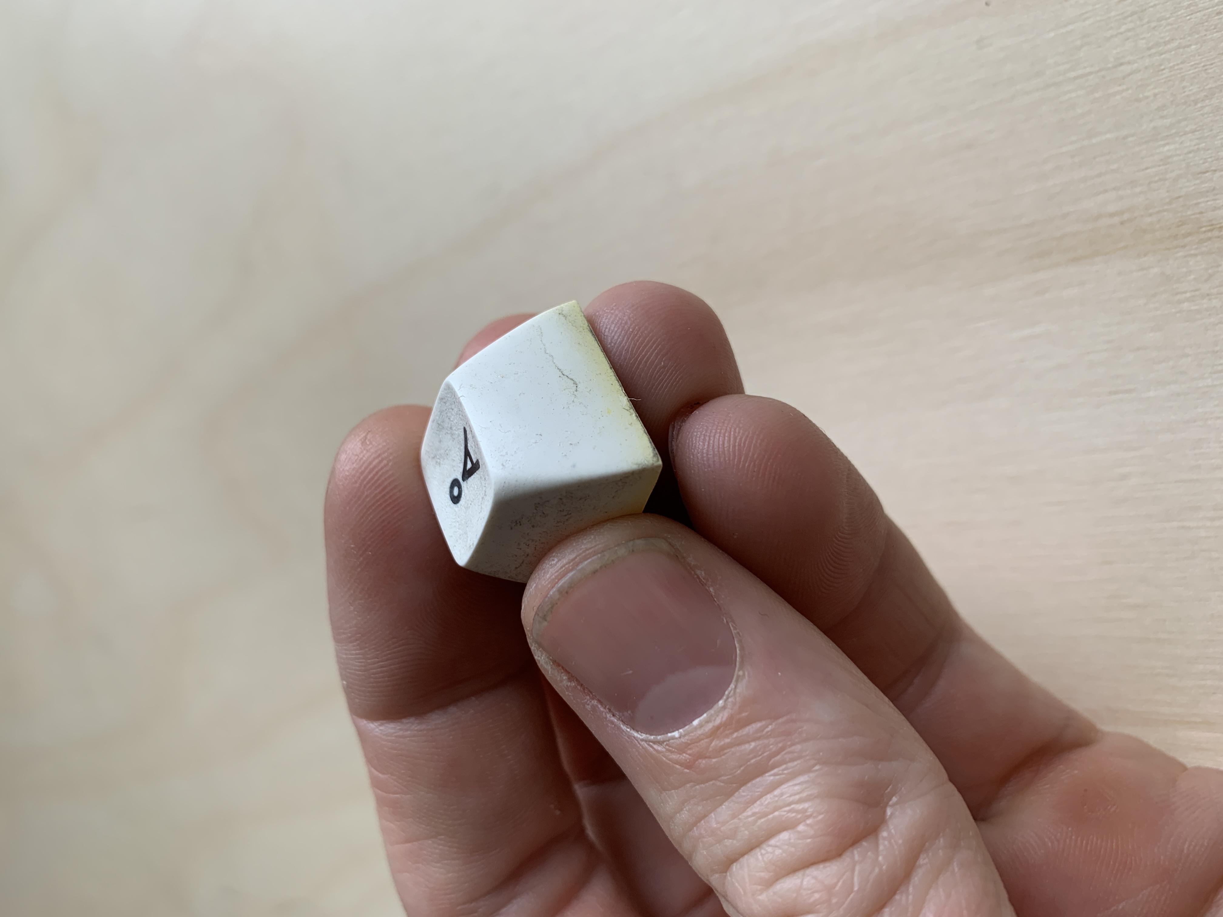

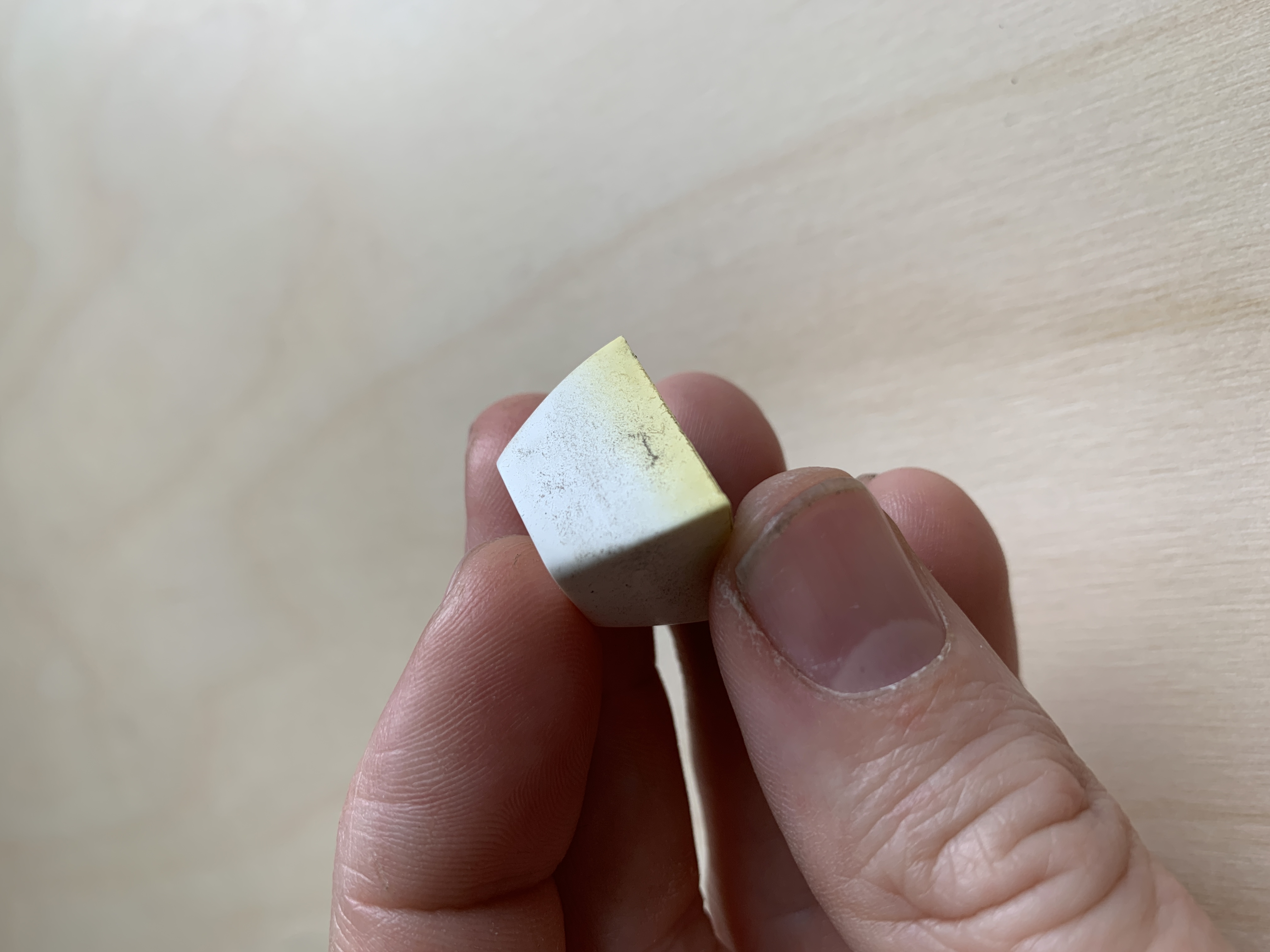

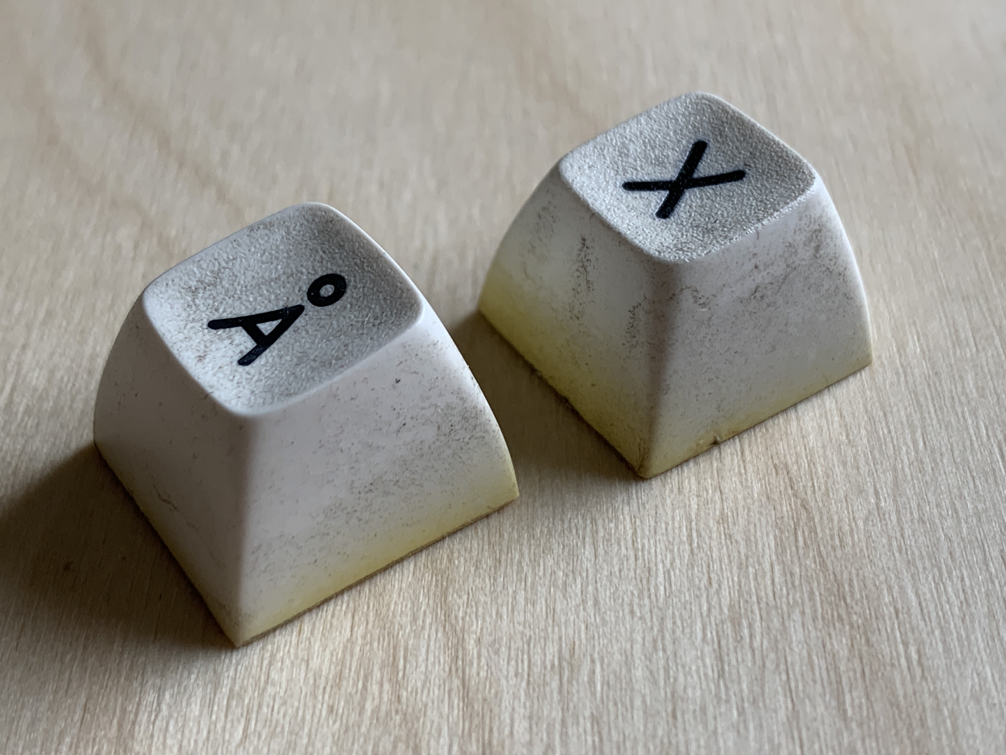

Pictures. All taken after all washing and futile attempts that I just mentioned.

These keycaps must have had an "interesting" life! But after all these treatments I think we can call these caps "clean" even if they don't look like it. Actually I find the look quite nice - if it's somewhat consistent over all keys.
The yellowing just adds to the mystery, because if it would be yellowing caused by UV light, it would be yellow at the top and have it's natural color at the bottom, where the least light gets to.
