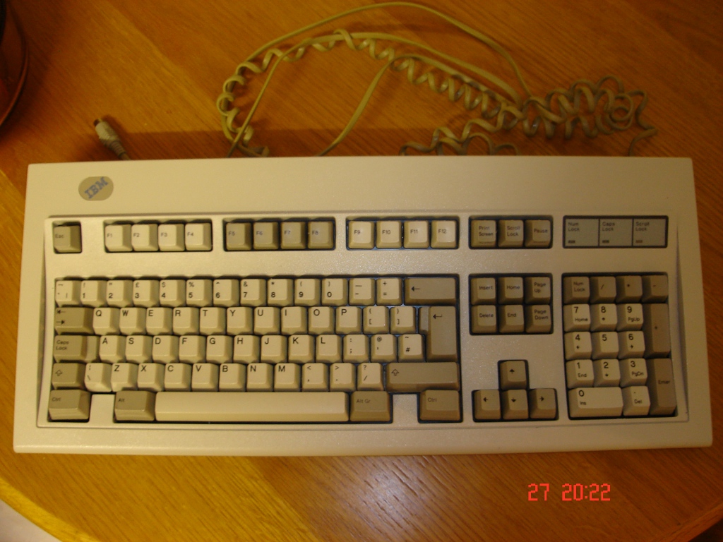

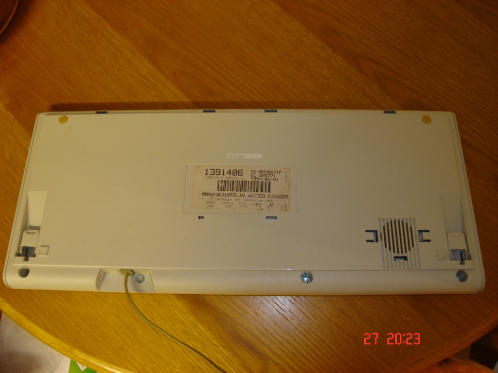

First, I decided to clean up the working one, missing its external birthday label. It turned out to be a Jan 1988 model, from the internal birthday sticker. It has the yellow wired-up LED PCB, but not the brass-coloured plate. Following the wiki here, that would make it a "1.5" genration model since it fits neither the first or second gen. descriptions.
Anyway, I started with this:
Dirty
Dirty
And achieved this:
Clean
Clean
Internals, for those interested:
Inside Scottish 1988 Model M

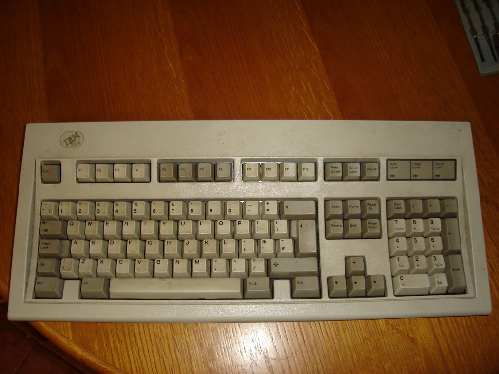

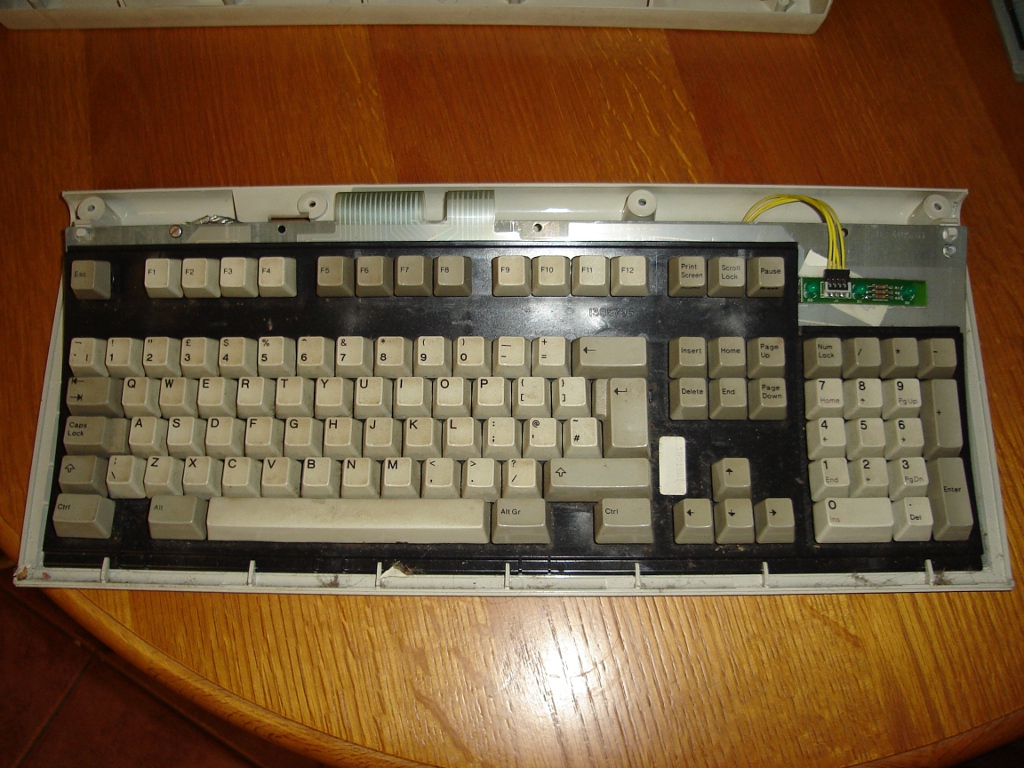

Next I opened up the dead captive cable M, born in Scotland in 1994. The PCB header was detached from the PCB, so I soldered it back on. This brought the keyboard back to life. However, the following keys are not registered: 'Pause' 'Num Lock' '/' '*' 'Enter' (the big one) 'R Shift' ' R Ctrl' 'Z' 'X' 'C' 'V' 'M' ',' '.'
I wonder if this combination points to a particular failure mode, such as a broken track on the membrane? I suggest this due to this previous work: http://danson.grafidog.com/2009/02/model-m-repair.html

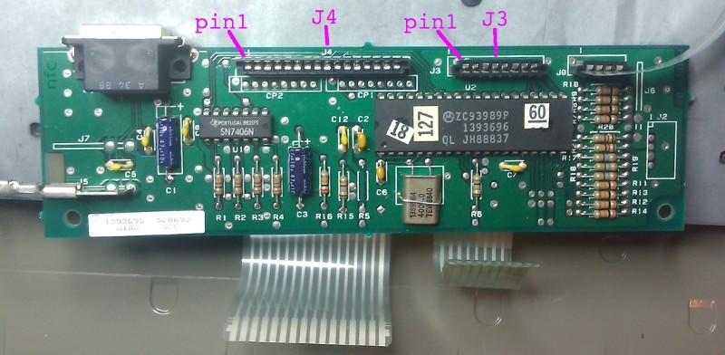

Matrix is collected on connectors J3 and J4, see attached picture.
Just have a look at Model M matrix at (bottom of the page):
https://github.com/clee/rump/blob/master/doc.txt
Chris Lee did a fantastic work here... also with documentation.
It seems that your 1994 keyboard have a problem on J3.7 meanwhile the 1993 one have a problem on J3.8
Try to search in that direction :idea:

I had a quick look this evening, and a visual inspection of the 1994 'board tells me that the exposed conductor on the track that connects with J3.7 is worn through. I've ordered some copper tape to sort this, and I'm hopefull that might fix it!

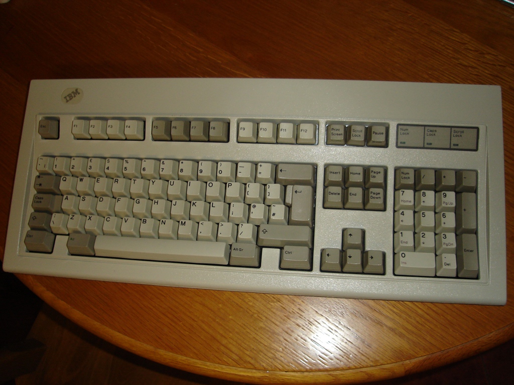

To finish that one off, here is the fully working and cleaned up 'board
Clean and fully functional 1994 Model M

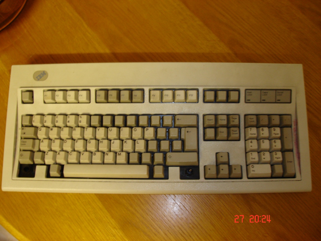

1993 Model M - Faulty- Missing a spring, 2 stems, many keycaps
