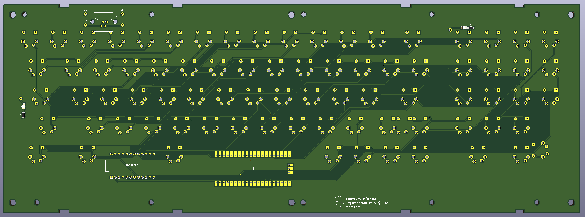

A faithful re-creation of the M0110A PCB, with some nice QoL features, reasonably accurate markings and a silly cable system to preserve the external appearance of the keyboard. I know that the elmo M0110A PCB is out there, but it doesn't support Mitsumi and also uses a pain in the arse chip.
Status
On sale NOW at kuritakey.store - Until December 1st
Features
  • Mitsumi Standard and Alps SKCC
  • Supports Pro Micro or Pi Pico as MCU

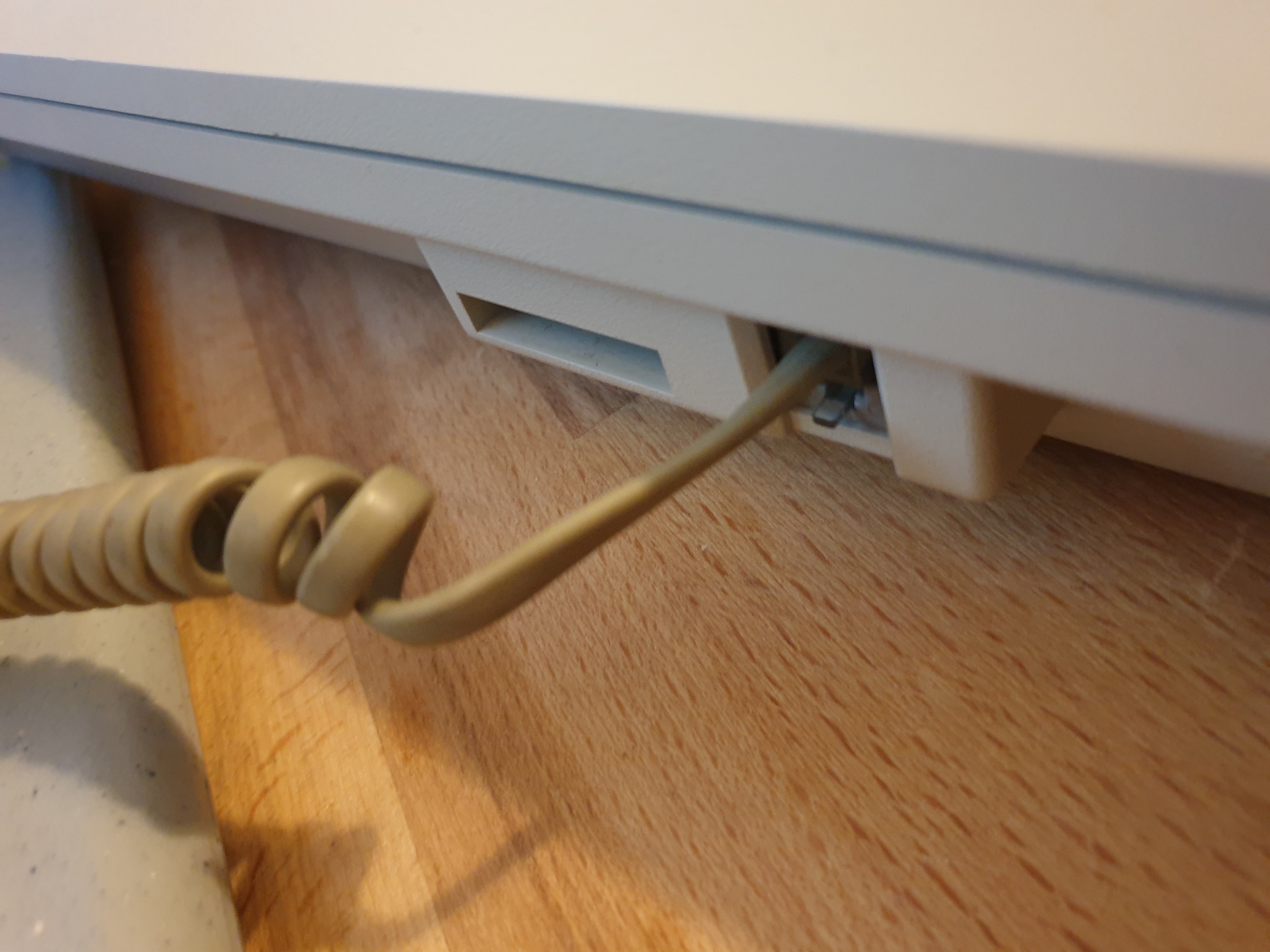

  • Preserves keyboard appearance with some smart cable chopping and re-use of the original 4p4c connector
  • N-Key Rollover - through-hole or surface-mount diodes
  • Supports ANSI mod (ANSI backslash, 2.25u right shift)
  • QMK and VIA firmware (Pro Micro only for now, Pi Pico will use KMK until QMK is ported)
Pictures
Fun

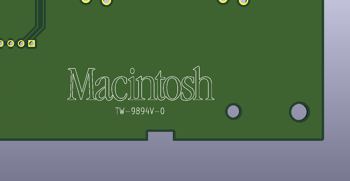

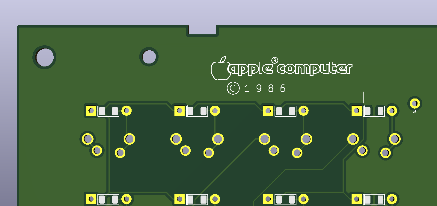

This PCB is designed to be unobtrusive as possible! It will ship in classic green and carries faithful markings copied from the SKCC version of the original PCB. Modern markings kept to an absolute minimum.

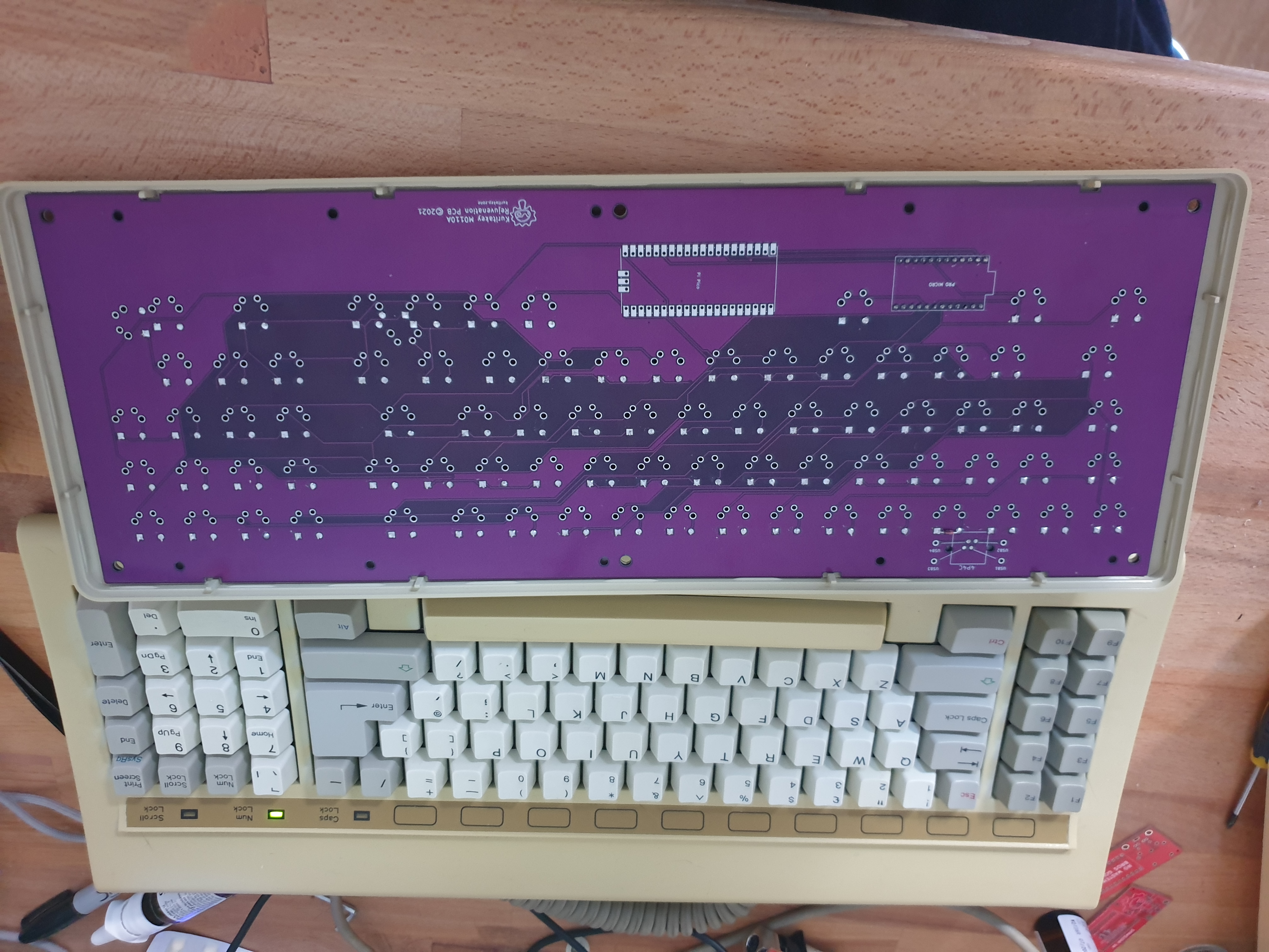

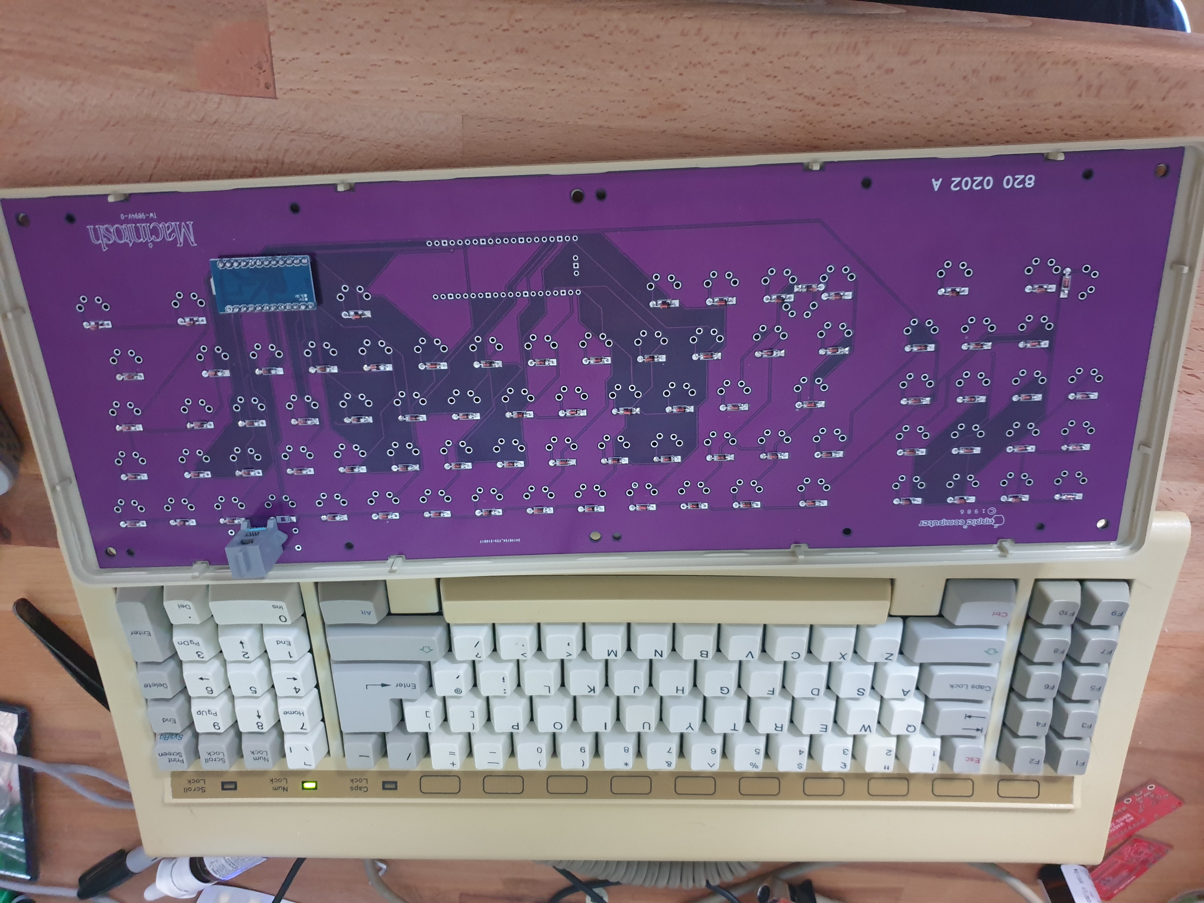

soyuz
27 Sep 2021, 18:27

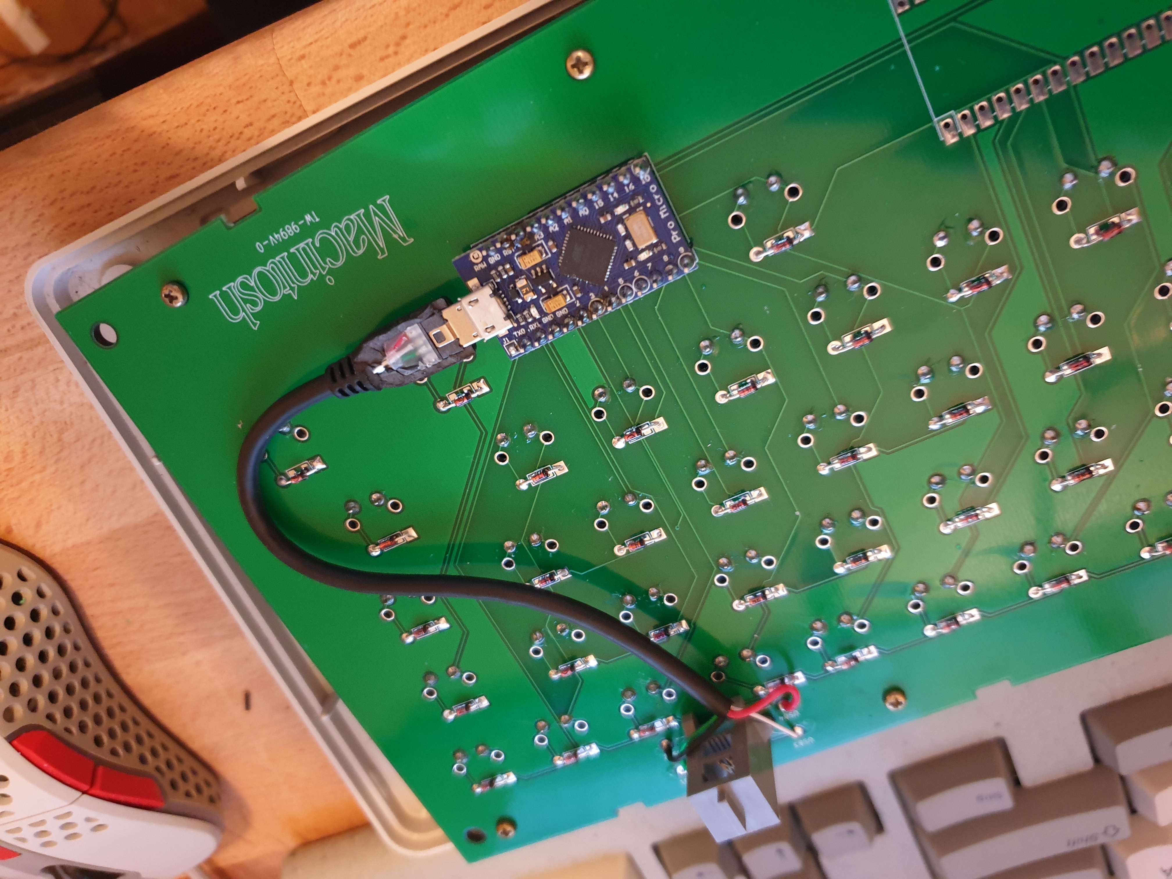

Prototypes arrived (in Prototype Purple!) - partway assembled at the moment, will update again when fully assembled.
Some minor issues spotted when seen IRL (as is to be expected) but fixes are easy. Those issues were:
- Mounting peg holes for 4p4c connector slightly off
- One diode collides with 4p4c connector housing when soldered through hole
- Pro micro footprint wasn't flipped, which makes plugging in cable kind of bait but doable.
All of these are workaroundable at present but will be sorted before any GB.
On the plus side:
- Fitment is perfect
- Electrically 100%

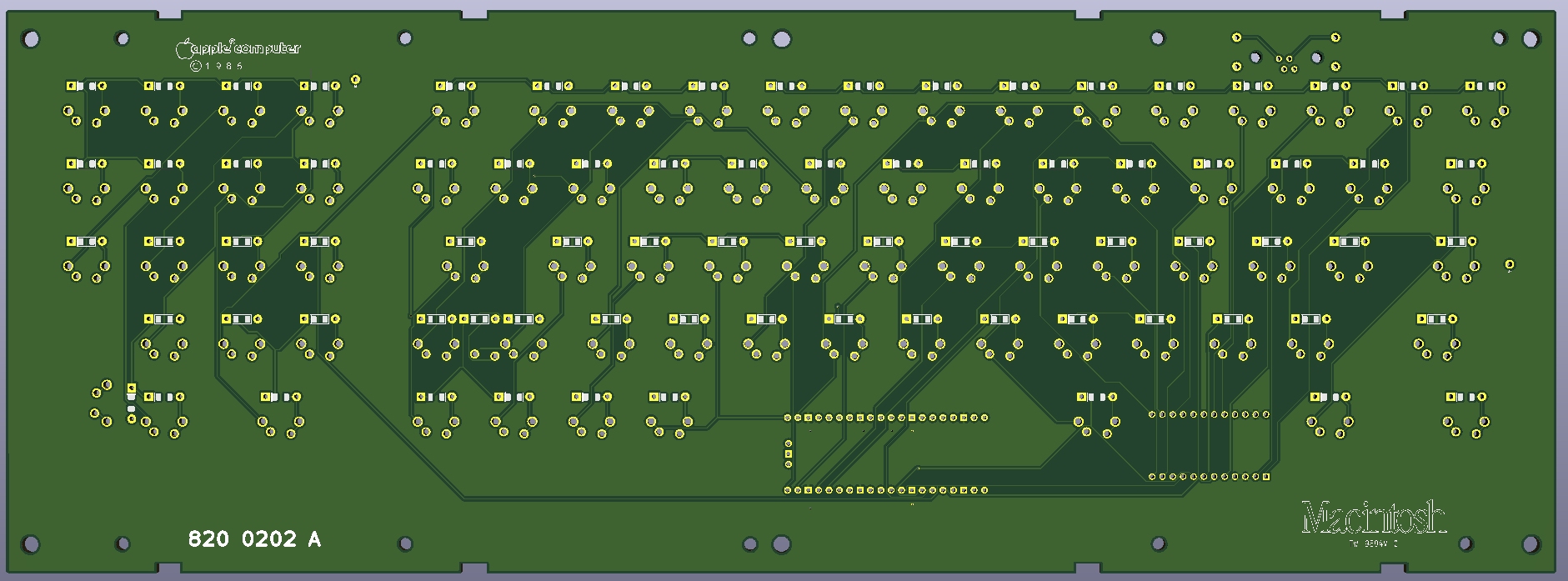

soyuz
27 Sep 2021, 19:36
It's gonna be a while - another prototyping round required. Numpad was offset just enough to make it impossible to put the pcb on ._.
I don't feel comfortable selling this til I've put a prototype on the keyboard and it works.
Edit: this is because Apple put the numpad 9/16 of a unit away from the alpha block. You gotta be kidding me.

soyuz
27 Sep 2021, 23:51
Next prototypes ordered - hopefully they make it out before Chinese holidays
soyuz
04 Oct 2021, 15:47
New prototypes are in, alignment issues look resolved. Will assemble and test tonight
soyuz
04 Oct 2021, 22:10
Working fine on SKCC M0110A :D
Waiting on Mitsumi testers to test that and then I'm happy to move toward a GB. Pics soon.

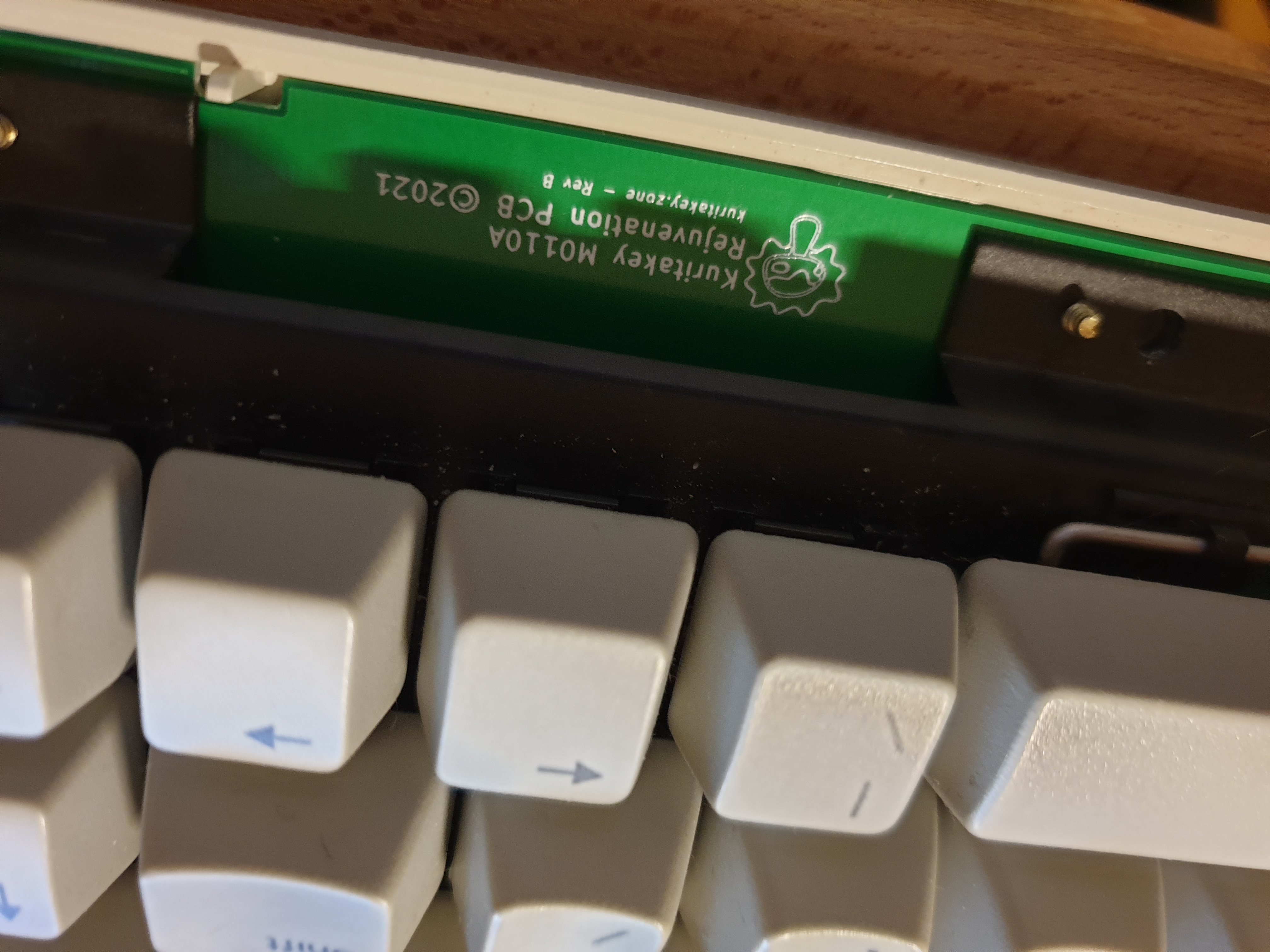

soyuz
05 Oct 2021, 00:13
Here we go! Unfortunately the 4p4c to USB cable I made looks super bad cause I was shivering in my cold cellar at the time, so haven't bothered showing that.
pro micro to 4p4c wiring.jpg (3.69 MiB) Viewed 23771 times

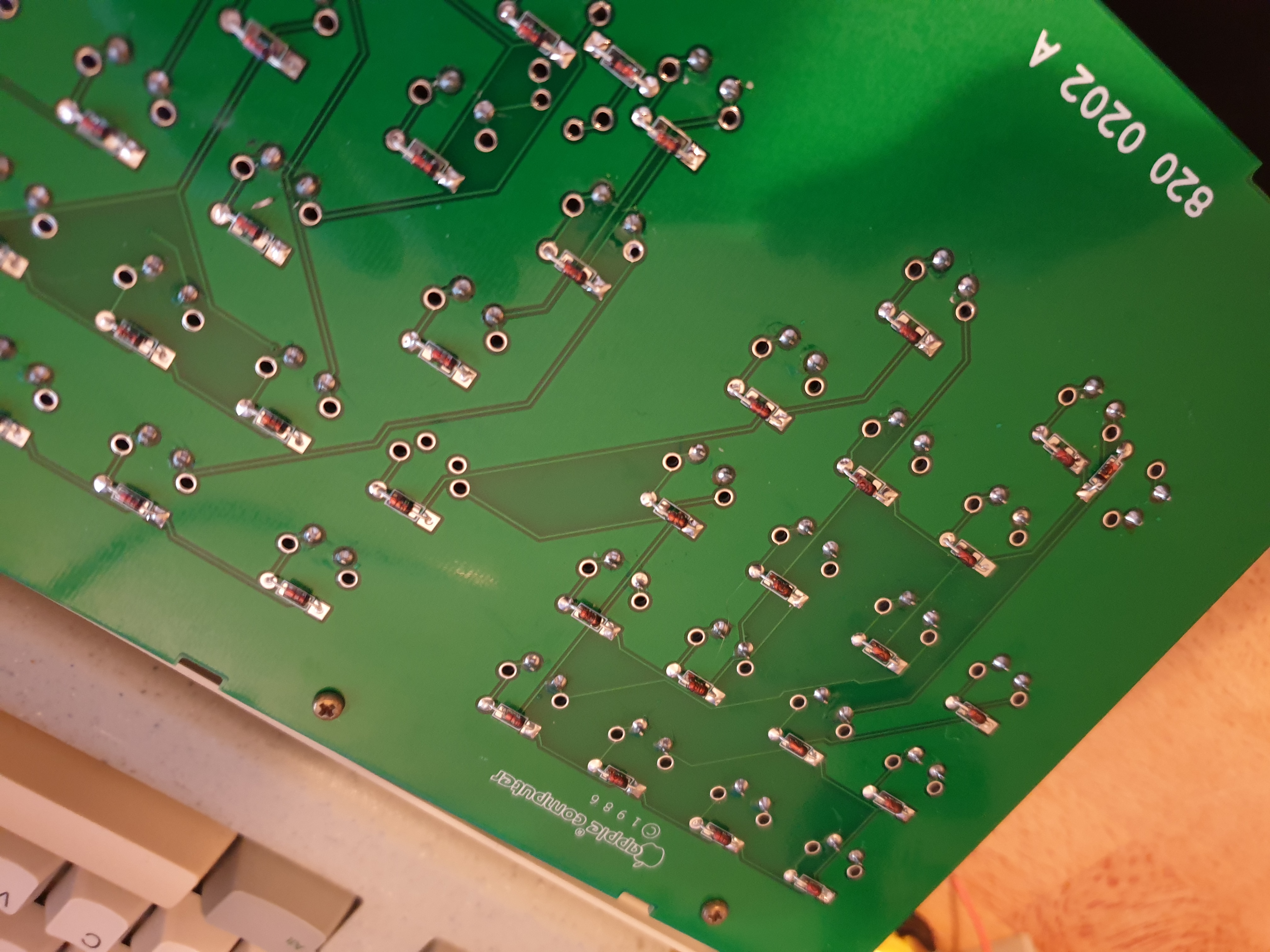

soyuz
09 Nov 2021, 05:34
Preliminary testing looks like the Mitsumi footprints work okay - I am likely to run a combined M0110 / M0110A GB very shortly.
