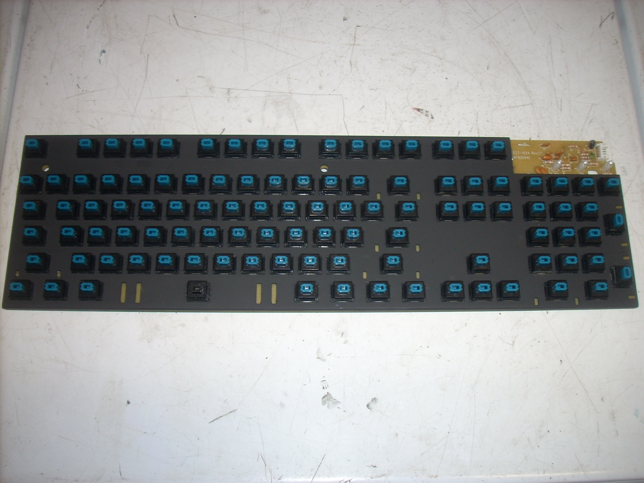

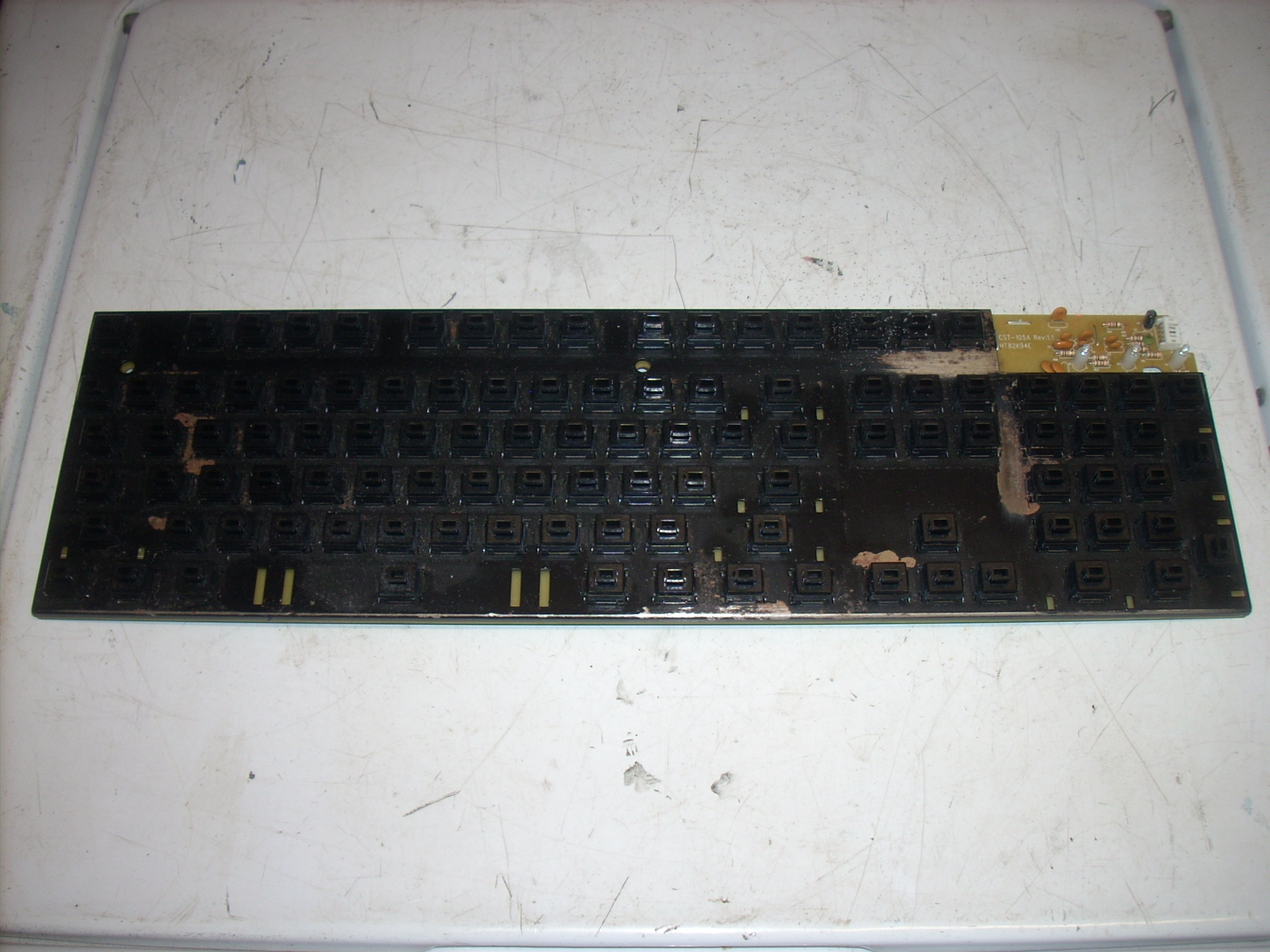

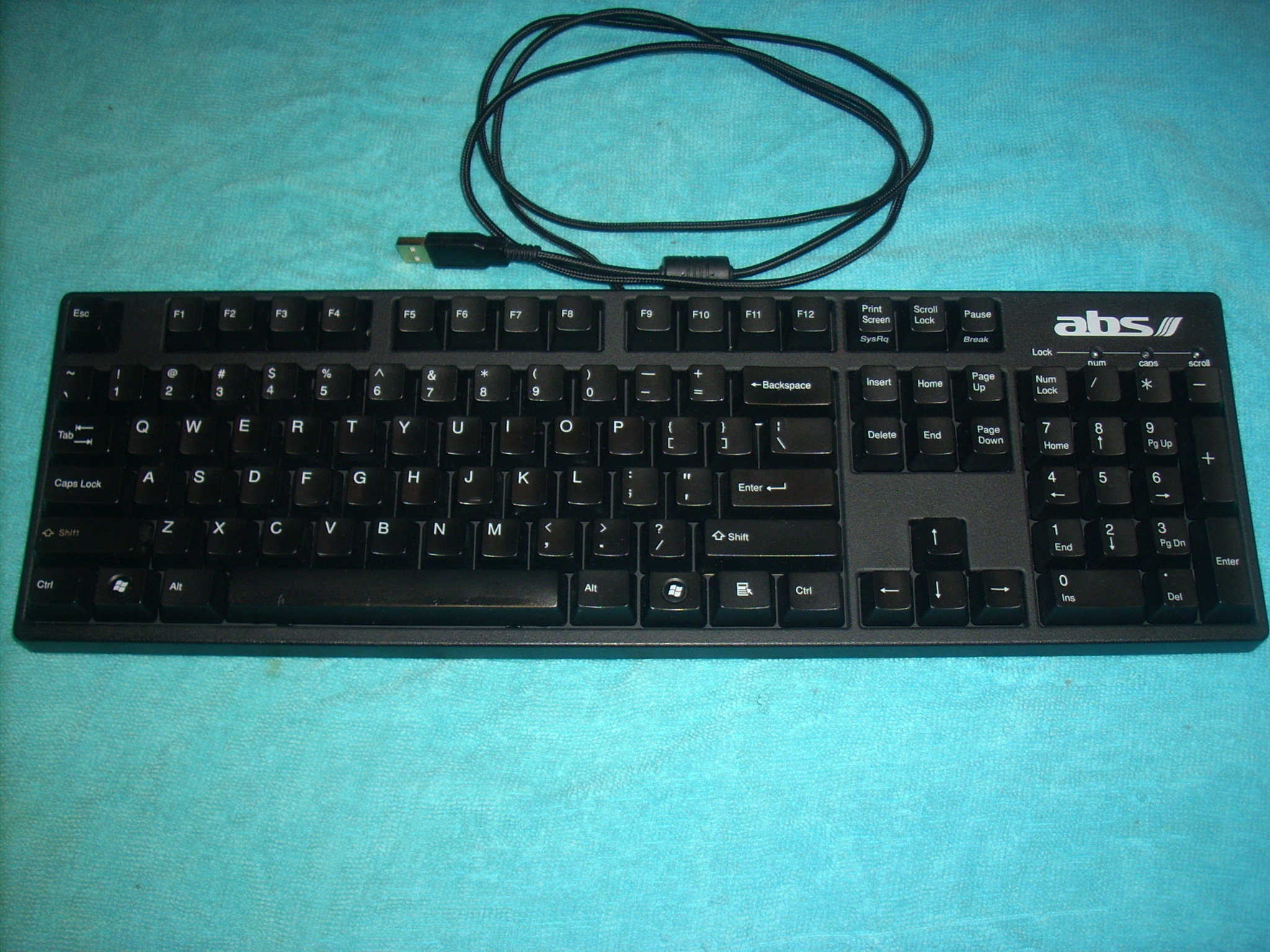

I recently bought two of these. ABS M1 board with Forward (Fuhua) black tactile Alps clones. One was like new, so I left it stock. The other had a rusty plate and a damaged cable, so it was fair game for some mods. I just wanted to see if I could make a usable keyboard from modern (read: cheap) parts. Yanked the Forward switches out, sanded and painted the plate, stuck in some clicky clone switches from another modern board, and put it back together. They're not real Alps, but it's a pretty decent keyboard for 20 bucks and change. ANSI layout, real USB (no converter), and no extra charge for the blue LEDs.

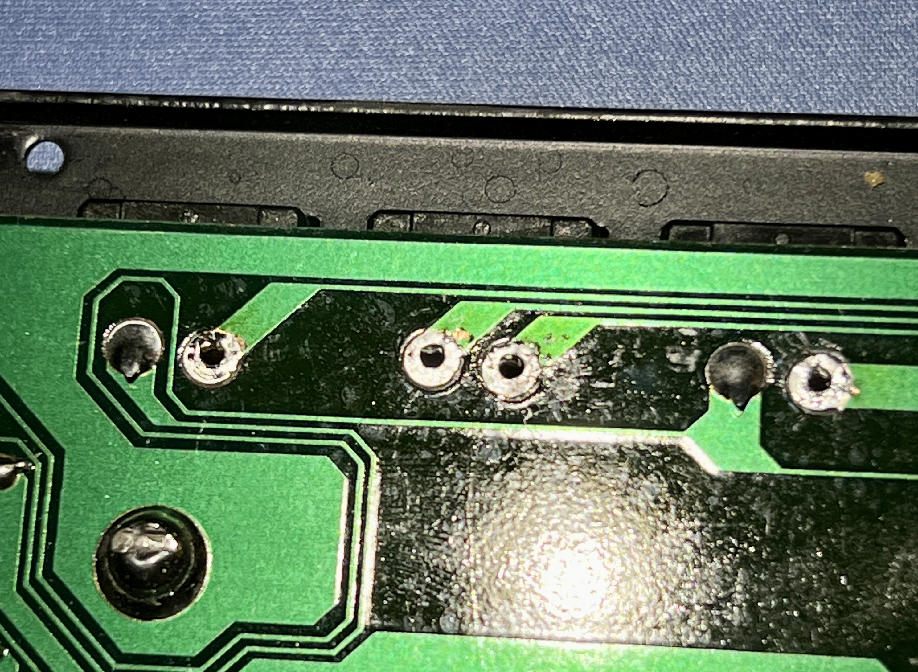

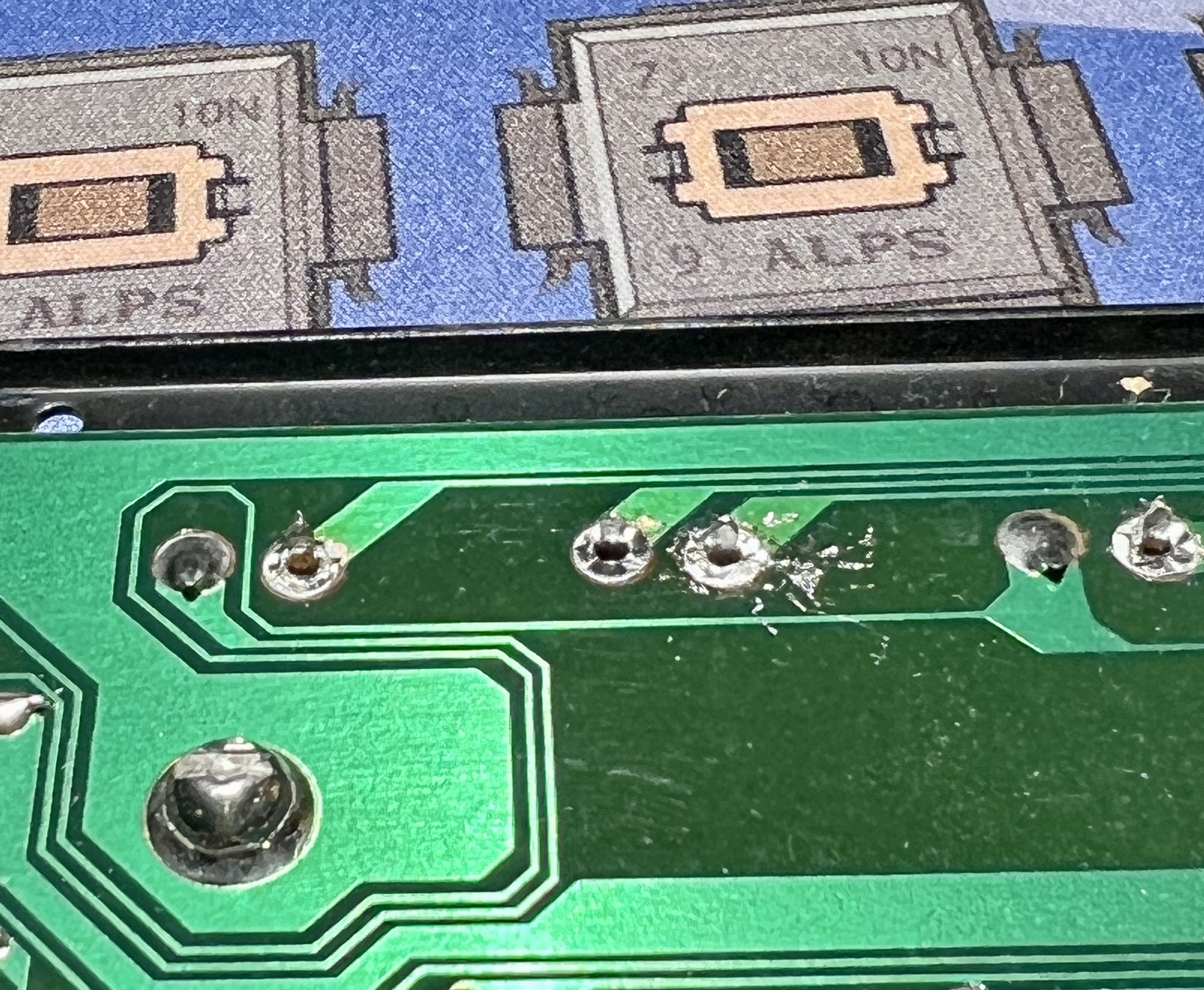

I tried your method and it seems to be working out well. This is my first time desoldering and my first attempt wasn’t good - I thought I burned the pad. I also had a hard time getting the solder sucker to suck until I figured out you need to suck the solder at an angle leaving a gap for the air to go through. Attached are some pictures for reference.
Stupid question. After the switches are desoldered can they be gently pried off the switch plate?
