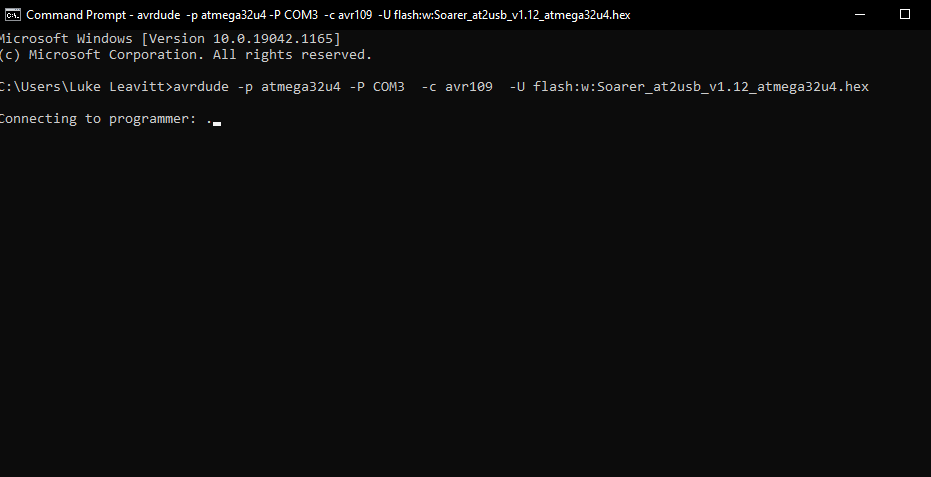

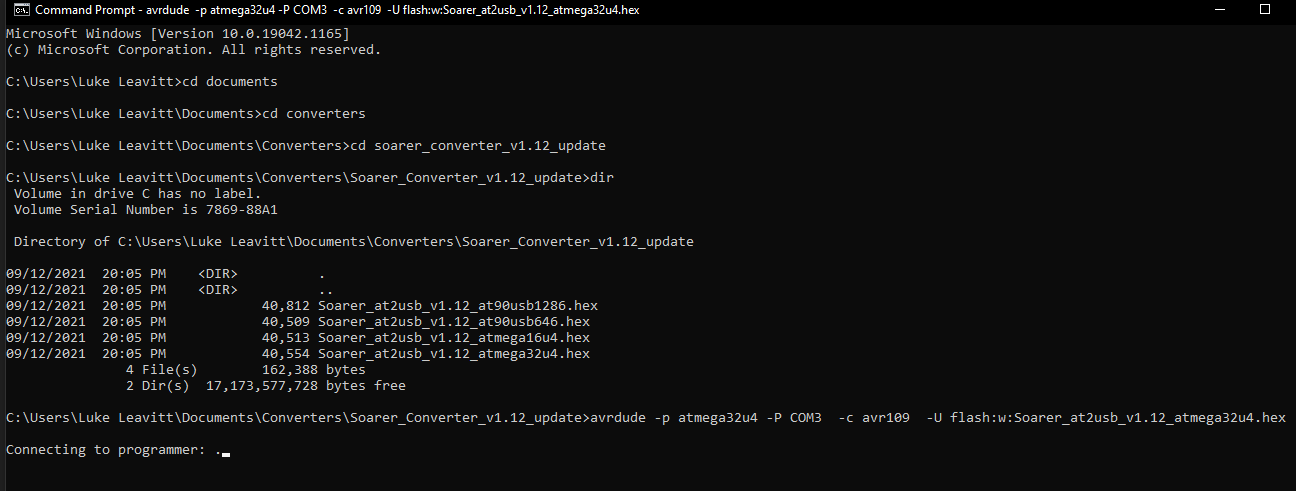

Hi Everyone,
I am working on building a Soarer's converter for my Model F XT using a Dfrobot Beetle which is basically a compact version of an Arduino Leonardo. The problem is that I have not been able to successfully flash the code using command prompt. I tried two different ways but both just get stuck on connecting to programmer as you can see in the screenshots. It is worth noting that command prompt is finding the microcontroller because when I unplug it the process fails. Any help is much appreciated because I really want to get this keyboard working :)
Edit: I got it working! The problem was that when I put my microcontroller into bootloader mode it temporarily changes the COM port so I had to flash to that port instead.
